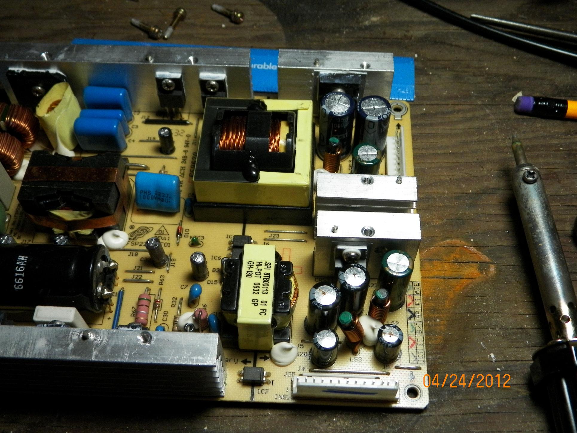

                      Have you put the new caps in with the correct polarity.
                      I only changed the caps. I will research how to test the fuses and to check the lead by doing a search tonight. I do own a multimeter but it can't check capacitance.
                      The new caps do have correct polarity, I marked the board and in addition the cap outline emphasized negative.
                      Here are the pictures of the old caps, I didn't take pictures of the replaced new caps.
                        Re: Fixed a ViewSonic N3260w
                        Did you changed C33 for the 5V standby power suply section? It is a small cap.
                        You may also have bad Zener Diode and transistor as shown here:
                        http://s807.photobucket.com/albums/y...onic%20N3250W/
                        I can see 6 bad caps, but I am not cleared how many and location of the caps you have replaced.

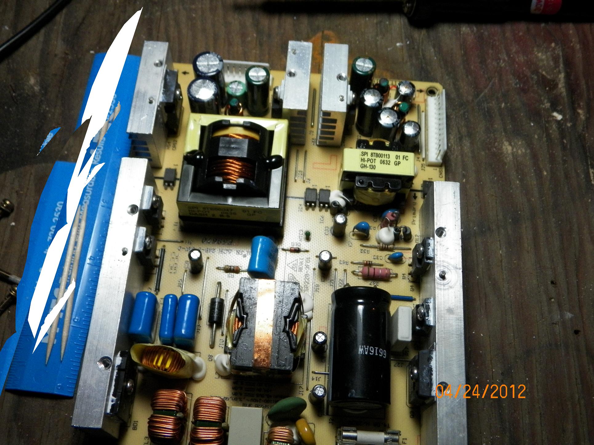

                          Only fuse I can see is a glass one at F1 near the end of the BIG cap.
                          Talking of which is the cap ok? it is in shadow but may be bulged?
                          To measure the fuse set multimeter on ohms (no power to board) and put one probe on each end. Result should be the same as touching the two probes together.
                          NEXT STEP
                          If the fuse is ok and your lead is ok next checkpoint is the leads on the BIG cap. This will involve HIGH voltage
                          around 170 volts so care is needed.
                          Set meter on 200 vDC and with the board powered on put the
                          red probe on the Positive leg of the Cap and the black
                          probe on the negative leg of the cap. The polarity is important.Positive leg is marked on the board.
                          When doing this take care not to touch the heatsinks or anything else for that matter.
                            Thanks selldoor & budm.
                            The photo gallery of the 3250 was VERY helpful.
                            I did not change the C33 capacitor... on closer inspection it does appear bulged but I didn't notice it before.
                            Also, to give credit where it's do, the blue buldged capacitor is Ost, the rest are CapXon.
                            I tested the transistors and sure enough the one next to the lead is bad. It's 12N50C3 and both before and after I removed it (so much easier to test when it's off the board) I got no reading even when reversing positive/negative to make sure.
                            At the very beginning of this project, when I first pulled off the back of the TV I immediately noticed the bad caps, and after I went online and saw a couple of articles about fixing tv's by simply replacing the caps for a few dollars I was sold. Now in hindsight, I remember reading TV's with bad caps would often give some kind of life (turn on and then off, or the dreaded blinking red lights) and this has none.
                            I'm hoping a new transistor gets it to fire up, otherwise I'll be changing C33 and see if there is anything else to test before dumping or getting rid of it.
                            The fuse tested ok.
                            After this post I'm going to search out that specific transistor here and elsewhere to see if others had success in getting a TV on after replacing it. Good thing I still have a tube of Artic Silver.
                            Attached highlights the caps I replaced.
                            Last edited by stanleybaxter; 04-28-2012, 04:13 AM. Reason: Clarification because of poor proof reading.
