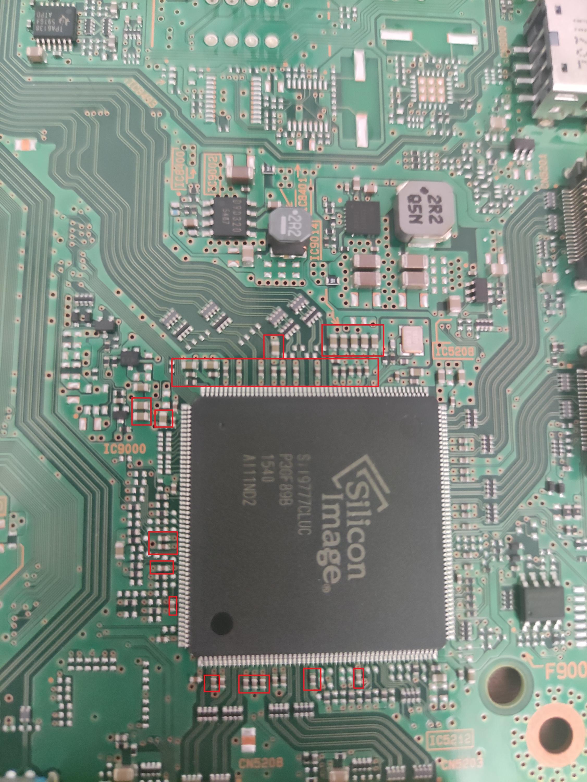

    Hi guys,
    This android TV show up the Sony the logo, than black picture, not turn off, but also no reaction for remote or buttons. First suspected a corrupted FW, but found some short around the hdmi IC.
    With upgrade drive show the update pictogram for few min's, after Sony logo again and black pic. The picture below show the short's and found a datasheet from the IC.
    I would be grateful for any help

    Re: Sony KD65X85005C, no boot, hdmi IC suspected
    What do you measure exact? I suspect you are measuring a very low resistance but that doesn't mean it's not good because you're measuring in the circuit.
    I think you better take a look at the EMMC, these models are known for EMMC problems.
      Didn't found any schematic to check, measured around 30, the neighbours 3-400. I know the EMMC by these models, but how can i check if corrupted?
        copy the content off the EMMC and save it. FF the EMMC and do a blank check. If the blank check is o.k. it should be all right. Copy the content back to the EMMC and off you go.
          If that ic is shorted it would likely be getting HOT. Check the area for heat.
            You can't check that, the EMMC in this model is a Hynix and I've seen a lot of those which I wanted to reprogramme , after the EMMC was programmed I got a message that the EMMC has reached it's "End of Life"
              Thx, i checked, can't say it is hot but definitely warm.
              I ordered a new Hynix nand. Need to dump the old, or just replace the nand with empty new and insert a Sony FW loader from usb?
                [QUOTE=Formaster;1060936
                I ordered a new Hynix nand. Need to dump the old, or just replace the nand with empty new and insert a Sony FW loader from usb?[/QUOTE]
                The old software is useless, you need to get working software , an empty EMMC will never work. The firmware you can find at the Sony website is not the same and will not work either.
                  measured around 30
                  30 what? Gallons? Always put measure units..
                  i guess software problem , repairable until the operator can break protection mechanisms, a good hacker is suitable.., i don't know the final bill how much, mabye better find repl. board...
                    Today arrived my hot air gun, removed the chipset and the short is gone around. Ordered a new one just in case, hope only that caused the problem.
                    I know these modells know as ROM problem, but nearly always with boot loop. My shows only the Sony logo, after no picture and hope it was this caused.
                    Here is the pins of the processor on Page 40. Can be tested pins for short?

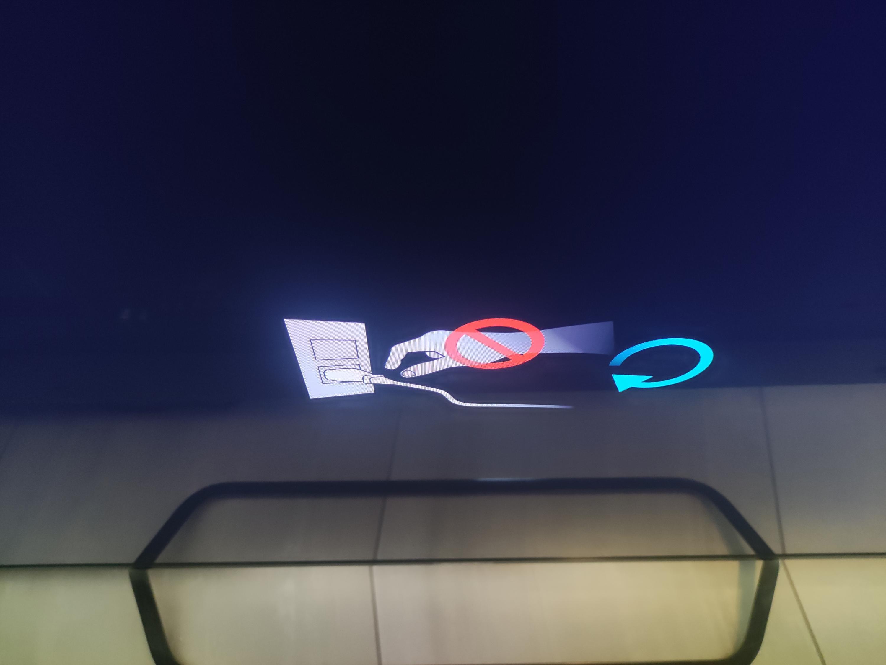

                                        Originally posted by Davi.p
                                        But.. if you trust me, this is a software issue and with these Sony i don't know the exact procedure to fix it, maybe you can start a search in the forum for a succesful reload by a simple usb key, not the hard way with expensive eprom programmers.. The way i prefer is by linux shell but if them are commonly shell protected i'm not a linux guru...
                                        For instance here is Android but shell is unix similar, if you want at least see the log you must own a low volt serial port adqpter, like the ones in RT809 / CH341A programmers
                                        Thanks! First the USB recovery method found it, show the picture in attachment, run it few minutes, than 2 times show the Sony logo and nothing, but won't turn off itself .
                                        For lucky i have one of this serial port adapter. Any suggest how to connect? I would like to thank you.
