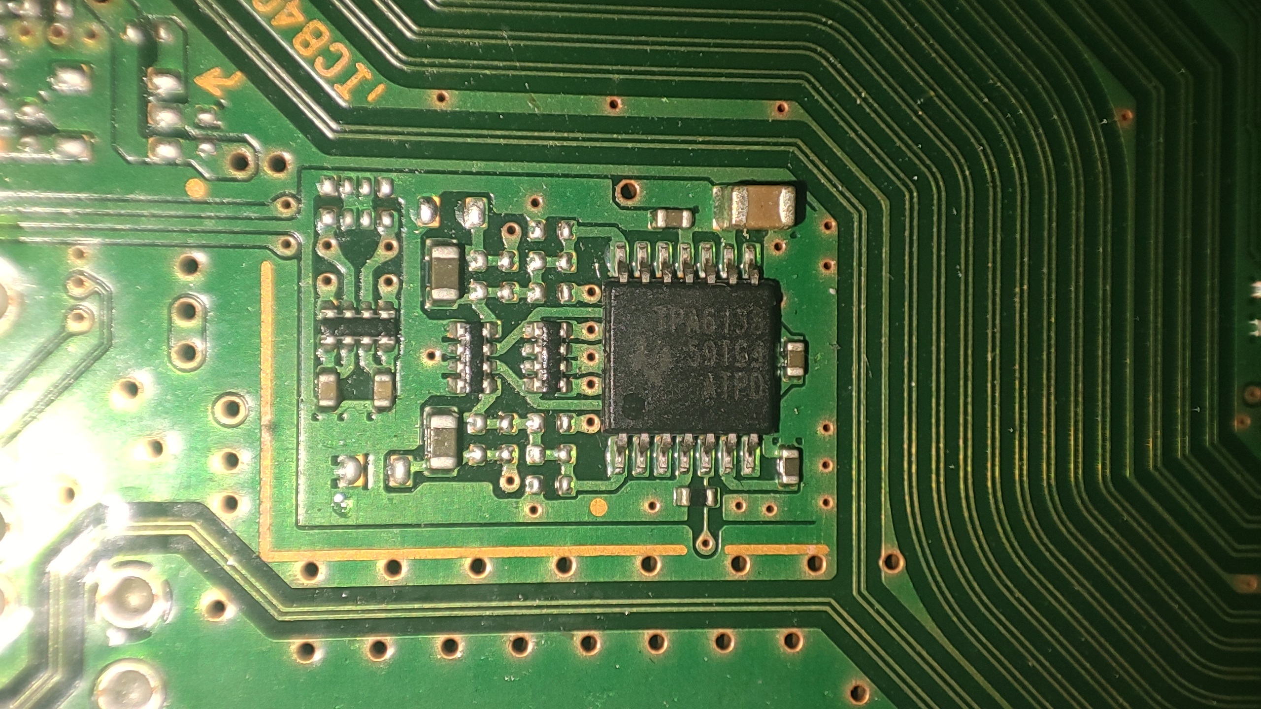

    Re: Sony KD65X85005C, no boot, hdmi IC suspected
    Just this found with 14 pins.

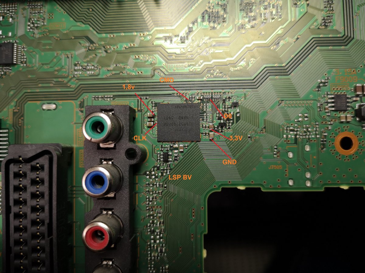

      #42
      I got an info, of Sony TV's default disabled UART log. There is only way to check the emmc via JTAG or expensive bga emmc reader.
      Is there any possibility to do a JTAG via ch341a adaptor? Points show below.
      • Davi.p
        Hobbist Tech
        • Sep 2009
        • 4297
        • Italy - Milan
        #43
        you need RT809H or ohers
