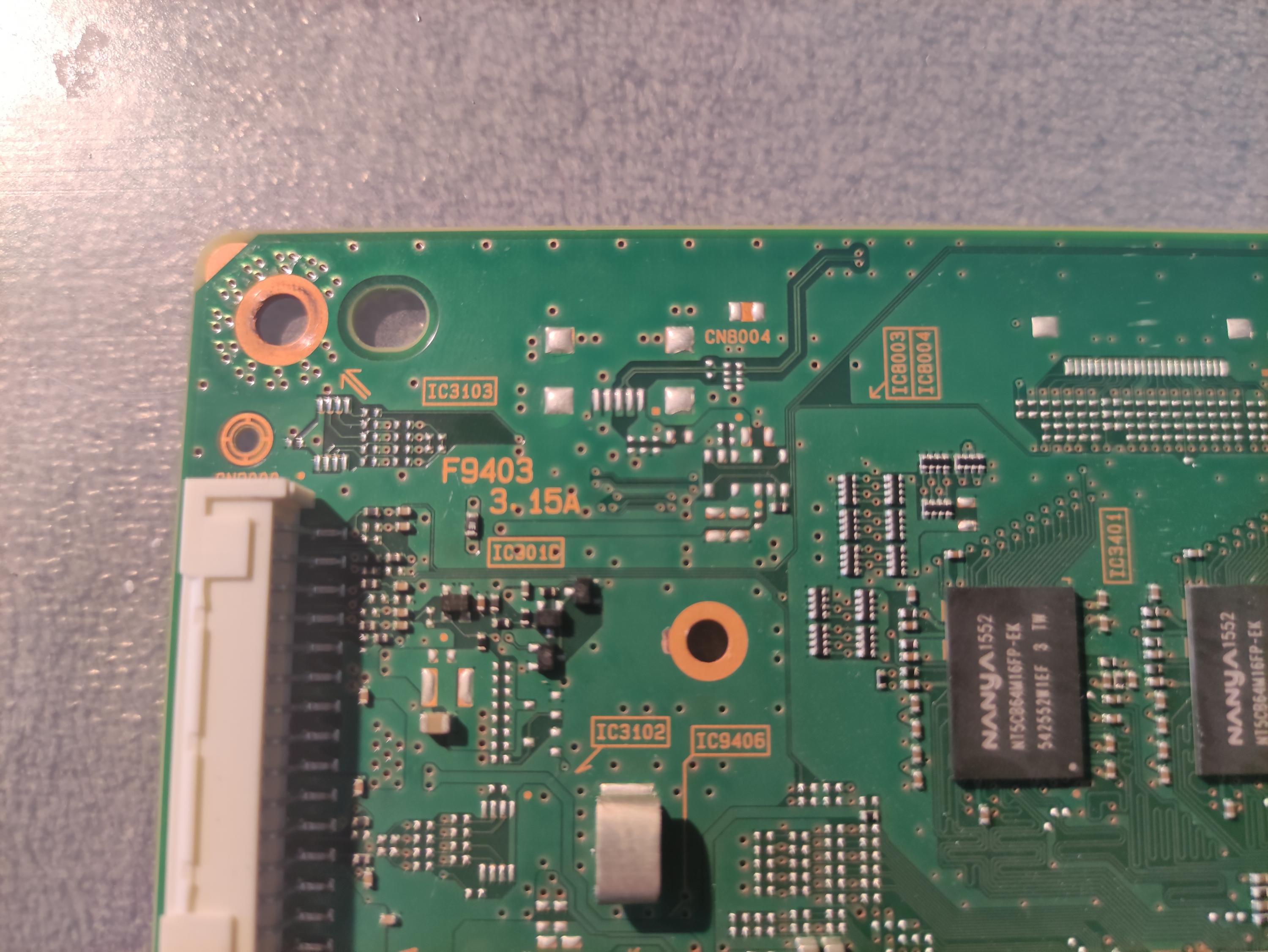

    In your second picture on the right bottom corner there is a 4 pins unpopulated connector, that is almost surely a serial port, make a picture of that area only, but anyway 1 pin is gnd, at the side, the other side is 5v output, if your adapter doesn't need it dont connect it, the center 2 pins are tx , rx, you must probe at tv start which one has a tension, that is tx and must be connected to rx of adapter. Then set the port at 112500 and open terminal in pc, start tv and watch characters come in, if them are readable, speed is ok if not change speed to a lower. Found the log , turn off tv, set the terminal to record the text, start tv again until it stops sending, then close the file , turn off and upload here the txt file.

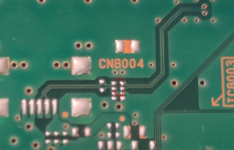

      Did you mean these 4? Just for sure i have that programmer below. Hope its ok.

        Yes CN8004, pins are 5 but 2 are gnd. The programmer is ok, must be know how to set in serial mode, yellow jumper go to pins 2-3 i think.

          yes, 2-3 is TTL serial. Tomorrow will check it... Big reputation, thank you

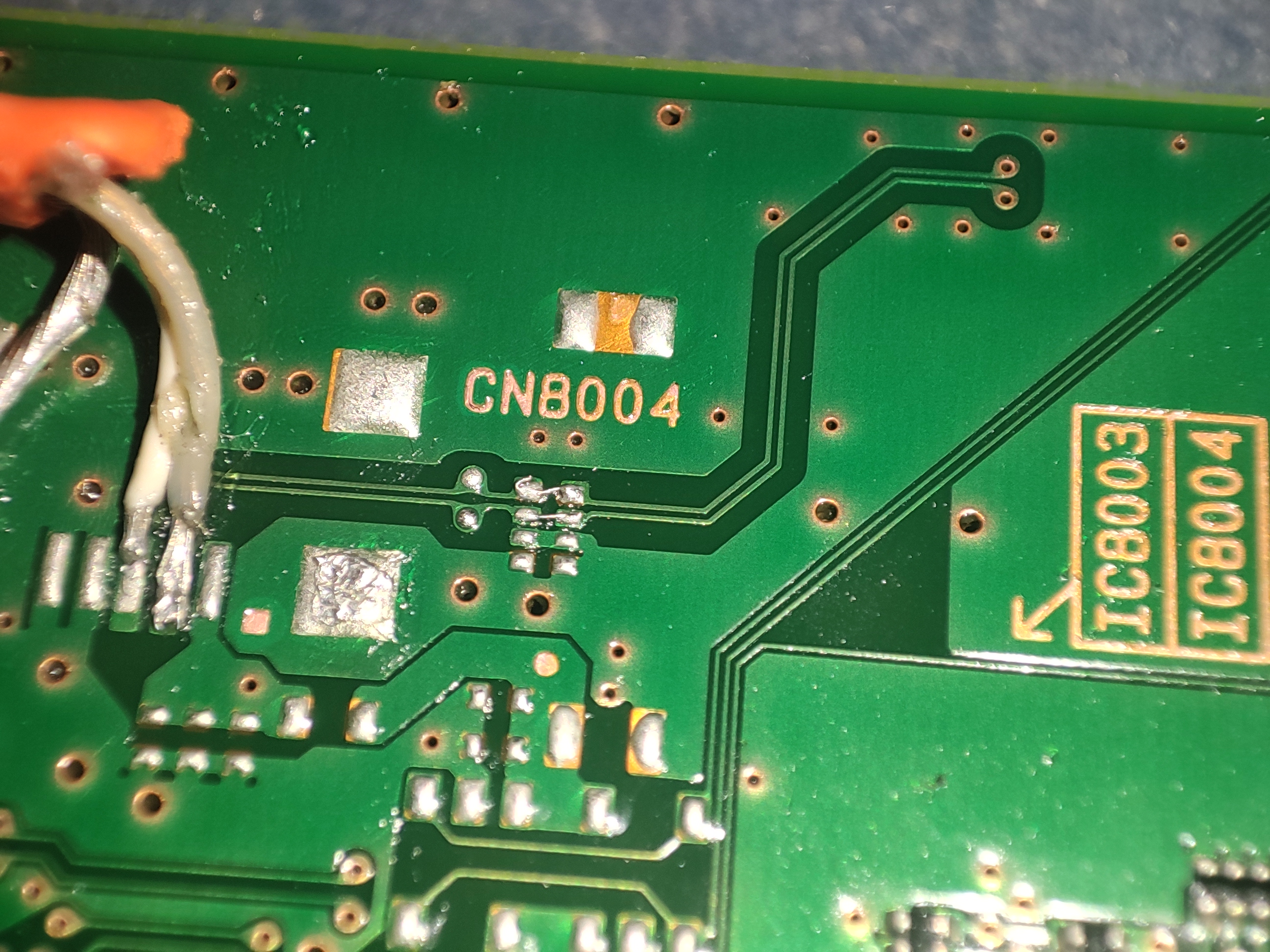

                You need to install zero resistances or jumpers.

                  been unlucky, maybe debugging must be turn on via service menu. Soldered jumpers between, after double checked the curcuits, but no voltage on both.

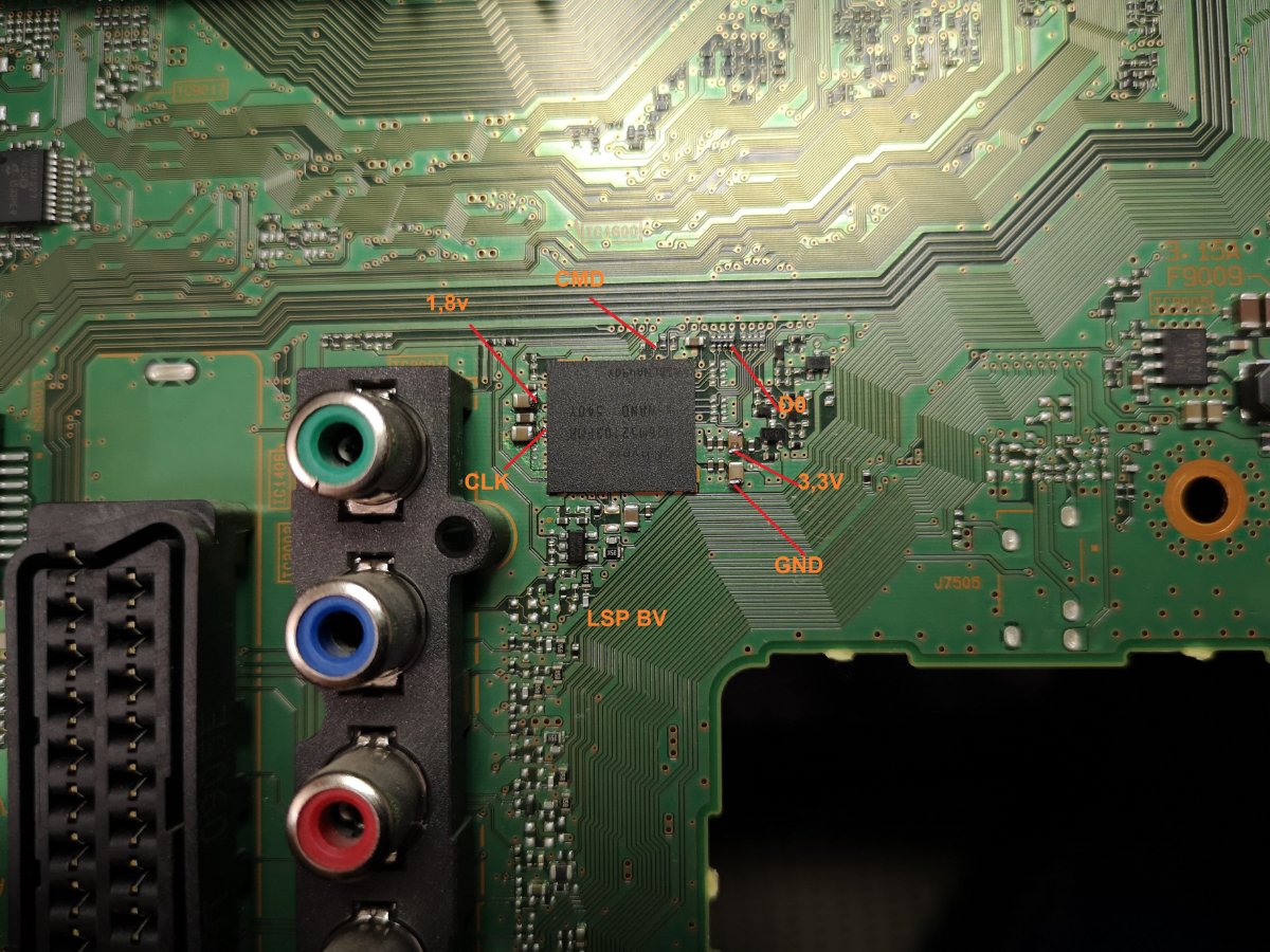

                  Other way to check the nand is JTAG, while don't want to buy an expensive emmc reader. I just found this tutorial, but on the programmer what i have, it has no CMD, LSP BV and D0 pins. Am i wrong?
                  Here is the JTAG points down below

                    It's not NAND, you have an EMMC.

                      Can you show us a photo of the jumpers?

                        Curcuits ok and pins not shorted.

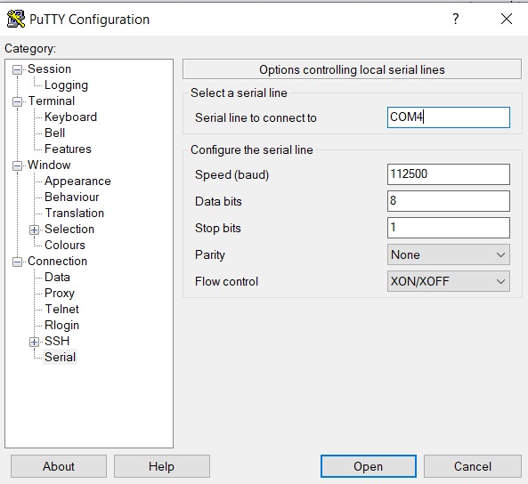

                          Forgot to tell that must be connect tx, rx, and gnd .. is it so for you?

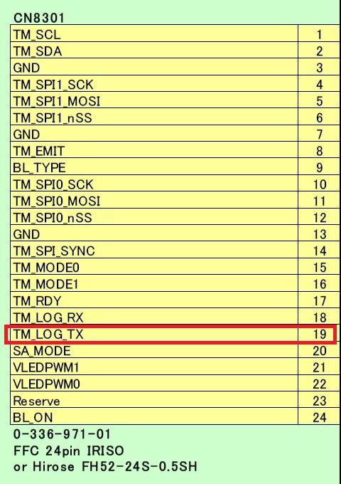

                              Guys we are wrong, found a schematics. Thats a blind miniUSB port. Under the link is the schematics from site 184-187 if somebody else need it. I will chech it.
                              link: https://drive.google.com/file/d/1slO...R0EuDrVdQ/view
                              need to be downloaded and you can able to zoom in normal PDF viewers.

                                Try Cn8301 pins 18,19+gnd

                                  did'nt success... Soldered the MB tx to programmer rx, but no data. Checked few rates also and curcuits are ok. putty correct so?

                                    18 need it too? I thought MB RX is to receive data's.

                                      seems all correct... try swap 18-19

                                        swapped, also on the adapter side, did nothing where i'm wrong ...
