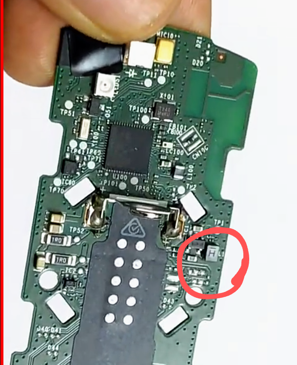

    Can Anyone Identify the Value of This Component ?
    Filter at L1 appears marked with the letter H anyone know what that means ? From an Amazon Fire stick remote control. The remote was burning through batteries at an alarming rate I may have popped the filter on disassembly don't know. Also missing a small resistor above it with unknown value but first things first ...

    Lx is normally the suffix for an inductor.

      Re: Can Anyone Identify the Value of This Component ?
      Okay what is the value of an inductor marked with the letter H ?
        No idea. I suspect a search of the internet may come up wiith an answer. Have you a suitable meter to measure it's inductance?
        Can you post a clearer close shot of the smd device. I see several smd fuses online with H on the package
          Agreed the picture is way too small.
            Share the markings of the smd ic next to this inductor.
            It appears to be a local buck switching regulator. The ic could help to identify the value for this part.
              As stated in the first post I do not have the inductor it is missing on my board. The pic is a frame from a youtube video.
                Yes this is a good idea though I will say I've looked it up and found nothing but if you can please let me know.
                Marking is 4FN5R
                  Is it the sot23-5 next to the inductor? My first guess is a Torex XC9140A
                    It’s quit likely not that critical but given the relative indicated size, (determined by wire size used to make the inductor and the designed current anticipated) replacement could be
                    2-3 μh SMT like a TDK SPM3010-LR or a TMS252012ALM depending on the actual dimension of the pads which were not provided.
                      I've replaced the inductor with one of appropriate size and hopefully value (no marking) harvested from an old iphone board. Now, I am missing a resistor going to the chip enable pin which must be high to be active. The 3v supply is there. I think the resistor is for current limiting ? What value is suggested for the resistor ?
                        33 ohms ? 100 ohms ? Is the value critical for this circuit ?
