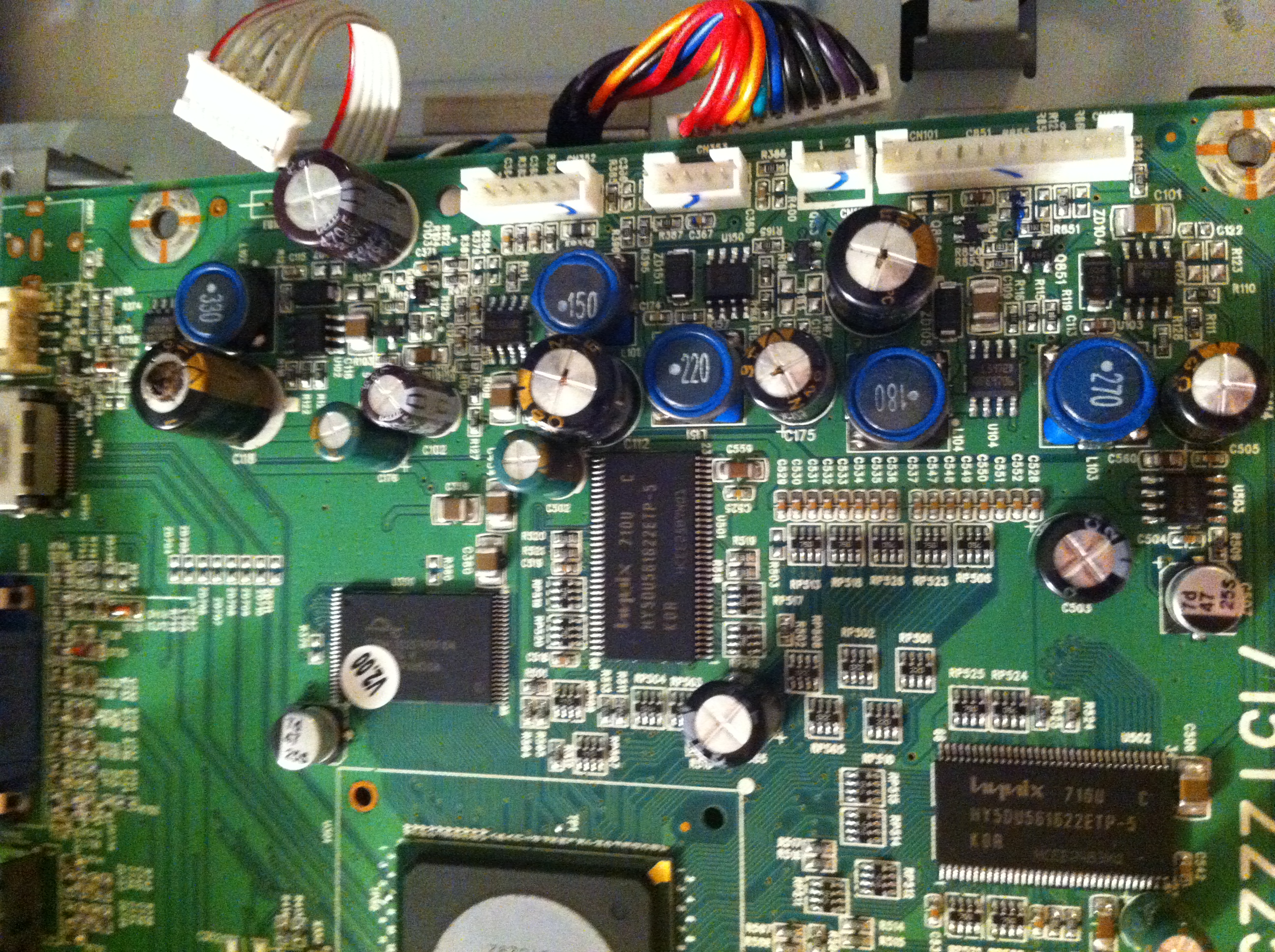

                          Originally posted by margo t
                          Thanks for the support!
                          Also, I found that there is a removable panel that makes this more accessible - that will make it MUCH easier. Posting a pic for other dummies like me!
                          Gently but firmly just pull it off.
                          Thanks for this Photo Margo I was able to finally know where some of the four pin cables orders need it to b at.
                          Now I turned it on and Power button lights up but just a plain Black Screen. Should I hook it up to a cable Box to see if it works.?
                          Or maybe is a just a big fail on my behalf.

                                Ok i am compleatly new to this and i need to replace the caps on my board. When i go to order the Caps i am at a loss for what ones to order. I was hoping i could get some help....It does seem like i need all of the ones from the first post. Any help would be appreciated

                                  Re: Magnavox 19md357b REPAIRED!!!
                                  You could either take the list from the original post to an electronics part store or use that list to buy from badcaps.net or digikey. It's pretty straight forward.
                                    You should really list the caps you have on your board to make sure you have the same values. You should buy panasonic FM or FCs to replace.
                                    NOTE - if you use the list there is an amendment to the first item.
                                      Well..I know it's been a while but I FINALLY got around to replacing some of the caps. Replaced 3 of the 1000uF 10v caps and the tv works fine...mostly. I've decided to completely refurb the tv to sell on ebay. As of right now the volume + button doesn't work but all of the other top buttons work. The dvd also plays fine but none of the buttons work for it. I had to dismantle the drive to retrieve the dvd. Will not eject or anything. I don't have an esr meter to test the caps but could one or more of the caps be the culprit?
                                        Well...I decided to just replace all the capxon caps. Gotta wait for my 330's to arrive...I was out of stock on them. There's one other problem I forgot to mention. When trying to turn off the tv, it goes off for about 2 or 3 seconds and then turns itself back on. Any way to remedy this (without using my sledge hammer, lol)?
