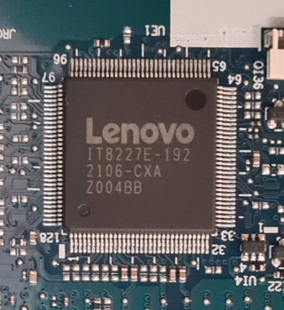

    hi
    i bought a defective legion, tested it had the IT8227E-192 CXA shorted.
    I ordered on aliexpress, carefully changed it under microscope, and now when i plug the dc in, keyboard flashes in all colors in loop, on button is white, and nothing more
    The battery led is charging, it seems is the only thing that works
    Screen is off, nothing, not even the backlight
    could it be a non programmed IT8227E ?
    Awaiting for your feedback
    Thank You

      if the chip you replaced is programmable, surely it needs reprogramming, but about the soldering job are you expert enough to say it is right? How is the package? Qfn? bye
      • reformatt
        • Feb 2020
        • 1505
        Unless your supplier specifically programmed it for the model you are replacing it on, it will be blank. You need to program it with a SVOD or similar via the keyboard connector (or 128 pin ZIF socket prior to installing). Some Lenovo's have a split EC and KB design, and require programming via JTAG connector. Depends on the motherboard, which you didn't specify.
        EC failure on these laptops is usually due to a broken DC input jack sending 19V down the ADAPTOR_ID line directly to the EC. So you need to make sure this is ok first, otherwise you destroy your new EC

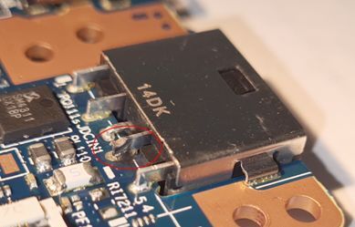

              I think you can be right, i found previous owner or technician made a short on one of the DC pins (see pic) to somewhere else, probably to ADAPTOR_ID as you said ; i tested the line and it seems ok now, i checked with the thermal camera, no visible hot spots as previously with the IC shorted

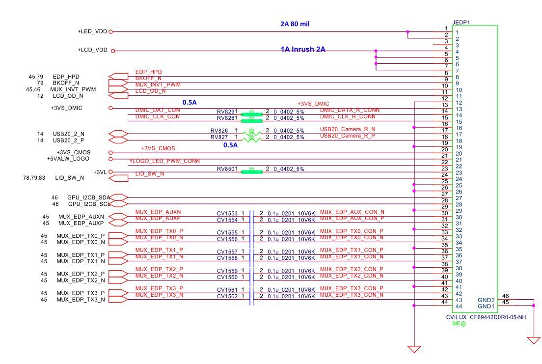

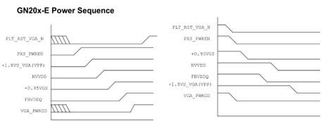

                  Lets' say that now this is the situation
                  1 - found EC shorted, changed with one bought on aliexpress i paid for programmed, no more short, now the keyboard is on (i can set the KB led color and the power button is white, fans spins)
                  2 - checked every voltage present on the board, all is present and in expected values ; CPU and GPU warms up
                  3 - No signal on LCD, not even backlight works, i tested all the pins with multimeter in order to find stange impedances, but found none
                  4 - i also bought a new bios chip and chenged it but issue remains
                  5 - i checked also the startup voltages based on the timing (see picture) and nothing wrong to me
                  6 - The only strange thing is that the display has the +led_vdd and its 20V as expected, but +lcd_vdd is impulsive (see oscillograms)-> i followed up to the CPU_ENVDD from the CPU and that is pulsed too; even the logo on the cover is off

                      In one Lenovo I fixed, the EC didn't completely die, just partly shorted. All power rails fired up but wouldn't boot. The plastic in the middle of the DC jack had broken and the adaptor id and 20V pins were just floating in mid air. I had replaced the DC jack only to get a no POST lappie. I replaced the EC because the laptop consumed 80ma in the power off state and the thermal spot was a small section of the EC (where the ADAPTOR_ID connects). I could still dump the programming too with my SVOD despite the damage.
                      If that all checks out, it will be bad balls under the CPU probably. Lenovo solder is shit.

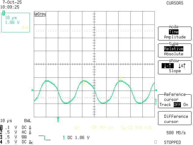

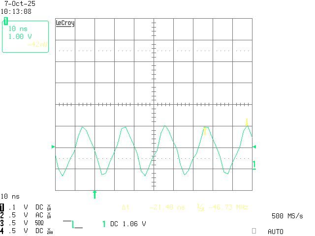

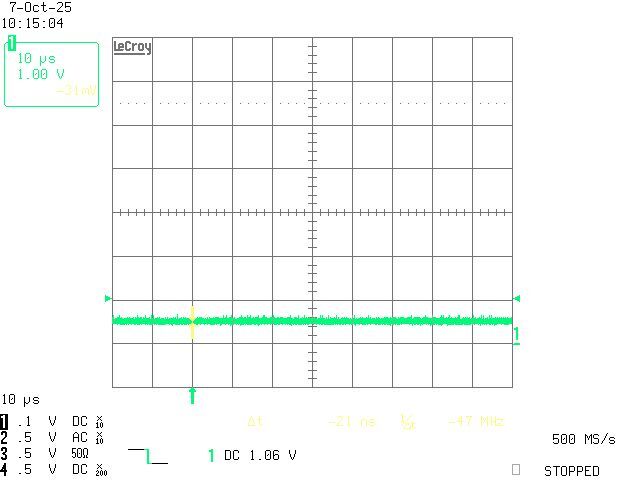

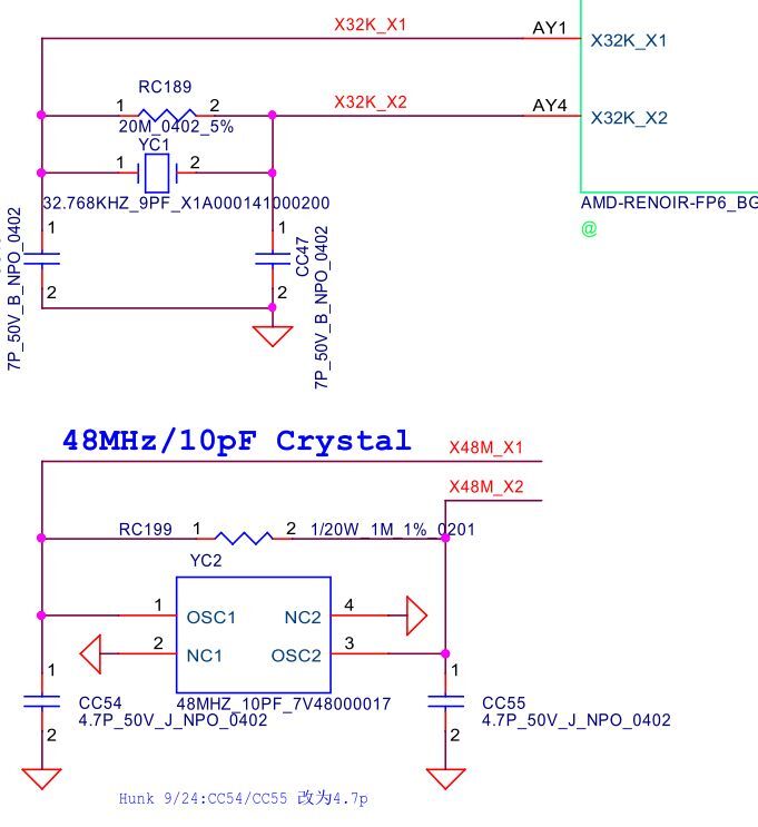

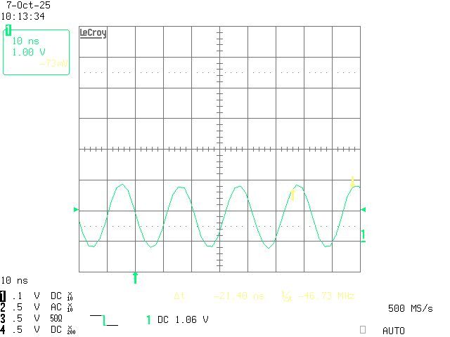

                        i checked the 2 oscillator
                        X32K_X1 -> 0,5V dc
                        X32K_X2 -> sinus 1Vpk (see pics) @32khz
                        X48M_X1 -> sinus 1Vpk (see pics) @48Mhz
                        X48M_X2 -> sinus 1Vpk (see pics) @48Mhz
                        on X32K_X1 should be a sinus 1Vpk (see pics) @32khz ?
                          X32K_X1 -> 0,5V dc
                          If they're oscillating they're fine, voltage don't matter here.
                            but pin 1 of 32khz oscillator does not, it's a dc voltage, see the oscillograms, please it's a 0.5v continuous
                            • pappothar
                              • Apr 2023
                              • 31
                              • switzerland
                              ok maybe i'm influencing the pin with the probe...
                                Check on diode mode, you need value on both sides, around 800mV, if u have that and oscillation, you're fine.
                                • pappothar
                                  • Apr 2023
                                  • 31
                                  • switzerland
                                  tested with fluke 117 in diode mode, the 32khz cristal seems unconnected (dmm shows OL) , but it oscillates when the mobo is on ; the 48Mhz shows 1,1V on both pins (vs gnd)

                                    Listening what they say about cpu soldering, probably the bad pin of osc. is no more connected under the cpu, and so other pins maybe.. does this laptop had been stored faulty for long and maybe in moist basement?
