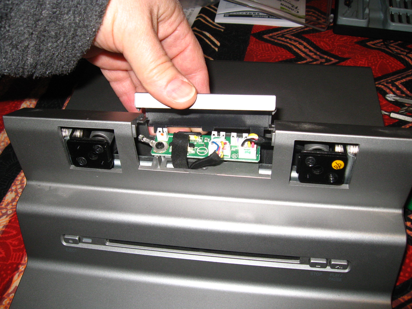

                                I know I should probably have more training and experience to try this but figure I have little to loose; the tv won't work and I'm not going to pay to have it fixed.
                                So -- I'm in the process of taking it apart and have the base unscrewed and the back of the monitor loose and I'm at the point where I need to detatch the small, delicate connections to the DVD player part. I can see how to detach them but how on earth am I ever going to get them reattached when it's time to put the whole thing together? It is such a small, tight space to work in.

                                  A photo - probably does not help ..

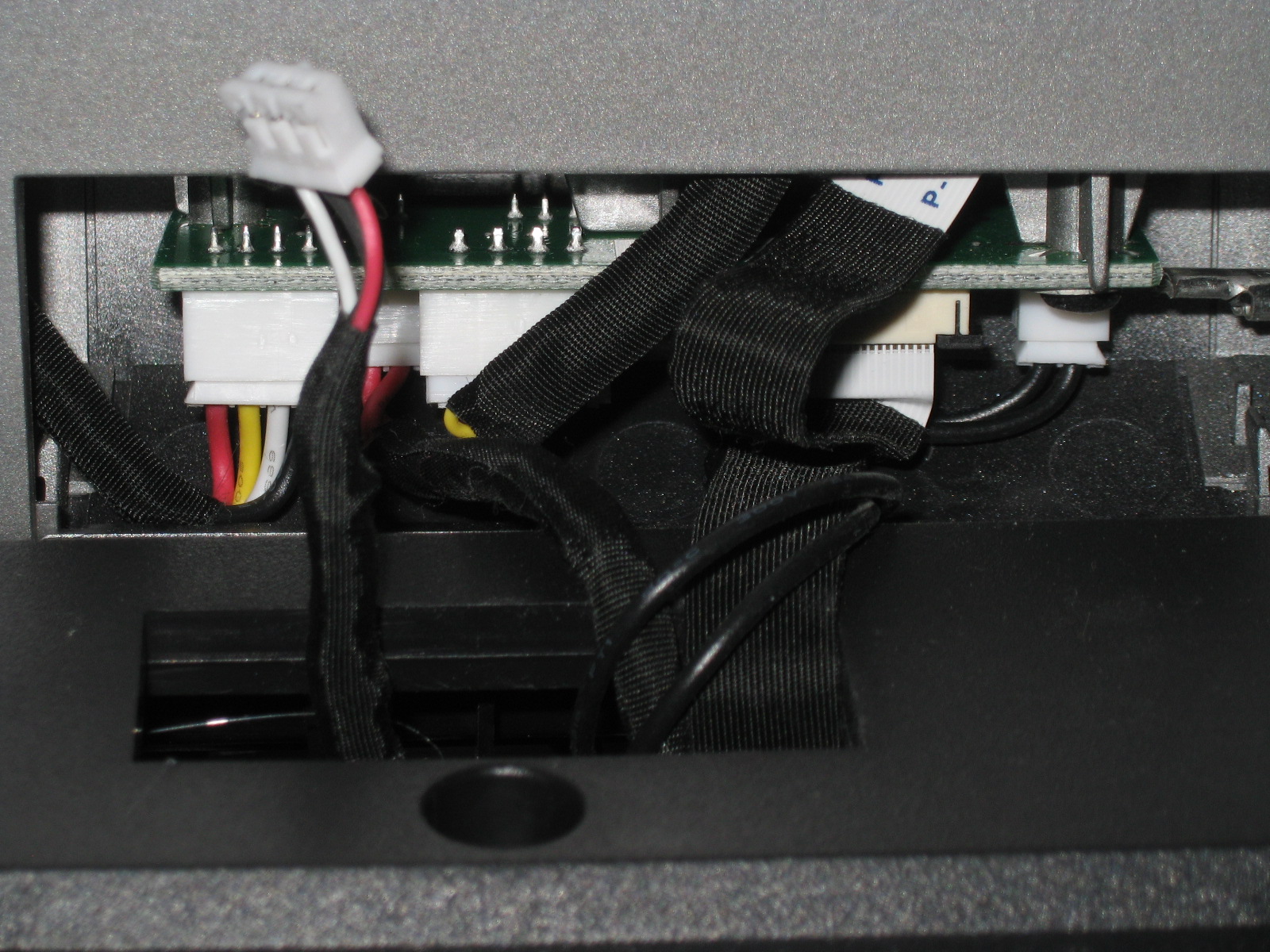

                                    They just slide out. Use needle nose pliers if you have them. If not, just give a little wiggle and out it comes.

                                      #38
                                      Re: Magnavox 19md357b REPAIRED!!!
                                      Thanks for the support!
                                      Also, I found that there is a removable panel that makes this more accessible - that will make it MUCH easier. Posting a pic for other dummies like me!
                                      Gently but firmly just pull it off.

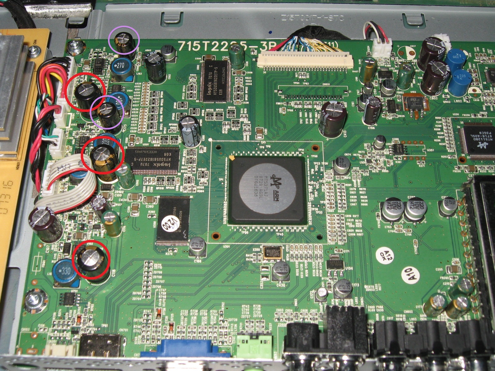

                                        Look, see the bad caps? I'm almost ready to begin the repair - yay!
                                          They look like Capxon brand? If yes, they make terrible caps and have a poor reputation for reliability.
