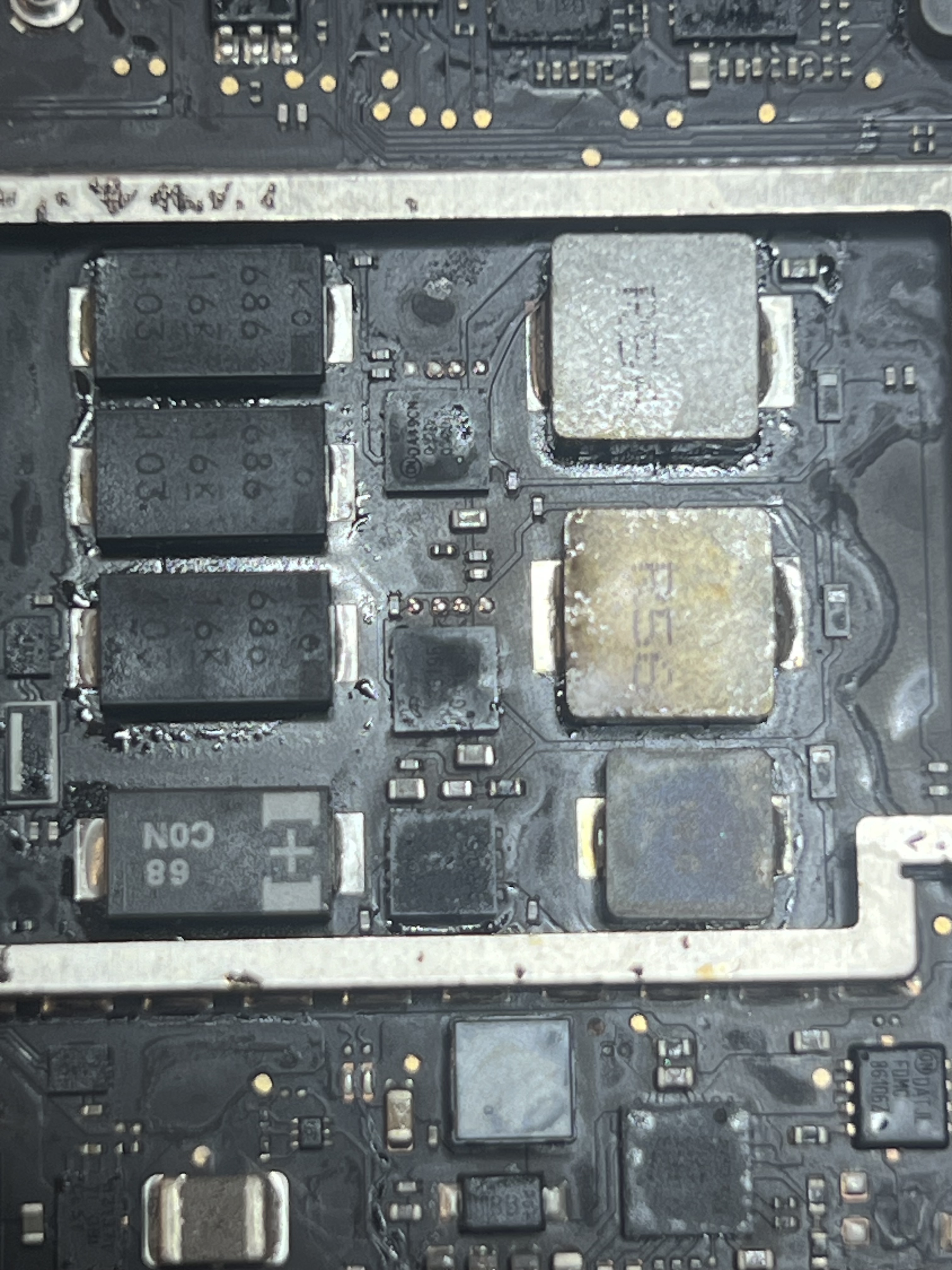

    Repaired a customers computer, had a faulty APL 1097 chip and replaced, all well, not shorted anymore, however I am finally getting 12.28Volts on PPBUS_AON, however it stays at 12.28 and doesn't increase to the normal 12.60 Volts. I read that this is the cause
    • If the voltage is approximately 12.28-12.35V, it may indicate a communication issue between the SOC and PMICs, or corrupt firmware.
    ​Can someone point to me what would be the next step to fix this. I can feel we are getting close to fixing this board, however this is a data recovery and we need to fix the computer to recover the data. Any advice would be great. This was a previous coffee spill board, thank god no pads are destroyed.

    Update found the issue.... another APL chip, but this time the APL 1096 chip is faulty and shorted to ground. UGHHHHHHHHH

      Update: Replaced the APL 1096 chip, that short was removed it seems the short went away but now I am seeing a short on two areas next to the APL 1096 chip. I'll send the picture of my issue from my thermal imager, I replaced these areas and the blown CAP next to it as well, but they keep shorting. I cannot seem to understand what is going on since the APL 1096 short was removed. APL 1097 short was repaired but my god. I am still stuck at 12.28Volts on PPBUS_AON. I know this is the cause. Can someone point me in the right direction, I feel I am getting closer to resolving this issue but my God lol
ID:	3224643 Click image for larger version

        Update: Replaced with a new APL 1096 IC chip, short is now gone. Now I do not have a short on the board but still no power. Still getting 12.28volts on ppbus_aon and 5volts .01 amps reading. Then it set itself to 5volts .28amps jumping continually to .39A and fluctuating. I am in awe lol
        FOUND ANOTHER short...lol this board is crazy...just got rid of that short. Now I'm stuck at 5volts .1 amp
