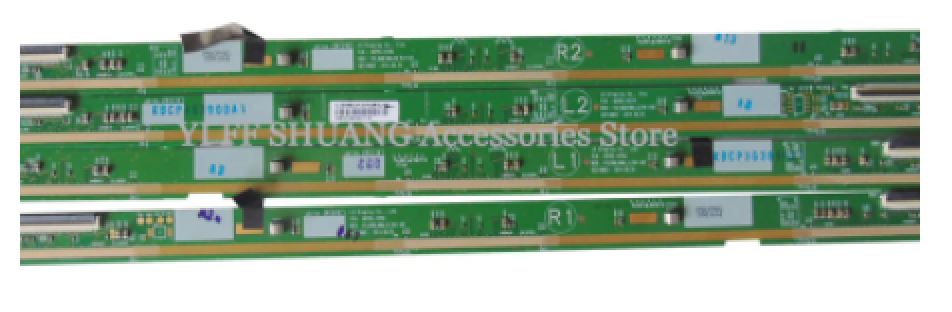

        maybe check first if both panels are the same by checking the white stickers, located somewhere on the tv back chassis.

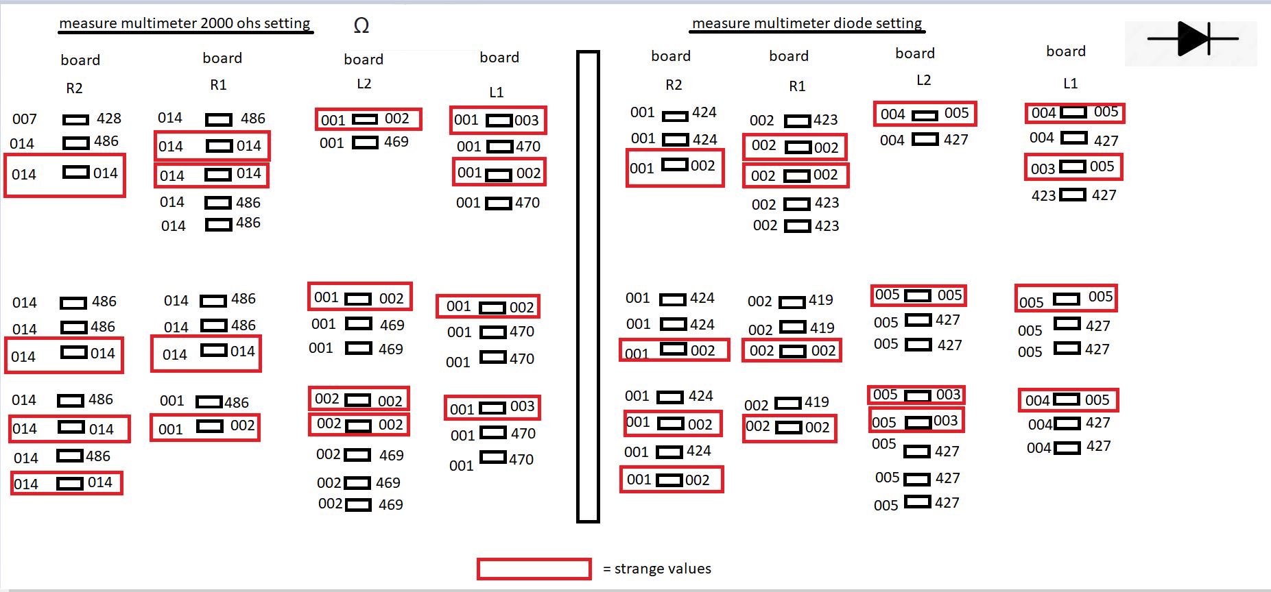

          you could also see if you get the same readings that you got in post #127, on the other "edge boards" of the broken screen tv.

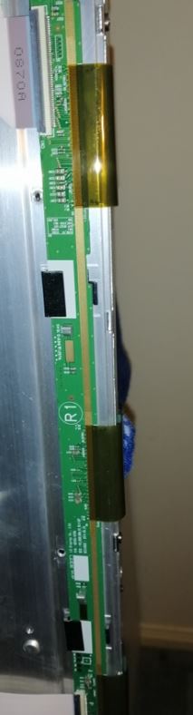

              I just took off the back of the broken screen one, and it has exactly the same part numbers. Everything works, albeit the internal screen is cactus.
              When you say "it may be a lesser evil to try putting the good screen on the broken screen tv", isn't the same problem going to exist on swap out, because the edge boards will still be faulty? The edge boards are not swappable, as they are bonded to the screen, as far as I know. I wish it were simple to just change the edge boards.

                  yes test the same way tv unplugged from power, ALL ohm checking is done unpowered, I would keep the tv with the broken screen edge boards unhooked from tcon, just in case the screen break might short something out on the good parts, don't forget to do the same test as in post #132, and go ahead and test them as you did in post #127, It might help narrow down the problem component. So the one test is in diode mode and the other is in ohm mode.

                          I have made up my own little diagram for both sets of edge boards, and will do the comparison readings now...albeit, I still wonder about the readings shifting everywhere from first putting the meter prongs on, reading that, and then they fluctuate.

                            Well, I was only able to get around today, to be able to do the comparison on my tv, of the edge board readings.
                            They were done by placing the black probe to the chassis, and the red probe tried to each side of the component.
                            I am yet to dismantle down to the edge boards on the broken screen one, and think it may be a waste, in that I cannot transfer those boards anyway. I am still stumped with the stupidity, that edge boards, which are probably one of the smaller boards on an lcd television, are irreplaceable, without owning a bonding machine.
                            It is all very frustrating.
                            When I disconnected the signal cables that run from the t-con board to the edge boards, no readings were gained at all. The only time readings occured were with all strips and boards connected.

                                      I have just undertaken the task you asked me to do, in checking my 4 boards in the way you told me to, and simply reported those as requested.
                                      I will try to dismantle the other one over the weekend and undertake the same tests again for comparison
