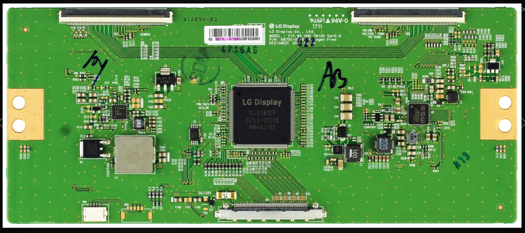

                  Lastly, the tcon board in Australia is here at this price
                  https://www.ebay.com.au/itm/254960031156
                  But I can get it at this much lower price from AliExpress
                  https://www.aliexpress.com/item/4000...archweb201603_
                  With my unprofessional eyes, I cannot see any difference between the original board, and the China one...all the numbers match up.
                  Is it worth trying a new T-Con board, or has what I have posted already, give any indications that my problem could be something else?

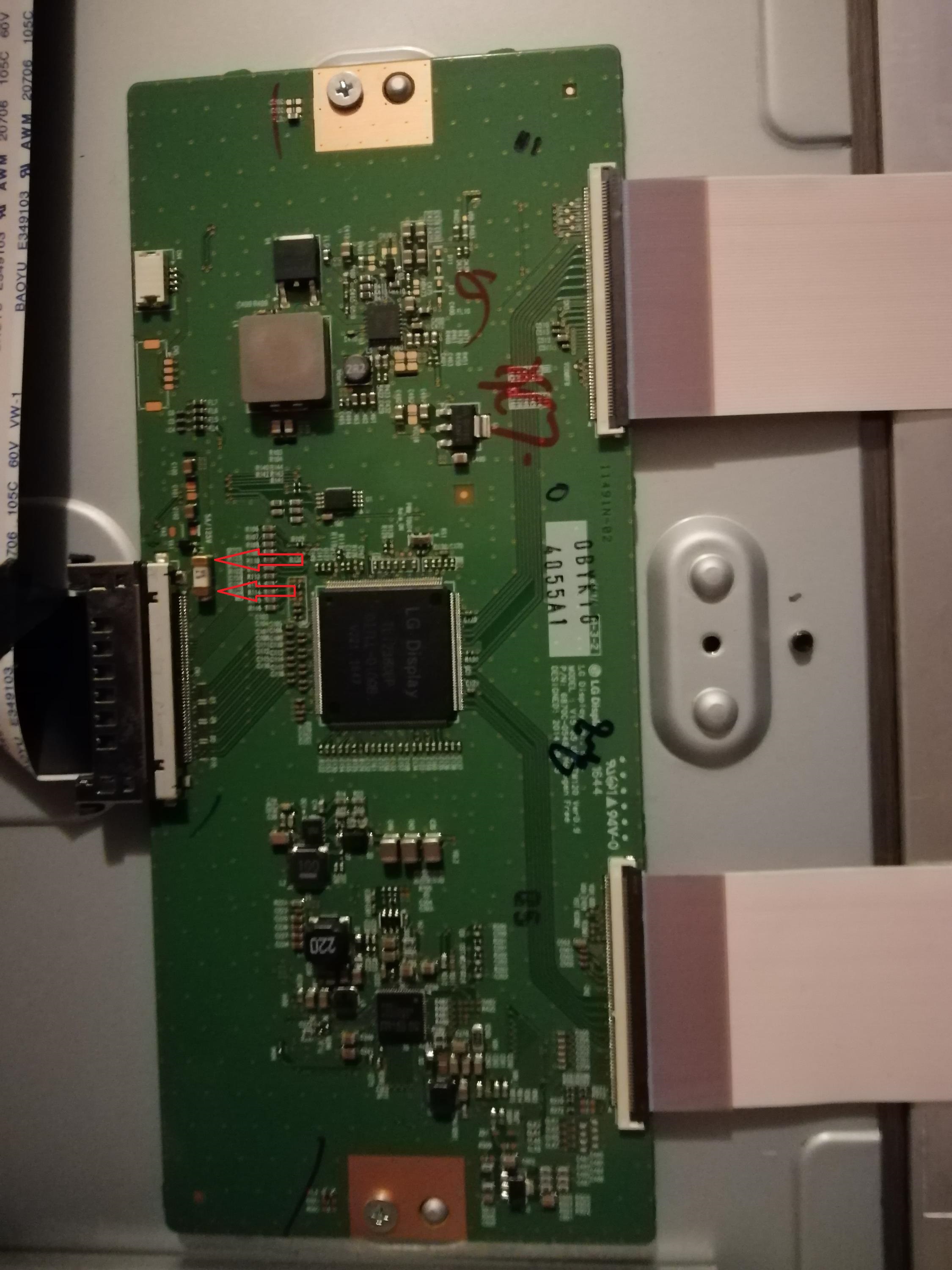

                    The pictures are not that good to do a miniscule comparison but they do look the same.
                    Have you checked that you have voltage on the tcon fuse both sides. It may be that the Tcon voltage is missing.
                    I would check that first before replacing the board.

                        better picture

                                Originally posted by viewerau
                                better picture
                                Better photo. Thanks
