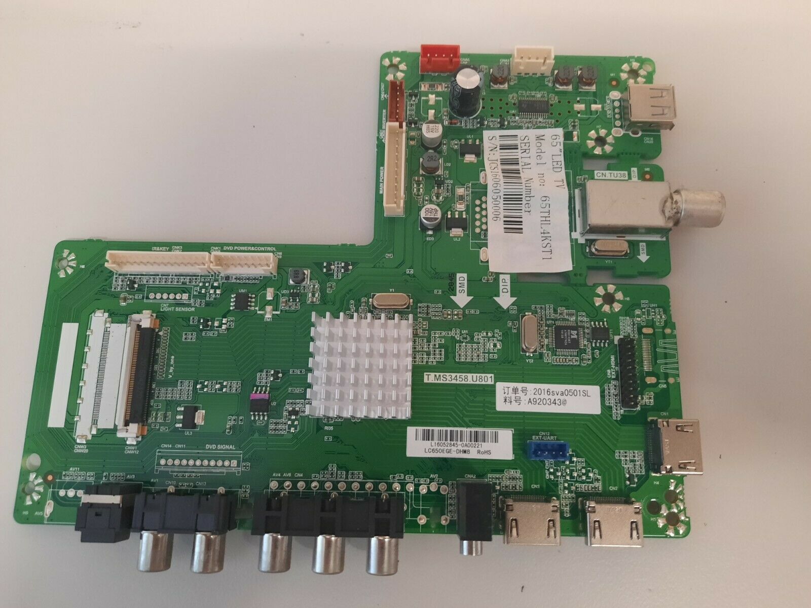

    My friend has this television.
    It stopped working, but still has power, but no image or sound.
    It was under warranty, and instead of fixing it, the company sent him a new one.
    The repair agent whom inspected the television reported that the fault was the main motherboards.
    My friend would like to buy the parts and get his old one working as well.
    I have looked online for spares, but note that this panel contains 2 x motherboards.
    One is a B.RK3288.3 LC550EGE-DHM4 and the other part of it is 20F2 Main Board - T.MS3458.U801
    Some pictures attached.
    Each part is AU$93 each.
    Is there any simple way to know which board is faulty, or is it a case of eenie meenie miny moe.

    Re: Thorn 65thl4kst1
    The little one is your wifi board, the other is the mainboard.
      Thanks...that seems a big wifi board, but so be it.
      Looks to me I may be best buying the one on the left with the rf/tuner, and hope for the best....

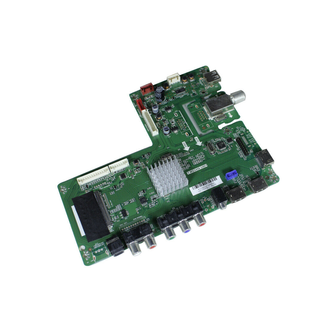

                      Hi...still awaiting this tv to look at.
                      I was searching for parts online, and noticed this:
                      This first photo is from a JVC T.MS3458.U801 Main-Board for U65CV-UMR ATVU65-0916 RTU6549-C 65UGX35 at a price of AU $53.99
                      https://www.ebay.com.au/itm/264935935927
                      The second photo is from a GENUINE THORN 65THL4KST1 20F2 Main Board - T.MS3458.U801 at a price of AU $90.35
                      https://www.ebay.com.au/itm/313240251503
                      Naturally the JVC board is the cheaper, but are the two mainboards the same, or could there be something on the main chip that makes each one either suit JVC only or Thorn only.
                      Could I be making a big mistake in buying the cheaper JVC one, rather than the more expensive genuine Thorn one, which is for a THorn TV?
                      Thank you.
                        The difference may be the LCD panel the mainboard is matched with.

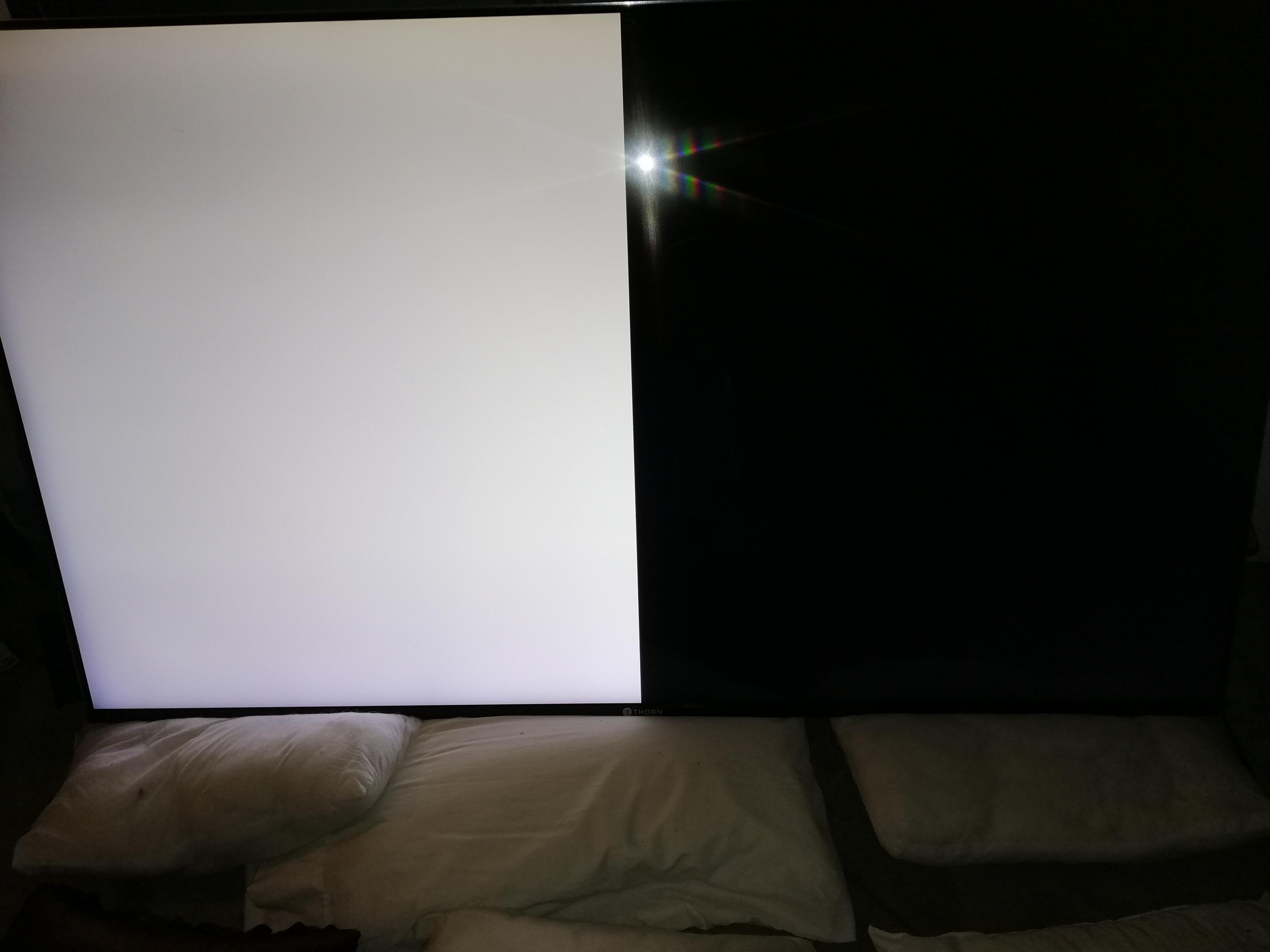

                            • viewerau
                              • May 2020
                              • 305

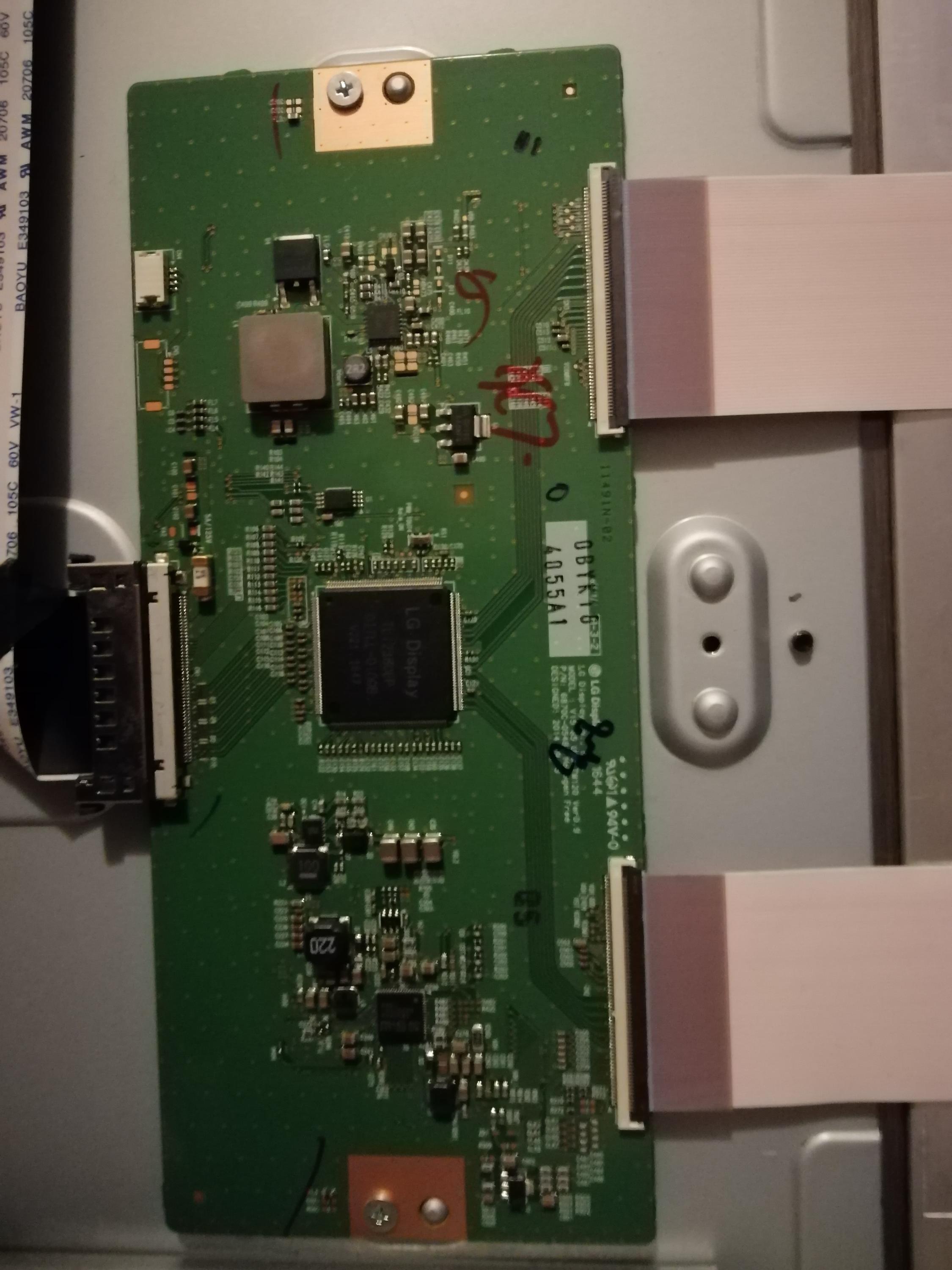

                              Ahhh...my bad luck...I put another motherboard in, but all remains the same.
                              TV powers to on, but the screen is just white...grrrr
                              On inspection of these boards, I also note that the T-Con board also has texta letters on it....would this indicate that this may have also been replaced at some time?
                              Signature:Seemingly hopeless tv fixer
                              • viewerau
                                • May 2020
                                • 305

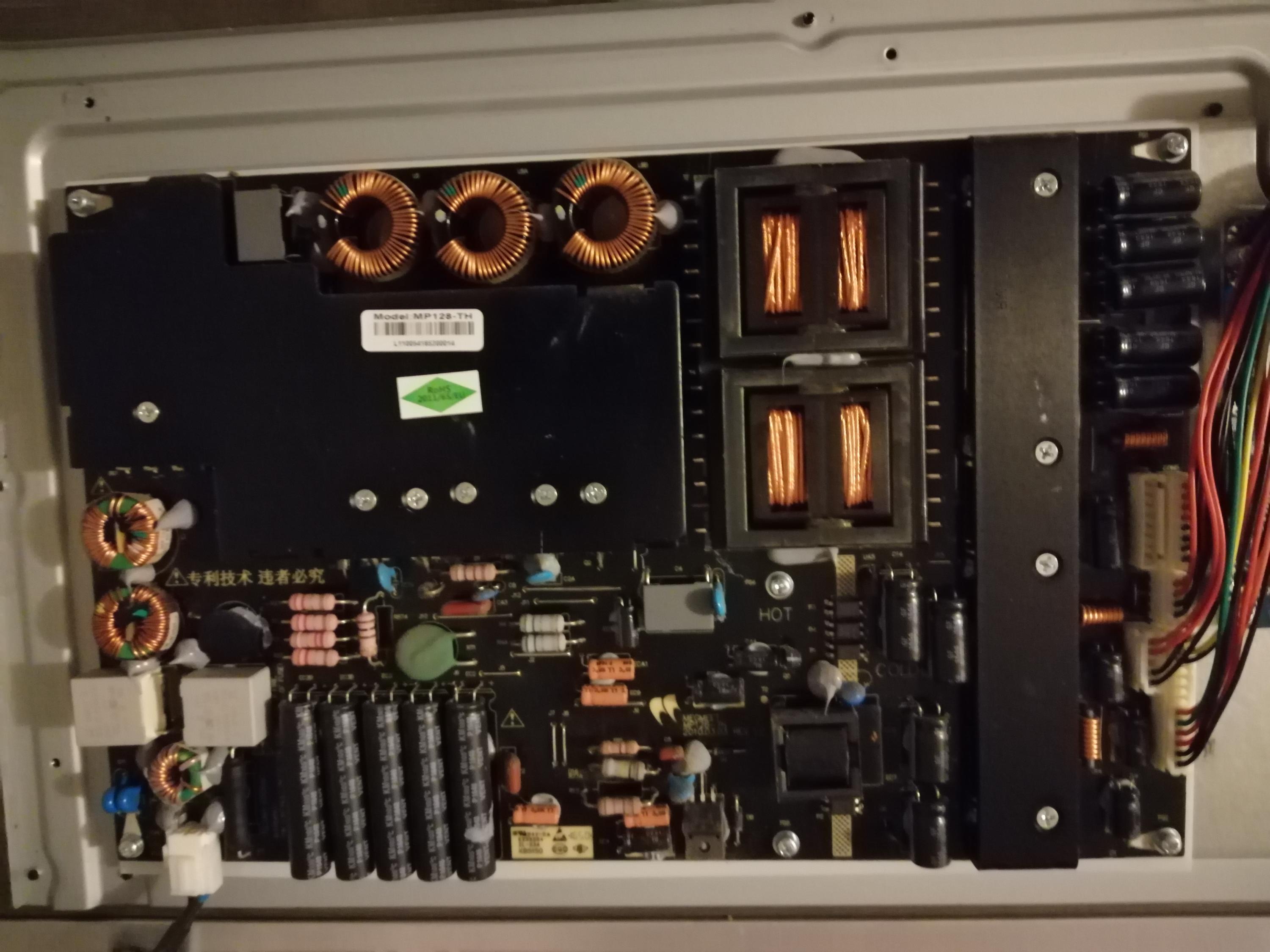

                                I have been advised, via a youtube search on ShopJimmy (https://www.youtube.com/watch?v=yTnkOfwBGGE ) that a way to check that my t-con board has power, is to check power on an ic for power on the drain, gate and source to determine?
                                On picture number 2, can anyone identify the component to check please?
                                Thank you
                                • dick_barton
                                  • Aug 2015
                                  • 6643
                                  • Wales
                                  "The screen is just white".....so the backlight is working.
                                  Disconnect one cable from the tcon to the panel and see if you have half a picture then reconnect and repeat for the other cable.

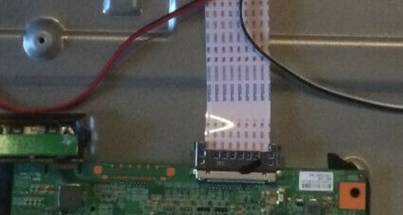

                                      • viewerau
                                        • May 2020
                                        • 305

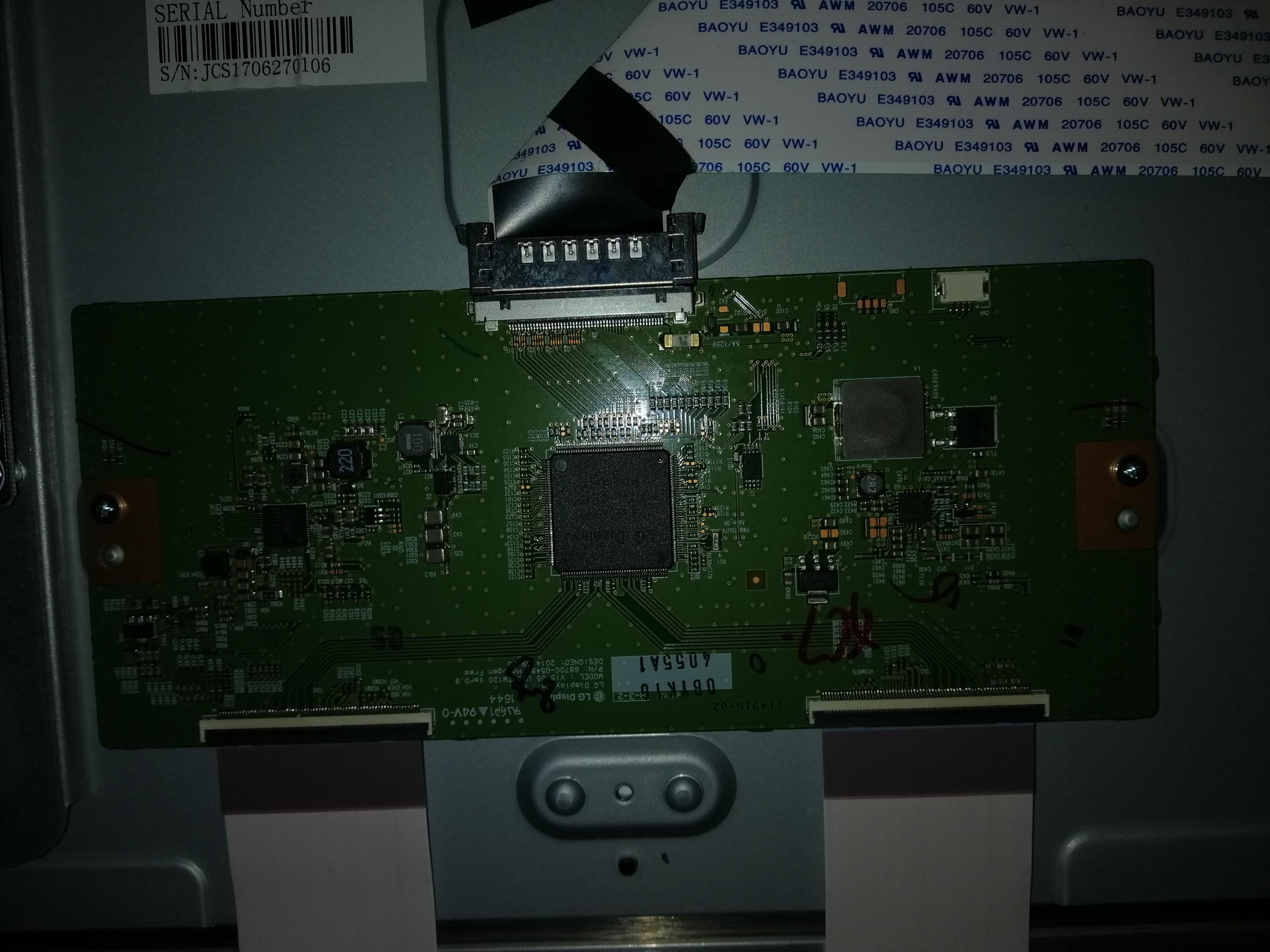

                                        Ok...
                                        I disconnected one tcon ribbon, and it all looked the same.
                                        I then reconnected that ribbon, and removed the other.
                                        This caused a change...one side illuminated bright white (left side) and the other side jet black.
                                        Does this help with any diagnosis please?
                                        Thank you.
                                        EDIT...
                                        I reseated all the cables, still no difference.
                                        I could not work out how to open, remove this ribbon...is there a special way so I can ensure it is seated correctly?
                                        Other picture shows with one ribbon connected.
