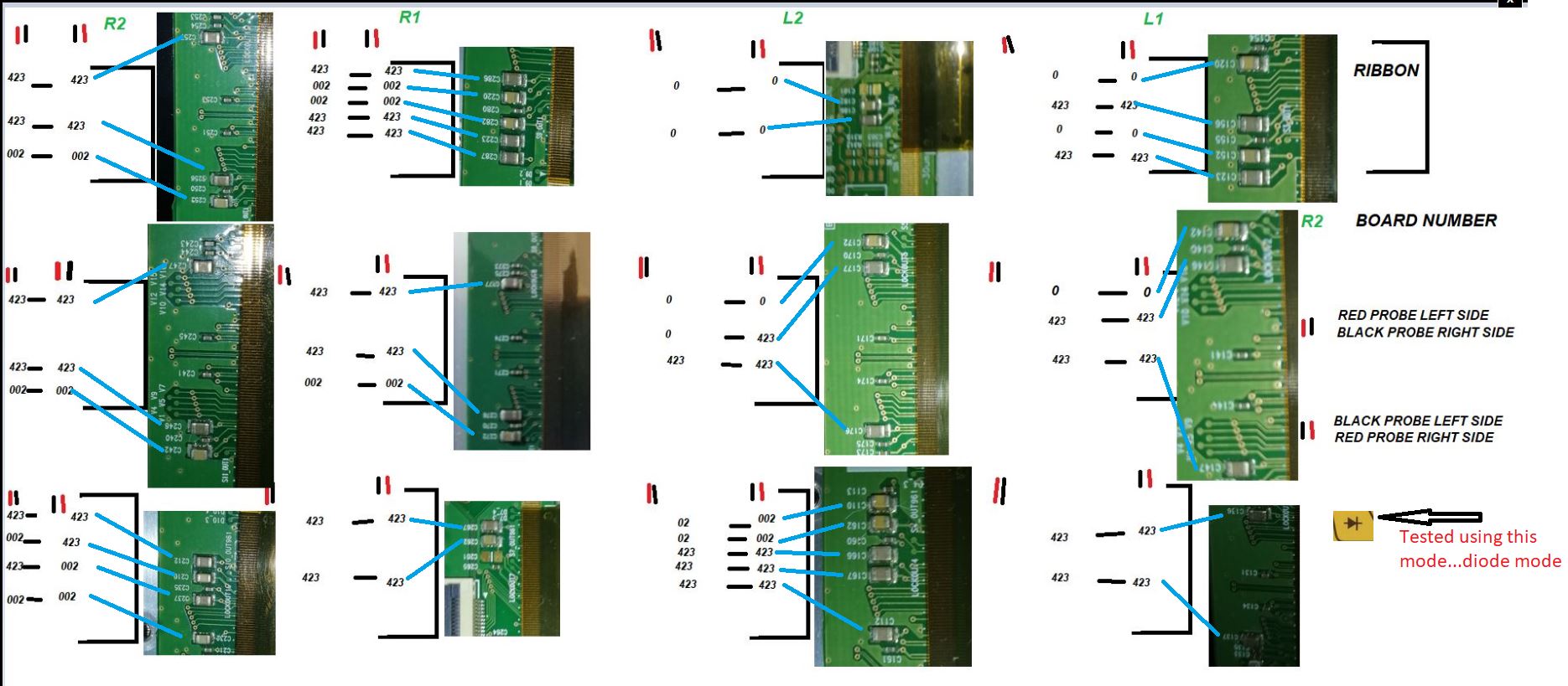

      THANKS,
      The 10th post on page. 6 shows the readings in continuity, giving a set of numbers according to how I put the probes on each end. I did this with all boards and strips attached as normal, but unplugged from the wall. My panel has 4 of those edge boards . Given nothing has changed, I think the values will be the same. Does this all mean, if I took out every board and replaced them, that it still would not work as one of the four edge boards would still be faulty.?

              Re: Thorn 65thl4kst1
              Thank you chaps...I do appreciate this additional help.
              In the daytime tomorrow (getting dark here now) I will measure all the 4 boards again, and report the readings.
              This is what I got before, will be interesting if I see differences.
              I note mrsith recommends all things connected and unplugged, and nomoresonys recommends the tcon cable unplugged from the driver boards.
              Which way do you both concur with please, as I do want to do this accurately, and eliminate data I may be supplying incorrectly?

                              Well...
                              The tv has remained unplugged from the wall, and checks suggested are undertaken.
                              The multimeter is set in diode mode....the reading on the multimeter is a single "1" digit.
                              If I touch the probes together, then the reading changes to "003"
                              I have disconnected the 2 x cables leading from the t-con board to the side edge boards.
                              With the black probe on the chassis, and at the same time, touching red probe on any side of ALL the caps, nothing but a single "1" changes.
                              So now I get nothing at all.
                              To double check myself, I went and located some same caps on the t-con board, and measured them in the same process as above. In this case, one side of the the caps looked at, they would show "001", and then the red probe changed to the other side of the cap, the display is "171".
                              To me this indicates that the multimeter is working ok?
                              What test do I move to next please?
                              Thank you.

                                #135
                                ok, it seems like there's a short on the panel driver board.
