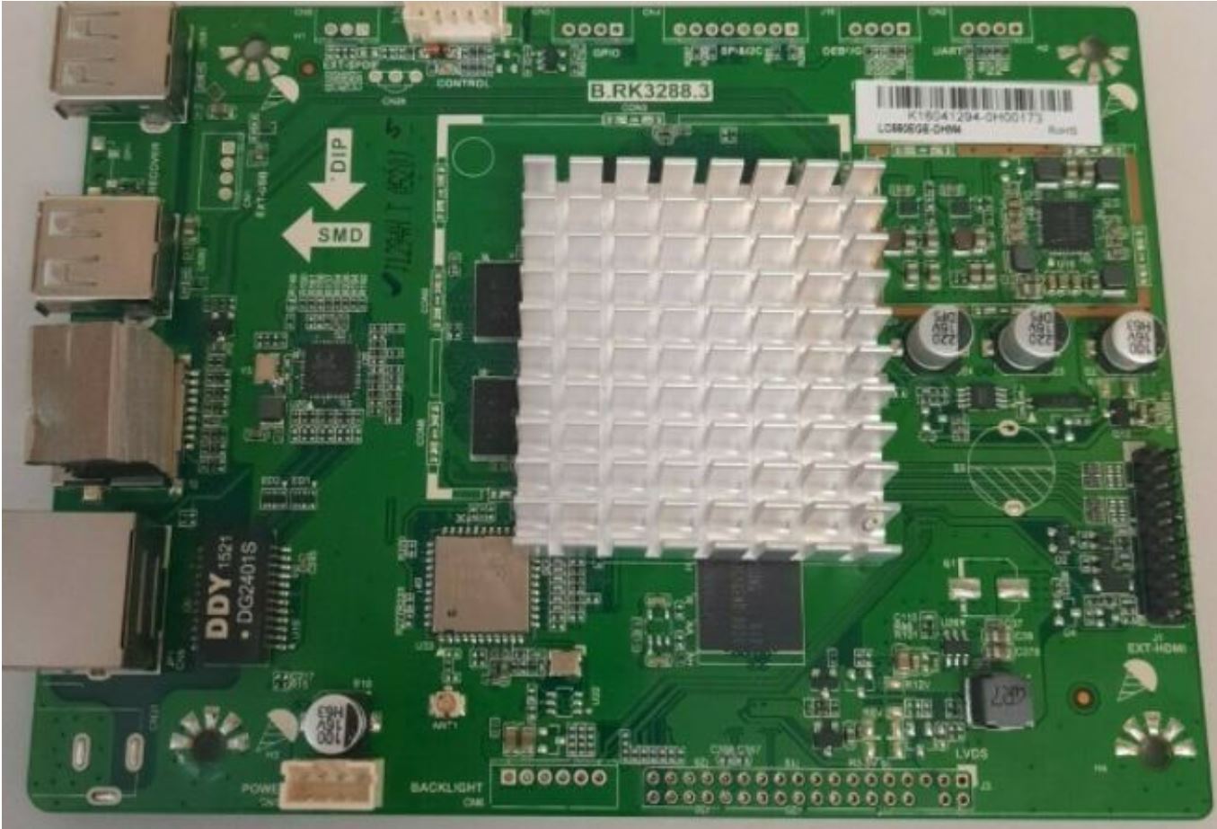

    Just for reference, here is the wifi board that attaches to the main board.
    It is the one that has a blue led which glows constantly when the tv is powered to on.

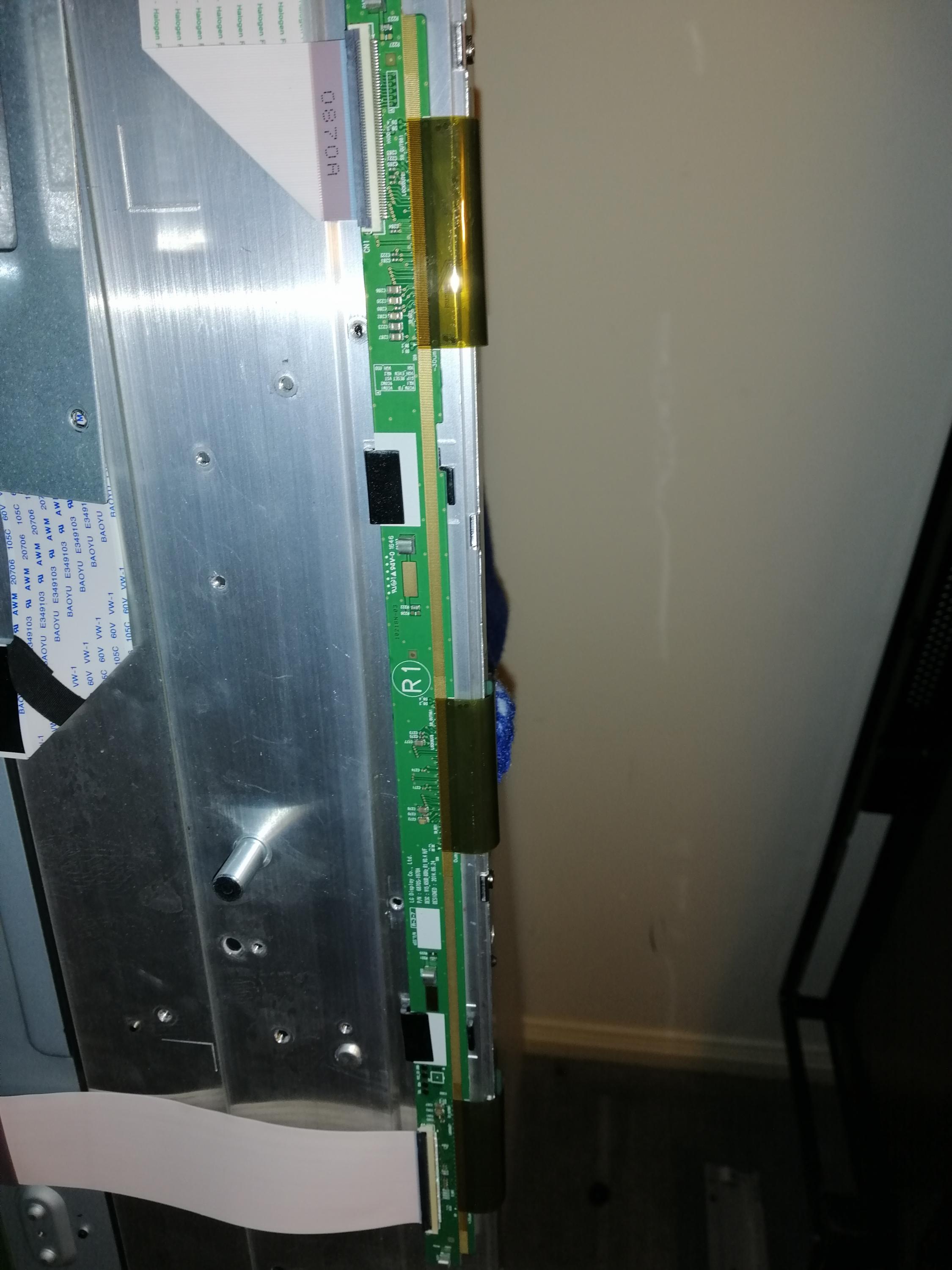

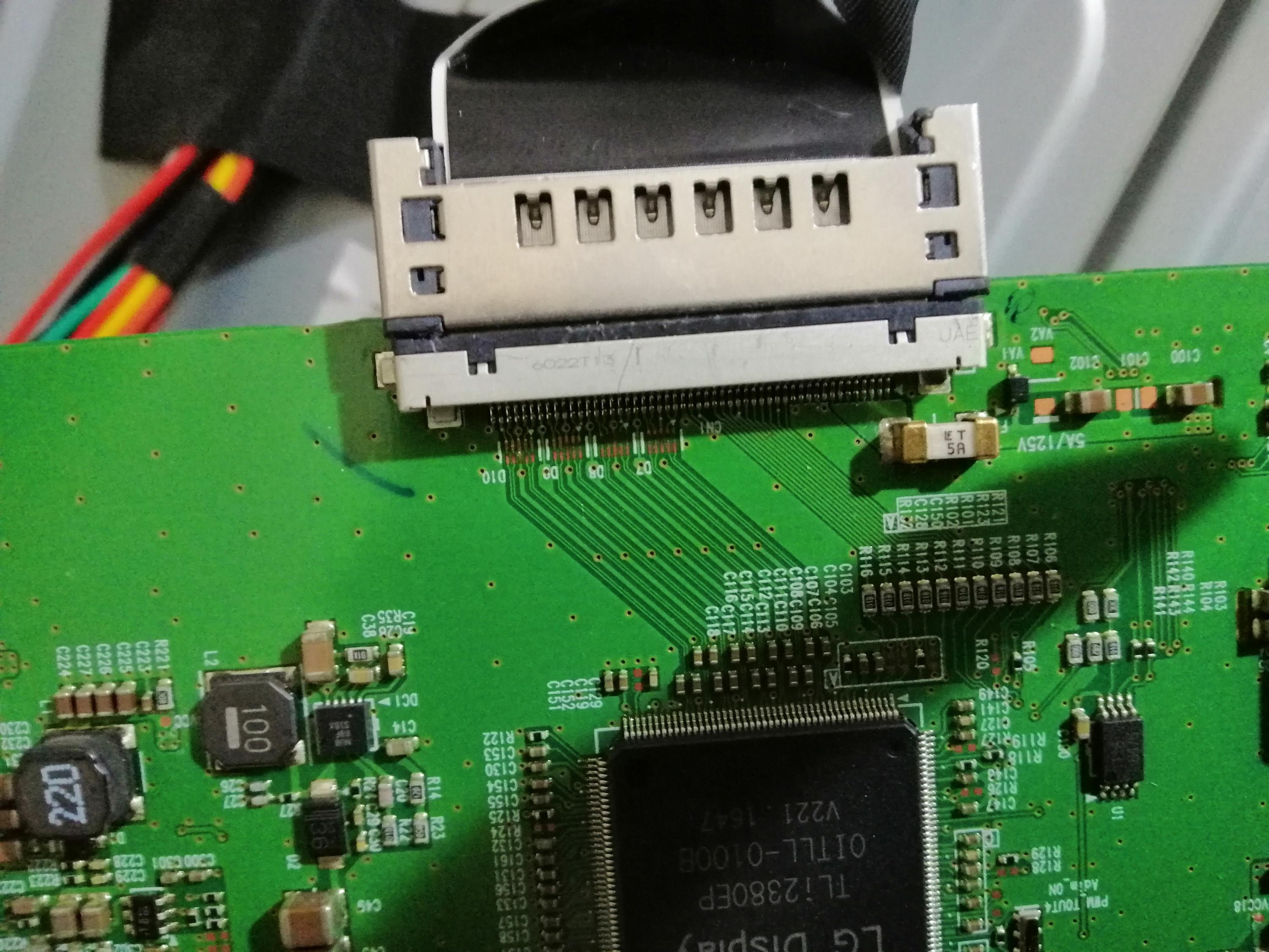

      OK...weekend is here so got to try some more measurements on this device.
      Screen still just goes to backlights.
      Now when I measure voltage on the T-con board it measures 7.5 both sides...it was 12v.
      Now when connecting and unconnecting the ribbons going to the panel, I was able to get one half screen white and one half black....I can no longer duplicate that image.
      The only thing I have disconnected from the main board, is one speaker wire so that I could remove the fittings around the display board area to reveal them.
      I have undone some of the bottom of the panel and exposed the display boards and checked the two main ribbons that go from the tcon to the panel, and they sit good etc.
      The display panels are in four sections L1,L2,R1,R2...wriggling all the ribbons on these makes no difference.
      I am a bit stumped as to why my tcon fuse is now reading 7.5 and not 12?
      I did check the readings for the 24 on the led driver board, and they are still correct.
      I don't really know my next move....anyone?

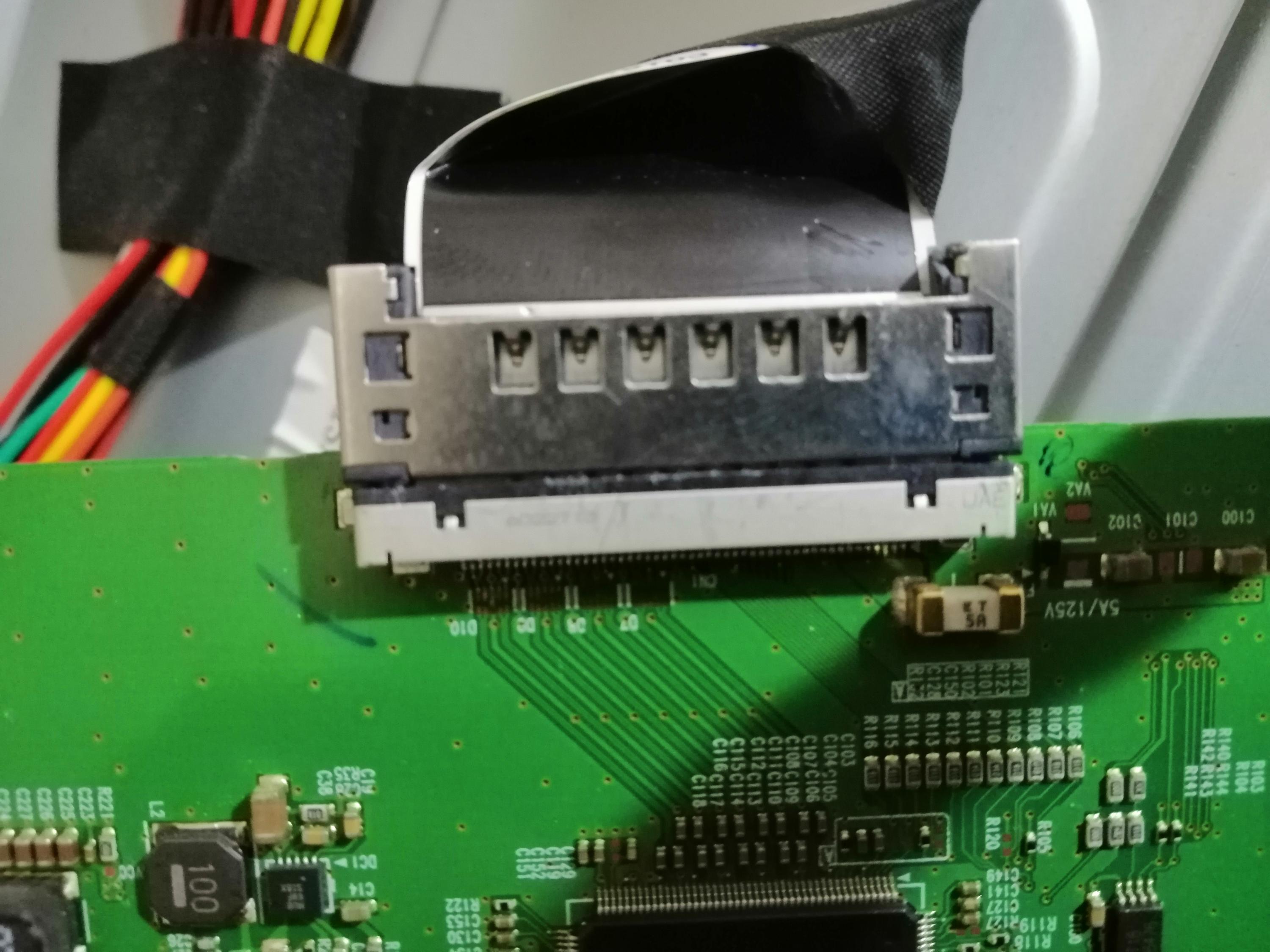

            I can't help myself, looking at the tv again.

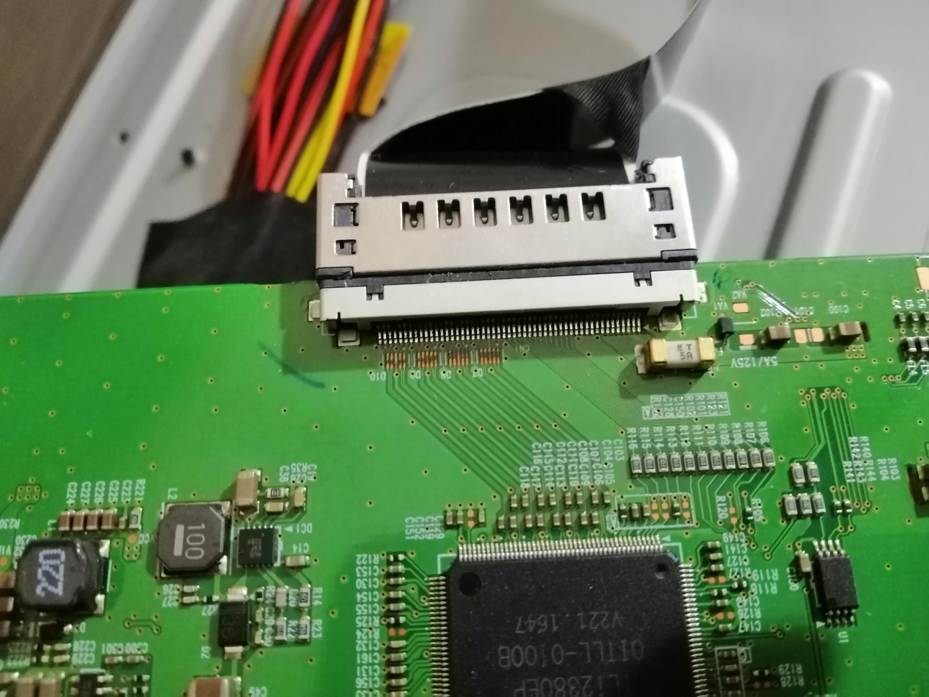

            For the life of me, I cannot work out how to remove the ribbon from the entry into the t-con board.
            It appears to be a pull out connector.
            Do I just have to grip it and grunt it out?
            Signature:Seemingly hopeless tv fixer
            • viewerau
              • May 2020
              • 305
              #86
              Re: Thorn 65thl4kst1
              EDIT
              I got it out.
              There were no black lugs on either side of the connector to pinch together to release the retaining clips
              I had to put a small screwdriver on each side where the tabs should have been, pinch the screwdrivers in there gently together to release the clip.
              Someone advised me to turn the tv on with the tcon removed, then reconnect it all again, to see if it cleared anything, but it didn't.

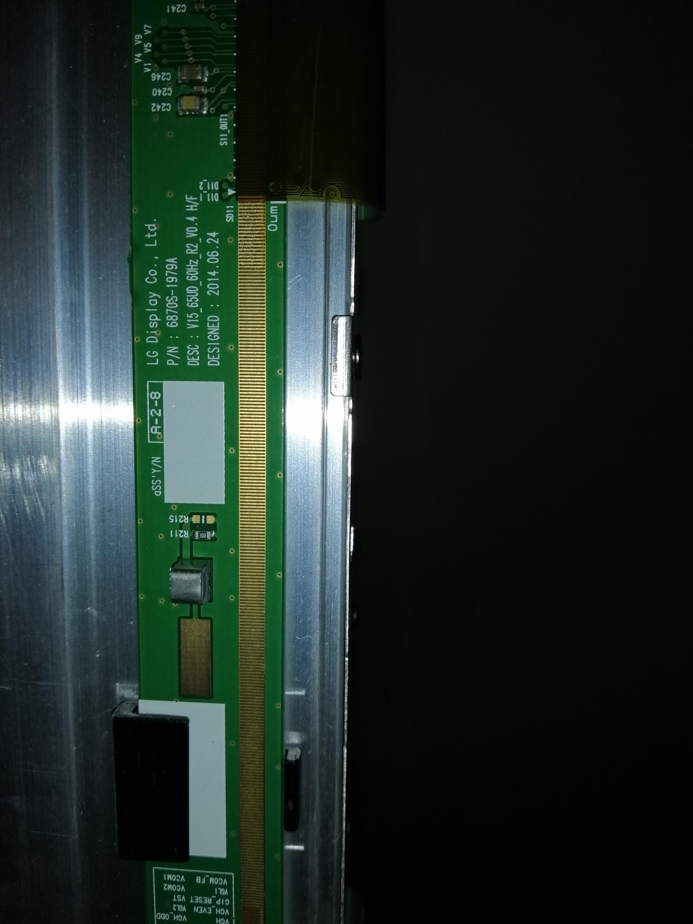

                I cannot help me, and played around again, trying to get some values on the 4 x edge display boards.
                As my multimeter doesn't have a beeper, I tried to measure across the smd capacitors.
                I got these readings.
                Is this just garbage readings, or could they be of value?

                  A shorted SMD capacitor will show very little resistance across it, did you find any like that ?

                      • diif
                        • Feb 2014
                        • 6978
                        • England
                        #91
                        It's unlikely you have 11 capacitors measuring 0 if I'm seeing correctly. Recheck.

                          • viewerau
                            • May 2020
                            • 305
                            #93

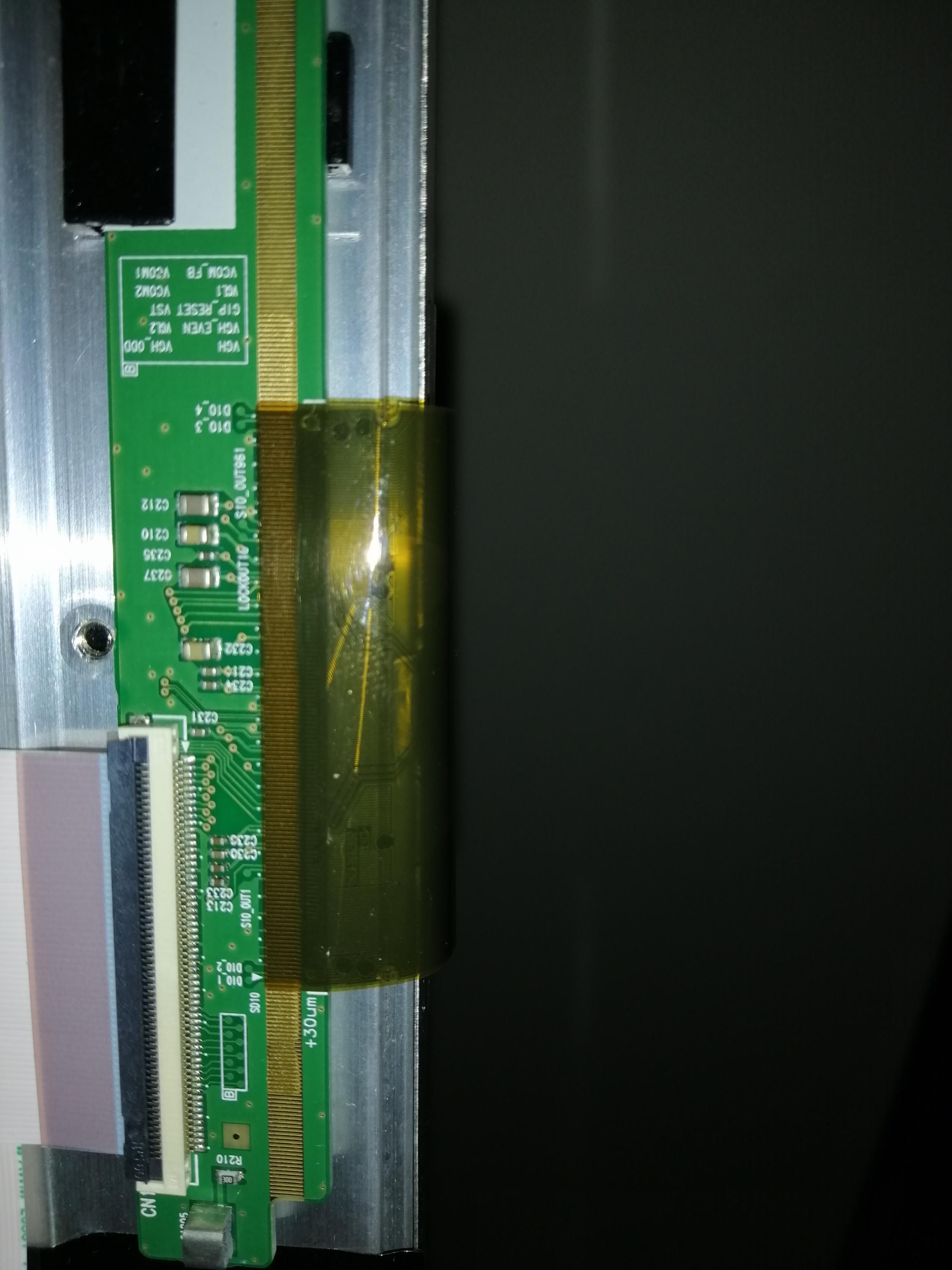

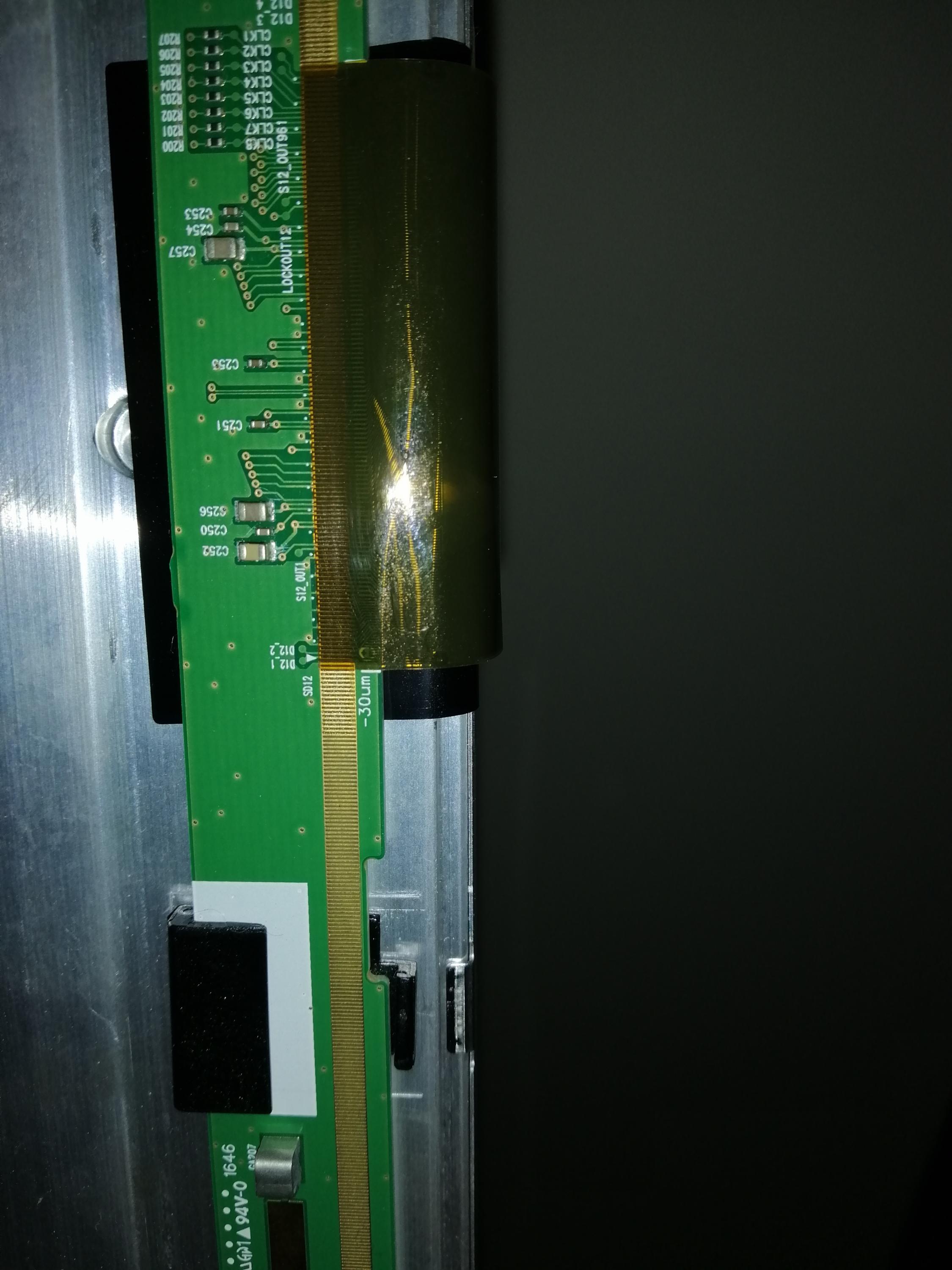

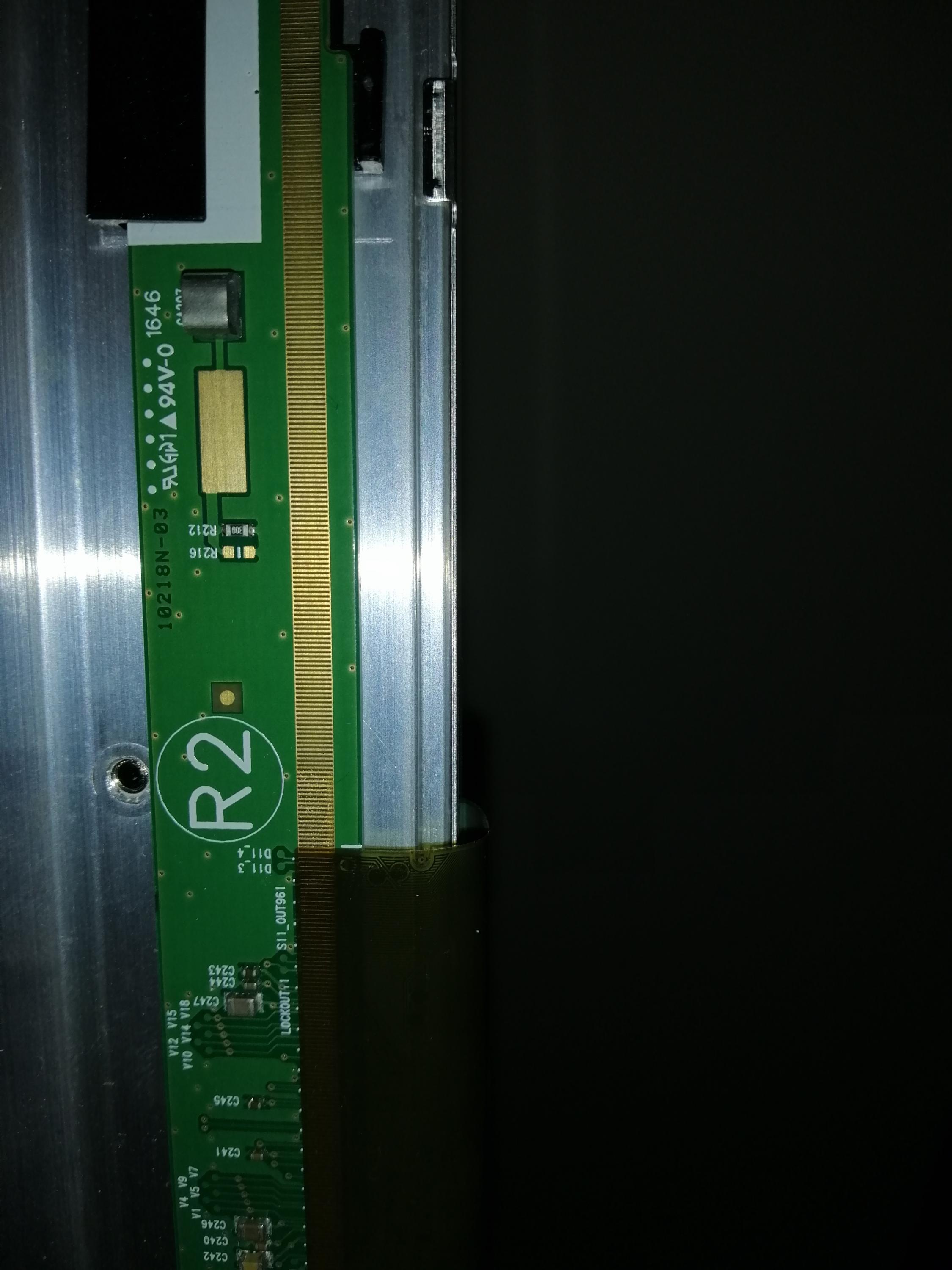

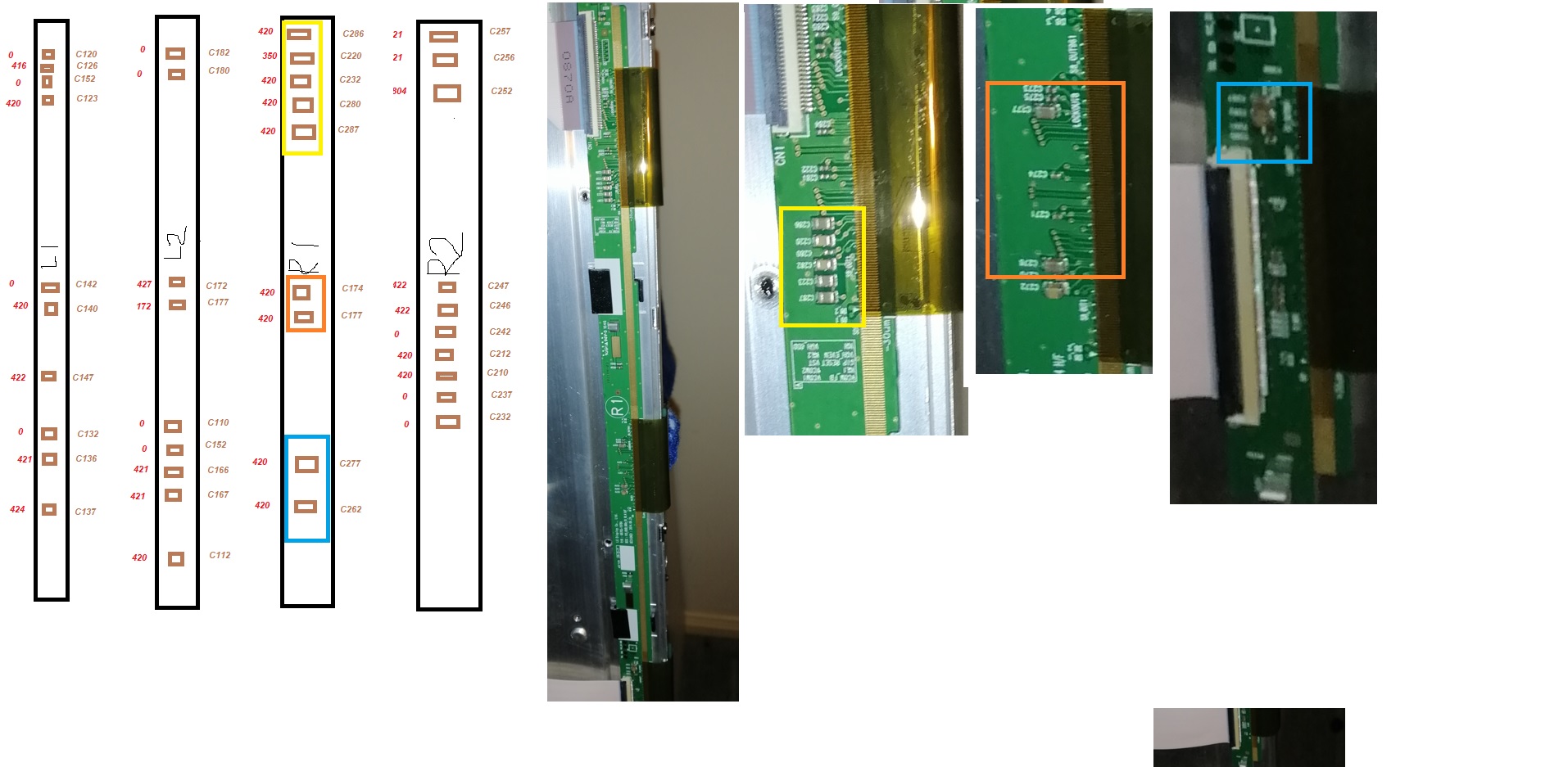

                            Here is my camera shot for R1
                            EDITTED
                            Shot one is top of board, shot 2 next down, and some show other sections. I could post them all, if of any benefit?.
                            Maybe I have wrongly identified and measured?

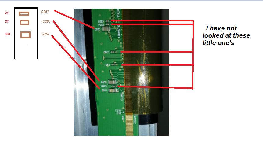

                                • viewerau
                                  • May 2020
                                  • 305
                                  #96
                                  An example my rough drawing to actual photo.
                                  • lotas
                                    • Jan 2016
                                    • 4555
                                    • Russia
                                    #97
                                    Why is it unlikely if they all sit on the same bus (connected in parallel with the same voltage), if one is in a short circuit, then everyone will show a short circuit, now it remains to find the culprit.

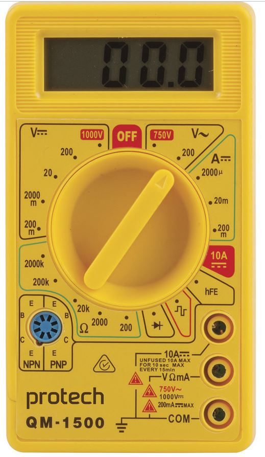

                                        I ran the checks just now with my meter set at 200 Ω mode.
                                        I had another person check the read outs.
                                        Not touching the probes together, the meter read 1.0
                                        With my two probes stuck on top of each other, the reading fluctuates to 1.3 and 1.5, finally settling on 1.3
                                        I set the meter in place, next to the boards on the panel, still with a reading of 1.0 before I touched anything
                                        I placed the probes either side of the smd's, and every one of them showed a result higher than 1.3, via a quick reading, and then the reading would go back to 1.0
                                        Every one I tested did the same
                                        Does this indicate anything exactly?
                                        Thank you for staying with me.

                                          What has happened to the meter between post #87 where you got some readings and now when you're not ? Is the battery flat ?
