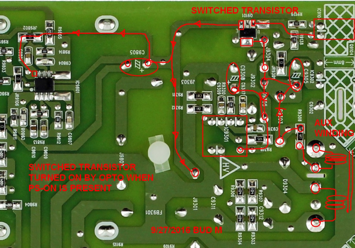

    Been working on a few televisions for awhile now, and thanks to everyone who posts. Learning so much! Anyways, working on Vizio M502i B1 power supply board with no voltages on CN9101 except for the 5v at pin 15 and 16. Traced it all down and I have an IC9301 that is a A6069H chip. As per the data sheet, this chip needs 13.8 - 15.3 volts to "start up". I only have 12.8 volts? I have attached a pic that was posted here 9/27/206 by Bud M. It shows the same board I am working on. Any ideas why the required 13.8 - 15.3 volts on my board is only 12.8 volts? This is tested with power supply forced on with a 1k resistor. Thanks!

          IC9301 IS the standby ic, so that is not where the problem is. Check the voltage on one of the main filter caps, C9811 or C9812. The voltage in STANDBY, should be around 160vdc, When you force the power supply ON it should go to 385vdc, This tests the pfc circuit. The main ic that develops the +12v & +24v is ic9101
          If the voltage on the collector of Q9101 is low, Replace C9305 and maybe C9805 & C9122 as well

            Thanks. When I force the supply on, I do get the 385 vdc. I did replace C9305 when testing the caps previously. I'll text the IC9101 tomorrow and post my results. I did order this ic from "SJ" (not sure if allowed to promote) and should be here Friday. Thanks for the reply.

              If the problem is intermittent, I doubt it will be an ic. (we use SJ pictures all the time so it's not a problem that I am aware of) Like I said, if you don't have the pfc boosted voltage, you likely will not have the main ic voltage.
              IC9101 should be a LCS703LG-TL

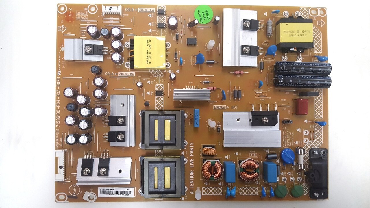

                Can you post a photo of your power supply board?
                RJ do you know the model number of the psu?

                  I do have boosted voltage. I was thinking the same thing about it working intermittent, why I suspected the caps, and even tried cooling and heating the board.
                  This is the board I have. (From internet)

                      The board number is 715G6100-P04-003

                        What exactly are all the voltages on CN9102 when you force on the powerboard with the resistor and are they steady? Remember that's with the cable unplugged.

                          The pfc circuit is working so I suspect the VCC is ok, but check the voltage on Q9101 emitter, it should be about 16vdc.
                          The power supply does have OVP (Over Voltage Protection) on the +12 & +24 volt supplies, I am starting to think it might be a backlight issue on this tv?
