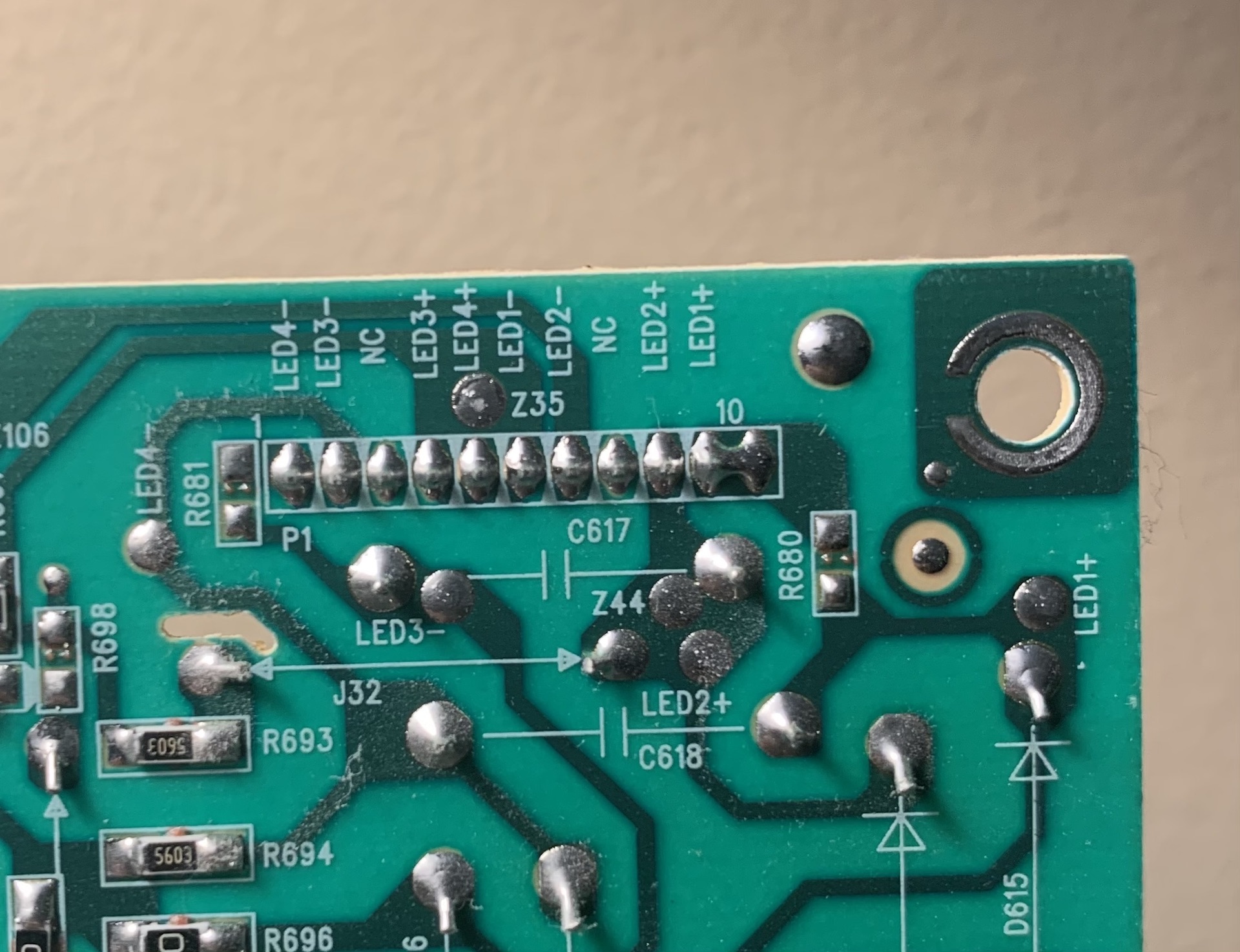

    Hey everyone - I have a TCL 55S401 with these symptoms: powers on, has sound, and a black screen.
    I tested with a flashlight and can see the TCL logo and setup screen. I did a factory reset and with a flashlight I can now see "select language."
    Following instructions from Budm in a recent post for a TCL 55S405 without backlight, I did the following tests:
    Power Supply to LED (pin label is under board)
    Tested w/ multimeter at 200V and tv unplugged to plugged in to power on:
    P10 LED1+ : 0
    P9 LED2+ : 0>48~60>0.69
    P8 NC
    P7 LED2- : 0 > 0.01
    P6 LED1- : 0 > 0.01
    P5 LED4+: 0 > 0.01
    P4 LED3+: 0 > 0.01
    P3 NC
    P2 LED3-: 0>22~25>0
    P1 LED4-: 0
    I also tested the PS to MB and will post later, but pretty much had 12V everywhere labeled 12V and 3.3V on P_Dim and 3.5V BL_ON

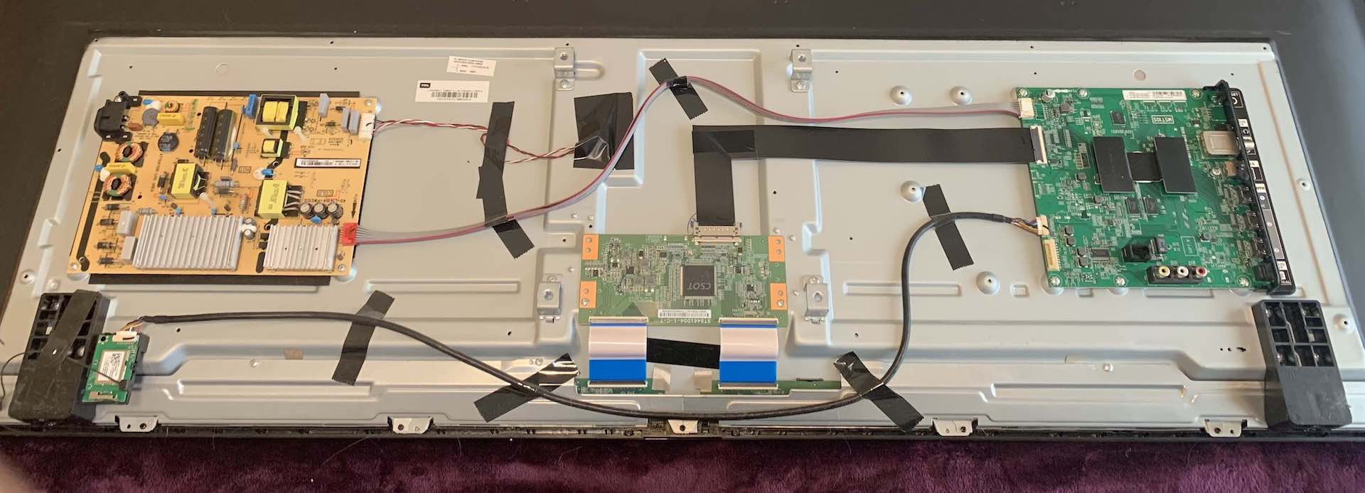

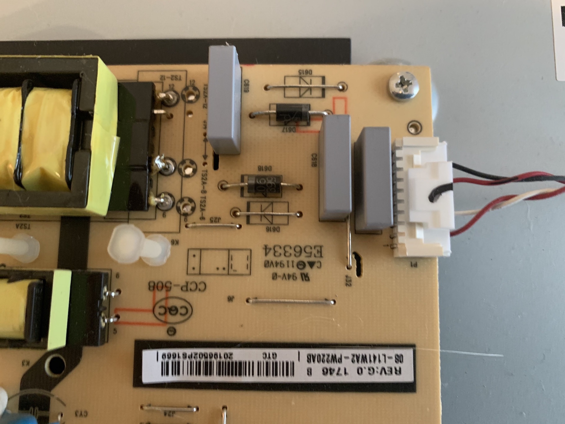

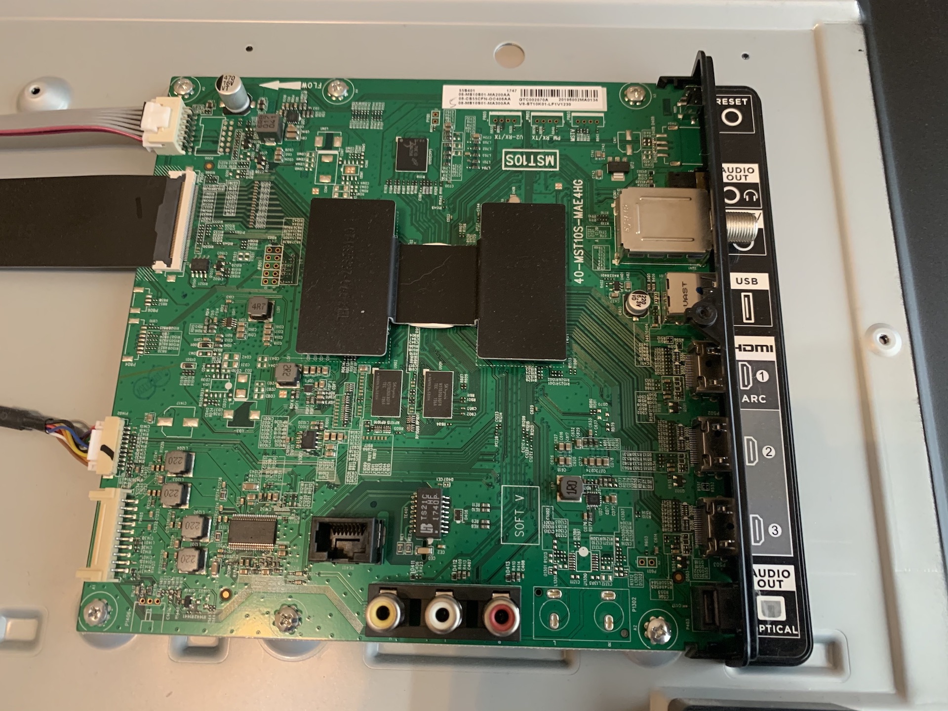

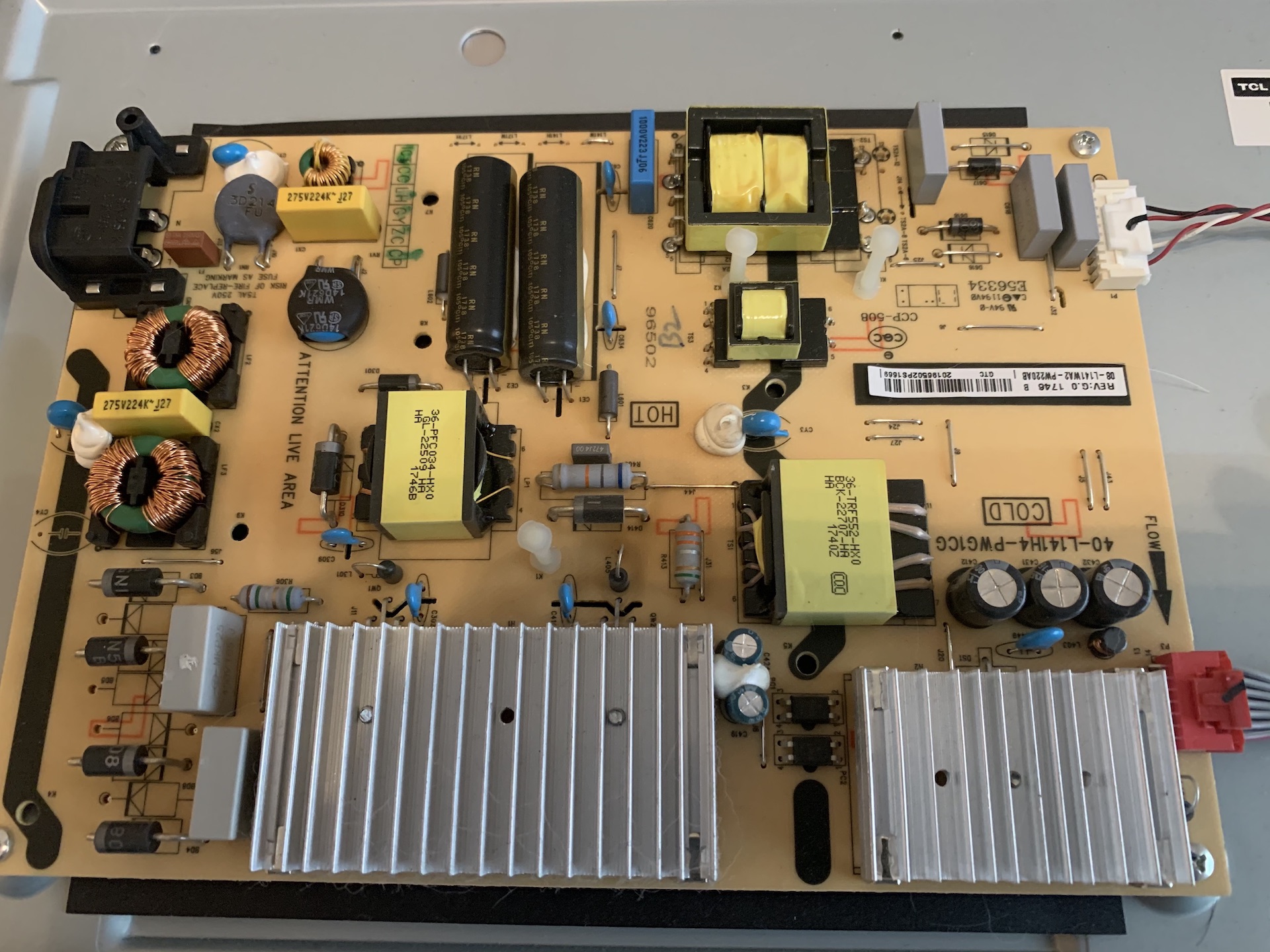

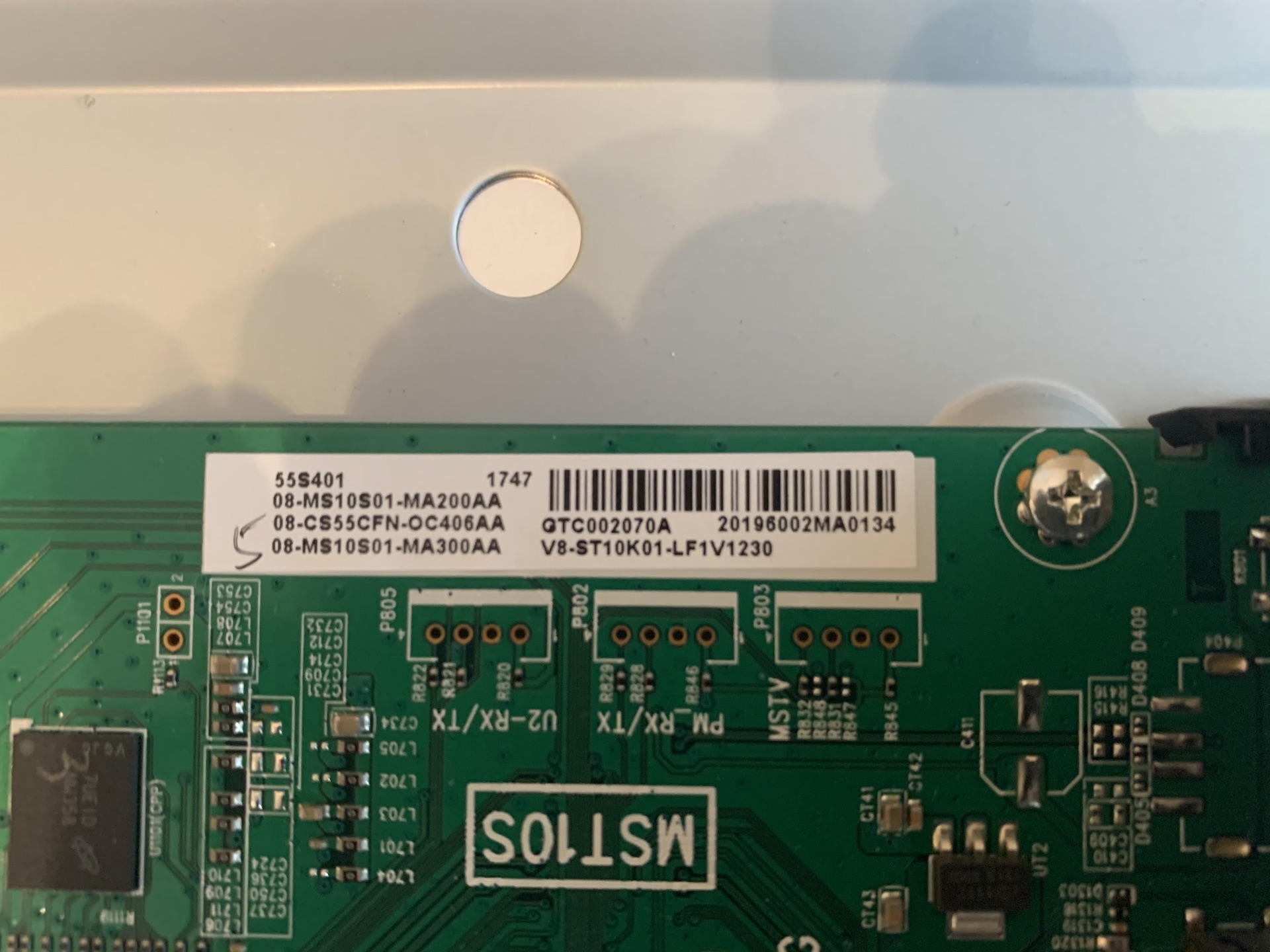

    Images attached. Any help figuring out if its the LEDs or something else is MUCH appreciated

              Based on your reading in post #1, it looks like you have open circuit in LED #2. this TV has LED 2 string connected in series with LED 3 string.
              If you leave the LED connector out and then keep the black probe on the chassis, red probe on LED2 + pin of the power supply board then turn on the TV while watching the meter to see how high the Voltage jumps up to.
              • Chris24
                • Feb 2014
                • 42
                Re: TCL 55S401 - No Backlight (powers on, sound, flashlight image)
                With LED connector unplugged from PS I get:
                P9 LED2+ : 0> 68~101v > 0
                and
                P2 LED3- : 0 > 78~90V > 0
                The PS clicks once and I get a 90v or so reading and back to 0 and then a few seconds later it clicks again and I get a 65V or so reading then back to 0
