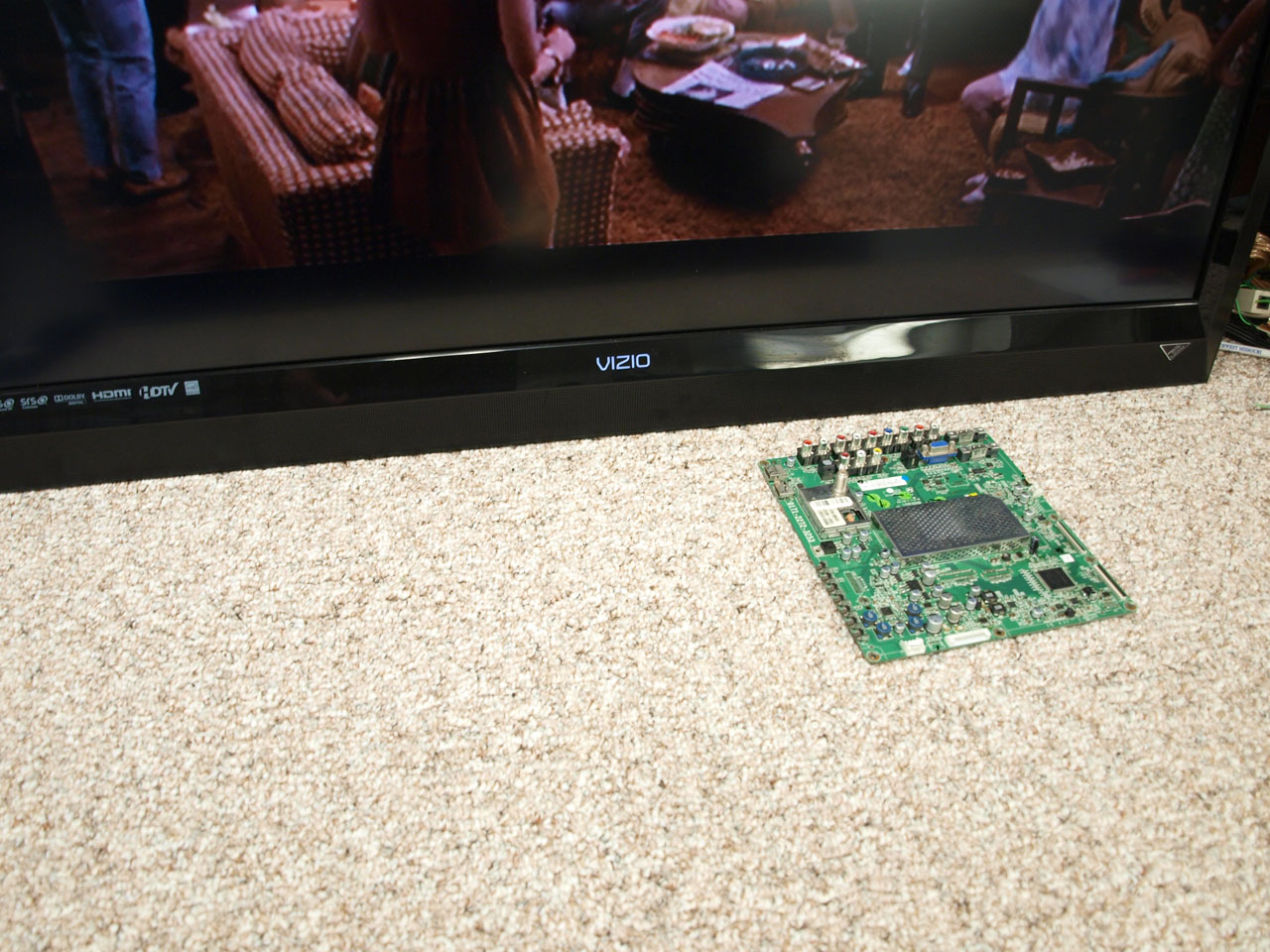

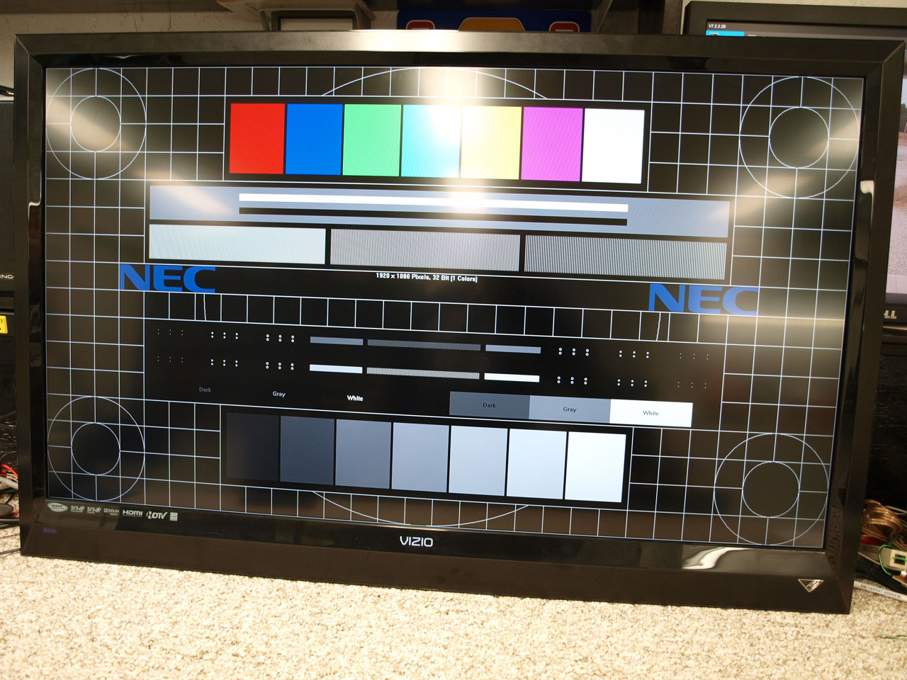

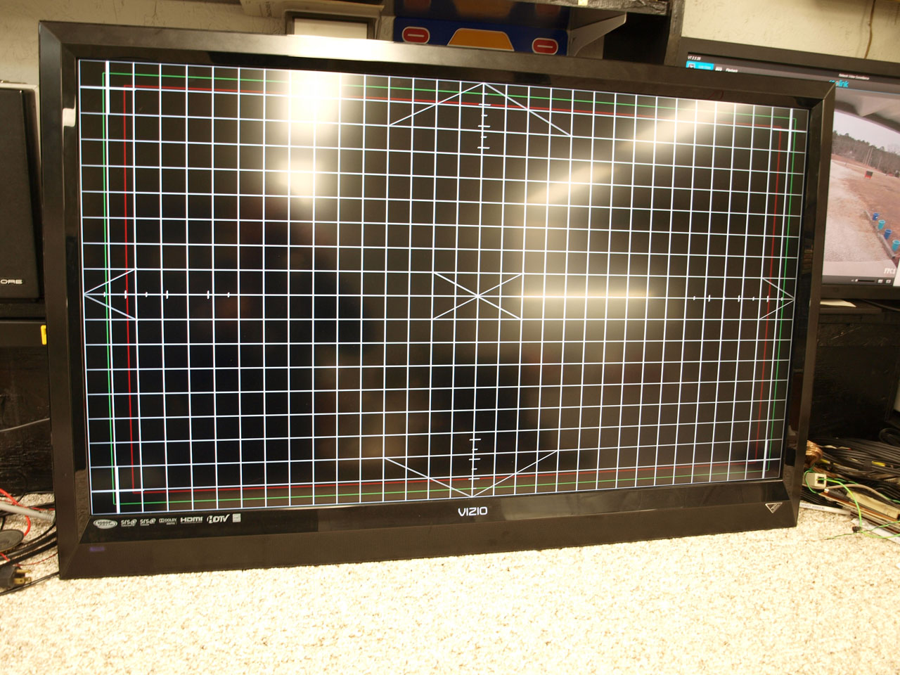

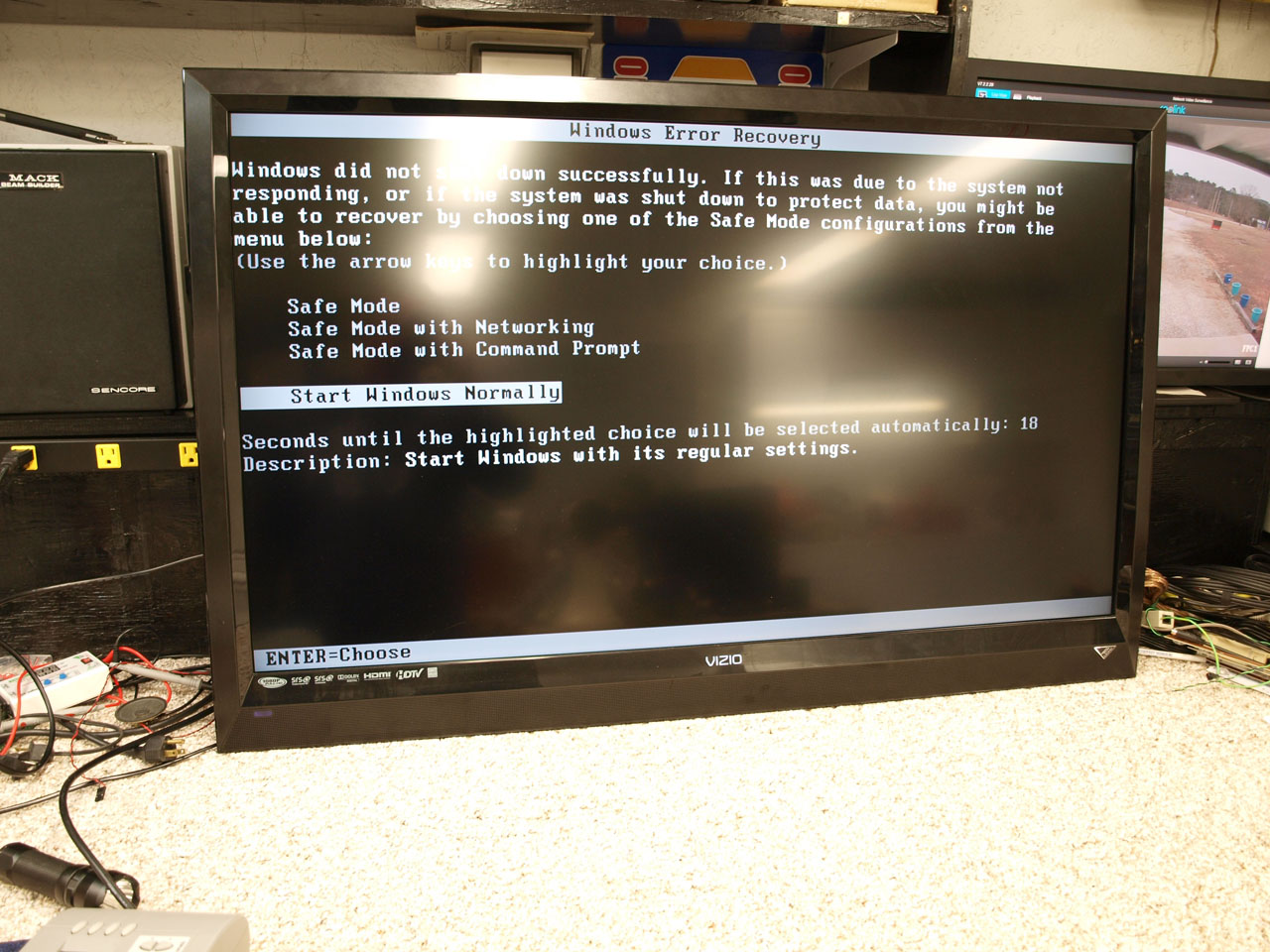

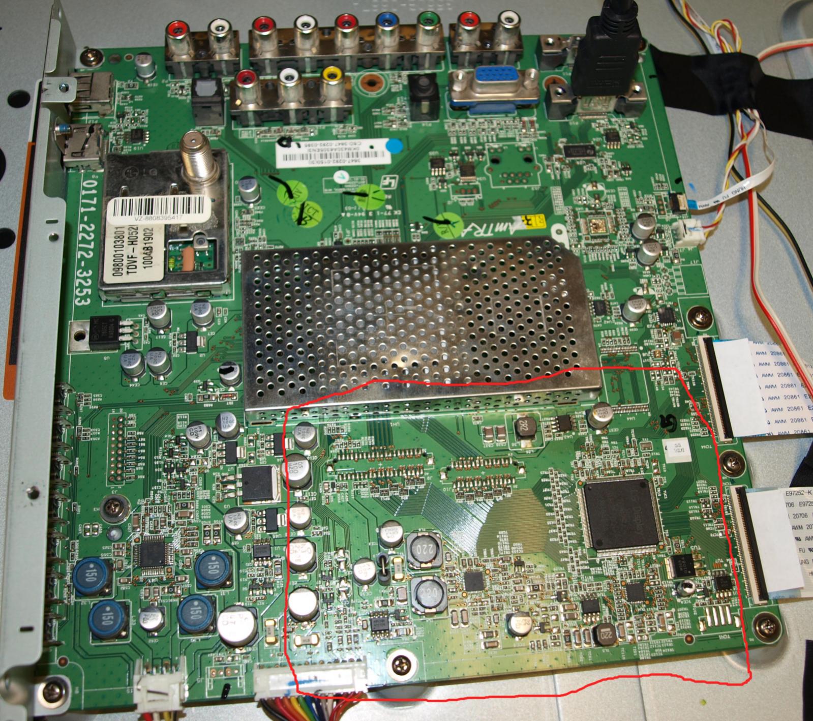

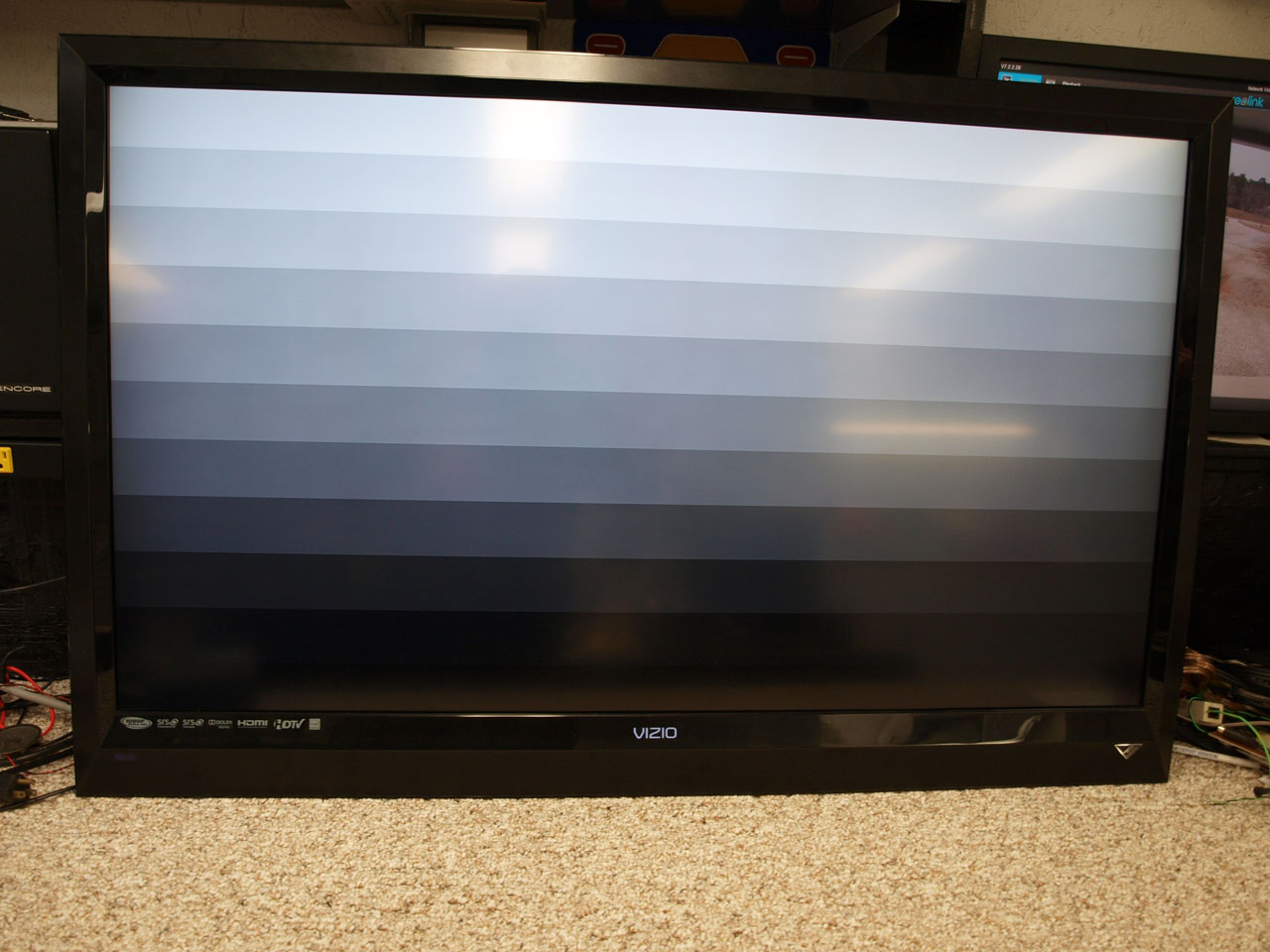

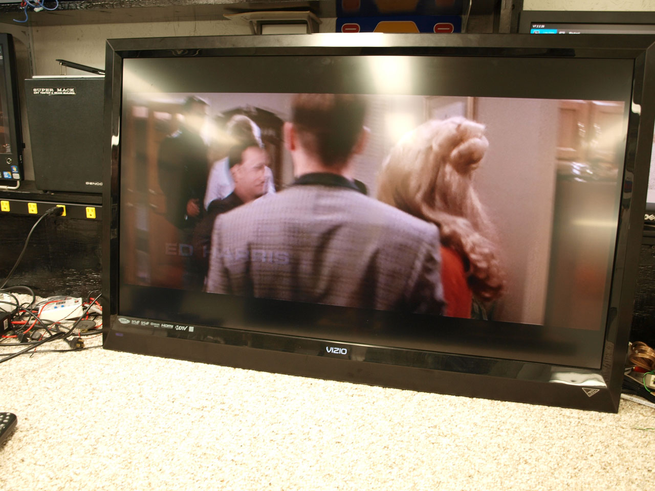

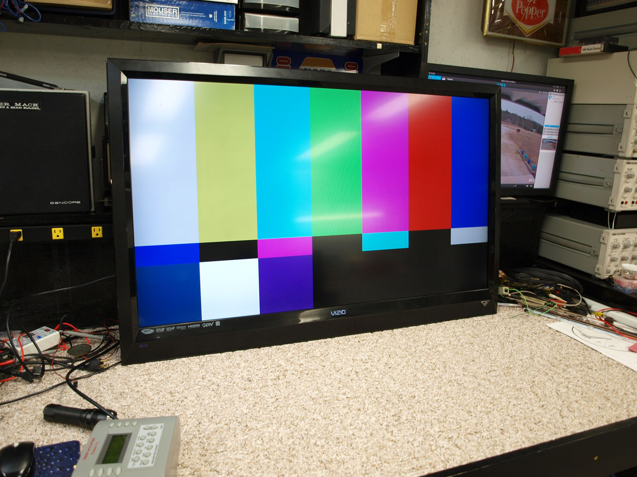

                    Ok, just so not to leave a thread hanging..... I finally got this one going...the owner wasn't in a hurry and I had other stuff to work on. Anyway, as much as I hate doing this, I just couldn't narrow down what component was causing the issue and I just couldn't waste more time on it....so I found a used board on ebay for $16 shipped that had the 'frozen splash screen' issue (a common issue and easy fix)....so I bought that and the $14 worth of eproms for it from shopjimmy, and we're back in business.
                    If I hit the outlined area with cold air from the compressor or warm air from a hair dryer, things would go bananas; screen freezes, gibberish, and sometimes it'd even recover and be perfect..... Anywhere else on the board had no affect.
                    I reflowed and checked components until I was blue in the face, nothing ever tested bad. The LVDS's were fine & clean (I cleaned them several times in the process of diagnosing).
                    Anyway, old board set aside, and new old board into play. After replacing the eproms, here we are!!
                    Test patterns:
                    Now for the HTPC...
                    NEC test pattern from the HTPC:
                    ...and a movie... Apollo 13 back from the 90's....
                    The turd board:
                    I hate being a 'board hanger'.....but I just couldn't figure this one out....but in the end, it's working and I made a nice profit on it.
