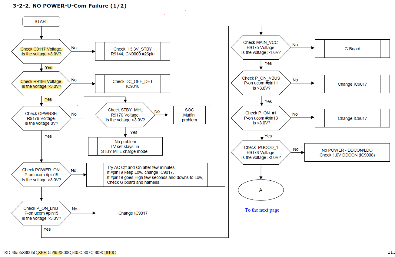

    Hello
    I'm troubleshooting a dead Sony XBR-65X810C.
    I was able to find a service manual from one of the posts here.
    I was able to get through the steps highlighted in yellow, but need some help with next steps. See attached Picture.
    Next step says:
    Check OPWRSB
    R9179 Voltage.
    Is the voltage 0V?
    and one after says:
    Check STBY_MHL
    R9176 Voltage.
    Is the voltage >3.0V?
    These are referring to the same resistor, what does OPWRSB and STBY_MHL stand for?
    I measured voltage on both ends of that resistor and got 0V (millivolts).

    Re: Interpreting Service Manual Troubleshooting Steps
    So you have 3 volts on R9186?
        I don't know what "OPWRSB" stands for. It seems to refer to a control pin on a microprocessor in other manuals., without a schematic, it will be hard to trace the circuit, R9179 & R9176 don't seem to be the same resistor.
        If the voltage on R9179 IS 0 volts, then proceed to the YES and check Power_ON
          You can find some information in this pdf
          OPWRSB - Power In On/OFF
            Thank you RJ, my bad, I read both Resistors as the same number, I actually checked R9176 and got 0V.
            So next step says:
            Check POWER_ON
            P-on ucom #pin19
            I'm not sure about this again, as there is no pin#19 on any of the boards that is named POWER_ON. I checked POWER_ON pin on the main board which is Pin#22 and Pin#9 on the Power board, they both have 3.5V.
            So that takes me to the next step:
            Check P_ON_LNB
            P-on ucom #pin15
            Again there is no Pin#15 on any boards that are called P-ON_LNB.

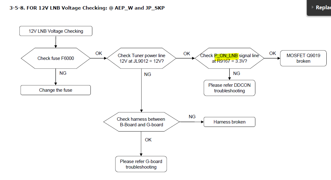

            But I searched the Service Manual for P-ON_LNB anywhere else and its on another troubleshooting tree referencing R9167.
            "Check P_ON_LNB signal line
            at R9167 = 3.3V?"
            So I checked R9167 and has 0V on both ends. So that would point to > Change IC9017.
            Any idea if I'm interpreting this correctly?
            If IC9017 is suspect, would you suggest I try to heat it up enough to re-flow the solder? Or I should be able to find a replacement.?
            Thank you for your help getting me this far.

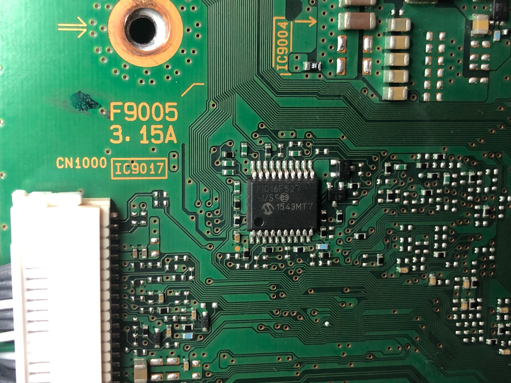

            • dick_barton
              • Aug 2015
              • 6643
              • Wales
              Looks like that chip is a 20 pin, 8bit flash microcontroller made by Microchip
              https://cdn.badcaps-static.com/pdfs/...07d0b1414e.pdf
              and if it is then it most probably programmed by Sony
              It may well be that it supervises the power on sequence.
              Check it has its supply voltage on pin 1 (VDD)
                  Sorry for the delay, I don't have much time to work on this.
                  THank you for your inputs.
                  I found maybe 7 or 8 fuses on the main board, all of them had either 12 or 5V on both sides of each fuse. So they are all good.
                  I also checked pin1 of IC9017 and it has 3.5V.

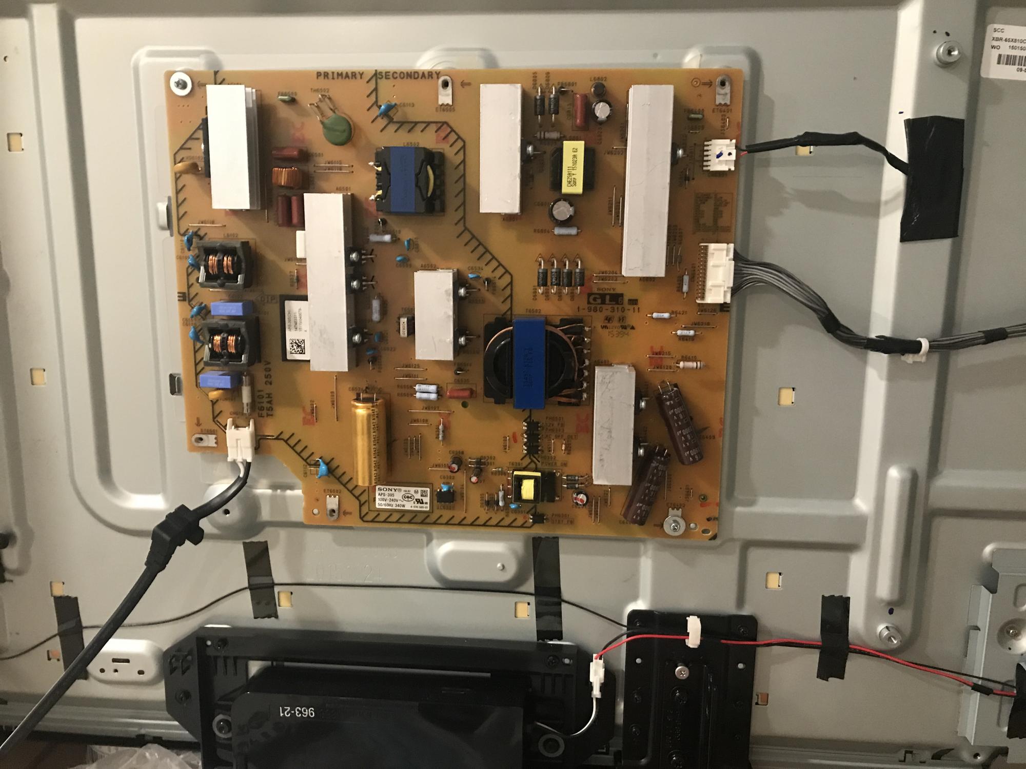

                              So I disconnected everything from the power board and got the following results.
                              Testing GL6 Power board
                              Main board connector disconnected
                              3.5 STDBY only
                              Main board connector connected
                              Pins:
                              AC_OFF_DET: 3.5V
                              POWER_ON: 3.5V
                              REG12V: 12.7V present
                              Pins: STDBY and Tcon_ON shorted
                              TCon_VCC12V: 12.7V
                              Backlights connector
                              Pins:
                              +OUT1: 98.6V
                              -OUT1: 0V
                              Pins: STDBY and BL ON shorted
                              Pins:
                              +OUT1: 220V
                              -OUT1: 80V
                              No Backlights ON
                              Not sure how to stimulate loads.
                              THanks again, hope you can still help.
                              • michalk3777@gmail.com
                                mk3777
                                • Nov 2016
                                • 33
                                This indicates to me that Power board is OK, I'm just not sure about the Backlight outputs.
                                  Pins:
                                  +OUT1: 220V
                                  -OUT1: 80V
                                  No Backlights ON
                                  That should be around 20V range, 80V is way too high.
                                  Is that measured with ref. to circuit ground?
                                    mk3777
                                    • Nov 2016
                                    • 33
                                    Thanks for your response.
                                    Yes ref. is ground.
                                    Would simulating some load help in troubleshooting the BL circuit?
                                    I just picked up an XBR55800G for free that powers up but has a broken screen.
                                    the main board is different but the power board looks identical, GL6 board,
                                    I;'ll check the numbers tomorrow when I open it up.

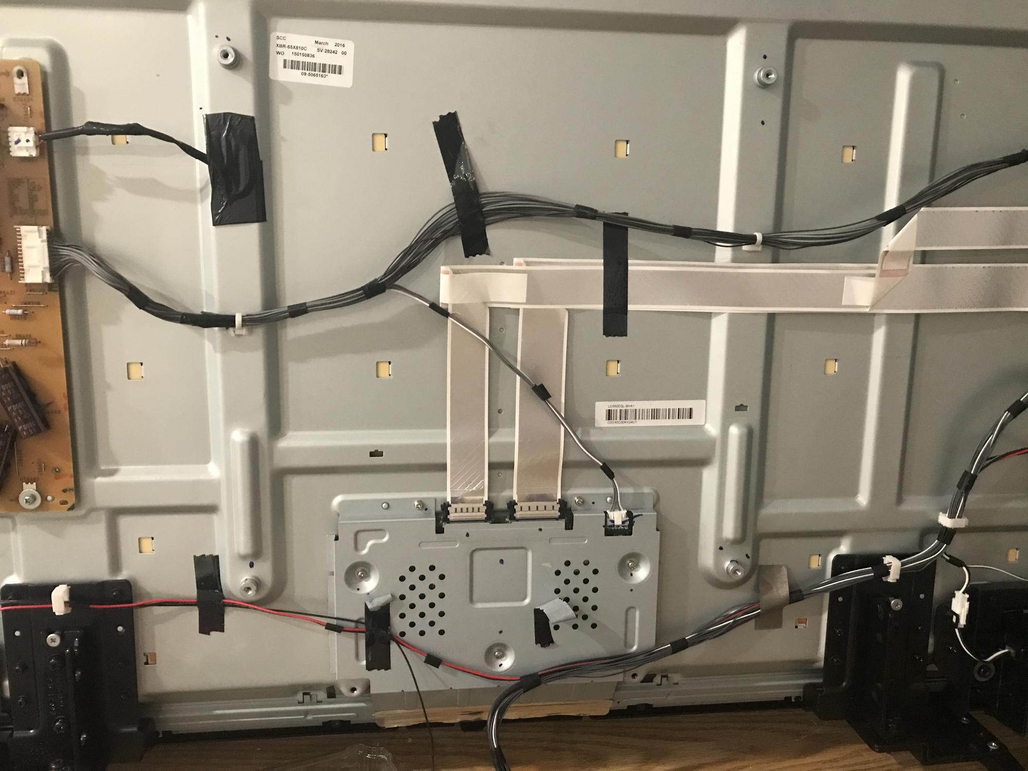

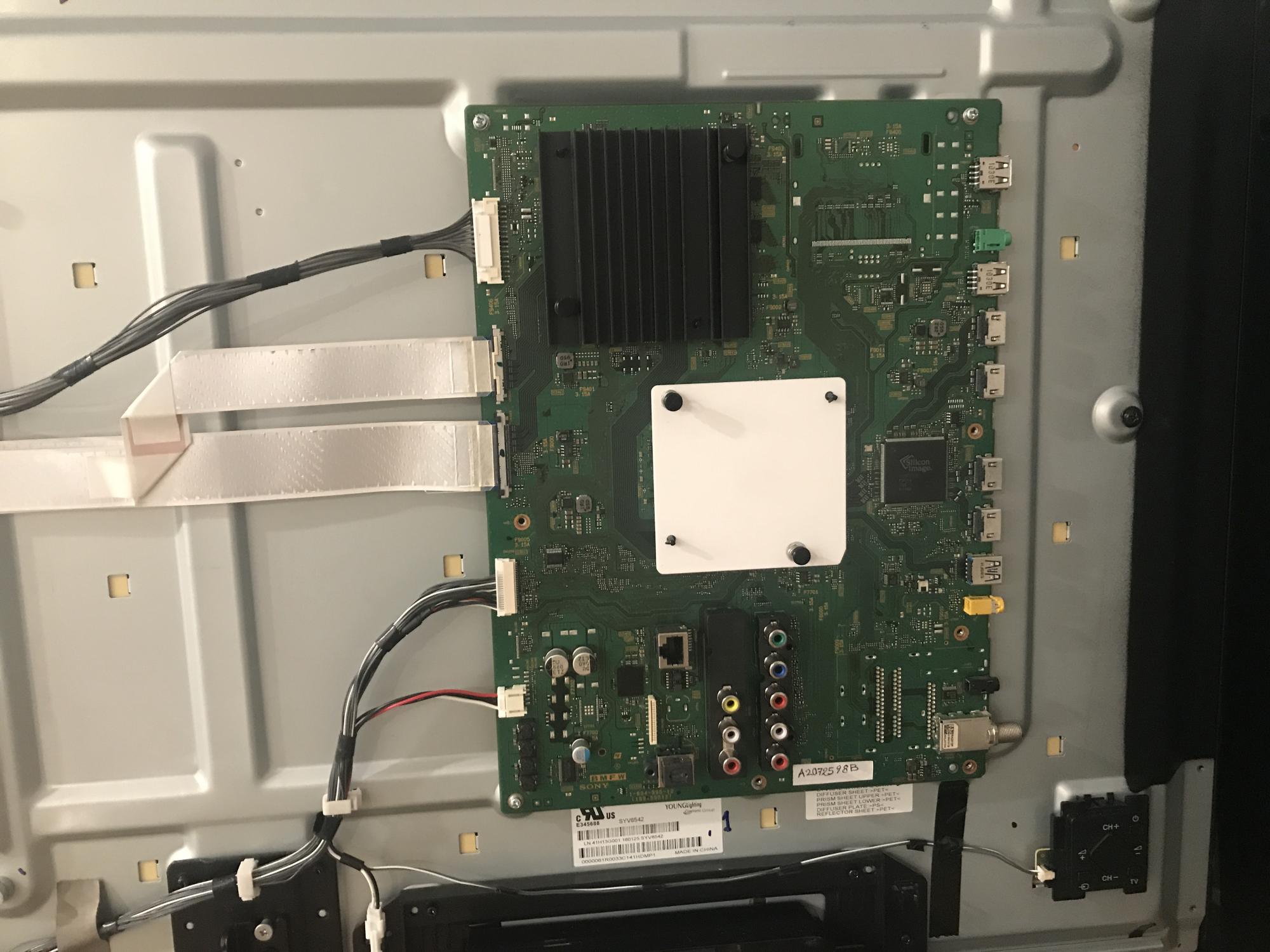

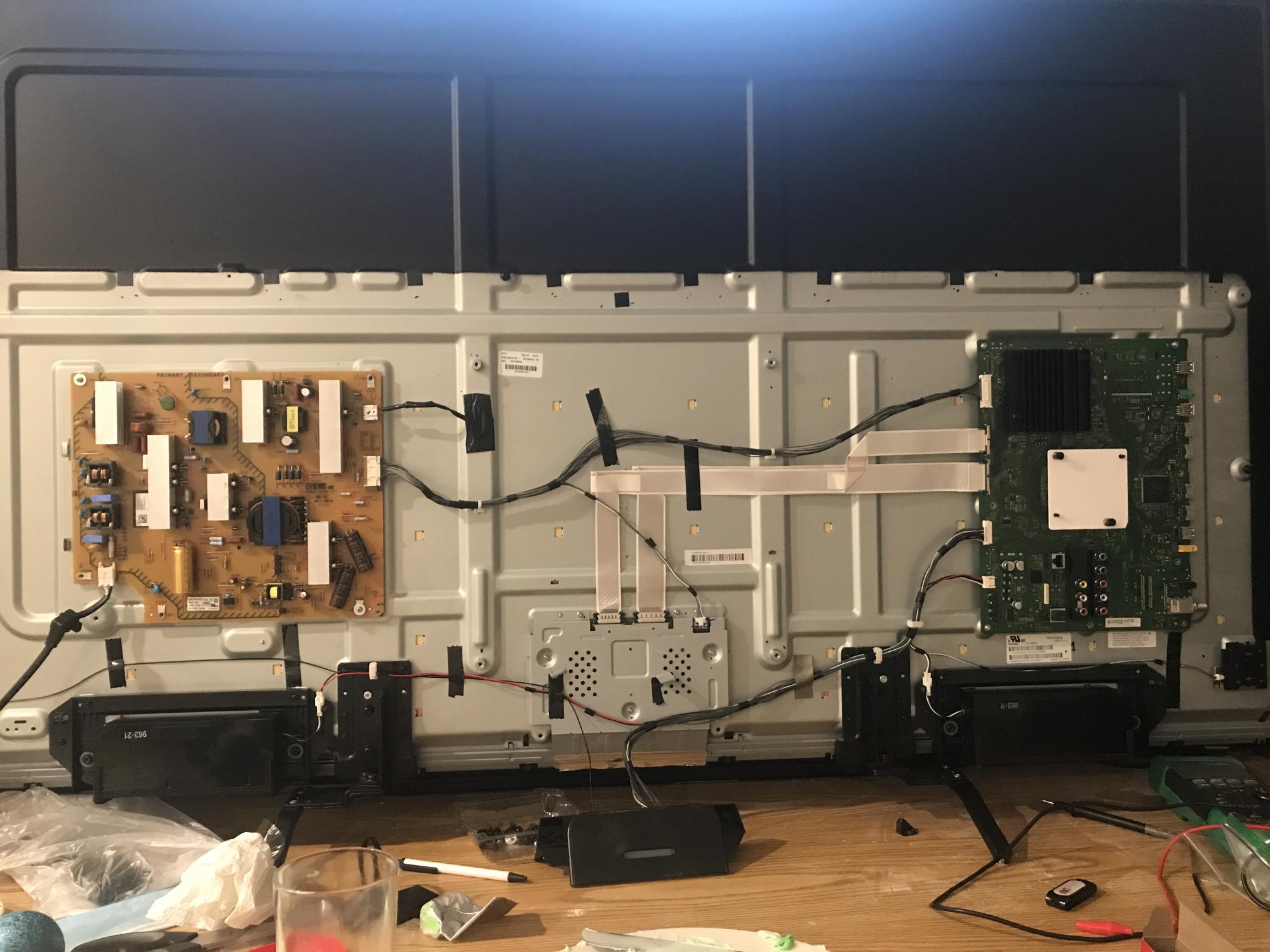

                                      Can I see the pictures of the whole backside of the TV showing all the boards so I can see what we are dealing with?
                                        mk3777
                                        • Nov 2016
                                        • 33
                                        Hello
                                        Pictures attached
