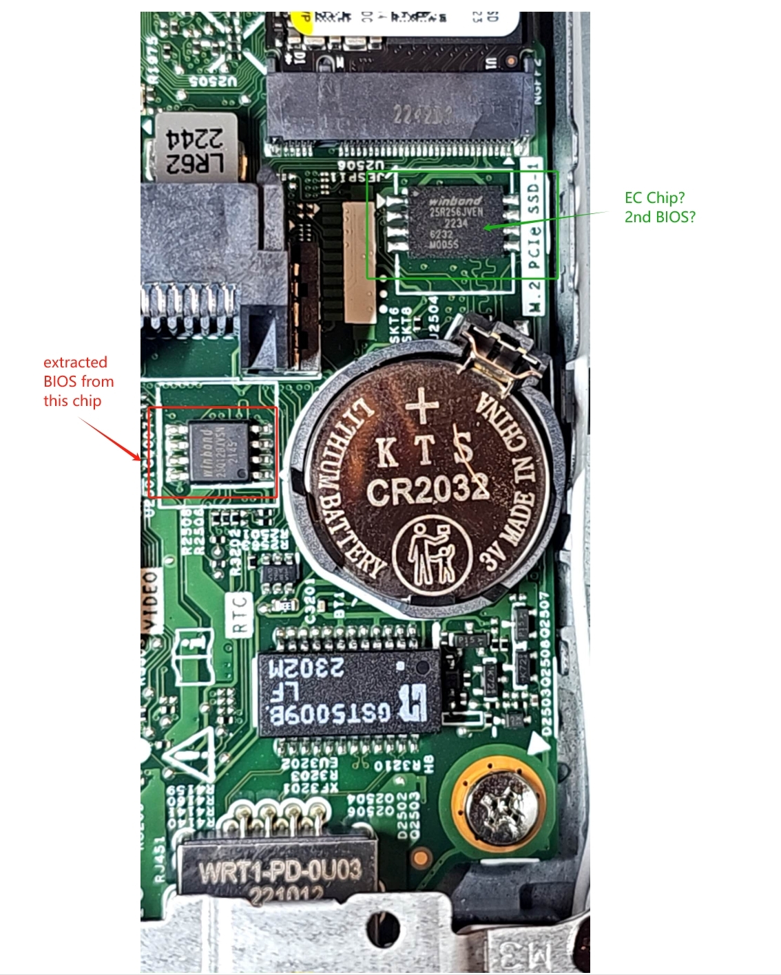

          Thank you for helping, I'm not familiar with 2 BIOS systems, I've attached a photo of the system board
          1. The smaller Winbond 25Q128JV chip on left of the battery is where I got the original bios and flashed patched BIOS to.
          2. The slightly larger Winbond 25R256JV chip could be the ESME? I did not do any modification to this chip
          I downloaded the original BIOS update file from Dell and noticed it's a 128MB file, far larger than just a 16MB BIOS chip would require.
          Let me know if I can provide any additional info.

            Post a backup of the 25R256JV chip. It`s WSON8 ,so a SOP8 clip will not work

              Happy holidays! Rats I realized what you mean by SOP8 clip won't work as the it's a flat surface mount without side legs like the 25Q128JV chip.
              I looked up the datasheet of 25R256JV and it appears similar in electrical specs and I believe my CH341a programmer should still work with the right adapter. I also verified ASProgramer v2.04 has this IC in supported list.
              I found this pogo adapter for WSON8 6mm x 8mm Amazon Link and will get it to help extract the 2nd chip

                Got the pogo header wire and read the 25R256JV chip, this was much more difficult vs clip as it had to be handheld in place. The CR2032 battery and all power sources were removed from board/system. Read with AsProgrammer and my CH341a @3.3v per spec
                1. First attempt: attached "as w25r256 first read.zip", CRC32 = 0xDE6E1D19 - Note: this however fails at verification (read back) at address 0x0102DE75
                2. I repeated until VERIFIED successful
                3. 4th attempt: attached "as w25r256 4th read VERIFIED.zip", CRC32 = 0x48E4F159 - successfully verified
                I attached both for reference. Thanks everyone!​

                  • rex98

                    flash both
                    first boot press f2 write service tag then press alt + f to exit manufacturing mode.
                    and do not use clip use adapter and do not use AS programmer use this neo programmer install driver first.

                      I've been using NeoProgrammer primarily but used AsProgrammer for the w25r256JV chip as NeoProgrammer did not have this IC specifically. I have found an updated IC database and will use NeoProgrammer moving forward.
                      Question regarding clip vs. adapter, for adapter you mean de-soldering the chip and mounting in dedicated flash adapter board or socket right? I agree this is ideal however currently I don't have access to a heatgun so de-solder/res-solder surface mount is not something I can perform.

                        Thank you so much rex98! I was able to successfully restore this system using those 2 files. A big thank you to SMDFlea for pointing me in the right direction and all others who looked and helped
