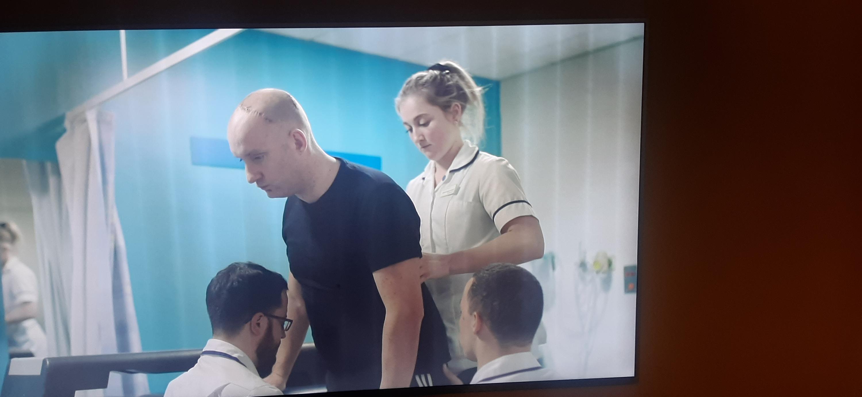

Backlight shadows ue75mu8000
    Anyone know how to fix these looks like it's off the backlight
    Re: Backlight shadows ue75mu8000
    Can you turn the backlighs down and see if that improves the situation.
      Tried adjusting that it looks like its pushing on the back light making it shaddow

                      I think it's the way the back lights are set up on these teles but not a easy fix without taking the glass out
                        this model here in germany known with this fault.. either samsung customer servivce knowing it and cant be solved via software.. the issue visible when you had many time HDR media content playing on it, try hard reset from service menu. if it solved avoid HDR to play

                                I have seen similar problem , the main question is , has this TV ever been taken apart? Looks like someone mistaken the order of disperser papers inside... or maybe the leds are running too bright
                                  No it's never been taken appart

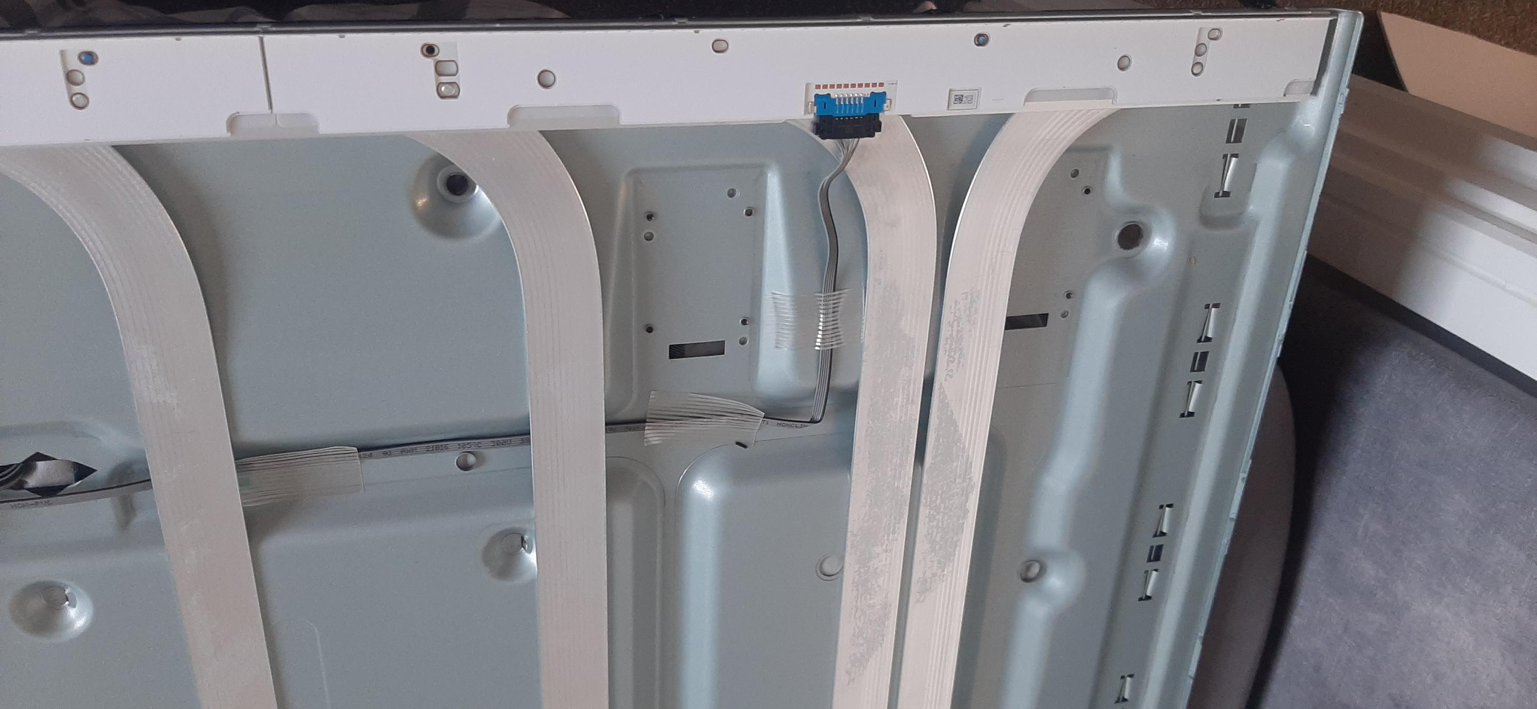

                                    Anyone know where to buy these backlight or replacement less for them

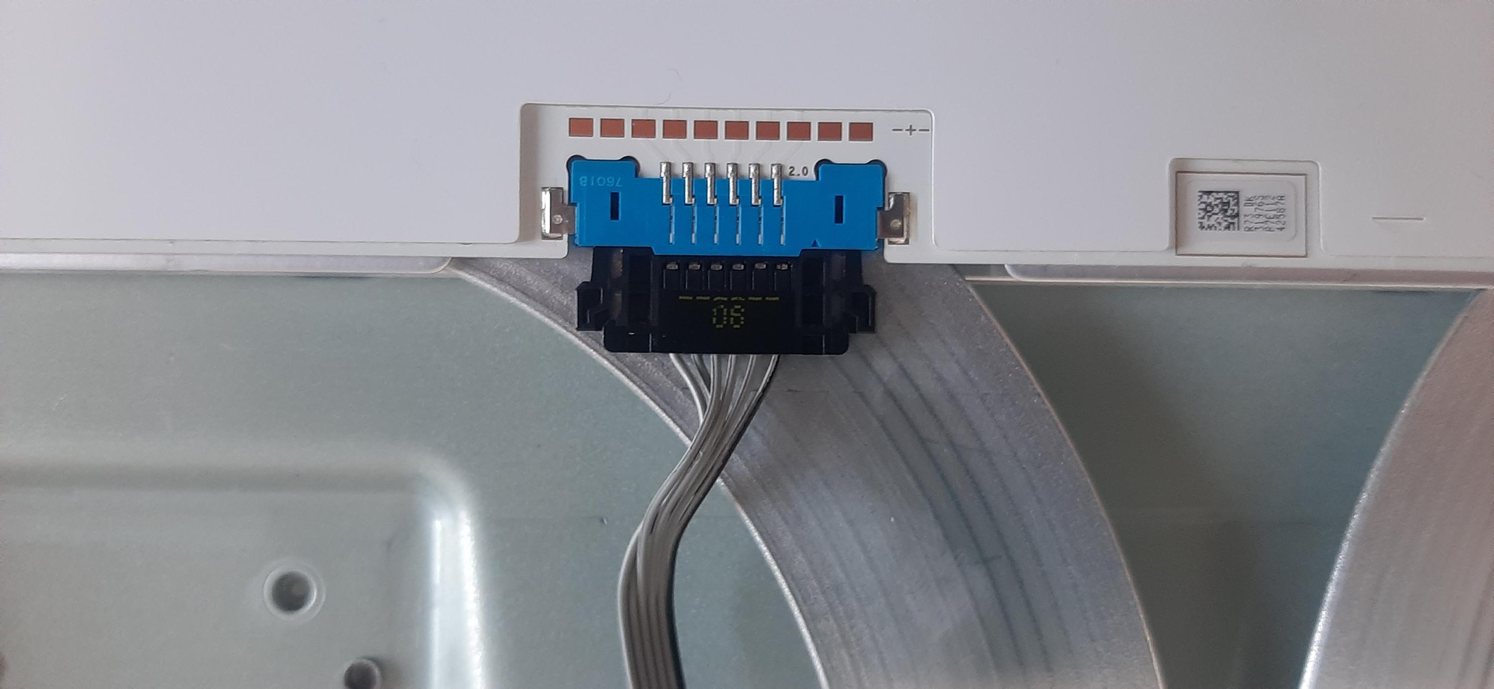

                                      Dont think they are running too bright as there are dark spots and sometimes the pic is dark
                                        Anyone know what order the sheets behind the glass go in
