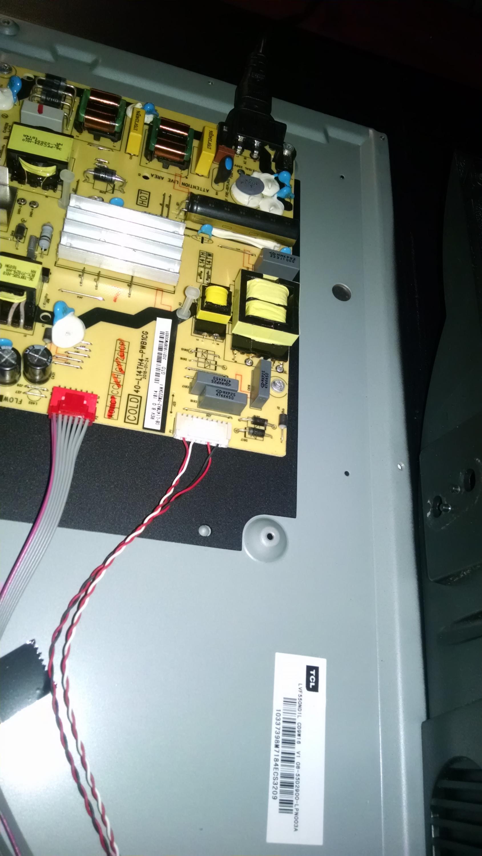

    I have a TCL 55s405 TV with the back light out, there 4 wires to the backlight(pic to follow) I would like to test the led strips without taking the set apart
    How can I find out the proper voltage to power the strips?

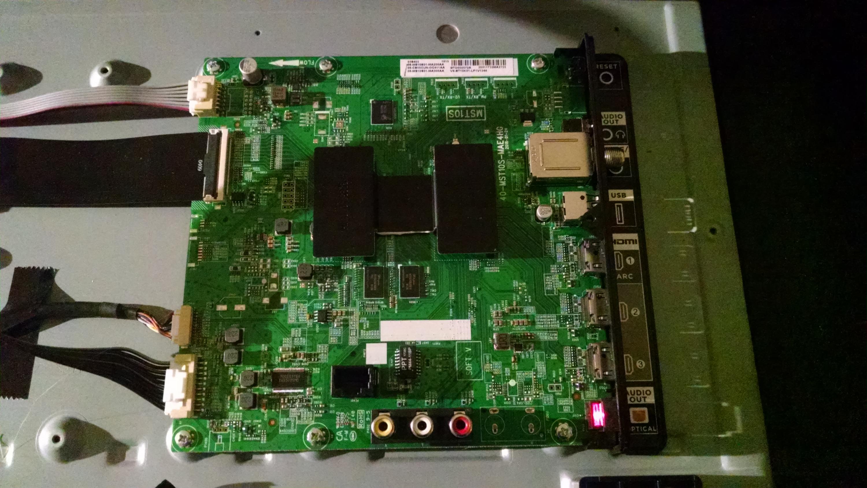

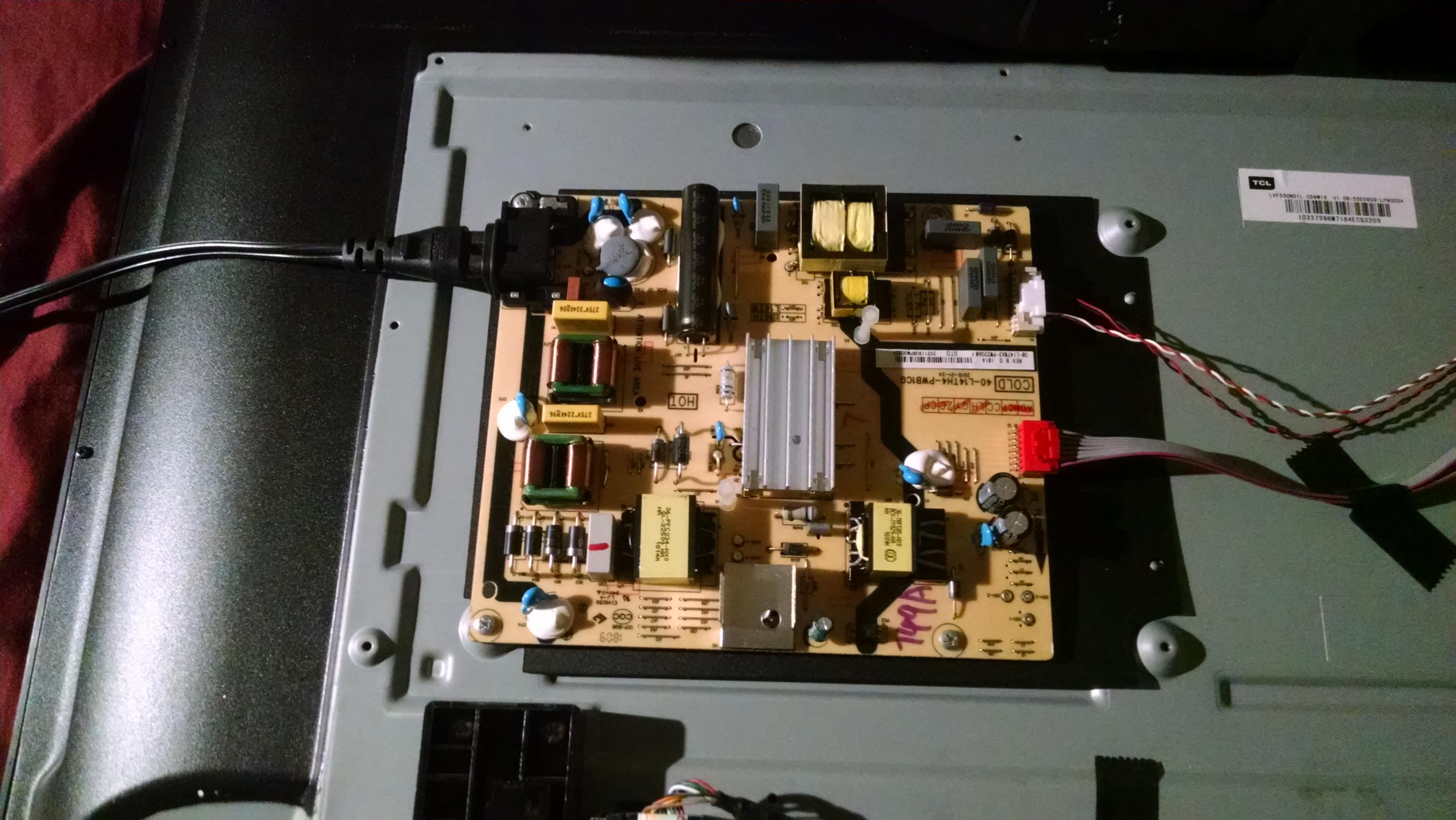

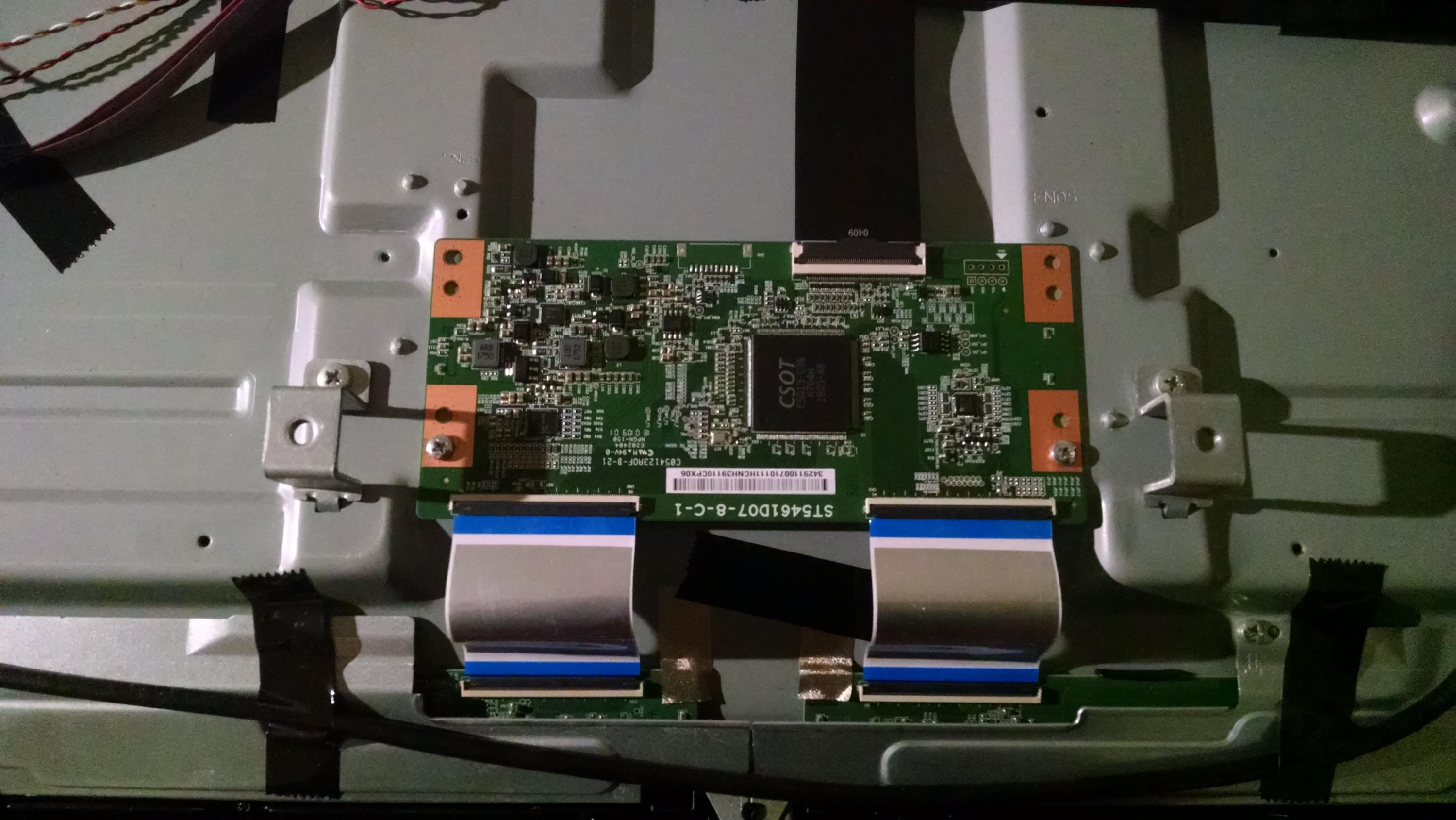

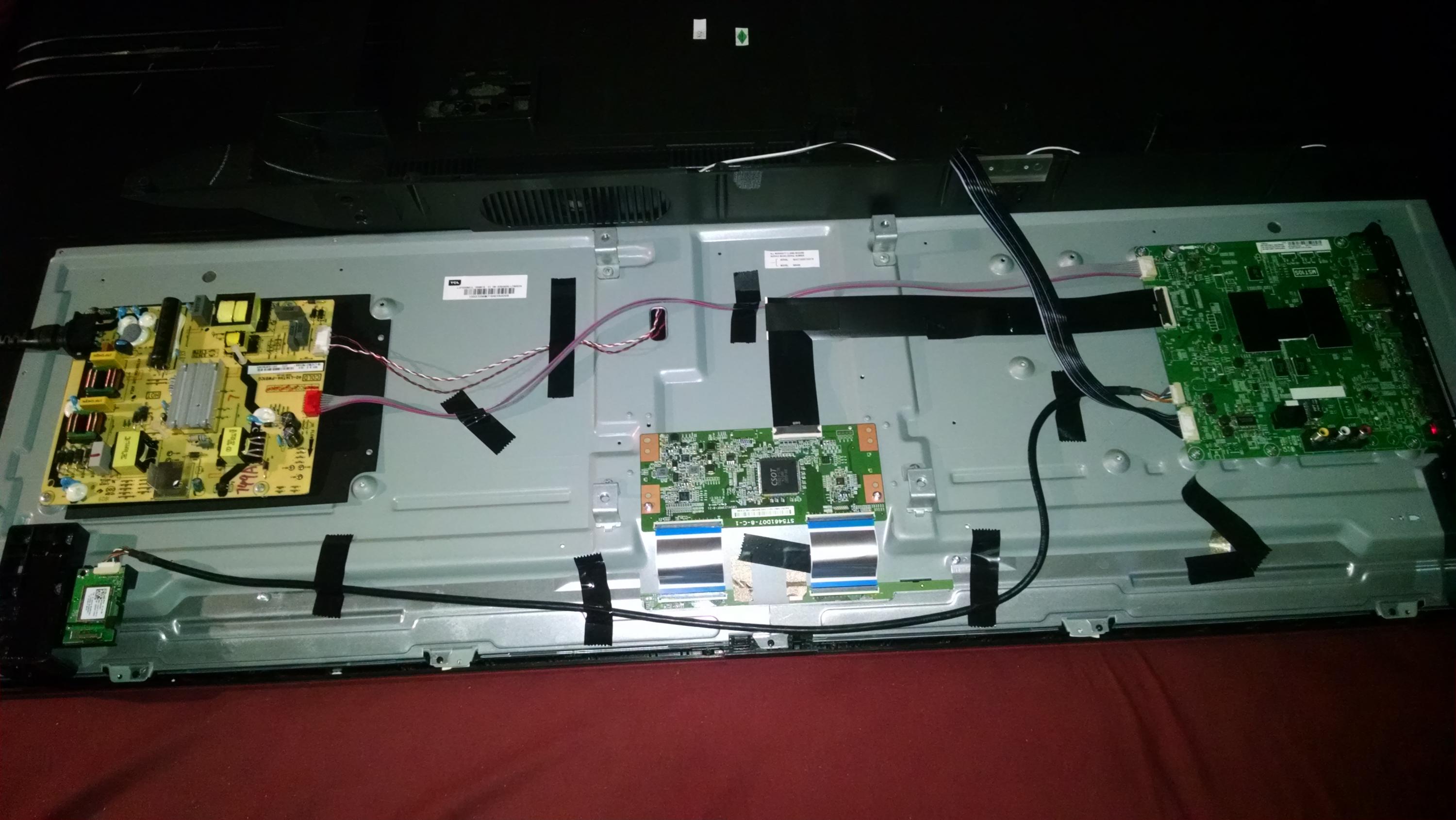

      Show us the pictures of the whole backside of the TV so we can see what we are dealing with.
      Also good clear straight shots of the power supply/LED driver board.

          Re: TCL 55s405 no backlight
          OK, you have 4 wires for the LED's.
          1) TV is off, set Volt meter to 200VDC scale, all connectors in place.
          2) Keep black probe of the meter on the chassis.
          3) Keep red probe on one of the 4 pin of the LED connector.
          4) Turn on the TV while watching the meter to see how high the Voltage jumps up to before it goes into shout down, then turn off the TV and wait 10 seconds.
          5) Repeat the same test on the other 3 wires.
          6) Report the result of each test.

            Top wire (black) goes to 200 -300 volts (my meter is pretty slow) Pin 9
            Second wire(red) always 0 Pin 7
            Third wire (white)always 0 Pin 4
            Bottom wire(red) goes to 40 - 65v Pin 2
            Goshen NY, USA
              You have open circuit (bad LED, bad connection between LED strips, bad wires, etc) for the LED current path to complete that is why the Voltage went up to 300V.
