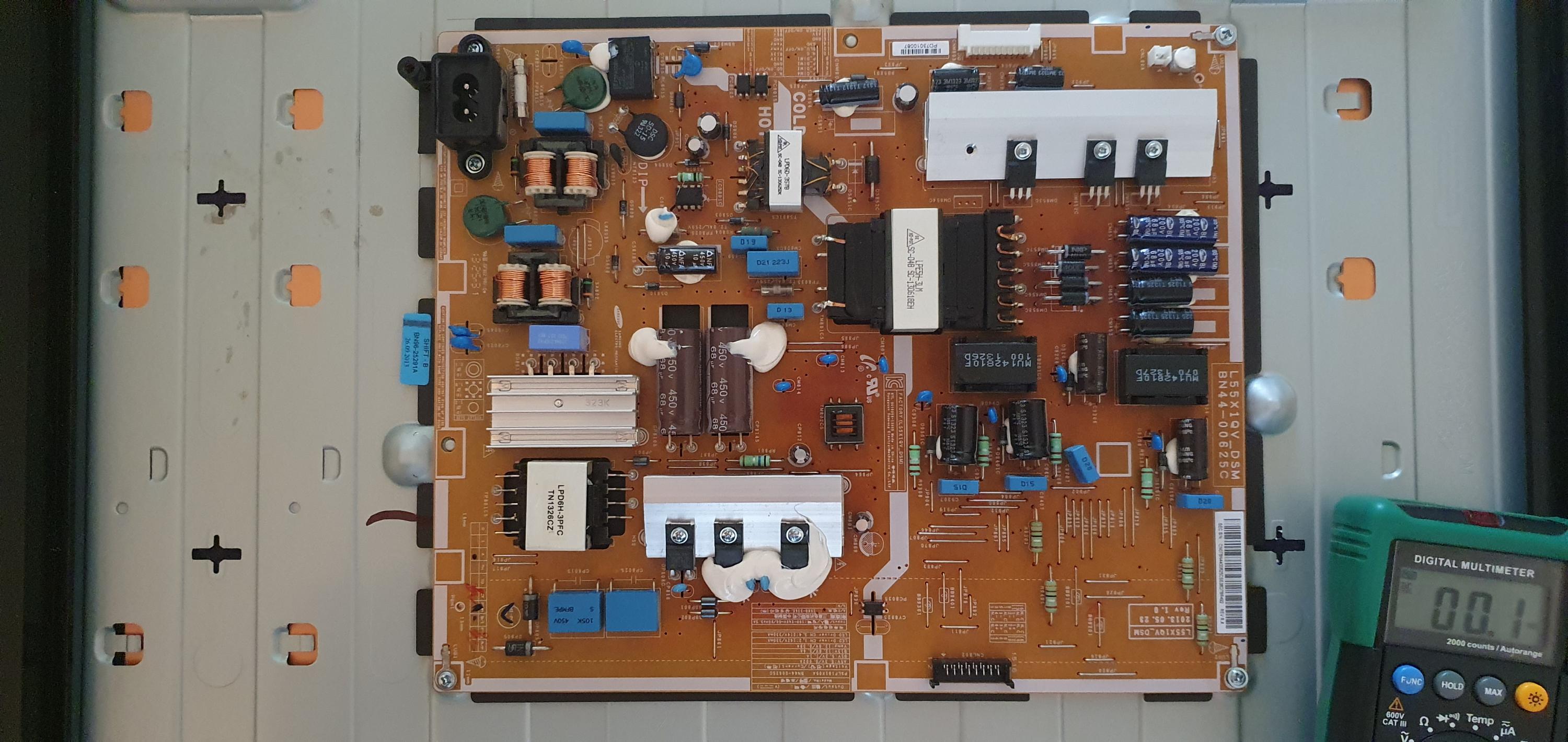

    Have an old Samsung LED 3D TV (UE55F6475). First it started to lose light on the lower 40% of the screen now and then. Like for 10-60 mins and then it would work again. Then a bit later it just got stuck in that position. The lower 40% of the screen is dark, and it gets progressively darker the lower u go so it's obviously that LED strips where not working. I also looked for similar errors online and saw an exact copy and on that one it was faulty LED strips.
    This is kinda how it looked, just that mine were at the bottom of the screen:
    Just so you know, there were no other cables attached to the TV except power and this problem still happened. I've seen some ppl talking about boxes connected by hdmi etc.. but I just used wifi, no hdmi or dvb cards connected etc. And the fault was there on hdmi and dvb as well.
    So I decided to open it to see what was up.
    After disassembling (removed the two speakers and the outer layers of the screen, I kept the IR/control connector from the frame connected) and revealing the LED strips I saw that some of the glas beads on top of the LED had came off (3 or 4) but they still seemed to work. My guess is they are just there to either have some function on heat or spreading light?

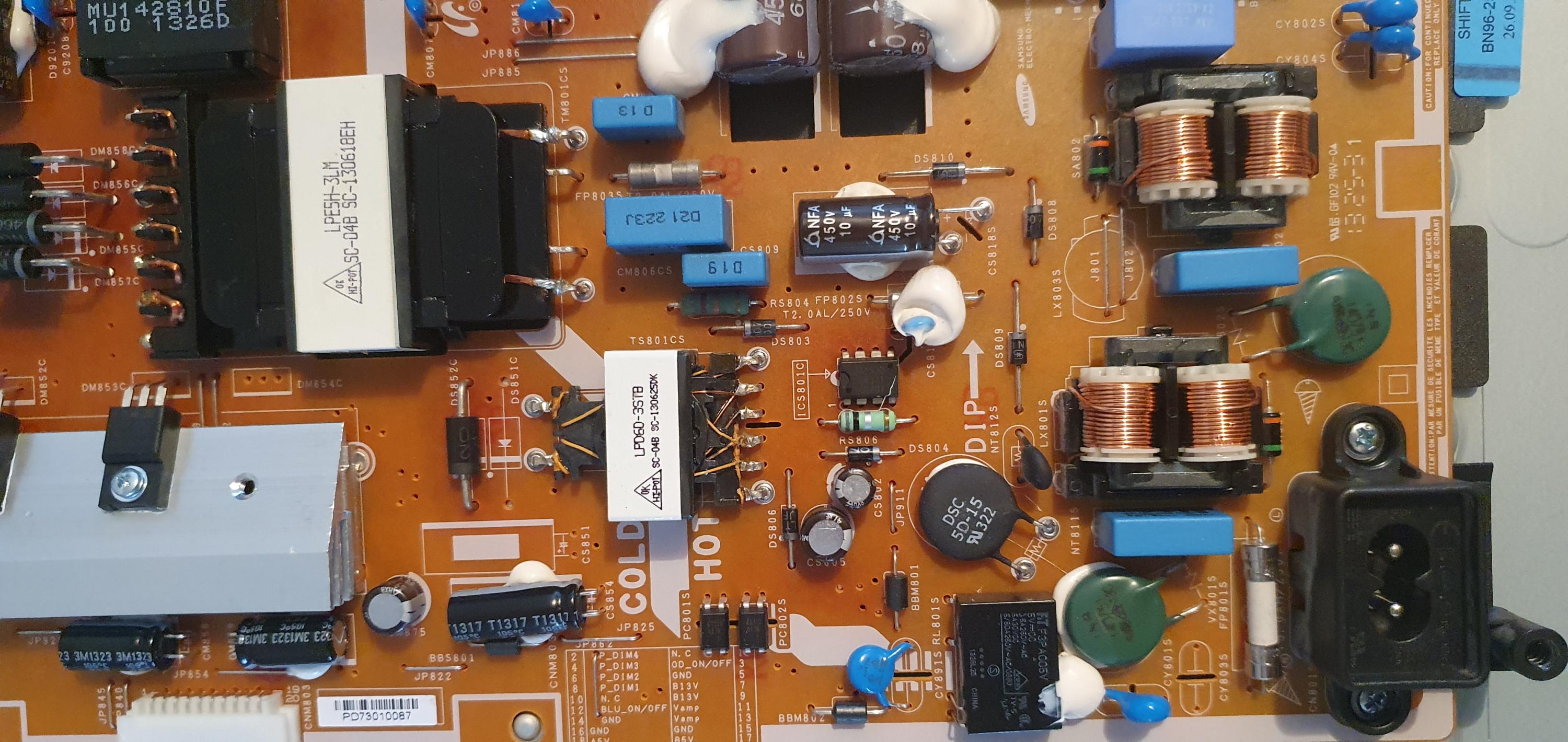

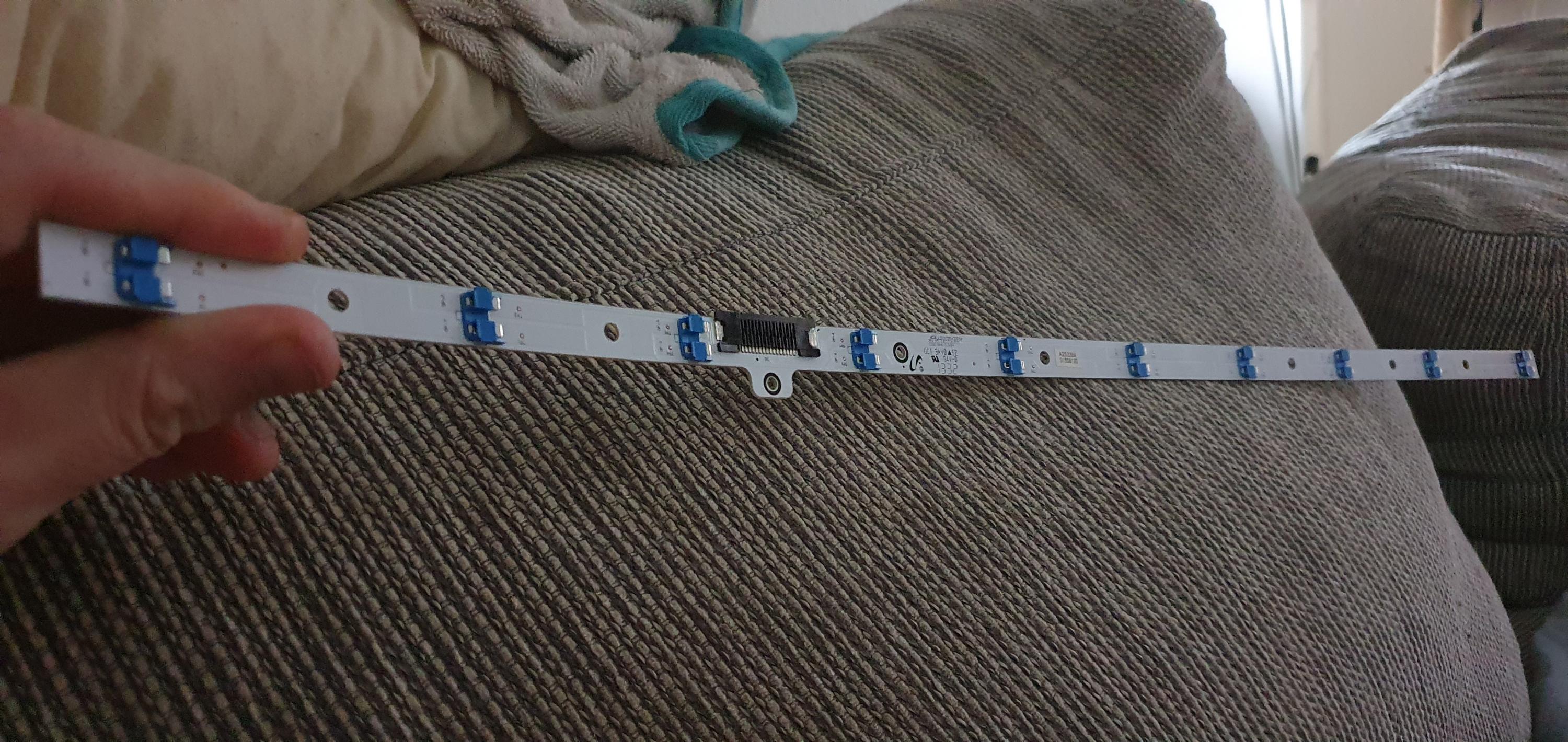

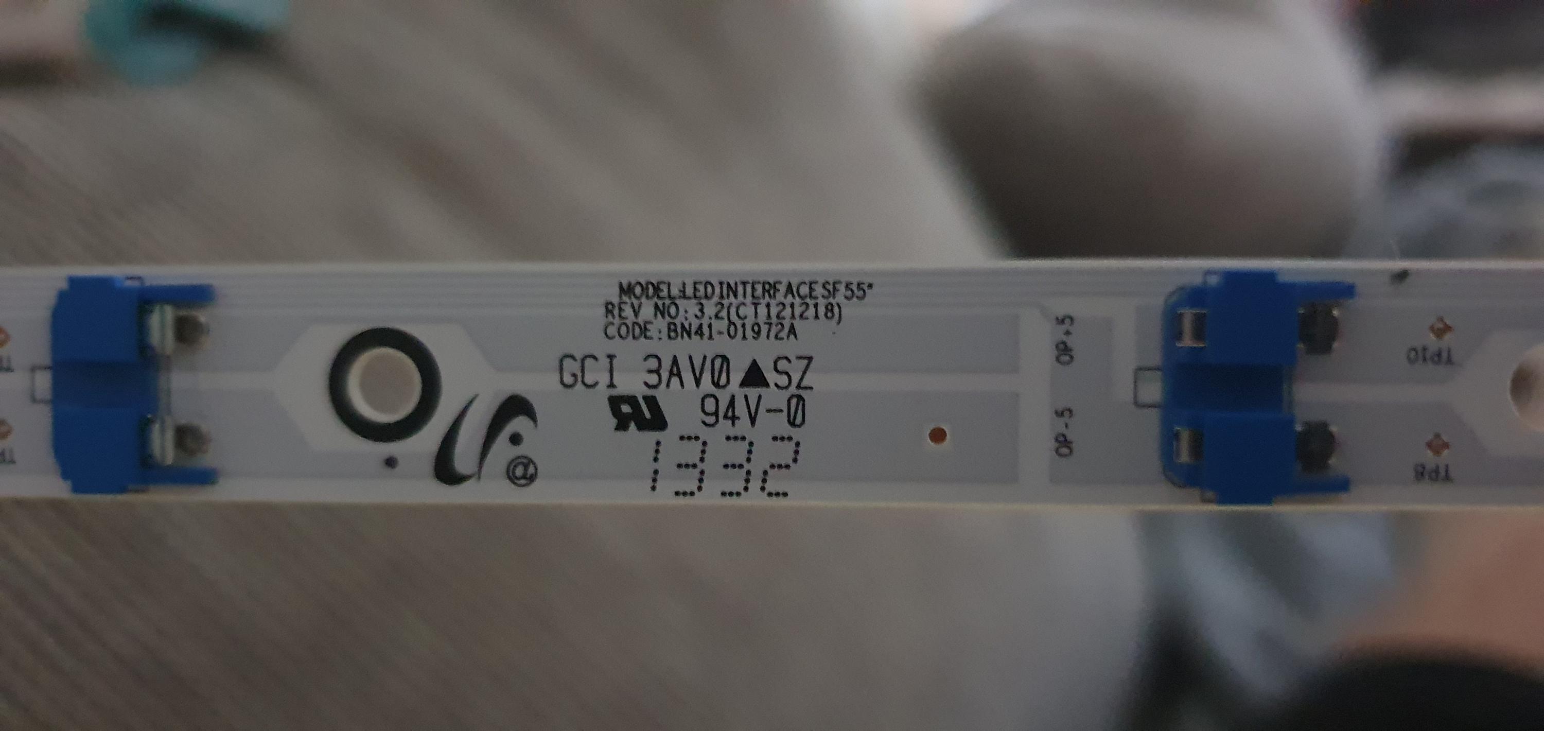

    Anyways, when I reconnected power to check the LED the top 2 rows light up. The rest of them just gave off a short flash every second or so. And I dont know if it's just an illusion but it seemed like the flashing got less bright the lower on the screen u went. On the bottom strip it was hard to notice the flashing.
    So to check the LED strips I replaced the top one with a lower one (one that had the bead on a LED fall off). And when it got in the top location it worked fine, and the top strip did not in the lower position.

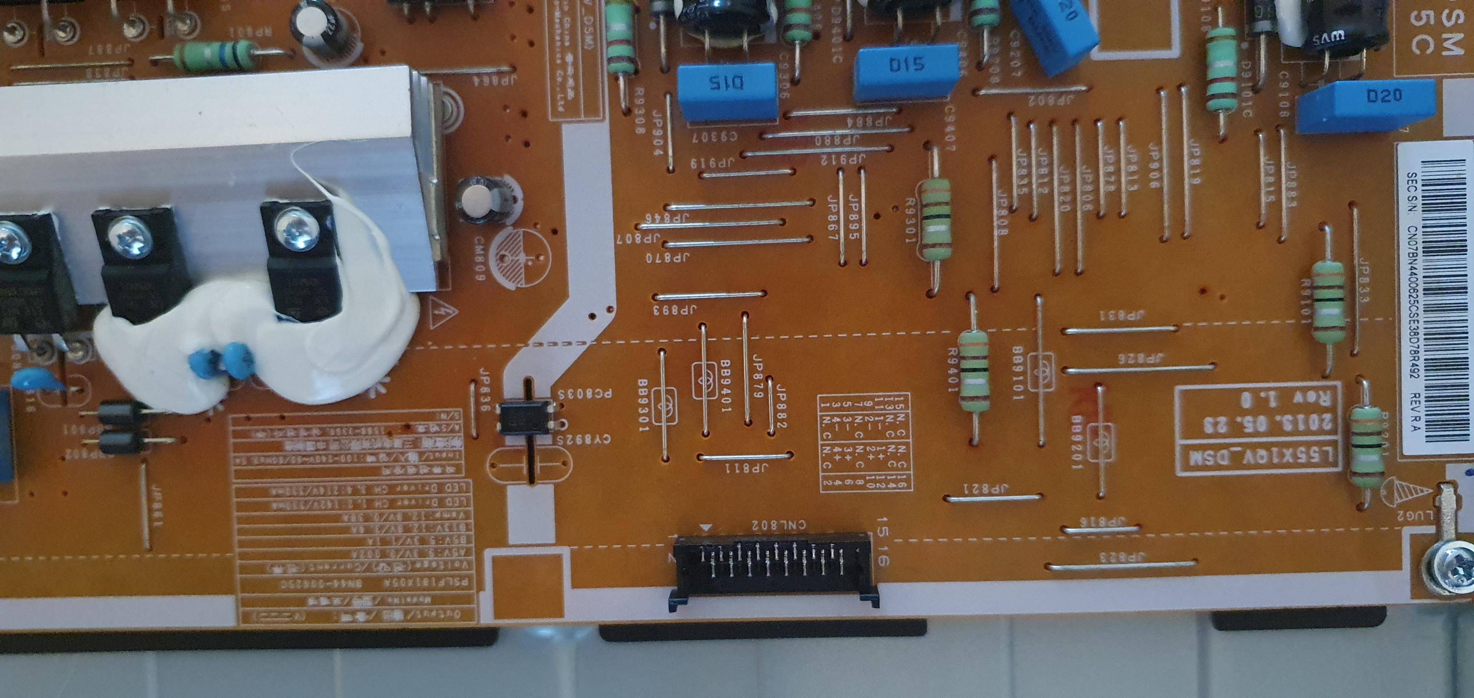

    Now to some technical info: it seems like the LED gets power from 8 pins (4/4 +/-).
    On the, I guess, power controller board there is info on how much it should be. Its divided into 4 channels. Ch 1 & 2 and ch 3 & 4. (Ch 1&2 142v/330mah, ch 3&4 214v/330mah )
    When I measured measured the voltage on the power controller output connection I got about 50v more than the info printed on the board. One thought I had on this is that it might be due to the fact that I had the light setting on the TV really high.
    From there the power goes to a rail where the different channels connect to the LED strips. 2 of the channels have 3 strips and 2 have 2 strips. By the way, when I say strips I mean 2 strips connected together since its a 55 inch TV. Just to be clear, but I dont think that have any implications on the issue.
    Each channel seem to have the strips connected in serial.
    When I measured the voltage on the top two strips I think o got around 55-60v (it was yesterday so not 100% of the exact voltage, but it was atleast somewhat constant)
    But when I measured on the strips that were not working I got really funky voltages.. it jumped all over the place.. but with quite low voltages. It wasn't constant.. it just changed all the time.
    I did a resistance check on the rail where the strips connect and at least there is no break anywhere.
    I can't understand how there can be voltage on the channels on the output connectors on the PCB but then when they get into the rail it's almost all gone and just jumping all over the place.
    If I'm not remembering wrong.. I might be.. the voltage on the faulty channels on the rail seemed to change from + to - on the multimeter.. like it had warped into ac.. but if this isn't indicative of some well known error then disregard it because I might have seen wrong since the numbers changed all the time and I had a hard time holding my somewhat large probes to the correct place.
    I think this is all I can think of for now. Please consider I am not a electrician! I have a basic knowledge of 220v AC electrical installation, and some DC low voltage tinkering, but thats it.
    So I understand somewhat how electricity behaves but TV repair is nothing I have done before (except a capacitor change, not this tv). So please think of that when replying if I've left out something important or said something stupid.
    I would really appreciate your help to fix this TV if it's possible. I have already bought a new one but would like to give this to my mother if it's possible to fix it since she really needs one.
    If I need to get new measurements or more pics just tell me where to measure and I will do it. I didn't think of asking on a forum until after I was done trying so maybe I missed some things. And please forgive my English, I'm swedish!

    W8!!! I forgot one very important thing!!!!!
    When I measured the voltage on the output led channels from the PCB, and I measured between + and - on the connector, I got the same strange jumping power readings as I got on some of the strip connectors on the rail. But when I measured between the + connector on the output bus and one of the ground screws on the corner of the PCB I got the numbers I mentioned above (about 270v on 2 channels and about 190v on the other 2 channels)
    I just remembered this! Wouldn't that imply some grounding error somewhere? Can I just make a new ground for the non working LED channels?

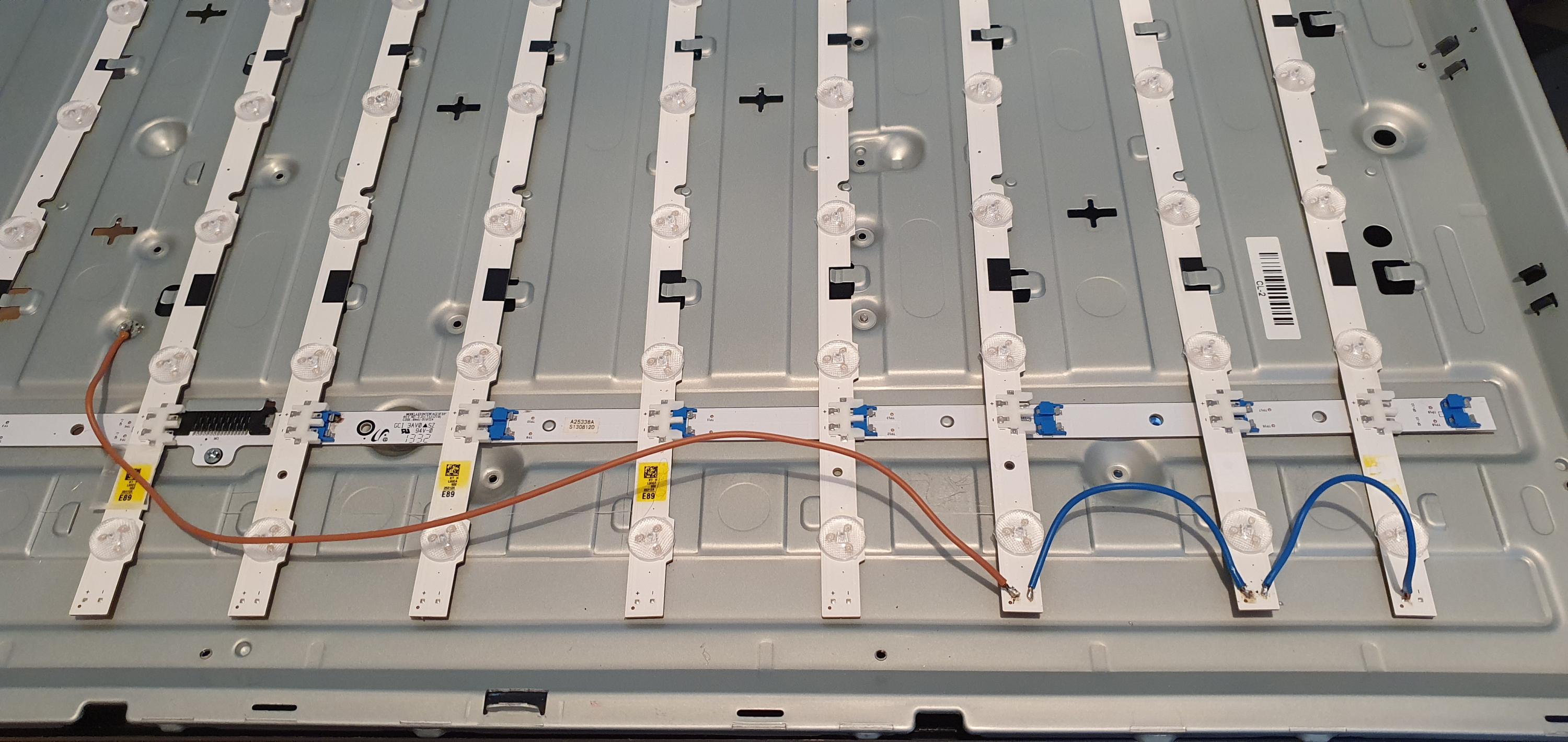

      Did some more experimentation.. I can't get the LEDs to light up but maybe it's my lack of knowledge.. I just did a simple serial connection at the end of 3 stripes, where they have +/- connections, and connected one end to the 270v on the connector that these 3 were supposed to go to, then I connected the - to the ground screw.
      But the only thing that happened was a short weak flash of light from the first led on the chain every time I connected it.
      Btw.. do these LED work whatever way u connect -/+ ? Or do they only let through the electricity on way?

          Driver ch 1 works fine (2 strips). Ch 2 don't, also 2 strips.
          Ch 3,4 don't, 3 strips each on them.
          I'm quite sure it's not an led issue since it was the lower strips that quit working.. and when I moved the bottom one to ch 1 it light up fine. So its probably in the connections or the power board.
          If someone has a video or schematic that explains how samsung gets power to the 4 individual led drivers and what components that are involved it would b great.

                    This: "The current and voltage are monitored by the power board if they go out of tolerance they shut down the output for that output on the leds."
                    I suspect your TV has LEDs that are aged out and drawing too much power. The upper channel tolerates slightly more power than the bottom one. That's why you can move your strips around and get the results you have. That's been my experience with that model anyways.
                      Thank you for your answer!
                      That seems logical! The TV was bought new in 2013-14.. and was used until 6 months ago like 18 hrs a day atleast. So that something just snapped is probably likely.
                      But the two top channels are both 2 strip channels.. while the other 2 are 3 strips. So wouldn't the 2 channels with 2 led strips on them behave rather same? Why would samsung build it so the top one can tolerate more power? Seems like a strange design when u have 2 ch that skall provide power to same amount of led to build them different instead of just copy n paste.. from an engineering standpoint seems strange.
                      Is it possible to find led strips to this model? I've looked But it seems hard to find.. its just other kind of models.. or can u modify any led strip with the same voltage on the led to fit it?
                      I read that there are different kind of led that gives you different kind of light. How do you find out what kind your TV has? Now that I think of it there was a small yellow sticker with a barcode on some of the strips.. that might give some answers.
                      • diif
                        • Feb 2014
                        • 6978
                        • England
                        Re: LED problem on samsung UE55F6475, 2 strips work. The rest is flashing every secon
                        Aliexpress for your new LED strips.
