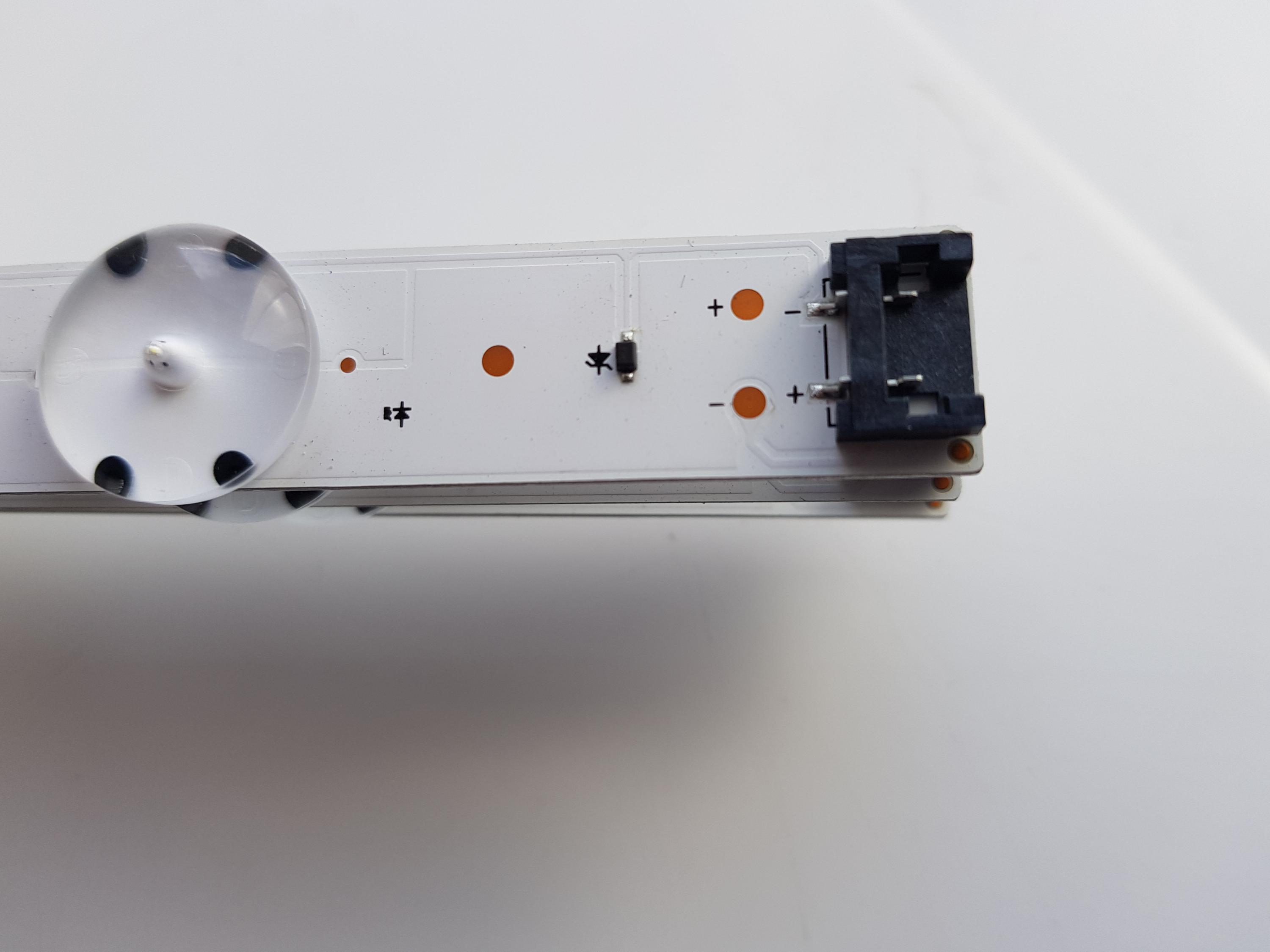

            Re: LG 43uh620v 4 red lights, no Led backlight
            Does anyone know what diodes these are ?
              Is the Cathode of that Zener diode connected directly to the + pin of the grey connector?
                I'll have to look and report back I've also looked and the writing on the diode is 6F J5
                  Hi budm
                  The cathode is connected to the - pin of the connector
                    Originally posted by sordids999
                    Hi budm
                    That cannot be, you can see the trace from the - pin of the connector that goes to the Anode of that Zener (top end of he Zener), but I cannot see the trace connected to the Cathode of the Zener.
                    The Cathode looks to be connected to the large copper plane which is also connected to the + pin of the connector.
