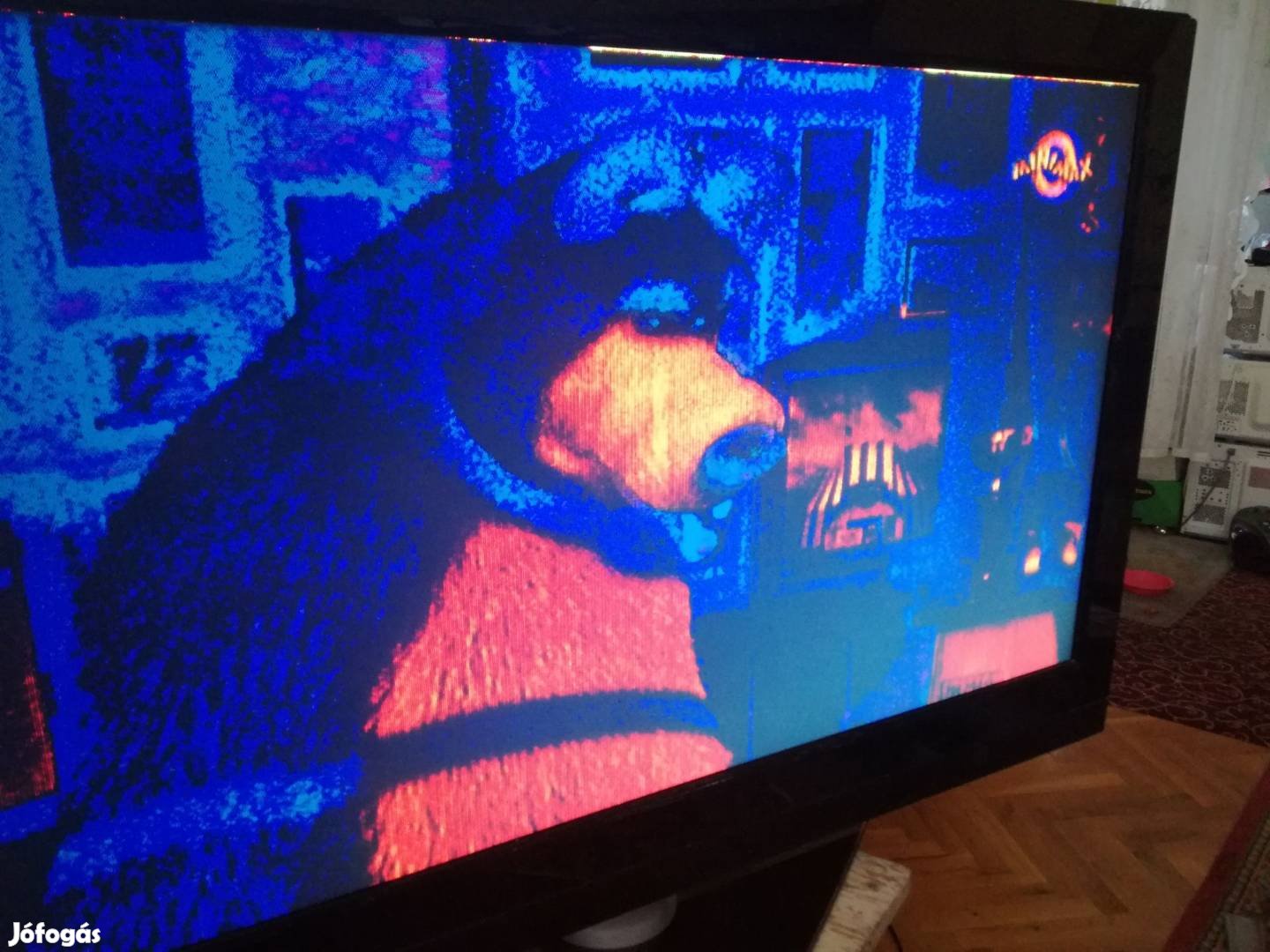

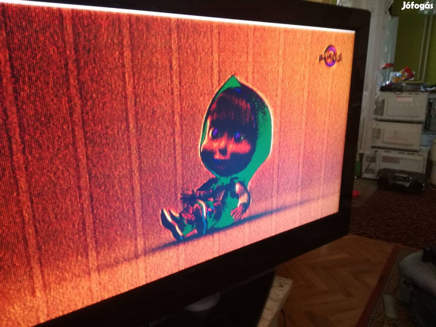

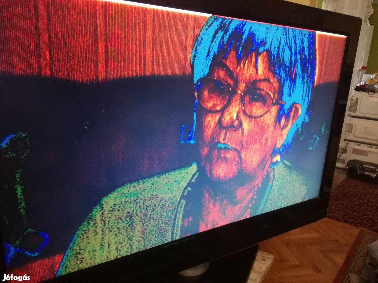

    Hello!
    I have already fixed some TVs in the past years, but now I am planning to buy another faulty unit for cheap. However, checking the pictures that the seller made, I can't decide if it's a Gamma problem or not.
    I'm open to learn new thingies, but I don't wanna waste too much money if it's not repairable.
    The seller sent me the 3 attached pics.
    What do you think?

    Re: Does this seem like a gamma problem to you? Philips 42PFL3512D/12
    Looks like an AS15F IC issue to me ! That is located on the T-con
      Yes, I have fixed that kinda problems too recently, but this color distortion seemed a bit different from what I saw before. I wasn't sure.
      But if more people agree on the AS15/AS19 chip, I will buy it and give it a try.
        freeze the ic and see what happens
            Is it worth an expensive transport for a very old tv? Yes it is surely gamma problem, as15 if i remember. I have fixed the as15 on the 37" version. I remeber that was not a good bargain because it had channel memorization problem that needed too much expensive Philips service update, and it had no LCN organization.
                    I would give it a shot, it looks like typical bad gamma chip, try freeze test as suggested. Philips are good tvs, I have one and it's every bit as good picture as a sony or sammy.
