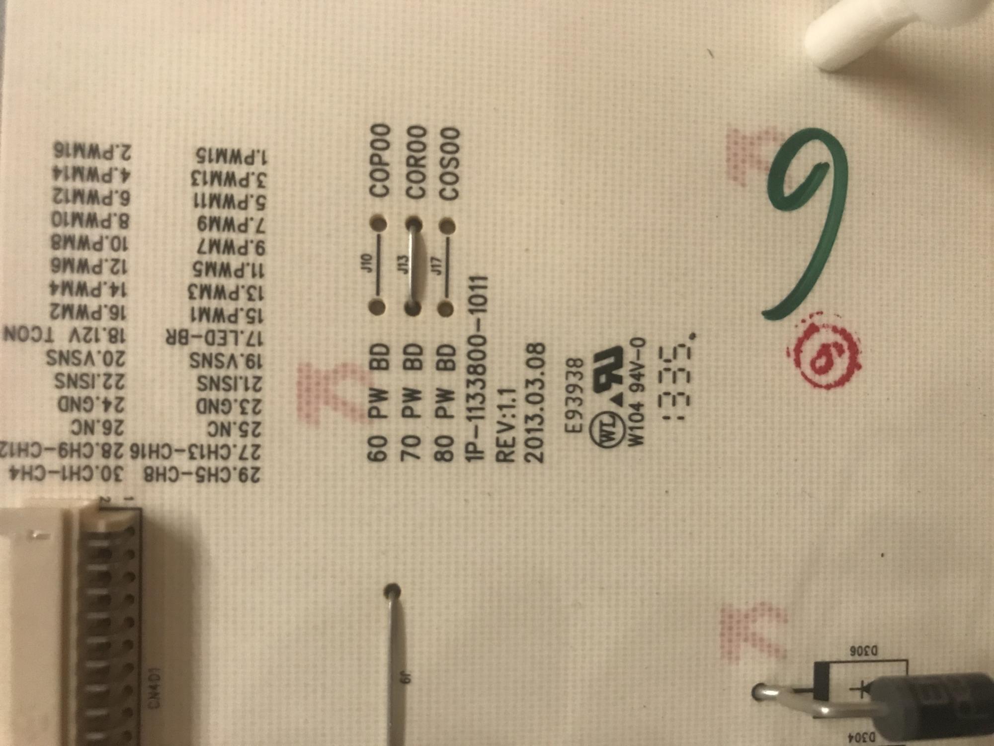

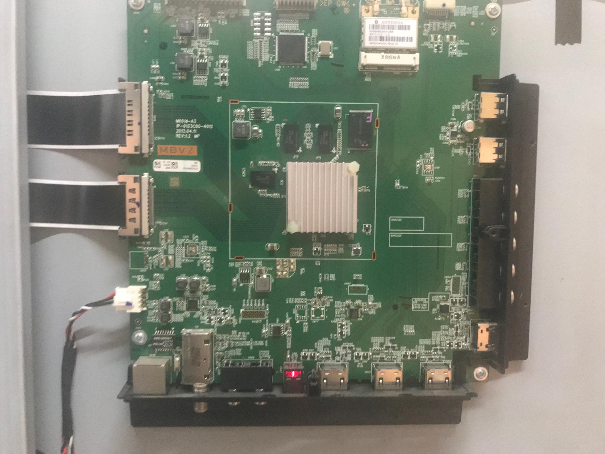

    I was gifted this monstrous non-working 70" Vizio. The story goes that it was working flawlessly for 6 years and then one day the screen was black. "Just needs a an inexpensive board!", I was told! Bwahaha! Unfortunately my extensive internet research has not provided me an answer as to exactly which board I might replace! This particular Visio has relatively few posts on Badcaps, though there is a robust thread from throngs of owners that had the opposite problem from mine (backlight but no image) and board replacement was NOT the solution.

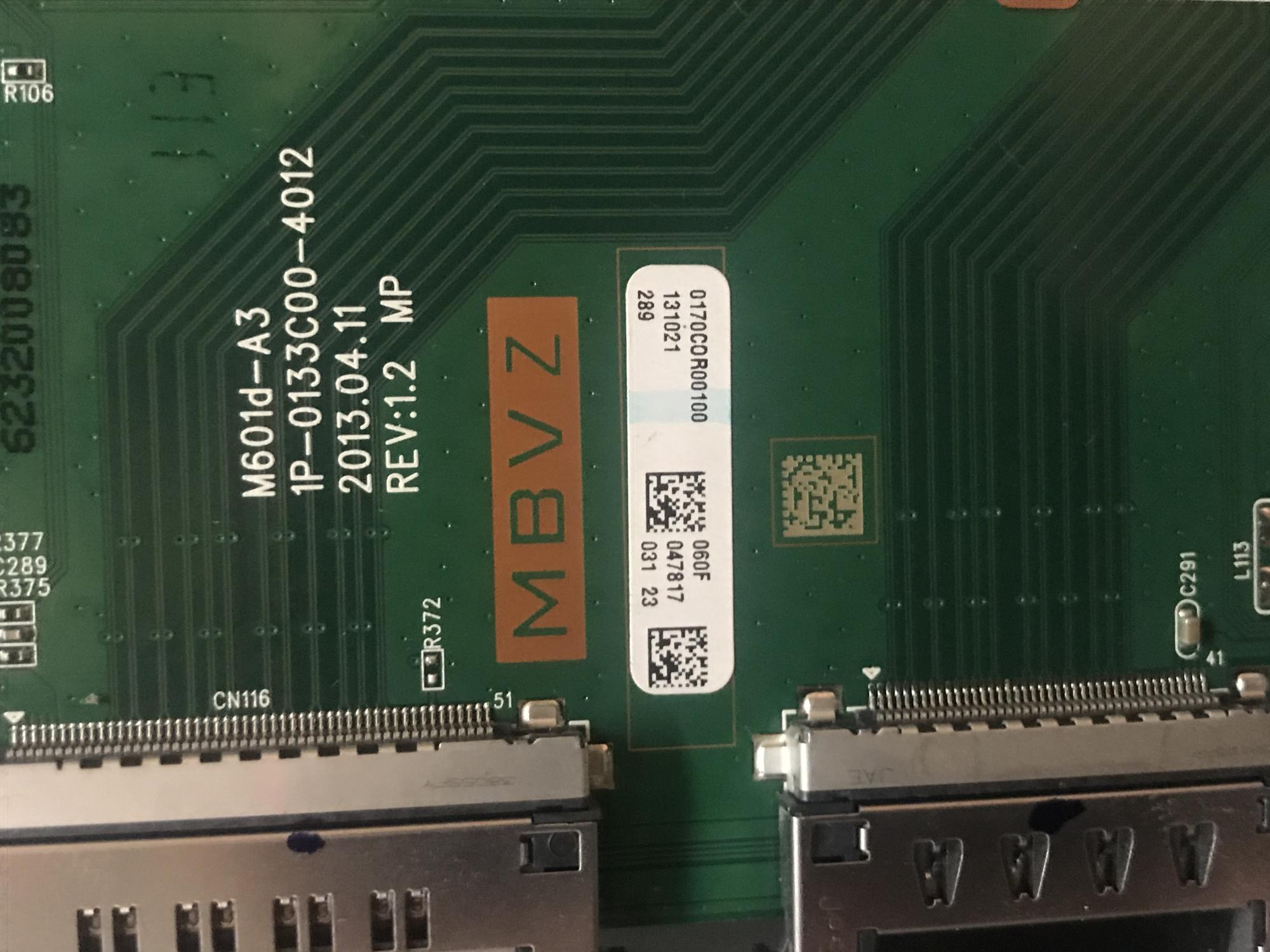

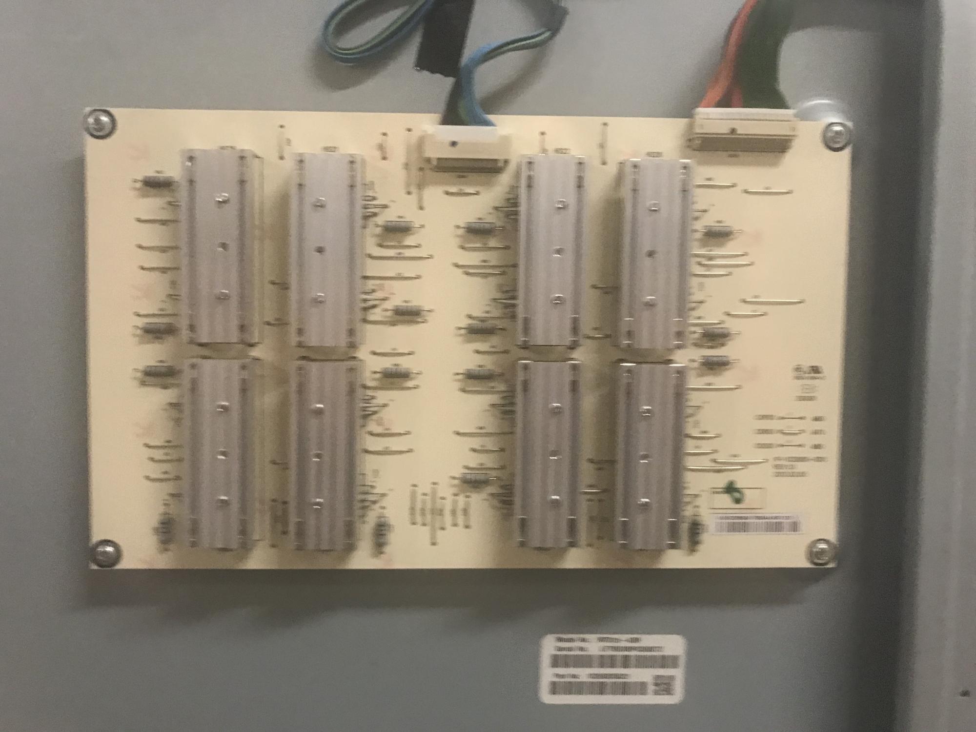

    This TV has 3 Sharp boards (not counting the T-con board—which is still under cover at the bottom of the unit): main logic board - 1P-0133c00-4012; LED driver 05-70COR000-00; and power supply E93938 1P-1133800-1011.
    The unit powers on. The logic board appears to go through a self test (red LED on board flashes once and then stays on). I see no visibly damaged components on either side of the boards. The flashlight test shows that I have an image on the screen. (I don't have a proper audio/video feed in my shop, yet—I'm a pinball guy, not a TV guy!) but I can see with my flashlight a "no signal" message. I plugged in a USB flash drive with images and it appeared to be accessing that. I had hoped that there were more test points with labeled voltages on the boards... I only see 12v markings on the power board and these are present. No other voltages labeled, dammit, but I see .
    I realize this is rather scant information. At one point shopjimmy.com had all three boards for $135 (now, out of stock). If that were an option, I'd gladly take the shotgun approach to this repair! I am hoping one of you pros will have seen this scenario and will immediately point me to the likely culprit (though the Web shows no postings anywhere with this exact unit/issue)!
    I know it's never this easy! I am anxious to provide any further diagnostic data. Thanks in advance!
    Lance

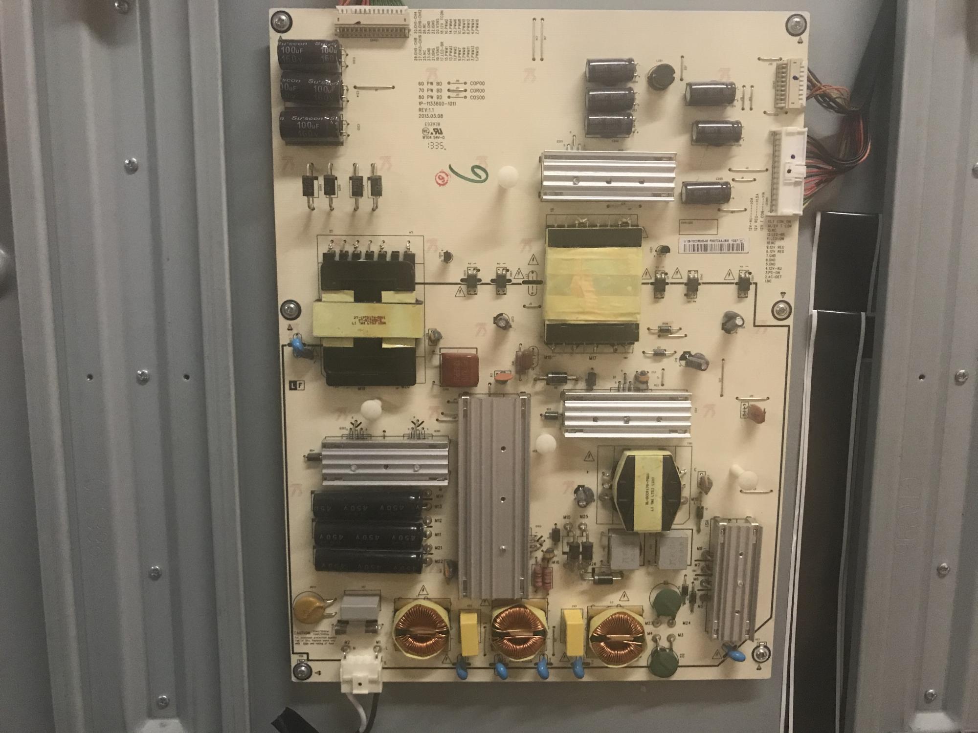

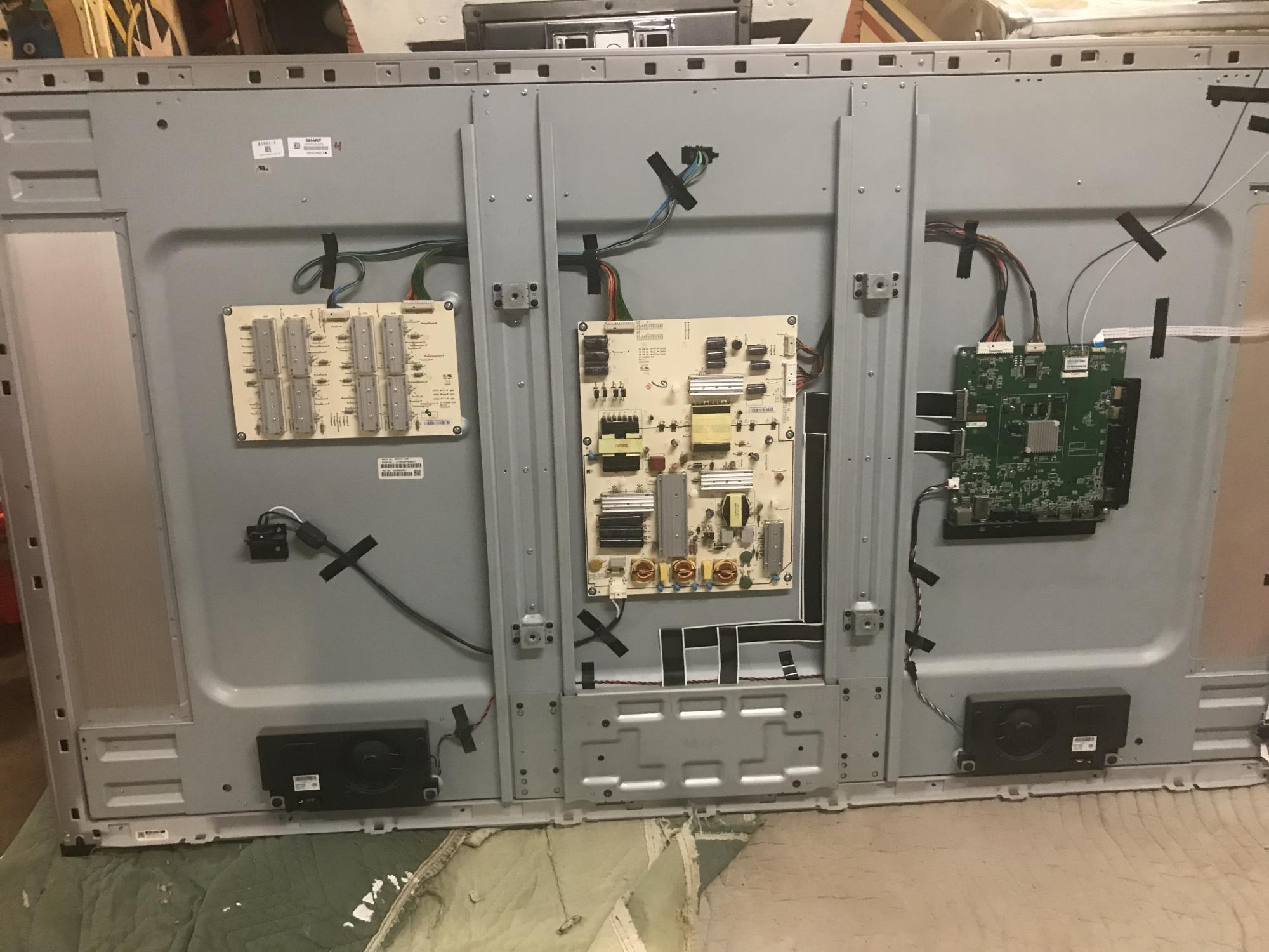

    Please attach good clear pictures of the whole backside of YOUR TV so we can see all the boards and how they are connected together so we can see what we are dealing with.
    • Lance_Foster
      • Sep 2020
      • 7
      • usa
      Re: Vizio M701d-A3R M701D image; no backlight
      Thanks, Bud. Images attached.

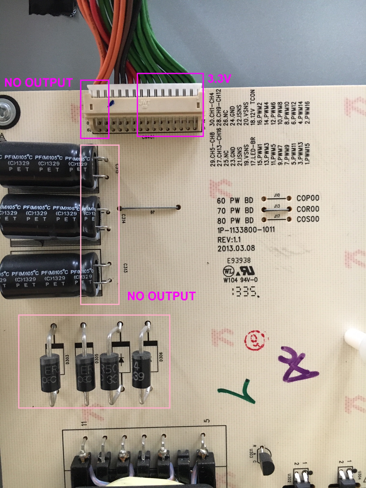

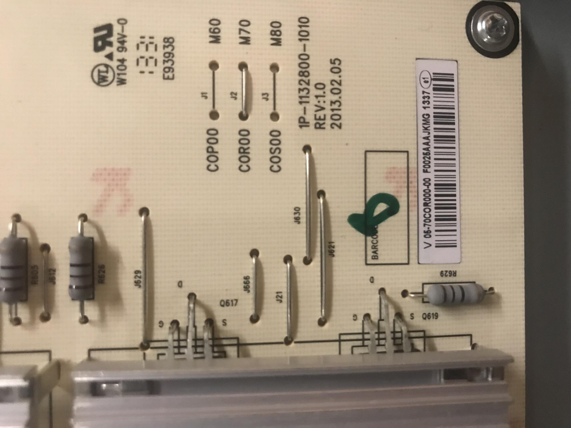

        Check if you're getting an output from the power supply to the LED driver because I'm not. I'm also having an issue with the same problem. I checked the backlights and they're working with the tester.

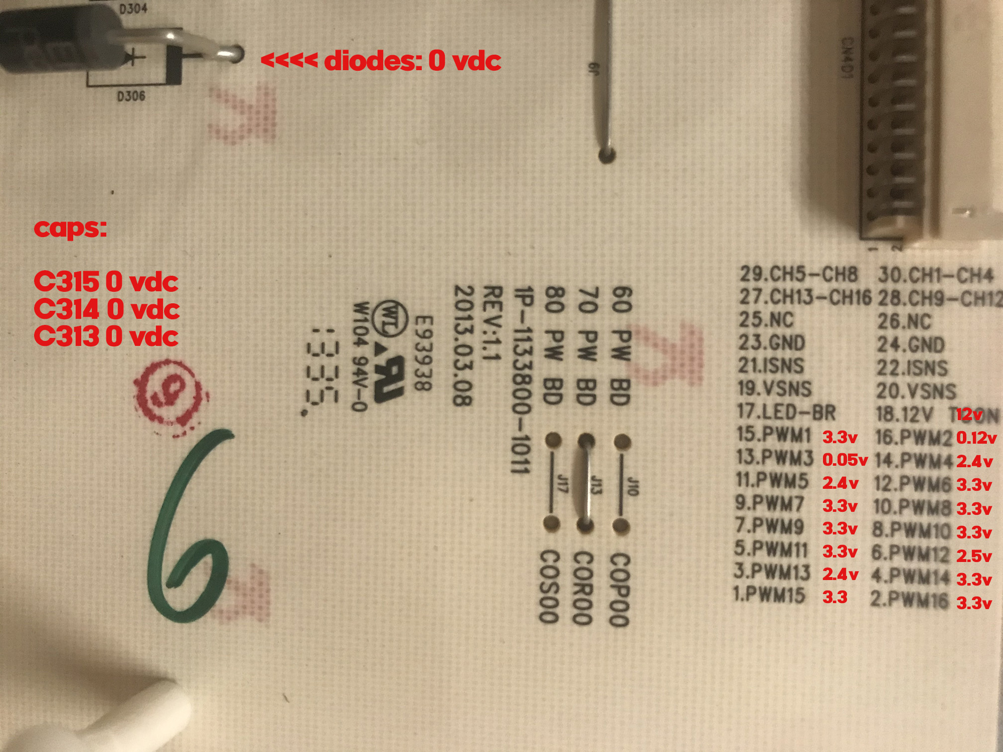

            Thanks for your replies. Attached are voltages power board-to-LED board.
            I perviously attempted to access (and see) menu... will give that another go.
            Thanks, again,
            L

                • Plurxtc1
                  • Oct 2014
                  • 136
                  Replacing the power supply fixed it. 80V shows up on the capacitor to the backlight and the lights came on.
                      I want to provide some closure to this thread. I took the Vizio to a proper tech. He determined that it was the LED backlights that had failed. For $320 he replaced the LEDs and the TV is working and looks fantastic. So... a 6 year old $2000 TV for $320! Winner! Thanks all for your help!
