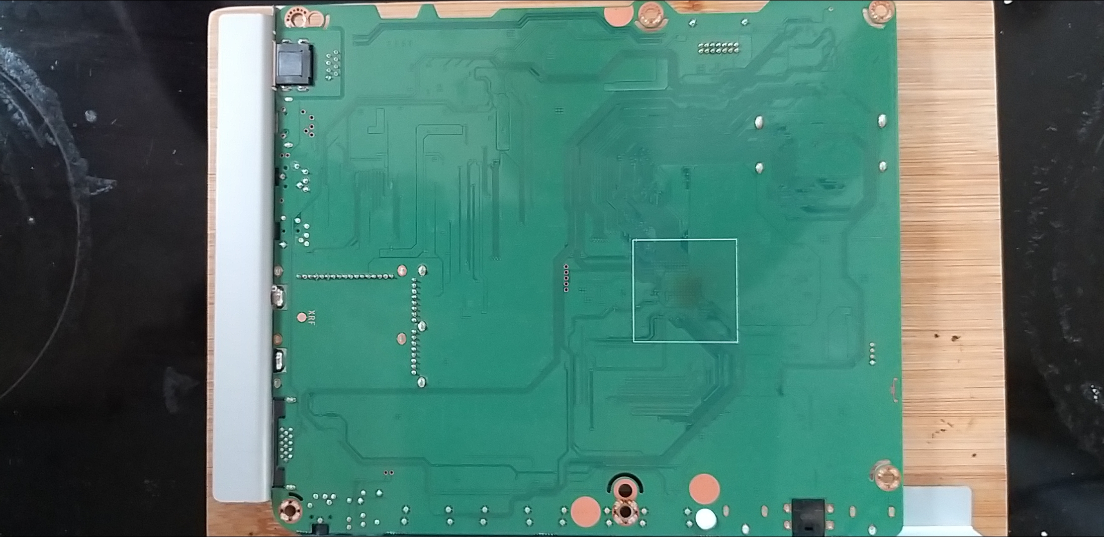

    From initial power (plug in socket) the tv immediately turns on and goes in a boot loop.
    Power on,red stby light, Samsung Smart logo, 4 red blinks as logo goes and Hdmi1/DVI 'Source' appears on screen but no picture (now tv box connected to hdmi1 port), tv shuts down and cycle starts again!
    First thing to try I guess is fw update, but is it safe to do so? taking into account its power cycling.
    On initial inspection the boards and connectors look good.
    Disconnect the main and the backlights come on and remain on, no power cycle/shutdown.
    Photos to follow

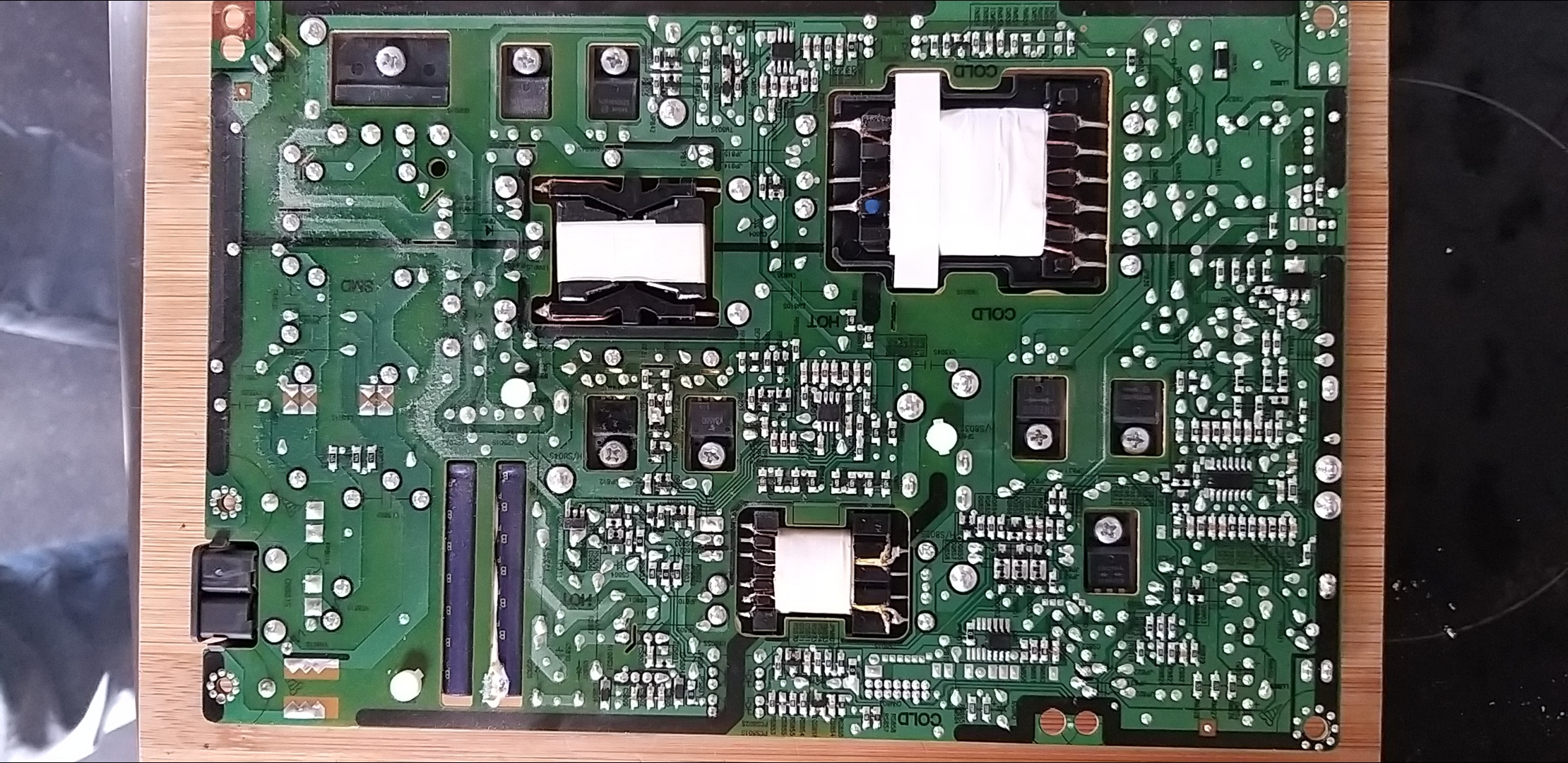

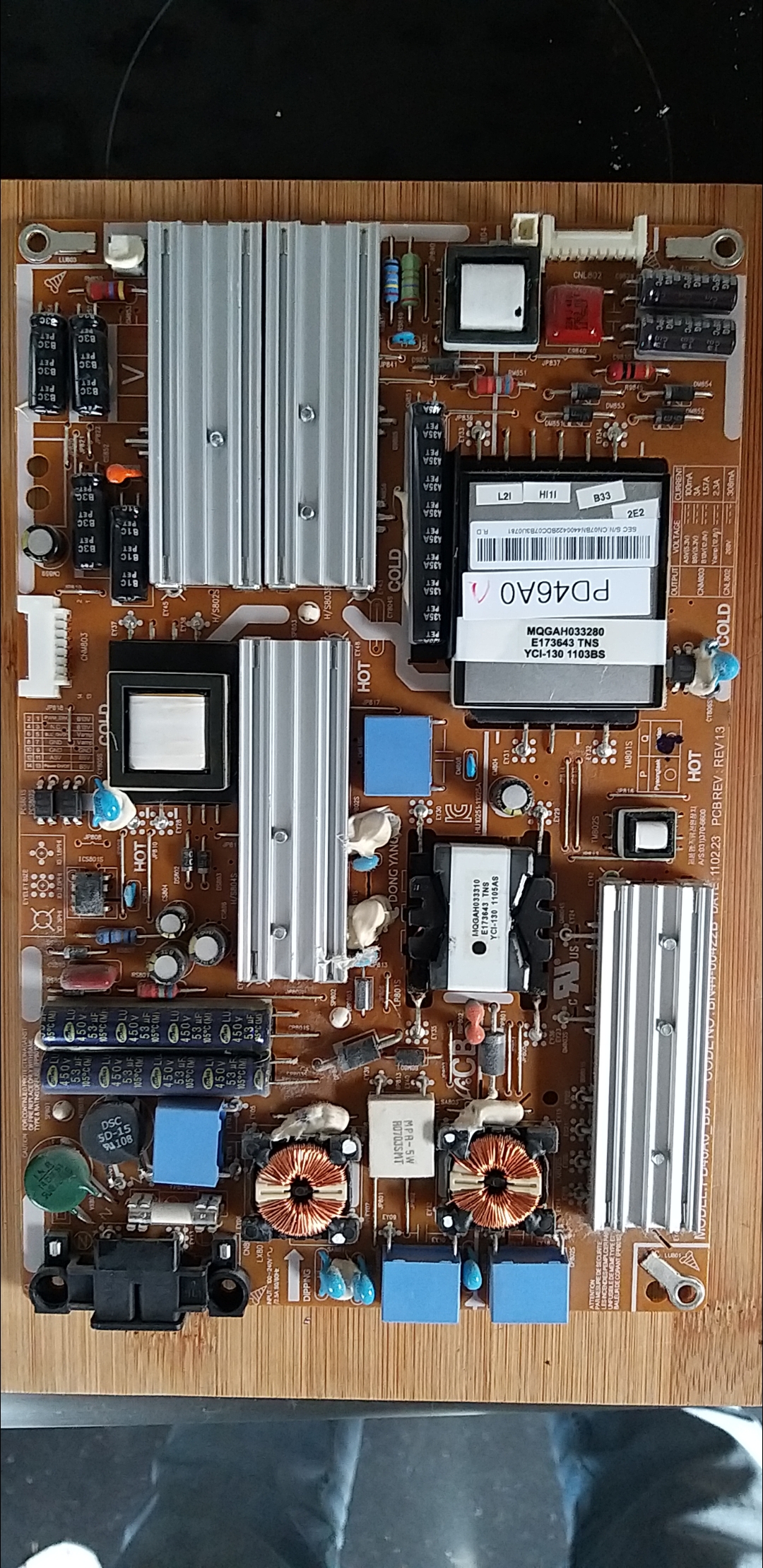

    Psu - bn44-00422B rev1.3

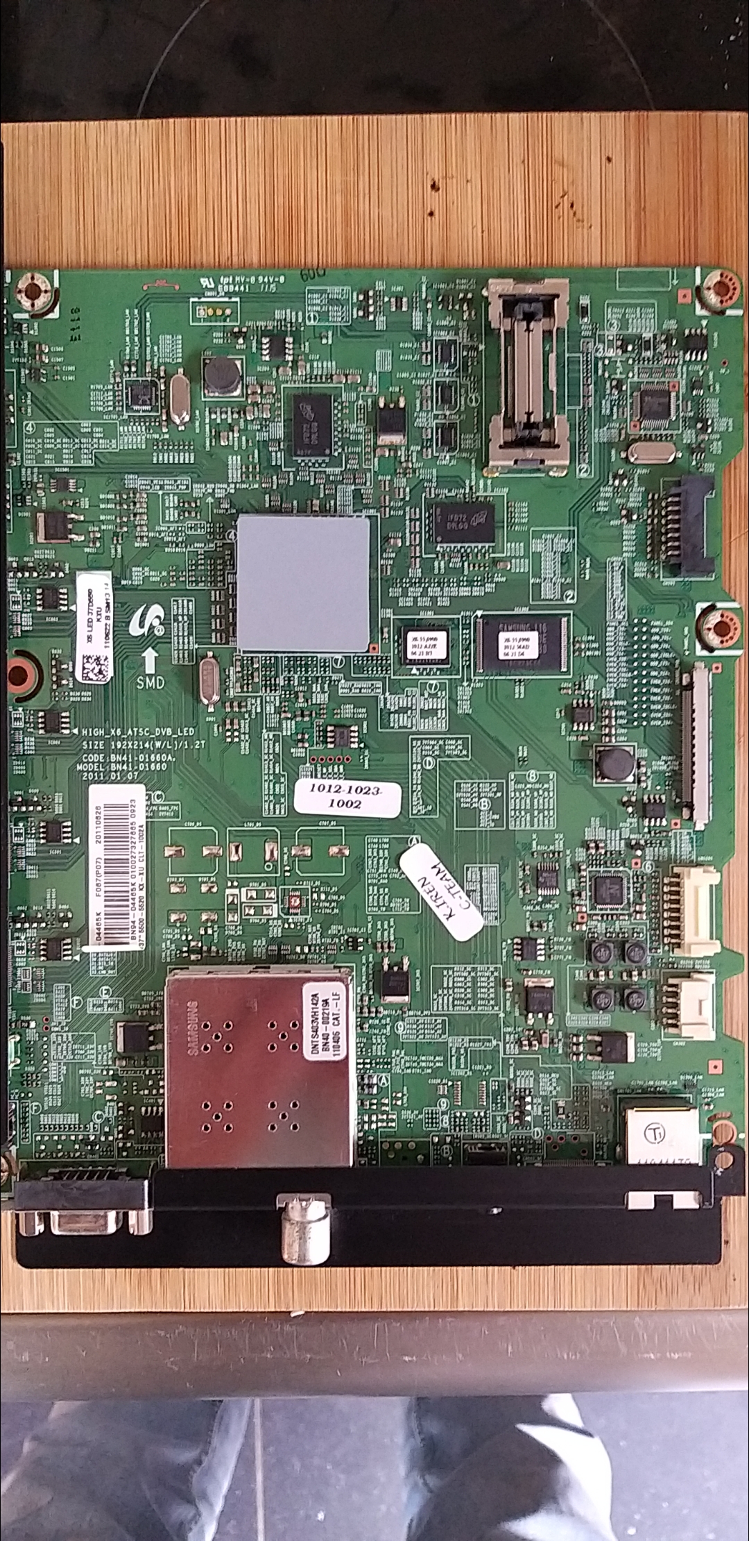

    main- bn41-01660A

    The D5XXX series is famous for this defect. Try cooling spray on the nand memory. Before starting or immediately after starting.

      It's usually bad blocks on the Nand causing a boot loop after showing the logo, you can try an FW update but it usually needs replacing.

        yh, I was hoping I'd get away without having to change the nand. Main board swap is def a no-go as they are stupidly priced!
