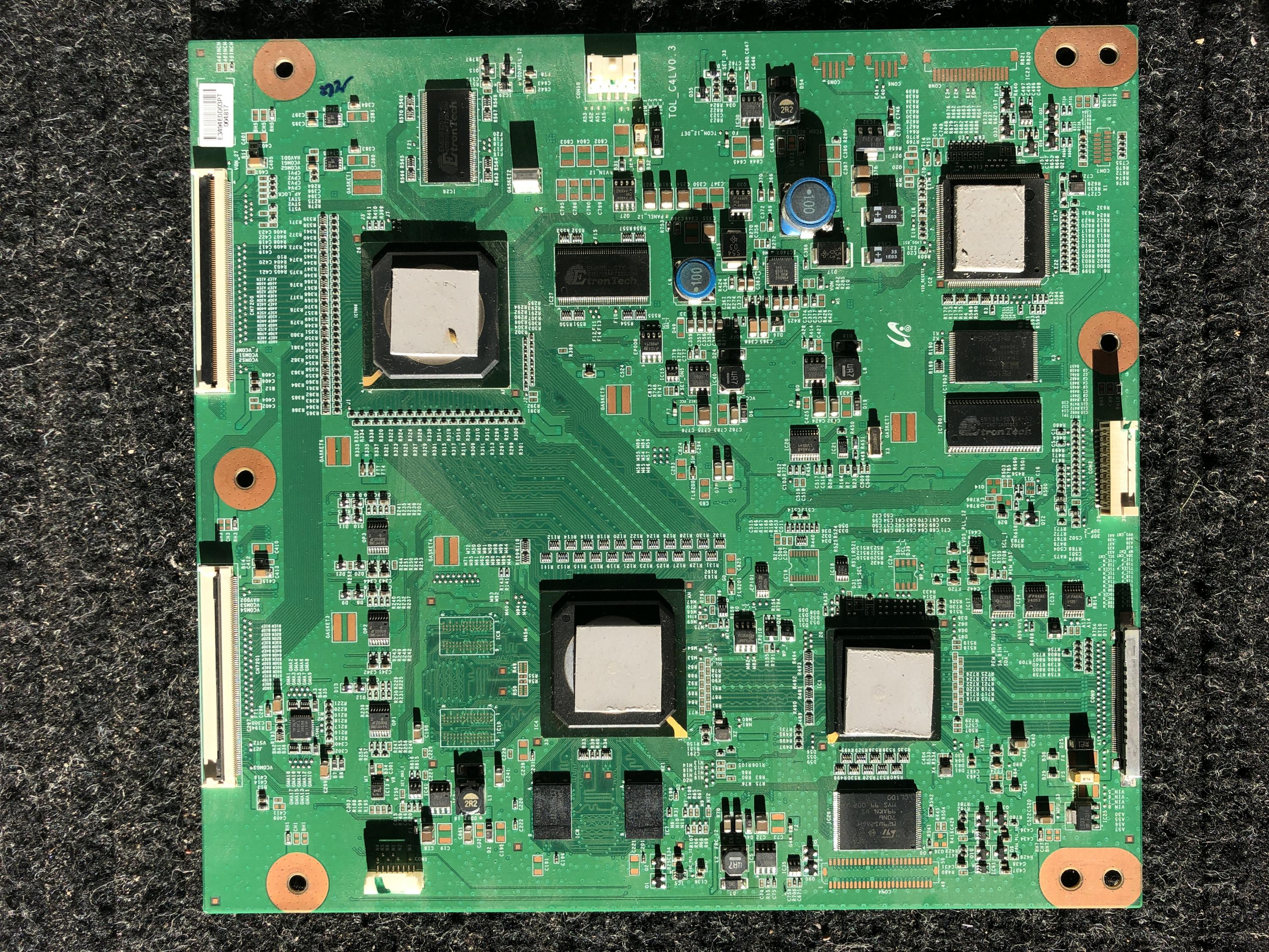

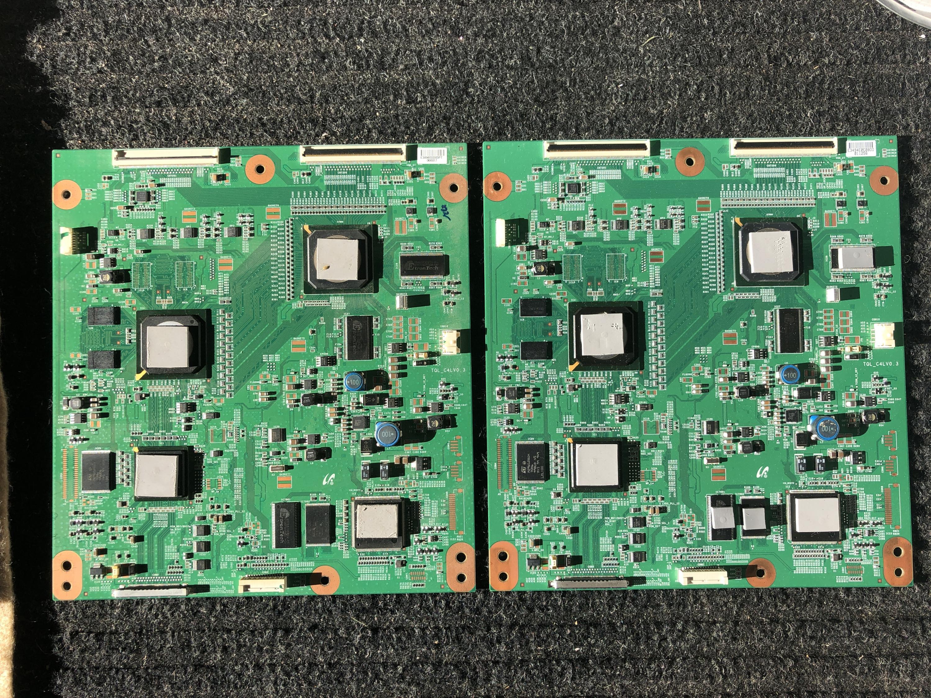

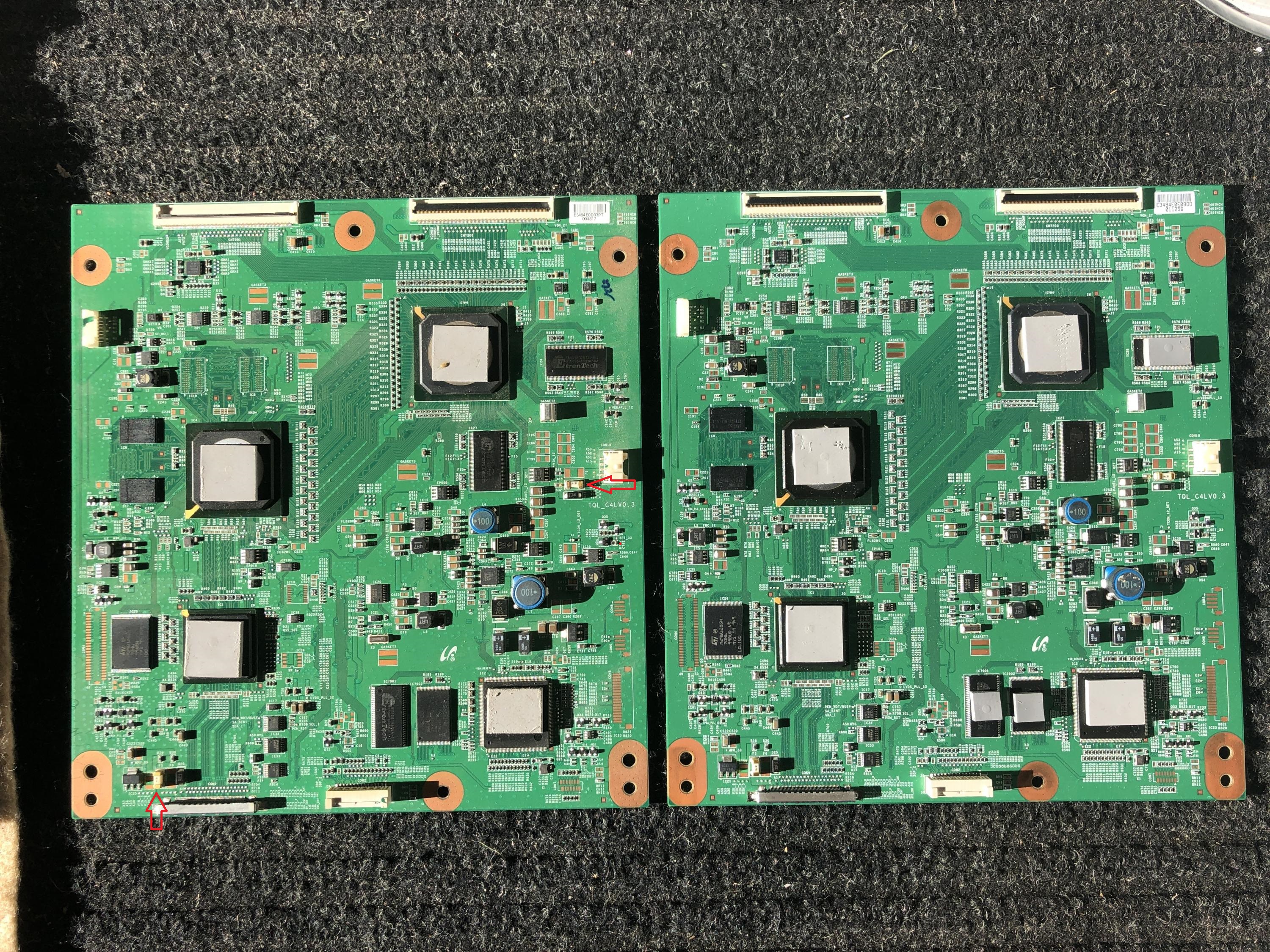

      It is possible that you may have an incorrect Tcon.
      Post pictures of the original and the replacement Tcon clearly showing any labelling or part numbers so a comparison can be made.

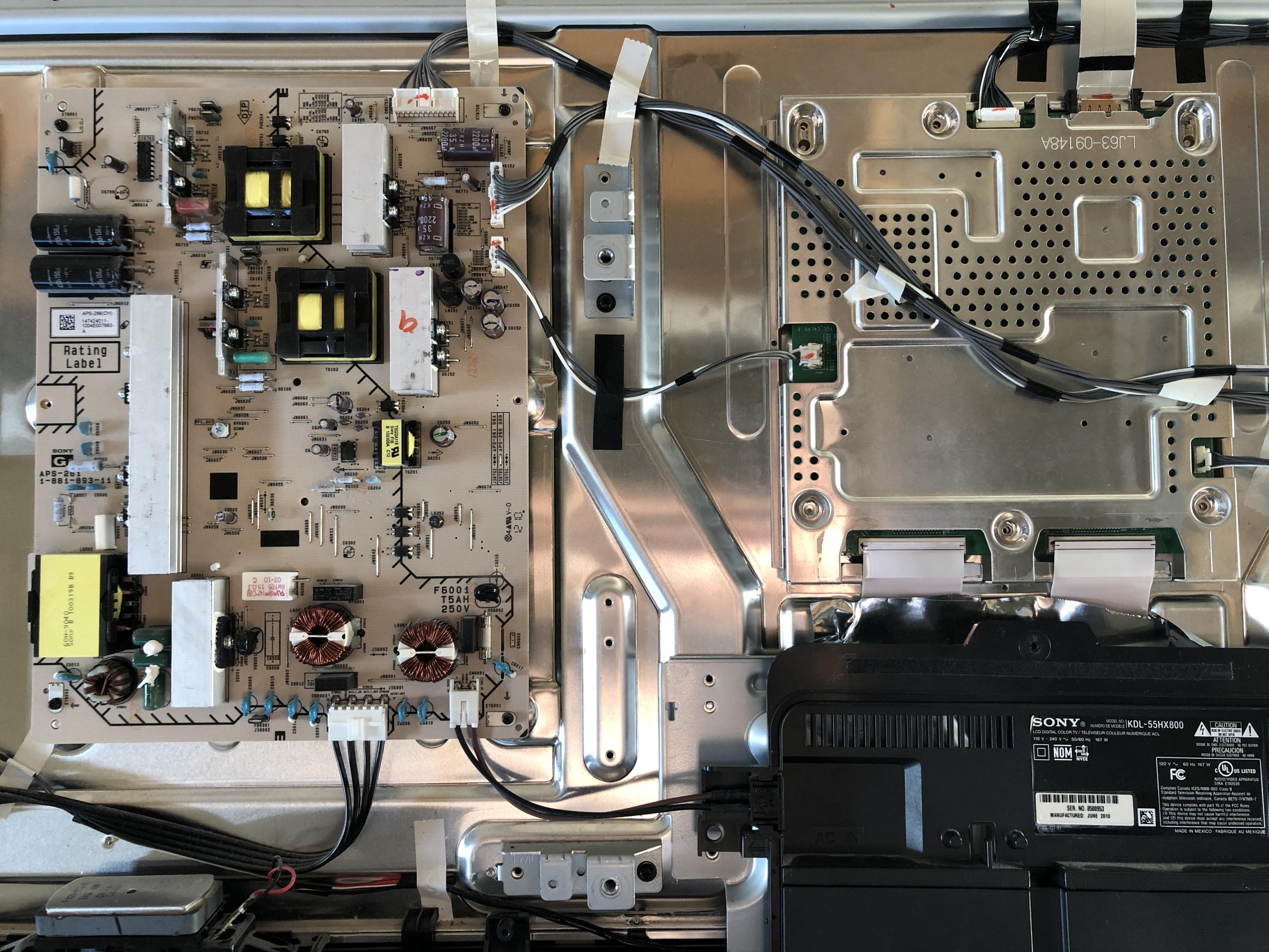

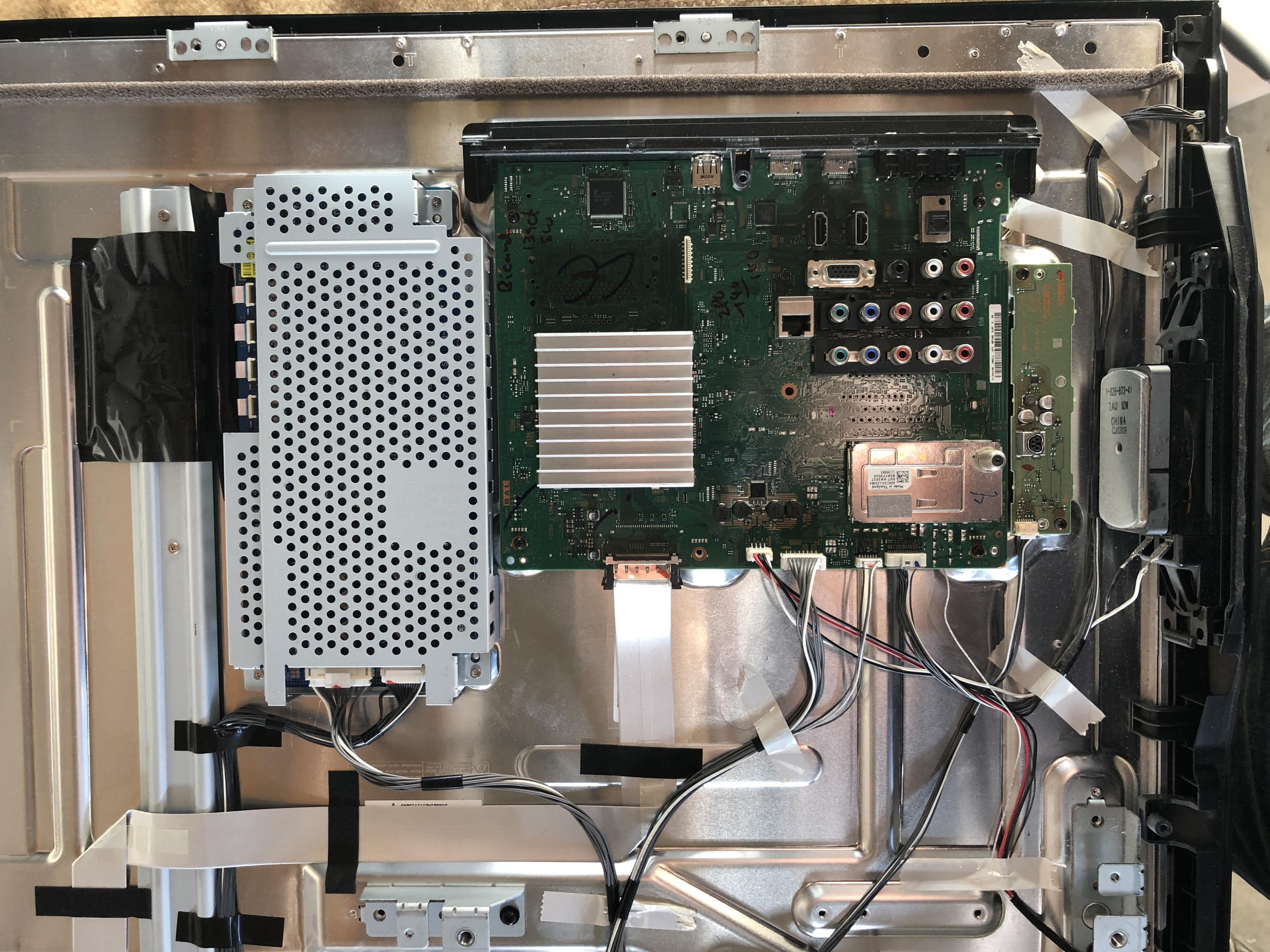

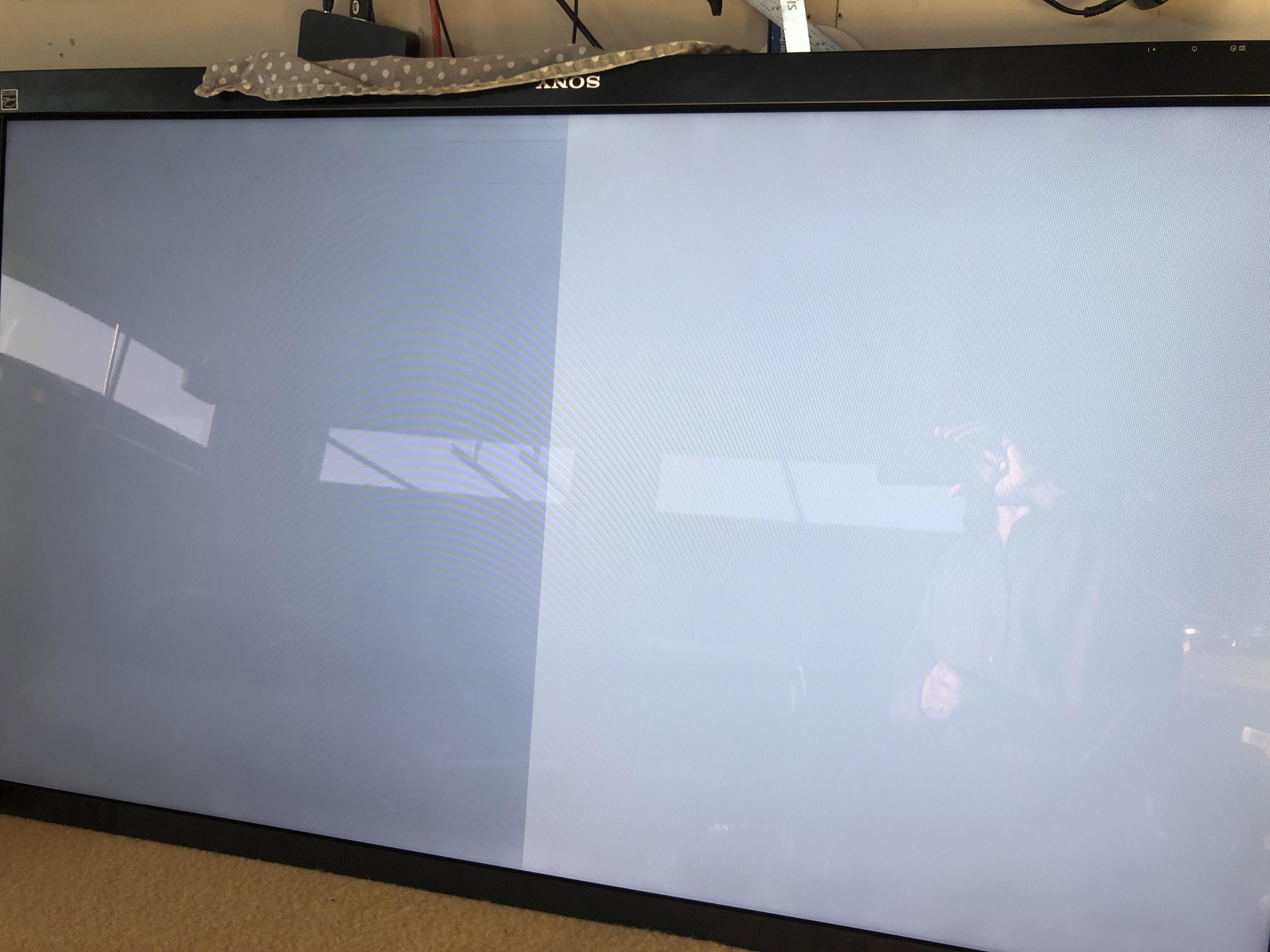

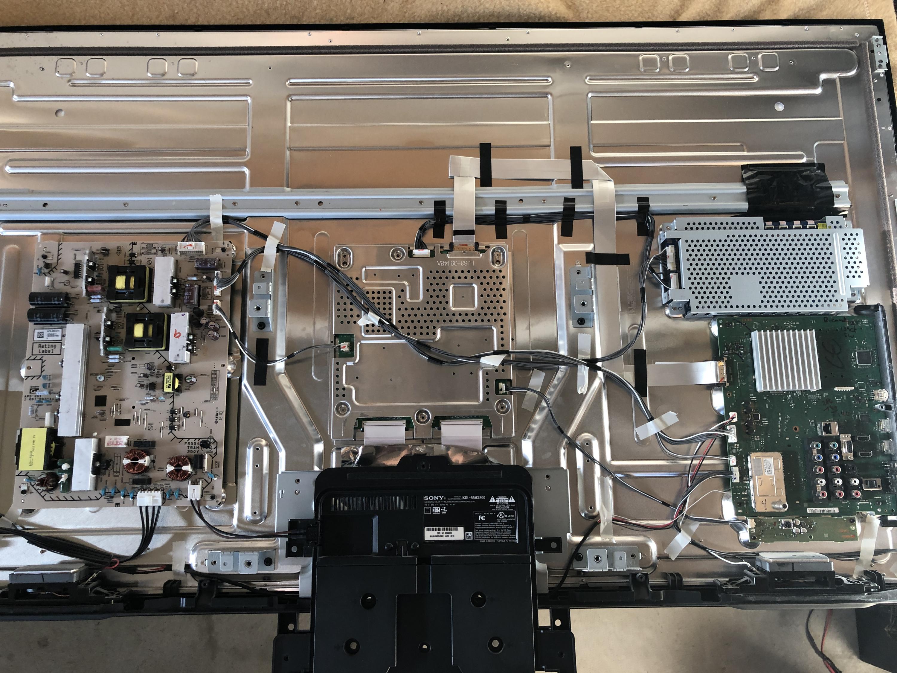

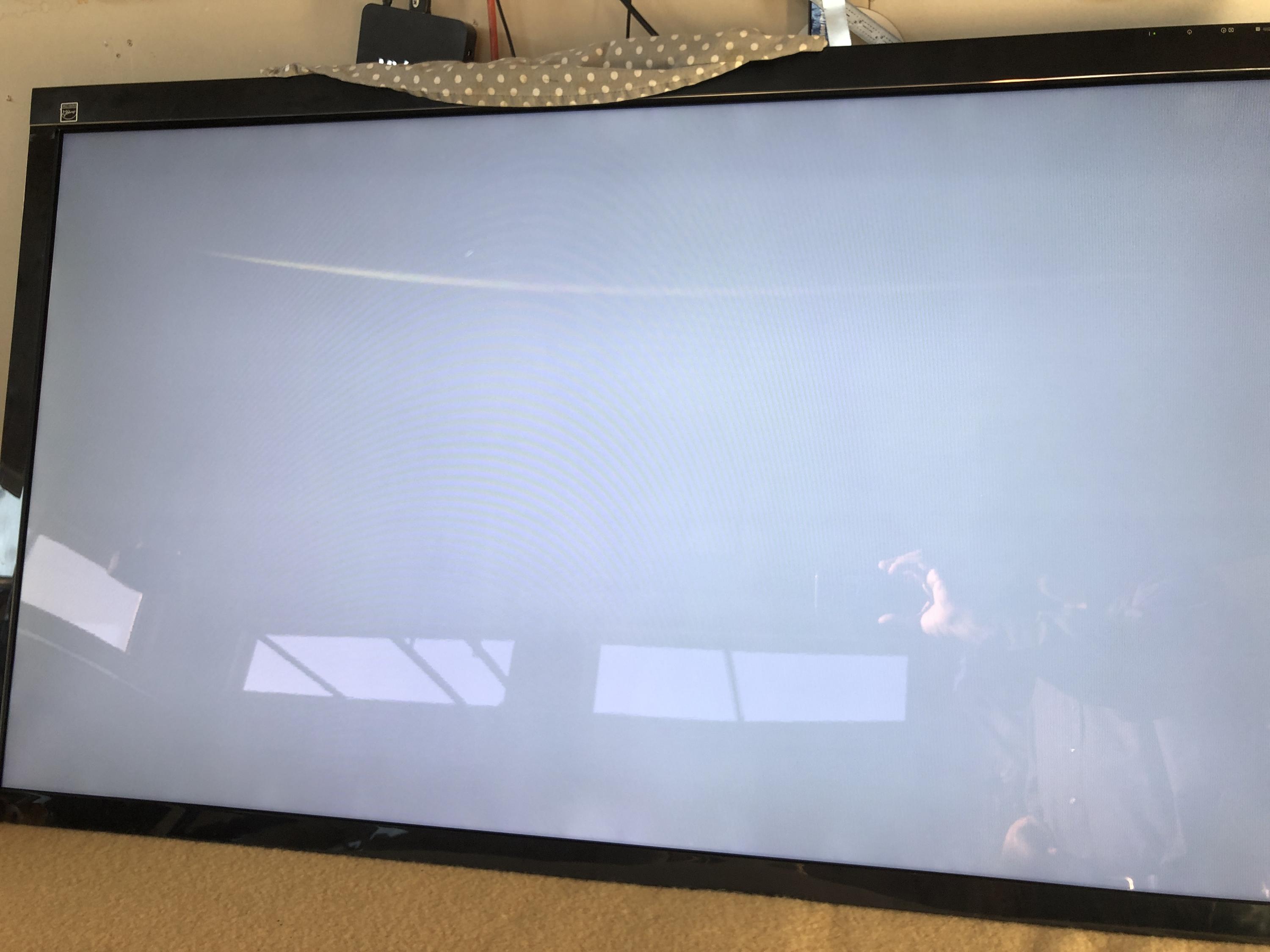

            Can we see the screenshots of what the white screen looks like?
            Also pictures of the whole backside of the TV showing all the boards.

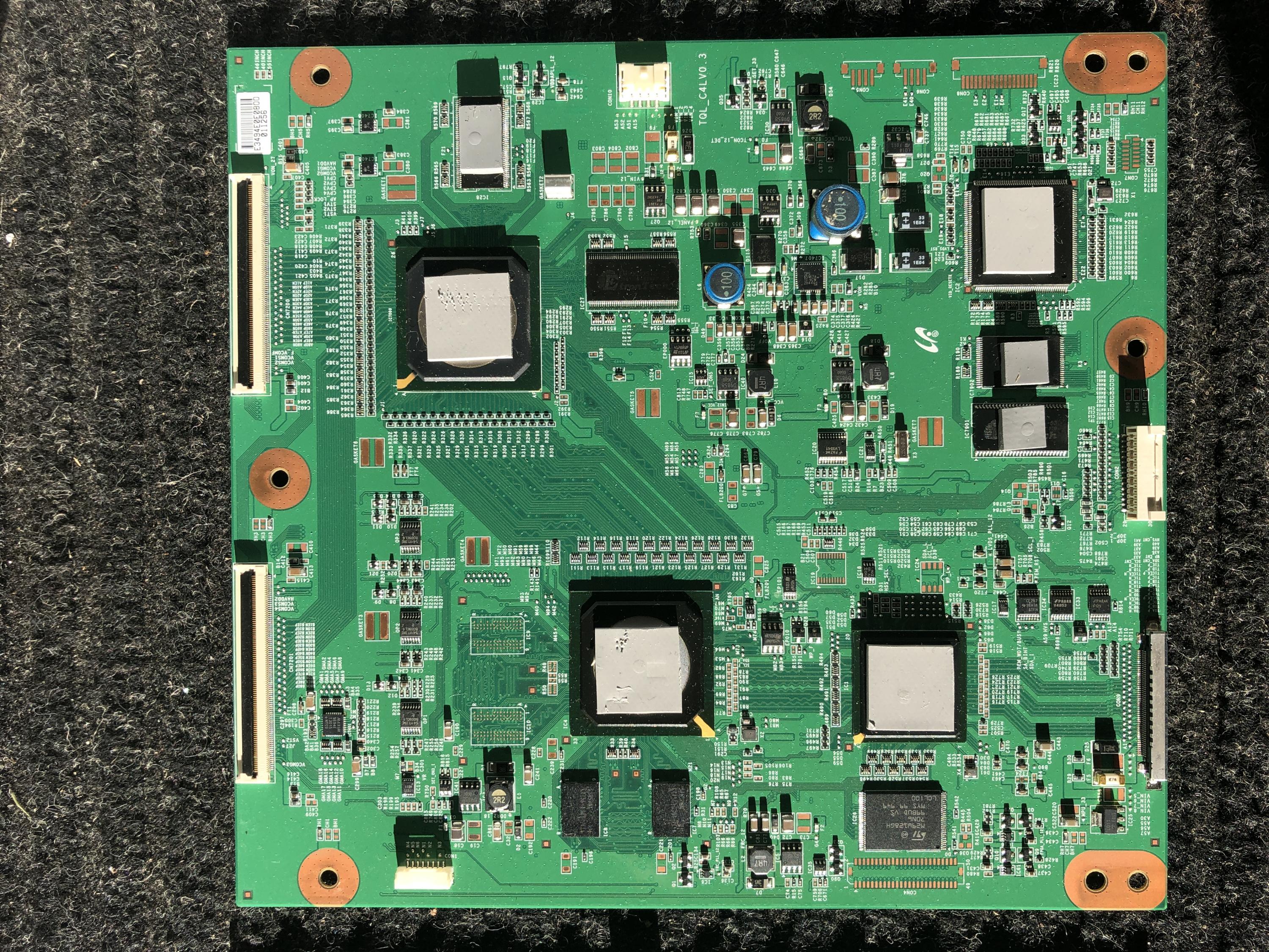

              Please find herewith the photos as requested. When I looked for the T-CON, this set seems to use two different T-CON's a LJ94-0349E and/or a LJ94-03495E. I could get the LJ94-03494E, as depicted in the photos.

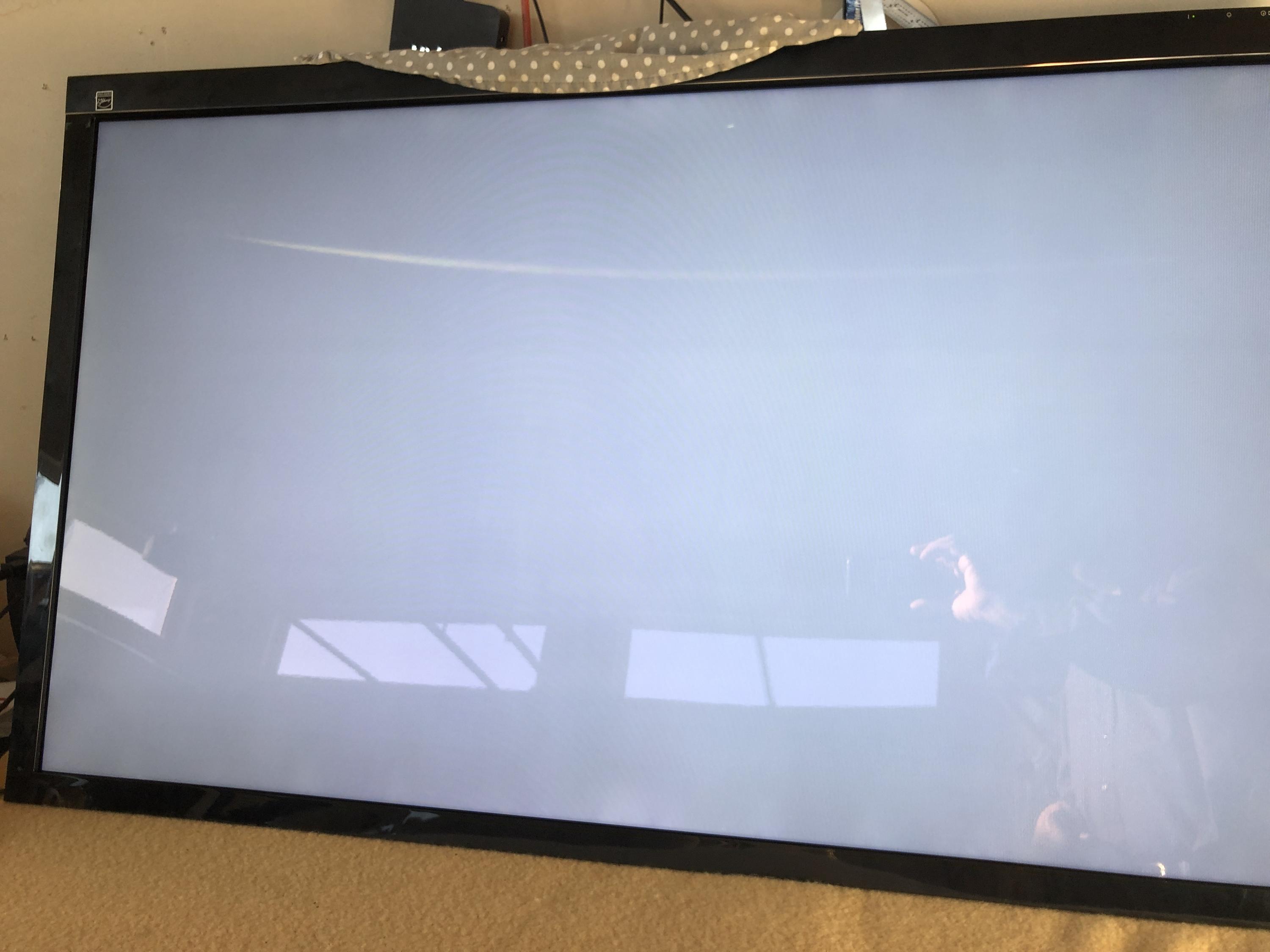

              Budm, the pictures of the white-screen with the division in the middle is when I remove one of the T-Con to panel tabs, and the clean white is of the picture I get with all tabs connected. The pictures with the weird circles are probably a fault with my camera. In all the pictures the display is crisp and clean "White". Even with all tabs connected the display is an even crisp white screen.
              I taped down the tabs going to the backlights after reading the thread from Tom.molyn(tape in black right corner of LED Driver)

                The two boards do look identical. Have you checked you have voltage on both sides of the fuses.
                  Re: Sony KDL-55HX800 White Screen
                  The white screen tells that 12v is present on the load side of tcon fuse, i guess, but something is wrong on the tcon because it has not all the tensions, that huge beasts of tcon appears to be very expensive, i think that your original tcon was not really faulty, but i guess for some strange and unpleasant reason the LD board tells the tcon that he has a fault and tcon sets a fault bit in its memory, so i strongly suggest to find the smaller eprom on the new board and save it because if it goes again into protection the reversing is sometime impossible otherwise, or buying a new tcon. The white screen is maybe due to screen defect (less probably) or error flag stored in BAL board, do you have changed it before or after LD+Tcon boards? One way to commonly reset an error flag in the Sony is to make an update procedure by USB.
