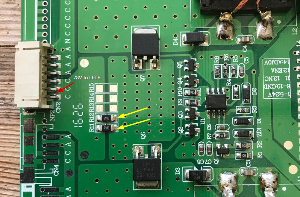

    Hi there,
    I have been given a store display panel to fix, The output of the B20N15D MOSFETs are fed to the output connector through parallel two resistors, which 2R00 (2ohm) and one R330 (0.33ohm), giving effective resistance of 0.28ohm. Both of these are open and need to be replaced. I replaced both temporarily with a 2R2 resistor and the TV works fine.
    I could understand why you would have two resistors of the same value (so as to increase the power you can carry), but I just don't understand why you would have two resistors in parallel with such differing values. Surely most of the current just passes through the R330 resistor and almost nothing passes through the 2R00 resistor.
    Is there something I'm missing? thanks

    Re: LED Driver board Question
    For fine adjustment of the voltage on the bars and implicitly of the current flowing through the LEDs. The values of the resistors differ depending on the type of LEDs, their typical current and the number of LEDs.
    Low value of resistors / higher voltage on LEDs.

      Yes, I understand. But the bit I'm curious about is why there are two different resistor values. The circuit will see the effective resistance of the two resistors in parallel.
      I have two options here:
      1. Buy exact replacements for the two resistors in the circuit.
      2. Use slightly higher resistance to reduce the current through the circuit.

          It's not unusual to have a mix of resistors in parallel to give you the exact value you want.
          • JonathanAnon
            • Jul 2012
            • 457
            • Ireland
            Interesting Dick, I didn't know that they need to be that finely "tuned".
            So here's my plan. The resistance that would have been there originally would have been 0.28 ohms (2ohm and 0.33 in parallel). Now, I have a load of 2R2 SMD resistors, so I'm gonna put five of them in the parallel on the available pads which gives effective resistance of 0.44 ohms. This will reduce the current, which is what I want, and will also mean I don't have to order any small bits in the post. I will checked afterwards to make sure that there is enough current in the LEDs so that the screen has adequate backlight.
            Anybody have any issue with this?

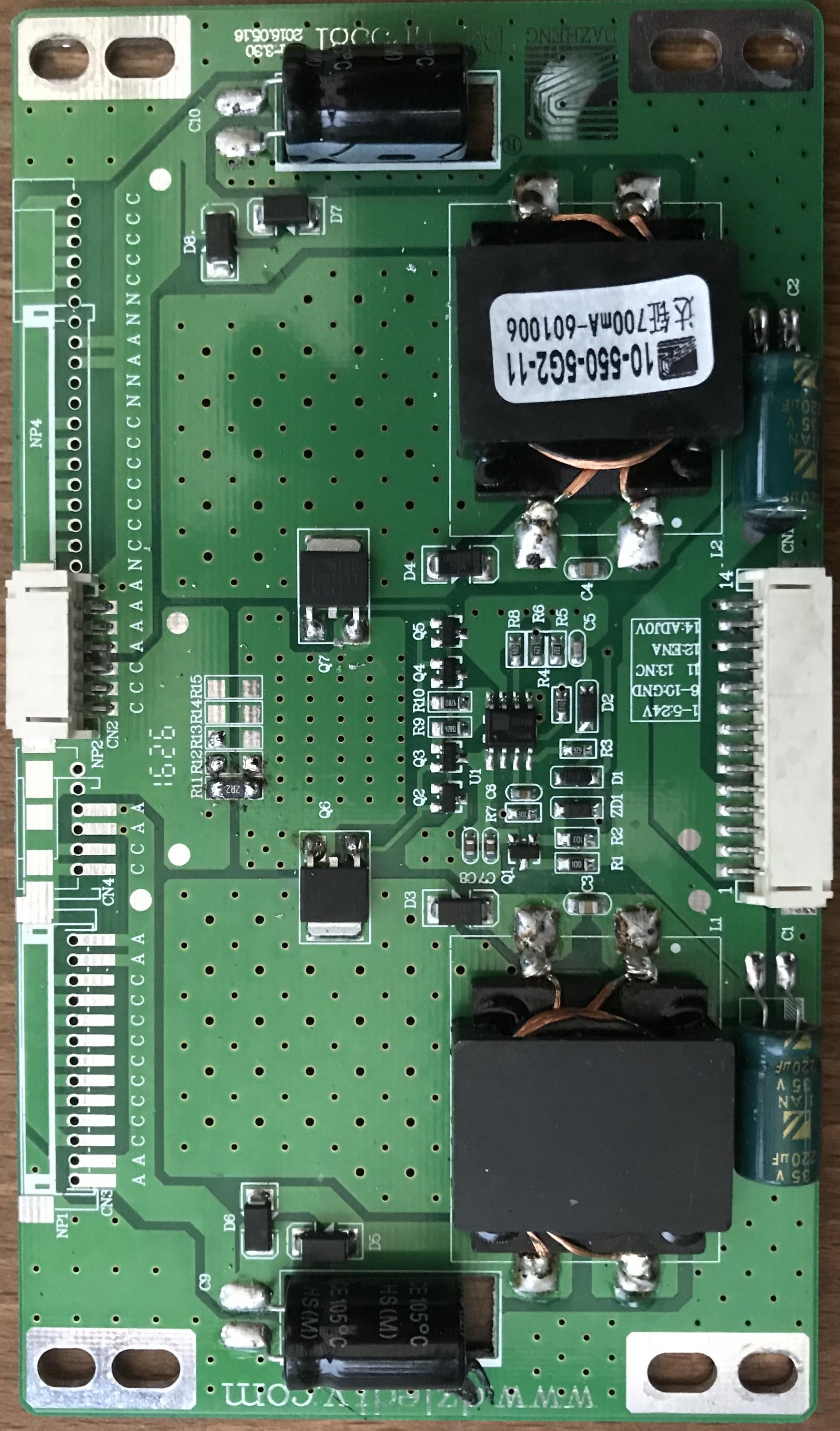

                Can I see straight shots pictures of the whole top and bottom side of the board?
                They may be being as current sensor.

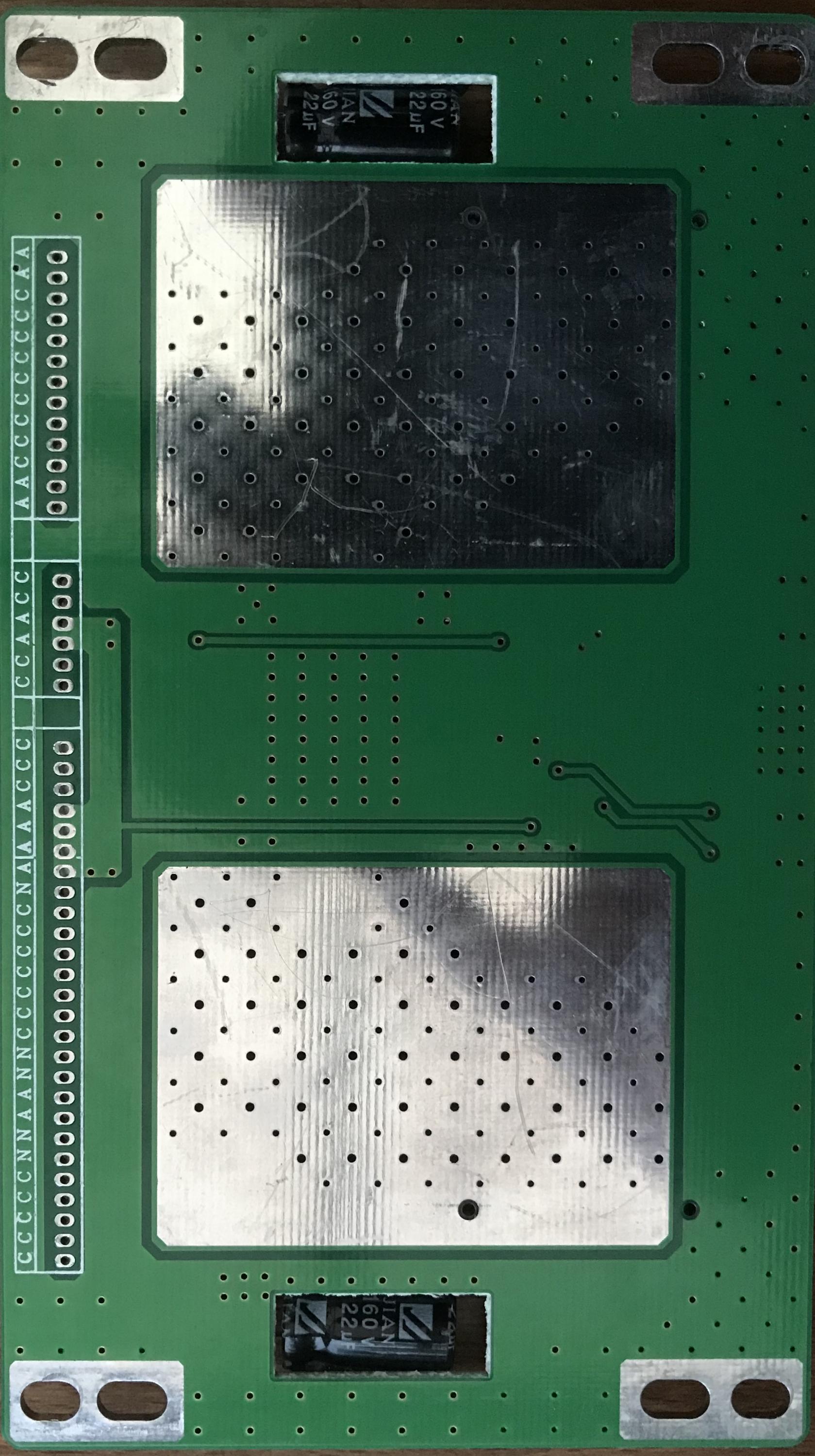

                  My apologies, I had the output cable turned upside down. I just noticed A and C on the output connector, which I presume is Anode and Cathode of the LEDs - so those resistors connect the cathode side of the LEDs to ground.
                  There is nothing on the back side of the board. So I think the purpose IS current limiting, not current sensing. I dont want to take up any more of your time, guys, so I think I'll just get the same resistors as what was in it. I will improvise on the next one!
                    They are current sensing resistors for maintaining constant current through the LED's.
                    You can see the VIAS on the CC cooper plane that goes back to the control circuit.
                    They set the maximum current by adjusting the values of the sensing resistors.
                    So for the resistor may be burnt out due to some shorted out LED's.
                      I see it. It must be pretty forgiving, as I have increased the resistance at that junction from 0.29 ohm to 2.2 ohm and still the backlight comes on and stays on. I think I'll just replace those resistors with exactly what was there previously.
                        you have 5 rank only 2 used.. it mean the same power boards used by other TV size.. here are the Numbers of LED play the roll. use one Res as you calculated will work smoothly.
                        but the question always remain why they are OPEN... need to inspect the LEDs first

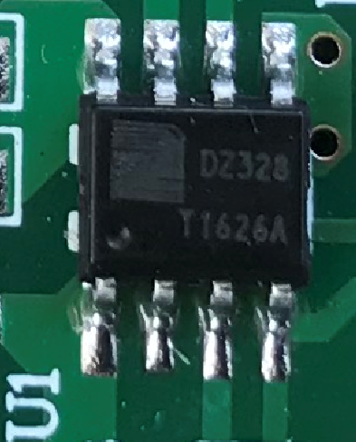

                          The value of the current sensing resistance will determine the maximum regulated LED drive current will be when the backlights is set to max, the higher the resistance the lower the max current will be.
                          BTW, what is the IC U1 P/N?

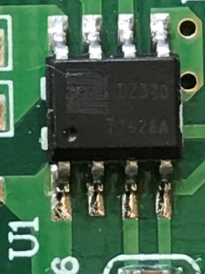

                              From the pics I currently that's the best one Bud. I'm not sure if you can work it out from that. I'll take another pic later.
                                I cannot really read the number.
                                D2330 on the first line?
                                Second line I cannot read.
                                You can turn up the backlights level then measure the Voltage drops on that resistor to calculate the LED current.
                                The LED strings look to be connected in parallel.
                                What is the panel number any way?
                                        Closer shot of the chip.
