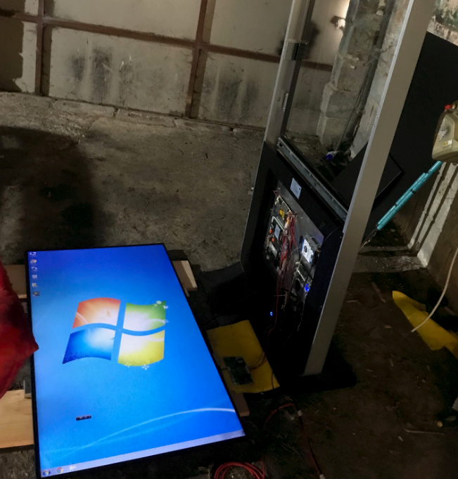

    Just one more image to give you an idea of what I'm looking at right now. I took apart the 50 inch panel completely to get at the backlights, so I'm very relieved that the screen seems to be okay.
    This is the level of light I get with the 2R2 resistor in place.

        Re: LED Driver board Question
        Originally posted by Diah
        its nice set, good candidate for Android / linux TV project instate as store display...LOL
        Hah, well you can do that for sure, but I'm downloading Garageband first.

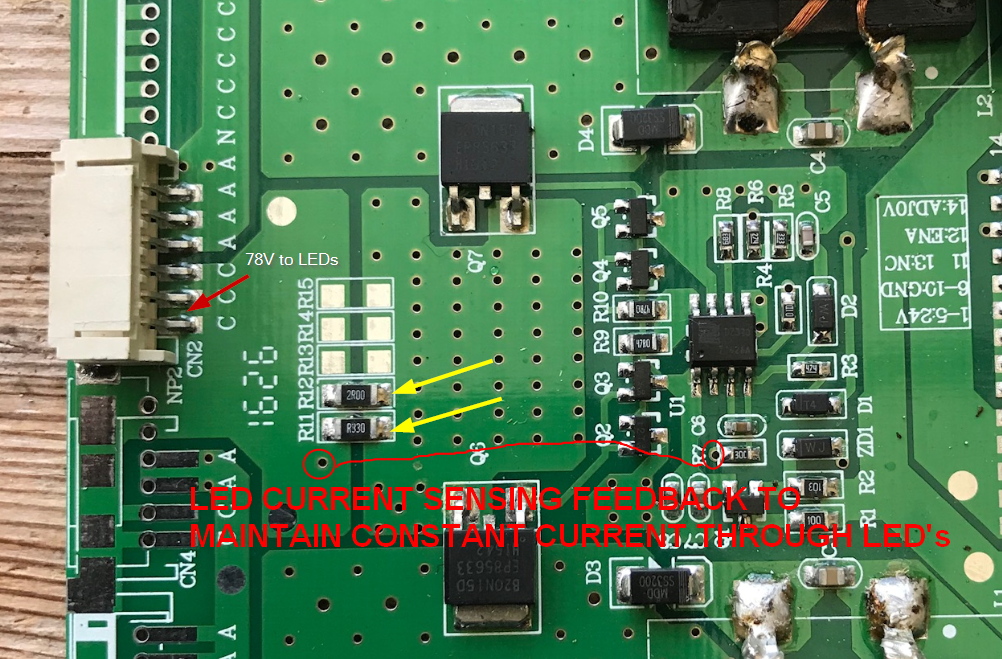

          Do you have LED tester so you can test and check the Vf of LED strings?
          So it's the Digital Signage display.
            "The LEDs in my version of the screen are all at the bottom of the screen, there are two LED strips and each has four parallel sets of 26 LEDs. The back of the panel says 720ma / 78-89V"
            Do you mean that each string has 26 LEDs and 4 of these strings are then connected in parallel?
              I have an LED tester in the post Bud, can't get there here in any shop in Ireland somehow. But it should be here shortly. There's a big digitiser fitted in to the main steel frame - So it's interactive as well. It's actually really cool when it's back together. Would be a hell of a gaming machine if I downloaded the MAME emulator.
              4 x 26 LEDs on each strip, and two strips, so total of 8 x 26 LEDs
                BTW, did you have a chance to take the Voltage drops reading on that 2R2 resistor at max backlights level so I can verify the power dissipation and current draw?
                  Hey guys,
                  It's been on for two days solid with the 2R2 resistor. Backlight is more than adequate.
                  Voltage drop on the 2R2 resistor is 200mV
                    Okay I used my induction ammeter to measure the current as well. There's no obvious location to break the circuit to introduce a series ammeter, so clamp is the best I'm gonna have for the moment.
                    200mV voltage drop across 2R2 resistor. 200mA current on the induction clamp.
                    P=VxI = 0.2V x 0.2A = 0.04 Watts.
                    So, the 2R2 resistor will have to dissipate 40mW.
                      #30
                      Where did you put the Clamp on meter?
                      Post #28 Vdrops 200mV/2R2 = 0.090A = 90mA.
                      Are the reading done at full backlights set to max?

                          #32
                          I put the clamp on the two positive wires coming out of the driver board feeding the LED strips. Does seem low to me but that is what it reads.
                          Sorry Bud, I meant to say this - there is no means for the user to change the backlight through brightness setting or the like. There is no remote control. So the backlight current will be fixed.

                              #34
                              They probably have it set to about 90% PWM which is typical for Signage Display, which is still high and that is why the resistor burn out.

                                #35
                                don't find excuse for wrong statement.. this Edge LED back light double cell, this why i asked him if there was wrong,,but OP clarified its Edge.
                                now about Edge.. did you asked your self why here no much threat about this type ?
                                allot of answer here.. start from the Freq. to currents.. to circuit .. OP upload photos easy to 2R2 & R332 are NOT sensing current but to just protect the PWB LED section.
                                  #36
                                  How many time are you going to making fools of yourself.
                                  1) Do you understand what constant current circuit does and how it maintain constant current through the LED's?
                                  2) As you can see, pin 3 of the IC U1 is monitoring the Vdrops on the resistor, if the Vdrops staring to change, it means the current through the LED is changing, so pin 3 of the IC is sensing that Vdrops to maintain the current at set level by changing the PWM that drive the power MOSFET Q7,.
                                  when current is constant, the Vrops will be constant.
                                  To maintain something at constant, you need feed loop, any person that knows electronics will understand that.
                                  3) Did you look up the spec sheet of U1 to find out what that IC is for? I bet you did not and that is why you do not understand the circuit. I ask OP for the P/N and did the research so I can see how this board works.
                                  4) So you are saying if you put LED light source on the edge, instead of backlit, the LED driver circuit for maintaining current is not the same topology? Who teach you that?
