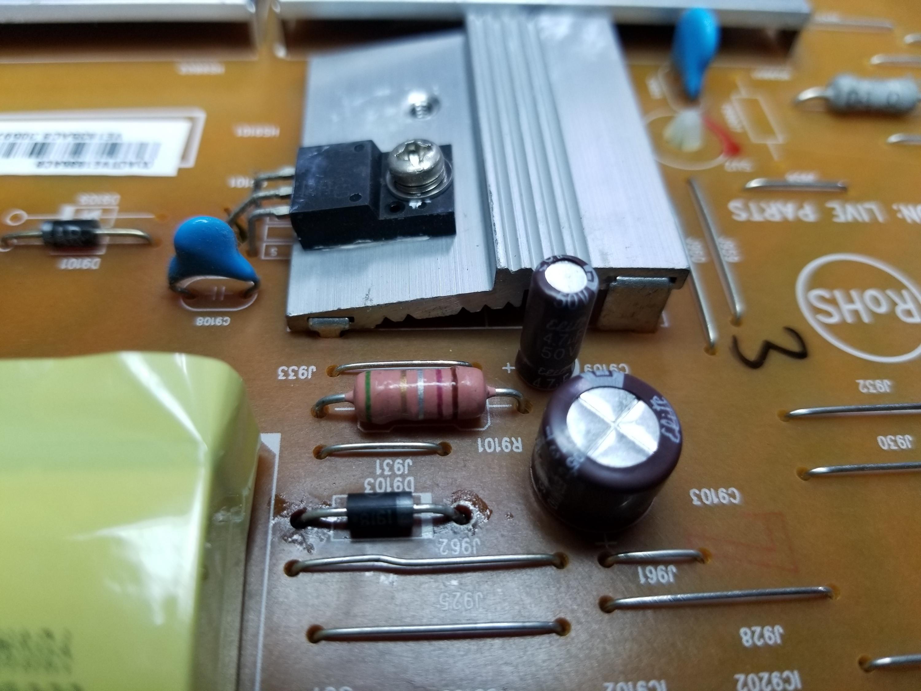

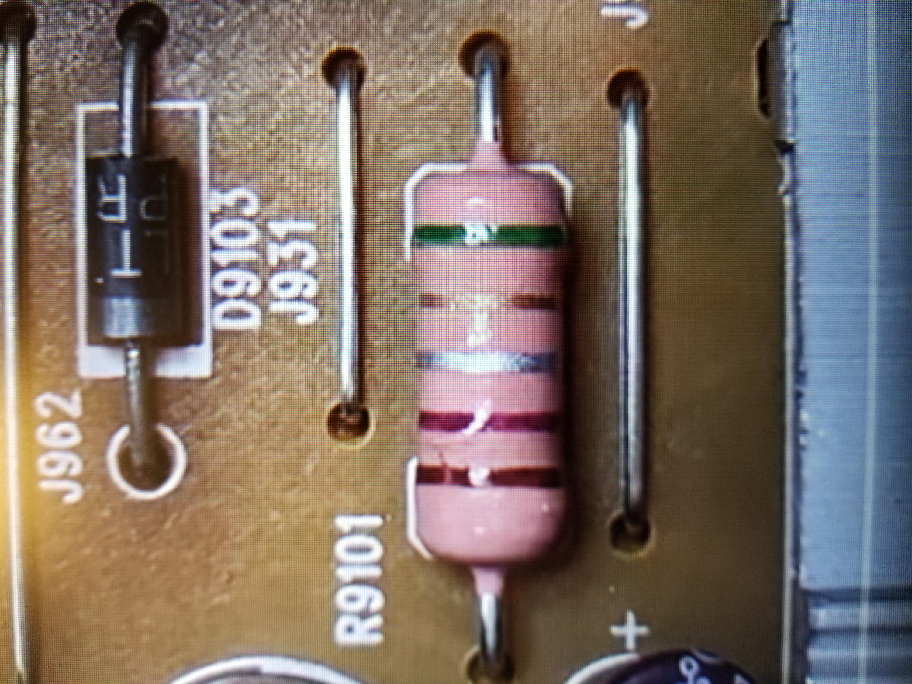

    Can someone please tell me the value of the resistor pictured? Can you tell me the exact resistor I need to order to replace it? Thanks in advance!
    Re: Need help with resistor value please
    Why do you want to replace it? What are you trying to fix?
    It looks like RED-RED-SILVER = 0.22 Ohms.
    Gold = 5% Tol.
    Green = Temp Co. NA.
    https://www.allaboutcircuits.com/too...de-calculator/

      Hey budm, I am working on a Vizio M65-C1 and when I got it it had no power. I watch a Youtube video of someone that has the same problem with the same model TV. I replaced a resistor and diode that he showed on the power supply. When I powered up the TV it came on for a second and blew the same resistor again. It's a SMD resistor mounted on the bottom of the board. So I got to checking components in the area of the SMD resistor and found that the resistor, like the one pictured, has no resistance whatsoever. So I am thinking it is bad. I am posting another picture of the actual resistor. It seems to have a small bulge on the side of it.
      • diif
        • Feb 2014
        • 6978
        • England
        When you say it has no resistance whatsoever do you mean? It's a very low resistance resistor, lower than the average set of test leads so it will show low. Or do you mean it shows open?
          1.2 ohm
          brown 2 red 2 silver .1

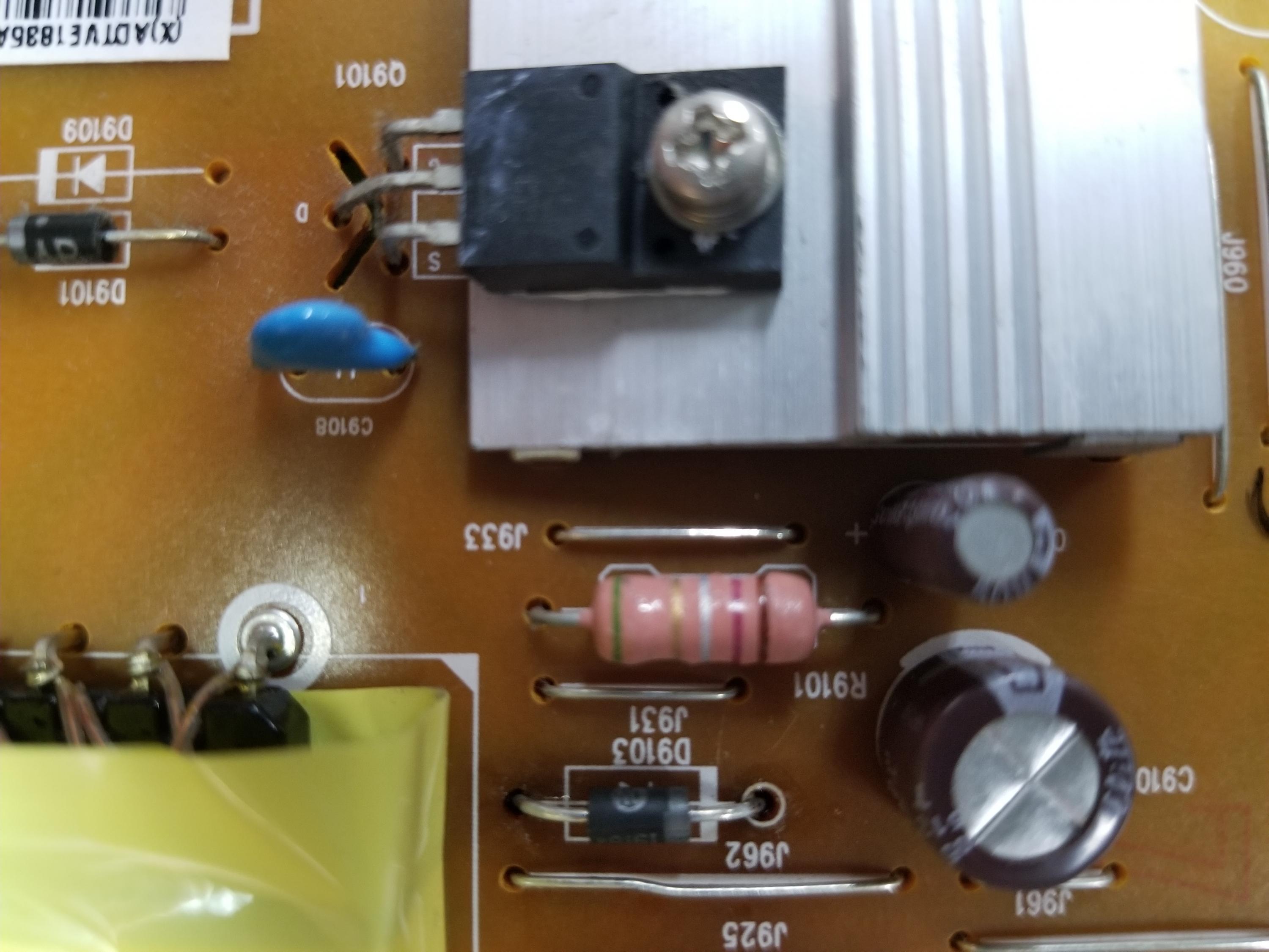

              I replaced diode D9103 and resistor R9114 but resistor R9114 keeps blowing.
                So it is Brown-Red-Silver = 0.12 Ohms.

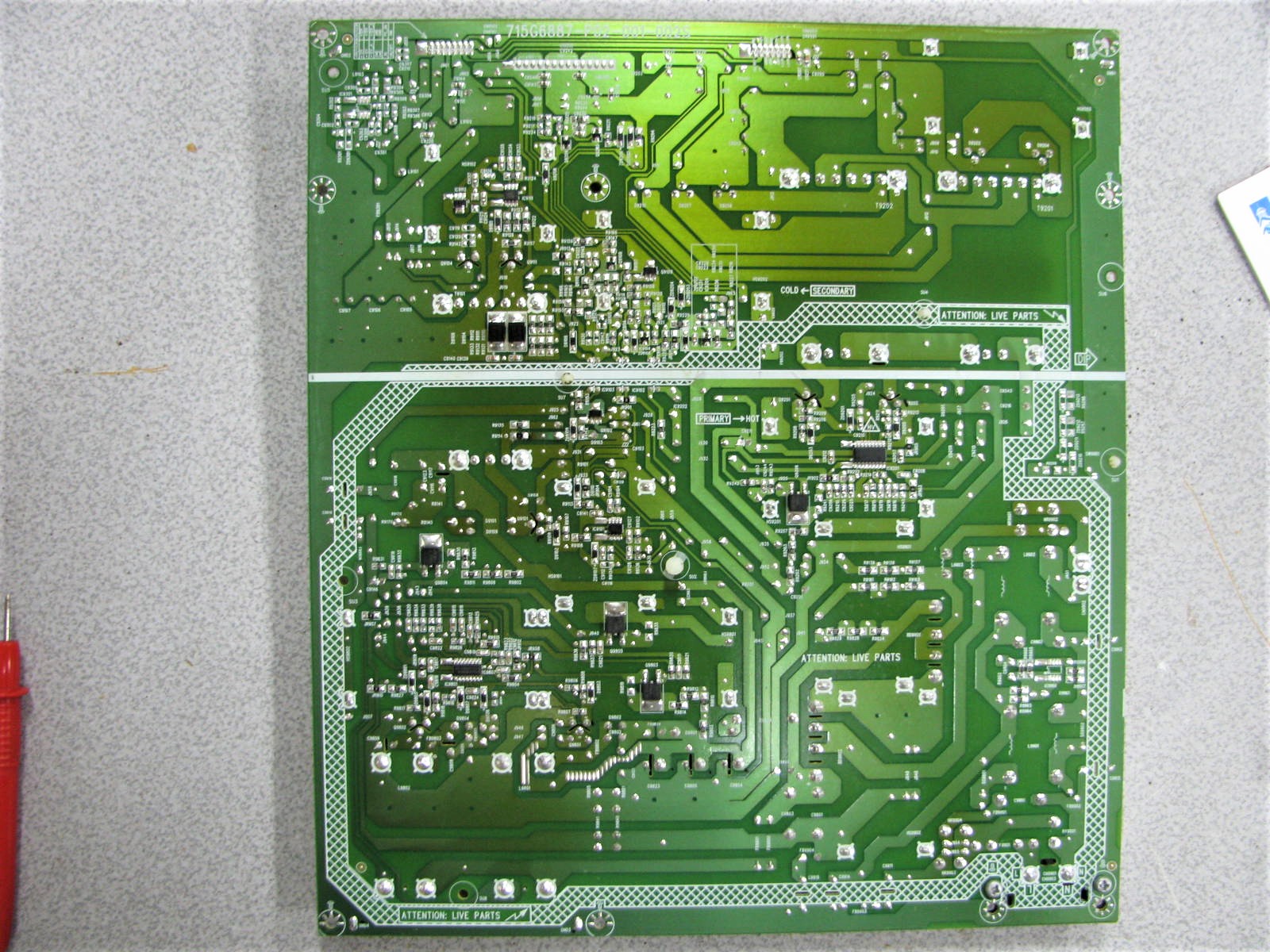

                Show us good clear straight shots of the whole top and bottom side of the board.

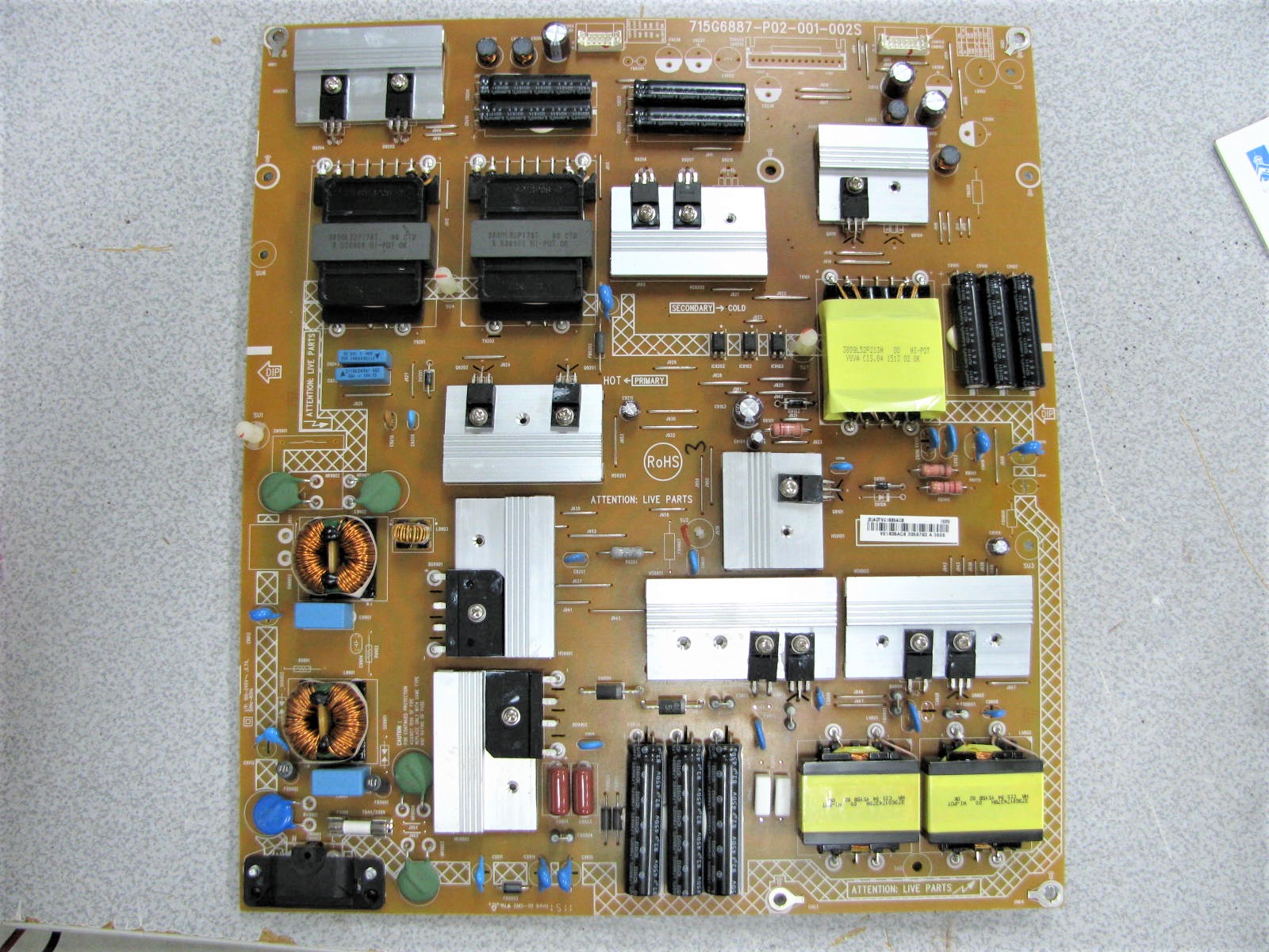

                    Is this your board? https://www.shopjimmy.com/vizio-adtv...ly-for-m65-c1/
                    If you look at the bottom side of the board you will see the followings:
                    1) R9114 (protection resistor), D9103, C9103 are for making running DC from AUX winding of Standby power supply transformer T9101 to run the Standby SMPS IC9101, that DC is also fed to switched Transistor Q9102 to supply the switched VCC to run the PFC IC9801, 12V/24V SMPS IC9201
                    2) What is the original D9103 P/N number? What did you replace with?
                    3) Was original R9114 blown? What was the printed on the body? What resistance value did you replace it with? Does it blow up when you first apply the power to TV or AFTER TV is turned on?
                    4) R9101 (0.12 Ohms) is the current sensing resistor connected between Source pin of MOSFET Q9101 (for driving Standby power transformer T9101) and Hot side Ground.
                    So in the beginning before you work on the power supply board, you were not getting ANY DCV from the power supply board connector to the main board?
                    Please give the link to the Video that you use to try to fix this board.
                      Original 621-PR1007G-T
                      Replaced with 1N4007FFG
                      The original R9114 was blown (had a hole in the center of it). I replaced it with the same part number and resistance value. When I first plugged the TV in after replacing the resistor and diode, the led light on the main board was solid red, instead of flashing, so I thought I had it fixed. When I turned the TV on, the V logo came up on the screen and I then I heard a pop and that's when the same resistor blew again.
                      I didn't actually check that budm. I just replaced what I saw in the video because I was having the same symptoms.
                      https://frugalrepair.com/2019/07/bar...wo-components/
                        2) What is the actual printing on the diode D9103?
                        "Original 621-PR1007G-T" 621-xxxxx is Mouser P/N, it is Fast recovery diode.
                        "Replaced with 1N4007FFG" that is standard recovery diode not Fast recovery diode used in switching power supply.
                        3) So what is printed on the R9114, what is the resistance value?
                        From that link, the blown up in the picture one looks like 1R0 (1 Ohm).
                        When TV is turned on, more current will flow through that resistor due to current drawn from PFC and SMPS circuit.
                        You need to check the resistance between GND and the VCC pin pf the PFC IC9801 and the 12V/24V SMPS IC9201 to see if they show low Ohms value or not.

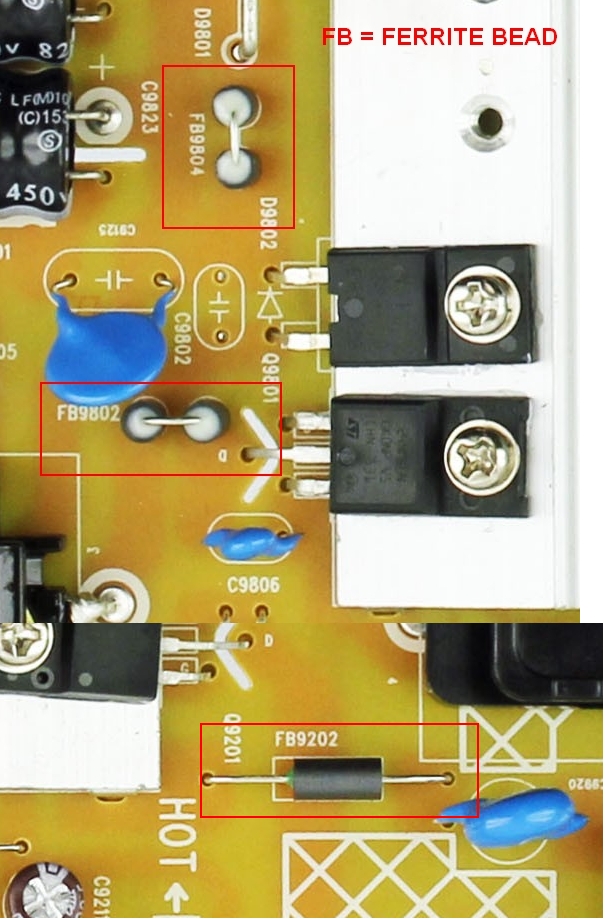

                            We are talking about R9114 SMD resistor, not the R9101 0.12 Ohm current sensor resistor for the power MOSFET which the value is critical value for setting the over current trip point, the value of the current sensing resistor is based on the circuit design..so it still holds true that R9101 is 0.12 Ohm.
                            FB = Ferrite bead INDUCTOR used for blocking high frequency, not for over current protection, it can be as simple as piece of wire through Ferrite bead.
                              FB = Ferrite Bead inductor, see picture.
