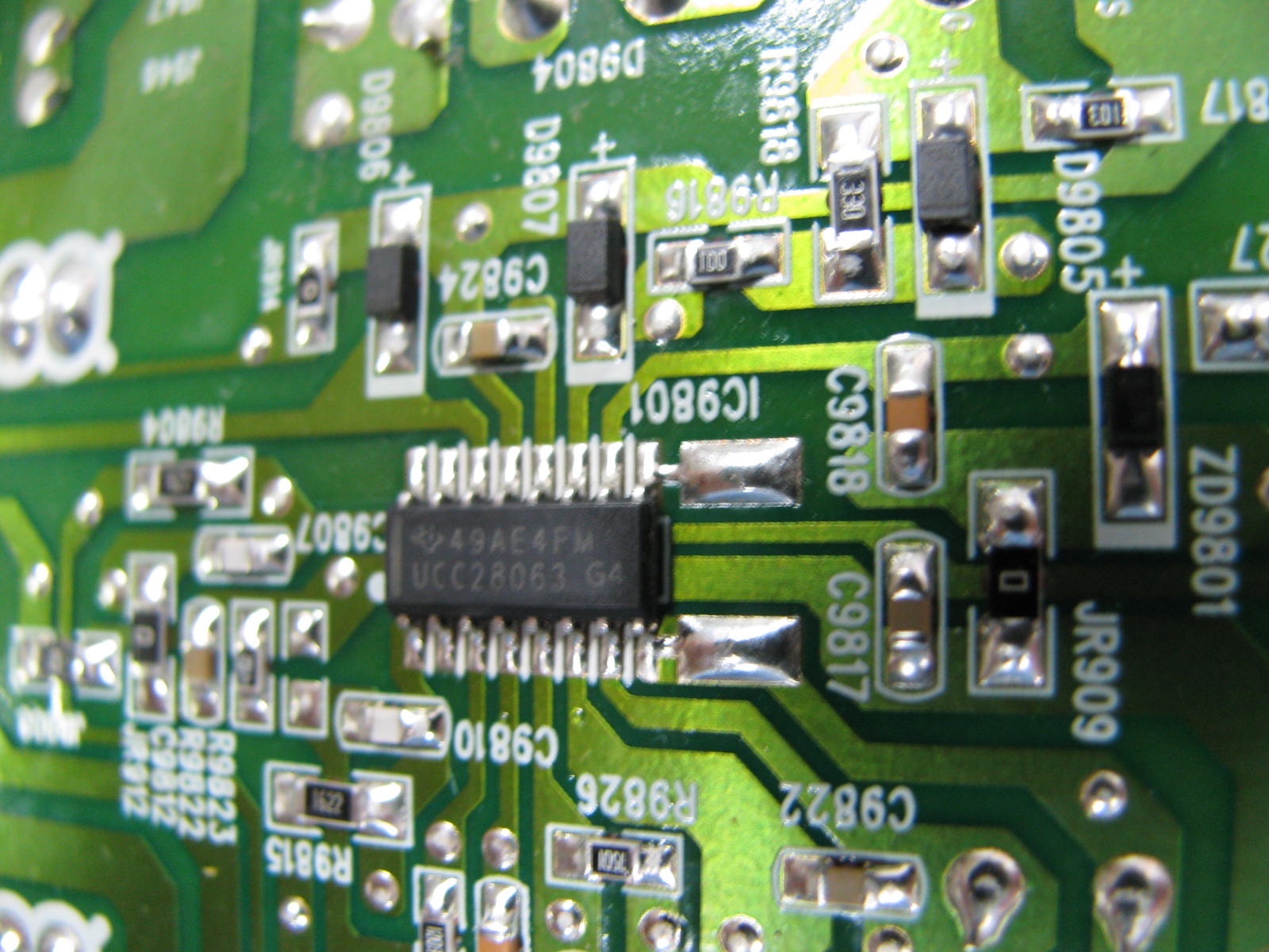

            1) Again, I still like to know what the P/N as printed on the body of that diode.
            2) Remove that diode and test it in both directions in using Ohm mode.
            3) Look at the P/N as printed on the PFC IC9801 and the 12V/24V SMPS IC9201 so I can look up the spec sheets.

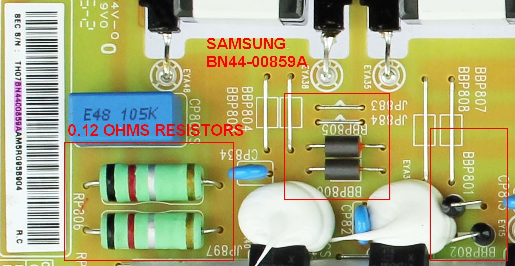

              Re: Need help with resistor value please
              BTW, provide the zoomed in picture of the R9114 that you replaced.

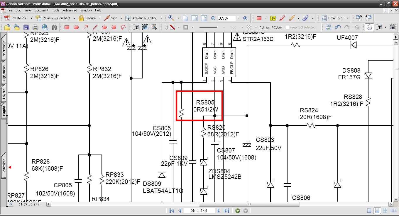

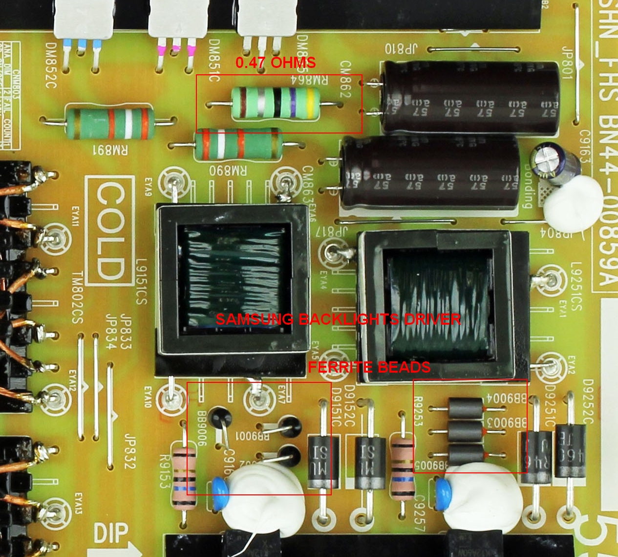

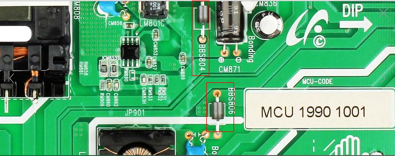

                FB = Ferrite bead INDUCTOR used for blocking high frequency, not for over current protection, it can be as simple as piece of wire through Ferrite bead.

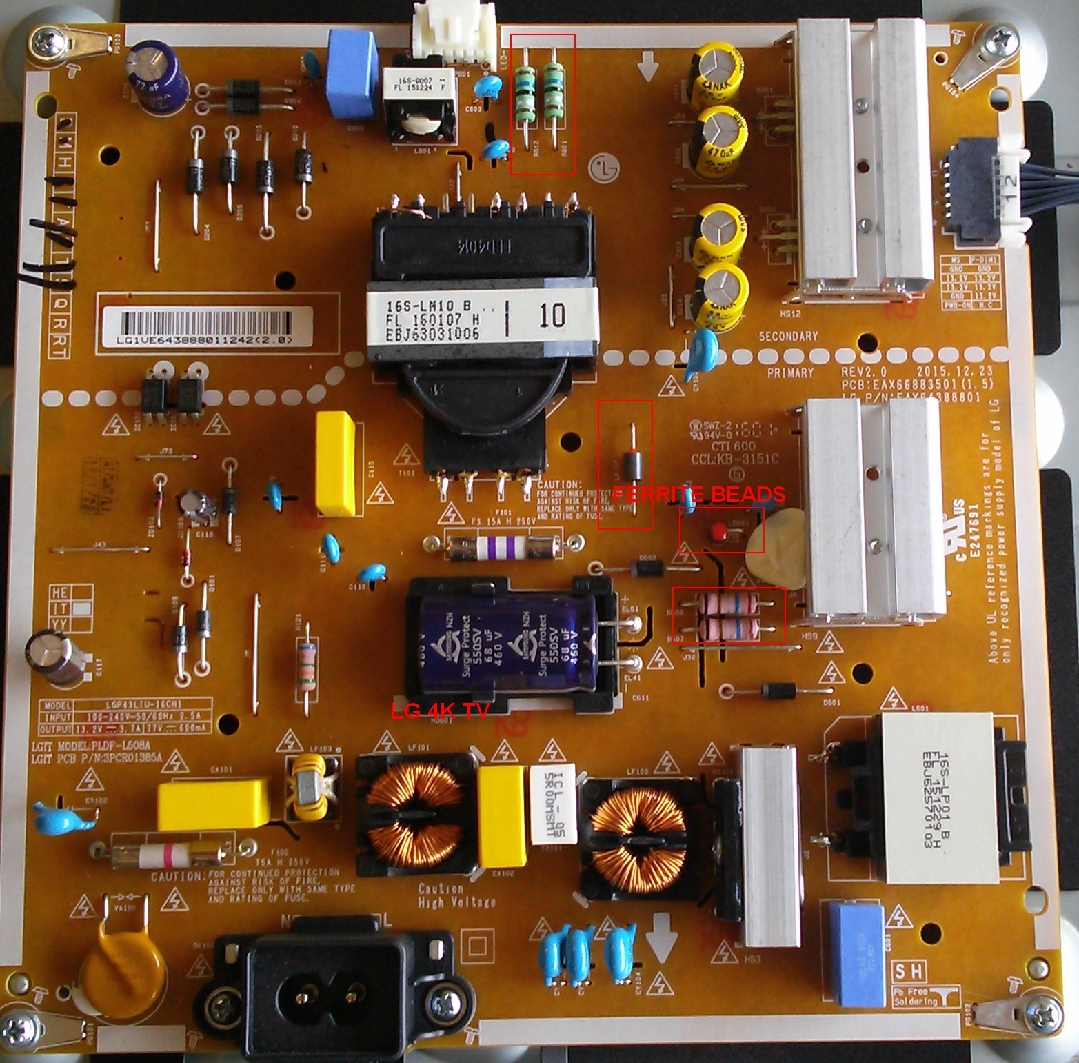

                LOL.. thx google let you know whats FB and why it used.. this why you linked photo on old type of FB which no more used for many reason... let me boil yours blood...

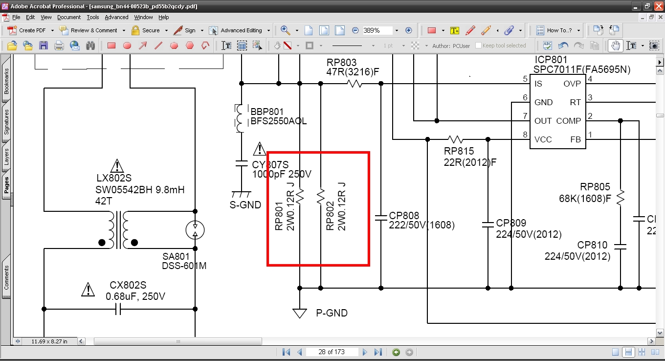

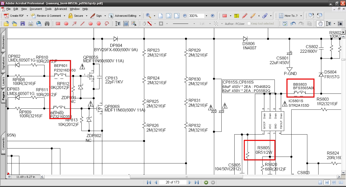

                1- you have time till end of this year to show me TV HD or above Res. PWB with Rsense used yours lovely 0.12Ohms
                2- compare this threat model PWB at same section within any Vizio newer model to see where and how they add FB to the same section we talking about.
                3- and the last we don't have yours Vizio over here and i am not aware of Korean brands shit too..
                  [I]1- you have time till end of this year to show me TV HD or above Res. PWB with Rsense used yours lovely 0.12Ohms[/I]

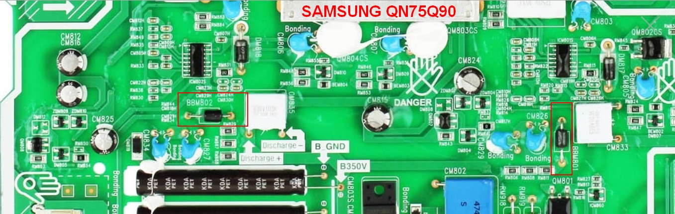

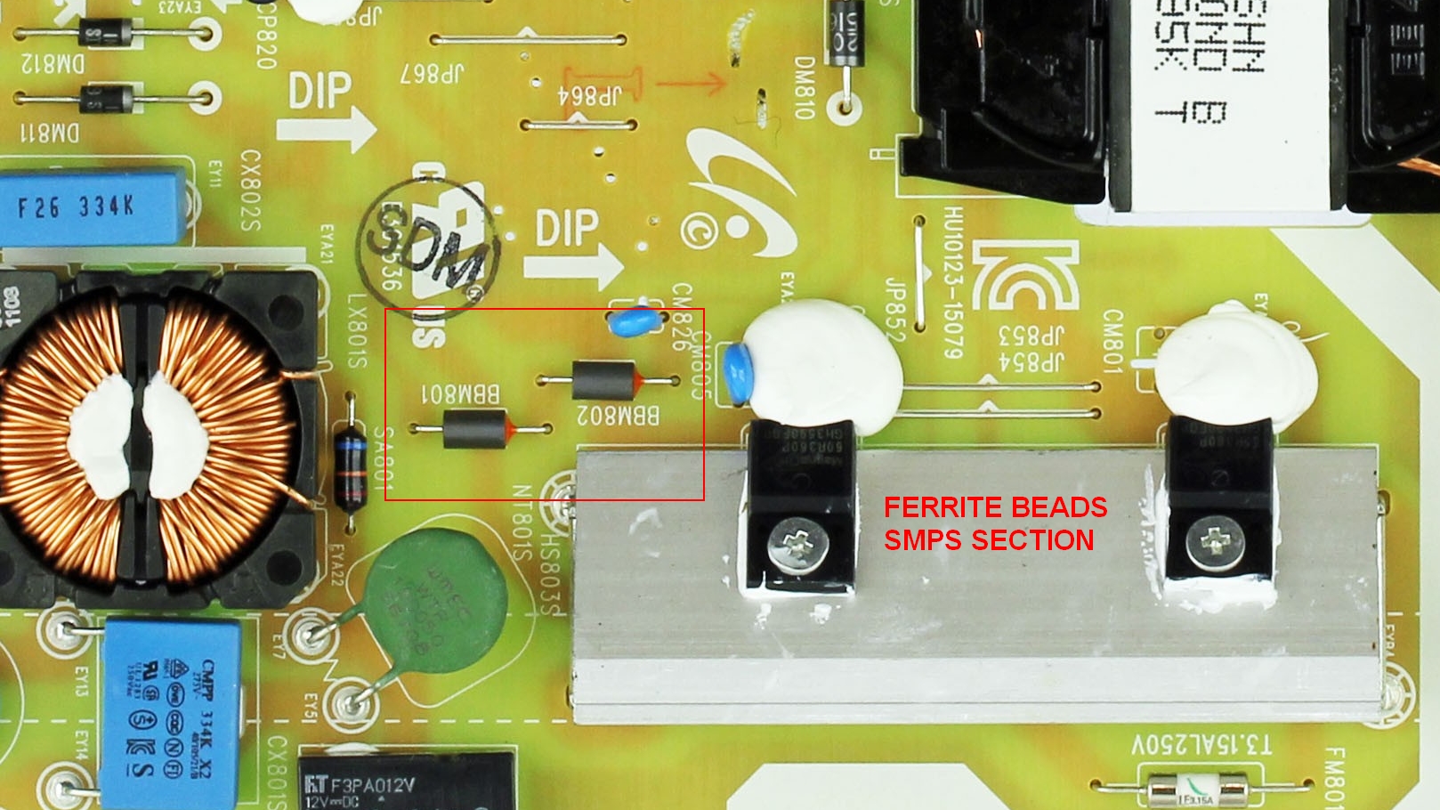

                  Oh man, stop making fools of yourself! I am laughing so hard right now my blood is boiling.
                  "old type of FB which no more used for many reason" LOL!
                  See spec sheet of the FB.
                  SAMSUNG BN44-00859, BN44-00980E. Samsung uses BBxxxx designator for Ferrtie bead inductor, LG and VIZIO (board not made by VIZIO) use FBxxx as designator.
                  So Samsung and LG are KOREAN BRANDS SHITS?
                  Now show me SCHEMATIC and the good clear pictures of YOUR power board that you have.

                      I show you the proof, where is your proof?
                      Show me the schematic and the pictures of the board?

                          So you are not going to show us the schematic and the board? That is what I thought, just more BS from you.
                          Here is 2019 SAMSUNG 75Q90.
                          BN44-00980E/F

                            1) Again, I still like to know what the P/N as printed on the body of that diode. Diode numbers....LT5302 and PR1007
                            2) Remove that diode and test it in both directions in using Ohm mode. .518 in one direction and no reading in the other direction. I guess this means the diode is good, correct?

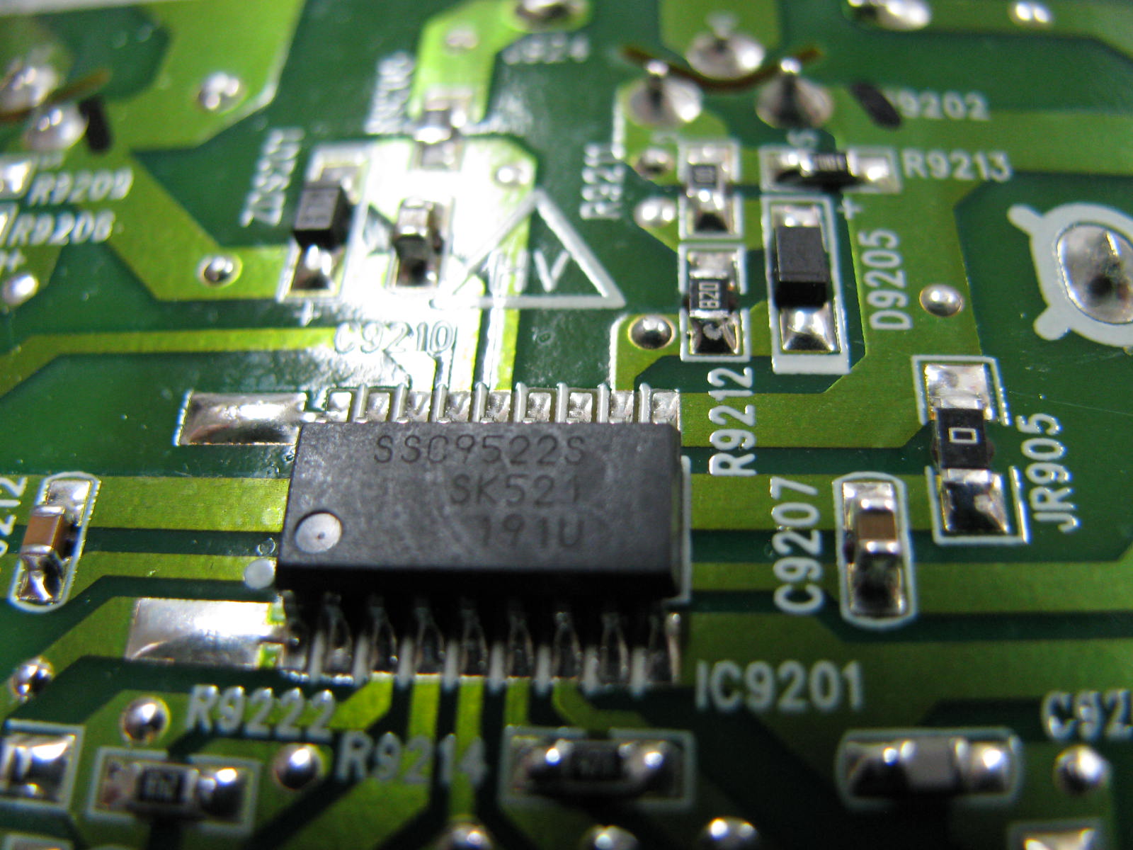

                            Please see attached pictures of IC9801 and IC9201.
                              OK, let me look up the spec sheet of the IC's so we can check the VCC pins first.
