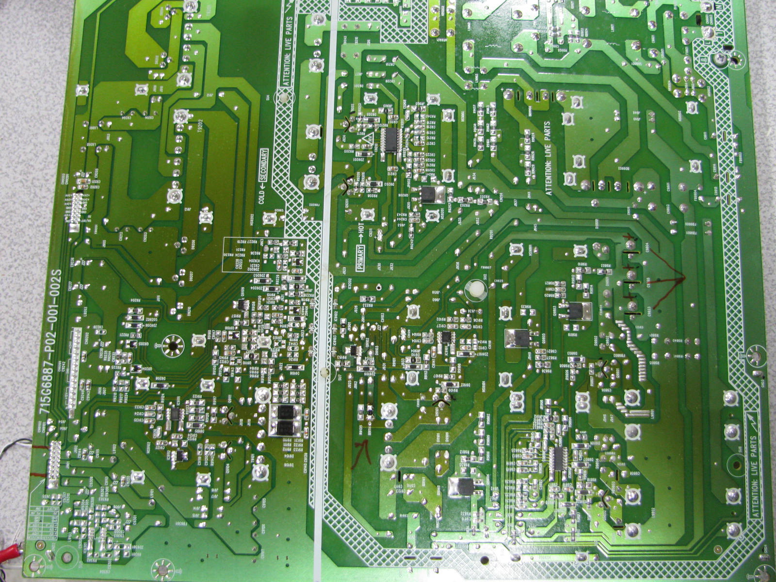

    Hey budm, sorry I didn't get a chance to do this yesterday. I just now followed your procedure and the resistor blew as soon as I plugged in the power cord. I didn't even get the chance to power on the board. The first time it didn't blow until I turned the TV on. This makes no sense. I did use a small clamp with rubber ends to clamp the board to the table to hold it in place. I clamped it over the power connector where the power cord plugs in. I don't know why that would have made a difference.
    My post #54:
    You can do the force on test without the resistor, I suggest to use resistor in case you make wrong connection that can cause damage to the circuit, so if you perform the connection correctly for sure then you can do without using resistor, so inspect real well on how you have the PS-ON and 5V/3.3 pins connected together, I would solder one wire to each pin then you can connect the end of the wires together after powering up then wait about 5 seconds before connecting the two ends of the wire together to simulate power on condition.
    Did you follow that instruction to wait 5 seconds before connecting the PS-ON to 5V/3.3V pin?

      Originally posted by budm
      My post #54:
      Yes I did. The resistor blew when I connected the power cord to power, before I had a chance to connect PS-ON to 5V/3.3V.

        Something changed then because without force on there will be no switched VCC to feed the PFC circuit, and we also remove the jumper for the VCC that feeds the 12V/24V SMPS IC.
        So when the R9114 was not blown up when in standby, the original diode was installed correct?

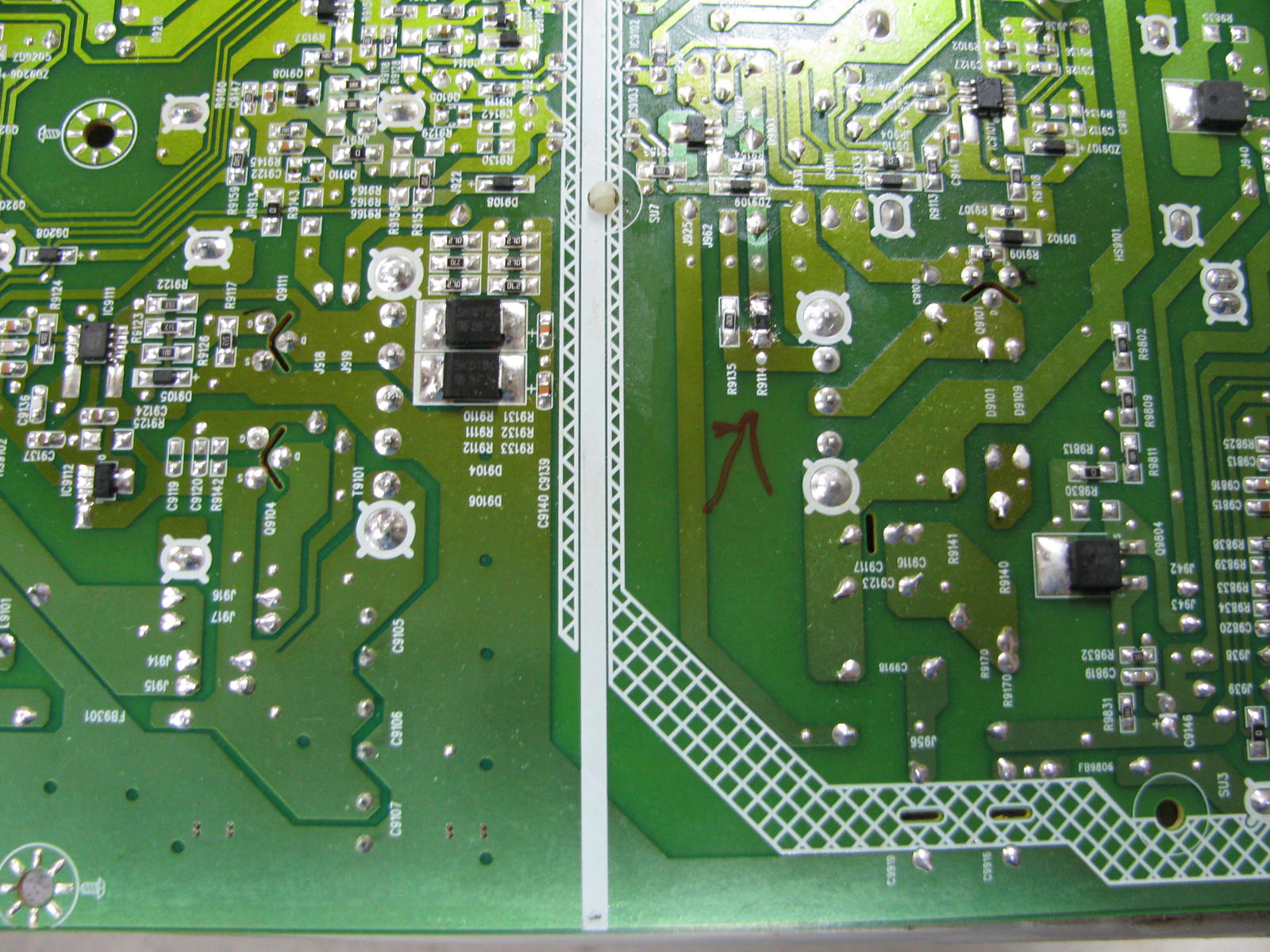

        I like to see the new pictures of the location of where R9114 is, we need to do some resistance testing to see if that AUX power supply section is seeing shorted load or not.

          The original diode was not installed when in standby. I replaced the diode and the resistor at the same time.

            So is the diode you install the Fast Recovery diode as it has to be?
            What did you put in?

              This is the diode that Digi-Key crossed the old one to....1N4007FFGOSCT-ND.....DIODE GEN PURP 1KV 1A DO41.

                  You cannot use general purpose diode in that section, it is too slow to turn off (stop conducting) when using in high frequency circuit. You need to get the correct type for it as I already explained before. I hope no new component gets damaged.

                                  When you put in the new parts, put the jumper wire back in place, remove the force on wires.
                                  We want to put it back to original condition and go from there with the correct parts installed.
                                  Did you order 1R0 or 1R8?

                                      Hey budm, I just finished reattaching the jumper, installing the correct new diode and a new resistor. Now I have no power. You mentioned that the diode I had installed could cause something else to blow and I guess you were right, unfortunately. I can't believe Digi-Key cross referenced the wrong diode. Do you have any ideas what I can do now?

                                        So right now the new resistor did not blow the minute you apply AC to the power supply board, correct? and you are not getting standby Voltage either, correct? If that is the case we now have to troubleshoot the standby power supply section.
                                        So what is the P/N of the new diode? we want to verify we get the correct one.

                                          No, the new resistor did not blow when I connected the power. The led light on the main board is not even coming on now, neither flashing or solid.
                                          The new diode part number is PR1007G-T. I got that number directly off the old diode.
