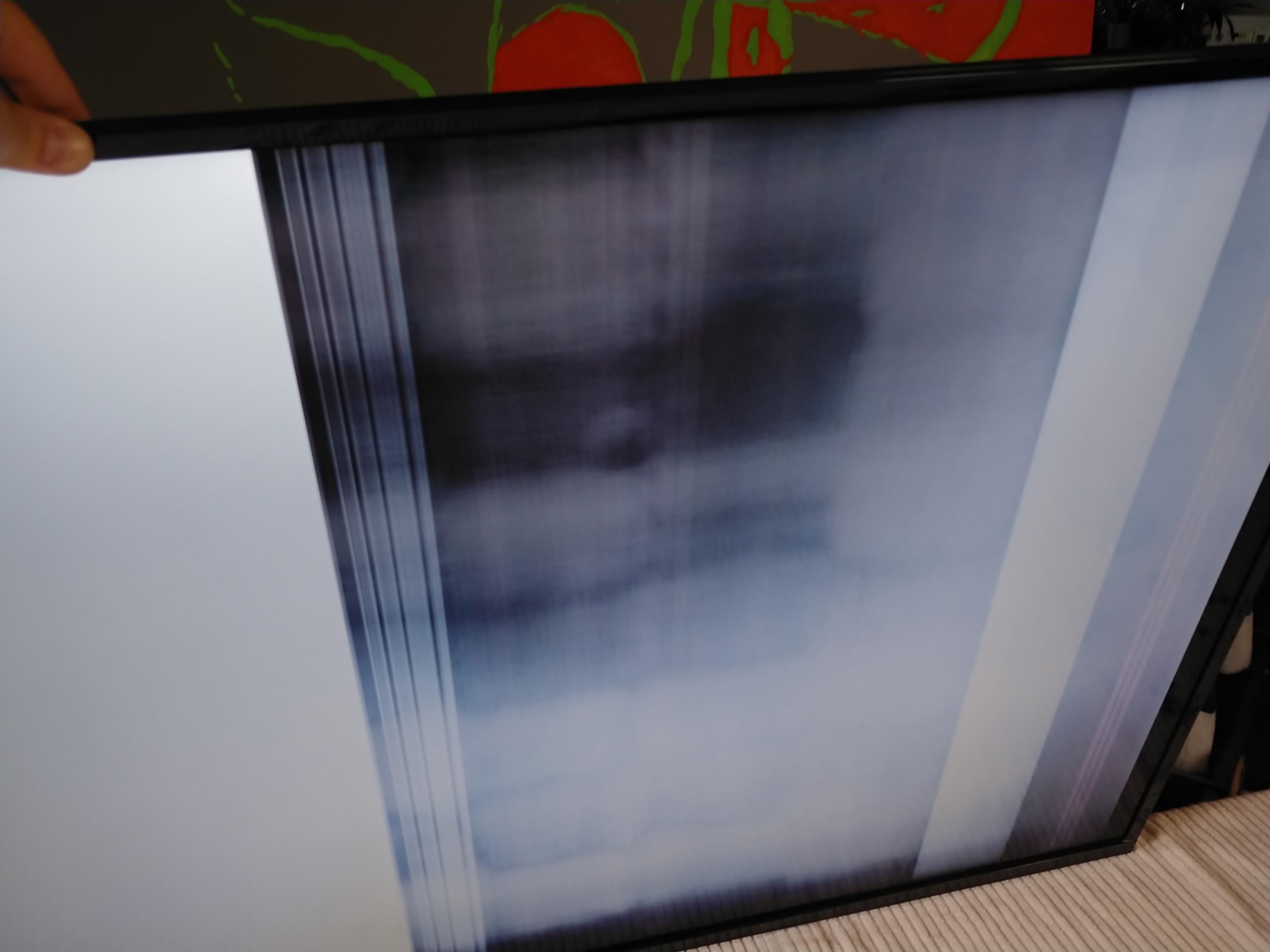

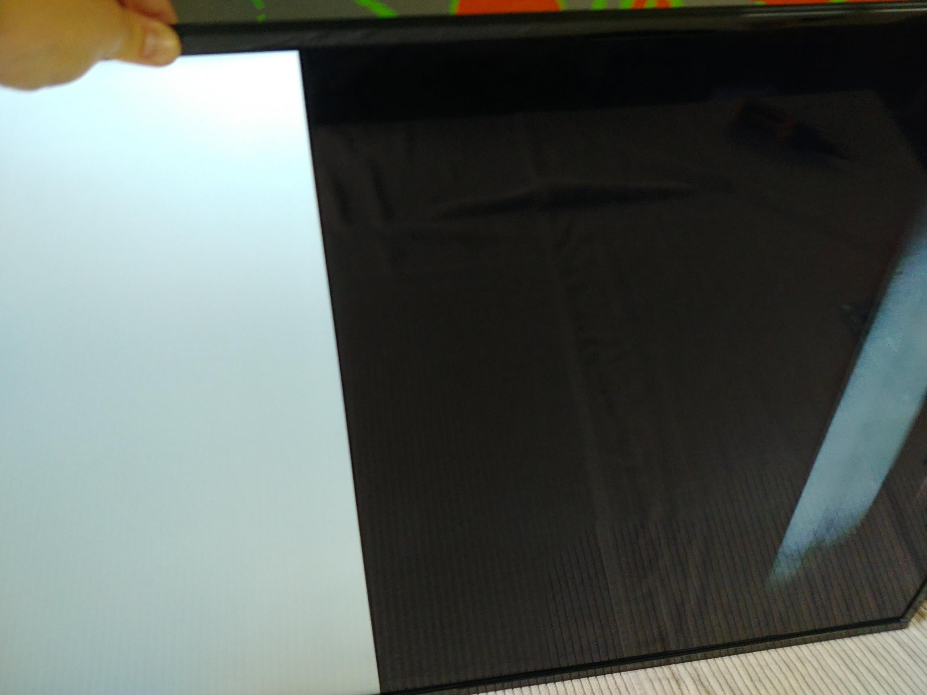

        #63
        Re: Bad T-con or bad panel??
        So a few questions before the results of the test.
        Does anyone happen to know if this tv or tvs in general are color additive or subtractive?
        I ask because when you unplug one of the sides that side goes white. Which means the R, G and B lcds are all set to 255 (or what ever number of bits tv's use now). That makes me think its color subtractive because no signal results in all colors (which equals white)
        But when either side is plugged in that side goes black at boot up when the tv is showing which input is selected and the rest of the screen is black which means the R, G and B lcd's are all "closed" (not re-polarizing the light)
        To me that would seem to indicate that every pixel on the screen is functional as it can operate both extremes.
        Does this theory have any validity? Or are there other parts in modern panel circuitry that i'm not aware of?
        Now to the test results
        So when I first turned the tv on again I was fully expecting no picture (as I thought part of the issue might be that once things heated up thats what got things kind of working again)
        I was wrong. The tv had full picture from cold boot but still half dark. But what I found more interesting was the OSD. It didn't seem to suffer from the darkness issue at all. (See pic1 and pic2)
        What I also find interesting is that the darkness problem doesn't start exactly at half of the screen. It fades over. There is no hard line. (See pic1 and pic2)
        Now once I popped the tv open and unplugged the "dark side" from the t-con I got pic3. I figured maybe there was a short again and it was just black. But slowly I started to see some sections of the screen changing. (See pic4)
        It faded from pic3 to pic4 to pic5 over 2 seconds or so and I realized it is displaying the lg background pictures when no source is available. I waited a few seconds longer and it started to fade again (changing pictures). It faded in to pic6.

          #64
          Your problem is that there is an issue with the drivers on the dark side. If the set had tabs on the panel along the side, then you would likely see / feel where the problem lies (ie. heating, burn marks, etc). However, on a set that has no side tabs, then the problem falls to signals (powering) not reaching embedded drivers on the panel itself. This is typically done with connections at each corner of the panel with connections associated with the bottom edge boards and the end bottom tabs. In your case, as your previous picture showed, there was a dark spot in the corner of the panel. This is the likely source of your problem. It is unlikely recoverable / repairable / saveable with any techniques discussed herein (ie. tape cutoff, tab removal). :-(

              #66
              I have questions.
              ***This is in no way trying to challenge what you have said. I just want to learn more then what I currently know***
              The drivers manage to switch from black to white with no issue (which to me says they can drive all of the R, G and B's of each pixel. I would also assume that these two states don't rely on any feedback as its full on/full off kind of thing. Would this be correct?
              Also when both sides are plugged in the OSD appears unaffected by what ever the issue is (the darkness). Does anyone have any idea why?
              Also the biggest question I have that i'm hoping some one can answer. Why if its only displaying a very poor picture on that half of the screen when the good side is unplugged does it then start to display a completely valid picture that is just darker when the good side is plugged in?
              When I saw this behaviour last night I started to think it was a feed back issue and that it cant adjust the colors properly to draw things due maybe a bad reference signal. (But again I do not have a background in lcd panel eng)

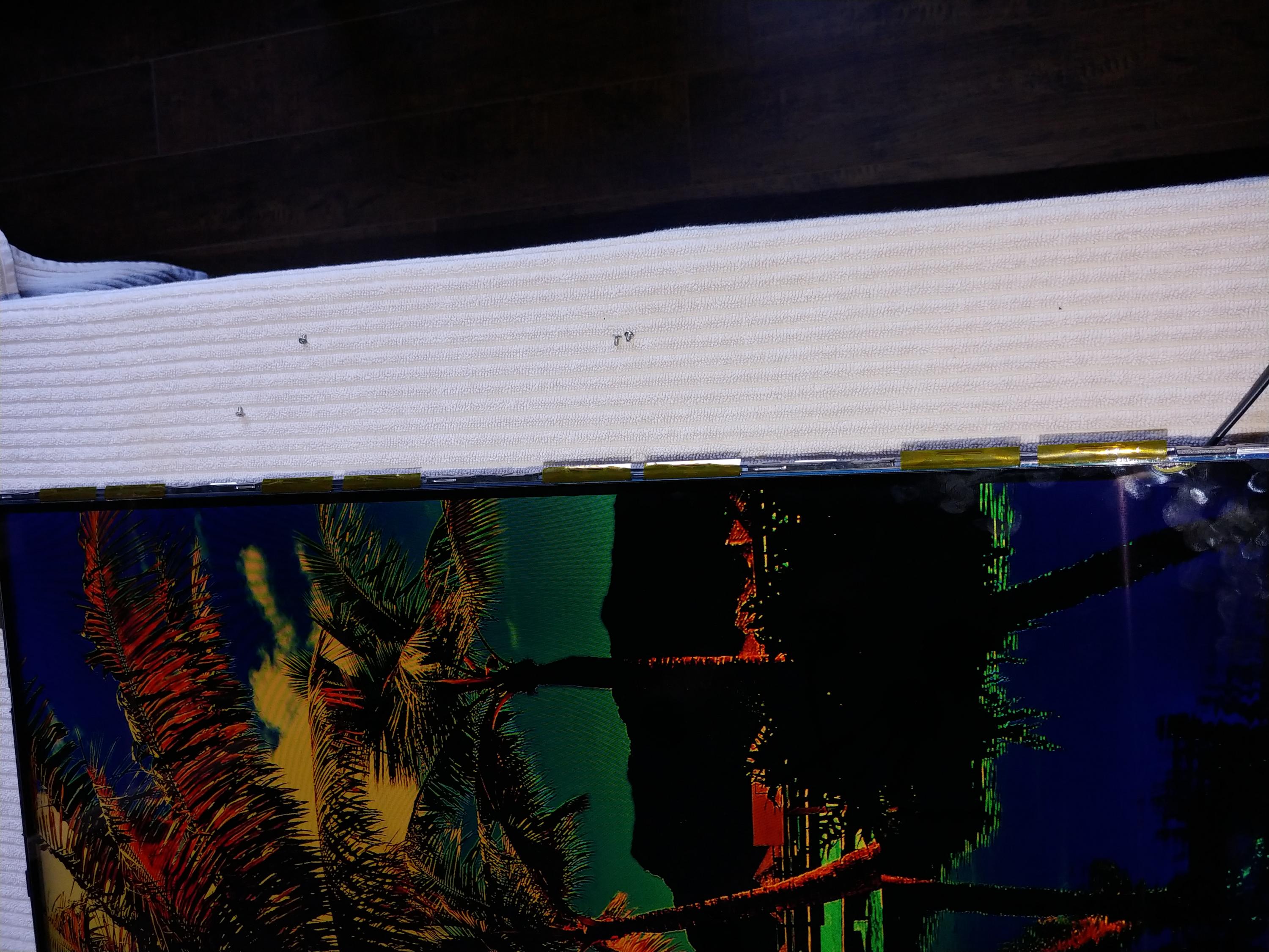

                                    • budwich
                                      • Jul 2015
                                      • 3097
                                      #78
                                      IF you have side tabs WITHOUT edge boards, then your problem is that the signals / voltages to the side tabs travel thru the panel "circuitry" from the bottom edge boards. You posted a picture a way back showing a "black spot" at the bottom corner of the panel. It is likely that area is causing problems for both the bottom and side. However, it is possible that you can get a "full image" with the removal of the side tabs as they appear to be "lacking drive" which then loads down the drivers on the other side of the panel. This results in the "dark side" that you are seeing. Once those side tabs / drivers are removed and are no longer loading down the opposite side, it is quite possible you may get a "full picture" that might be "relatively viewable" (ie. not golden eye"), assuming the forementioned spot is not a major panel issue (crack or otherwise).

                                          #80
                                          So I tried to poke at the all the tabs and no such luck with anything.
                                          I also noticed while doing this that there is most definitely lcd timing issue.
                                          While poking all the ribbons on the side I noticed that when the stock lg background display picture changed I could see that some pixels close to the edge of the "dark side" took much longer to change then anywhere else.
                                          For an idea of what this looks like, think of a the sweeping effect from one side to the other. Picture first changes on the one side and the change sweeps towards the other side.
                                          Now this doesn't happen for the whole picture but as you go further and further towards the edge of the "dark side" thats what it looks like is happening. Depending on the picture I watch some pixels take as long as 5 seconds before they were updated with the rest of the screen.
                                          Also the attached picture show the side of my screen with the tabs that are connected to nothing. (as requested)
