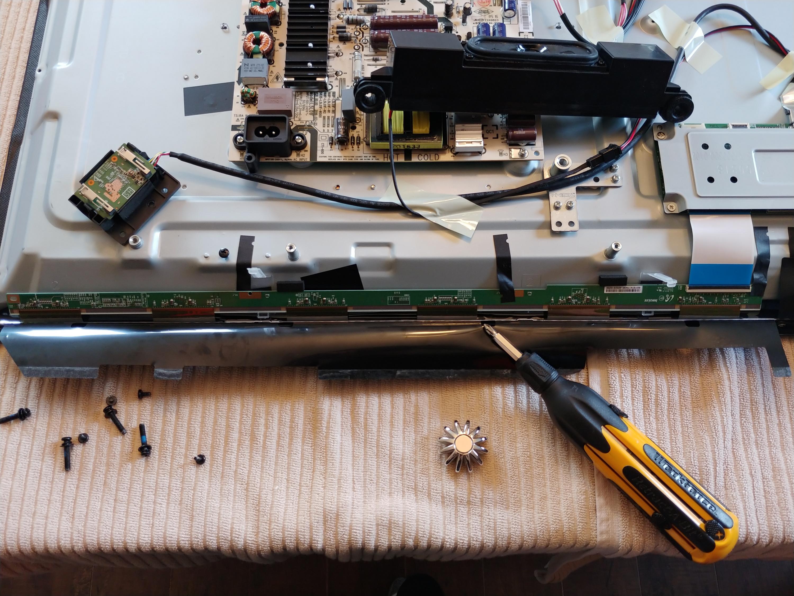

      The tabs in the picture are along both sides and none or connected to any external panel.
      The tabs at the bottom are connected to 1 board on each side of the bottom. (2 boards on the bottom total)
      General question (for anyone that may know)
      How does removing the tabs (on tv's where its been proven to work) not effect the image? Taking out one of the drivers should result in lost of a chunk of the picture, should it not?

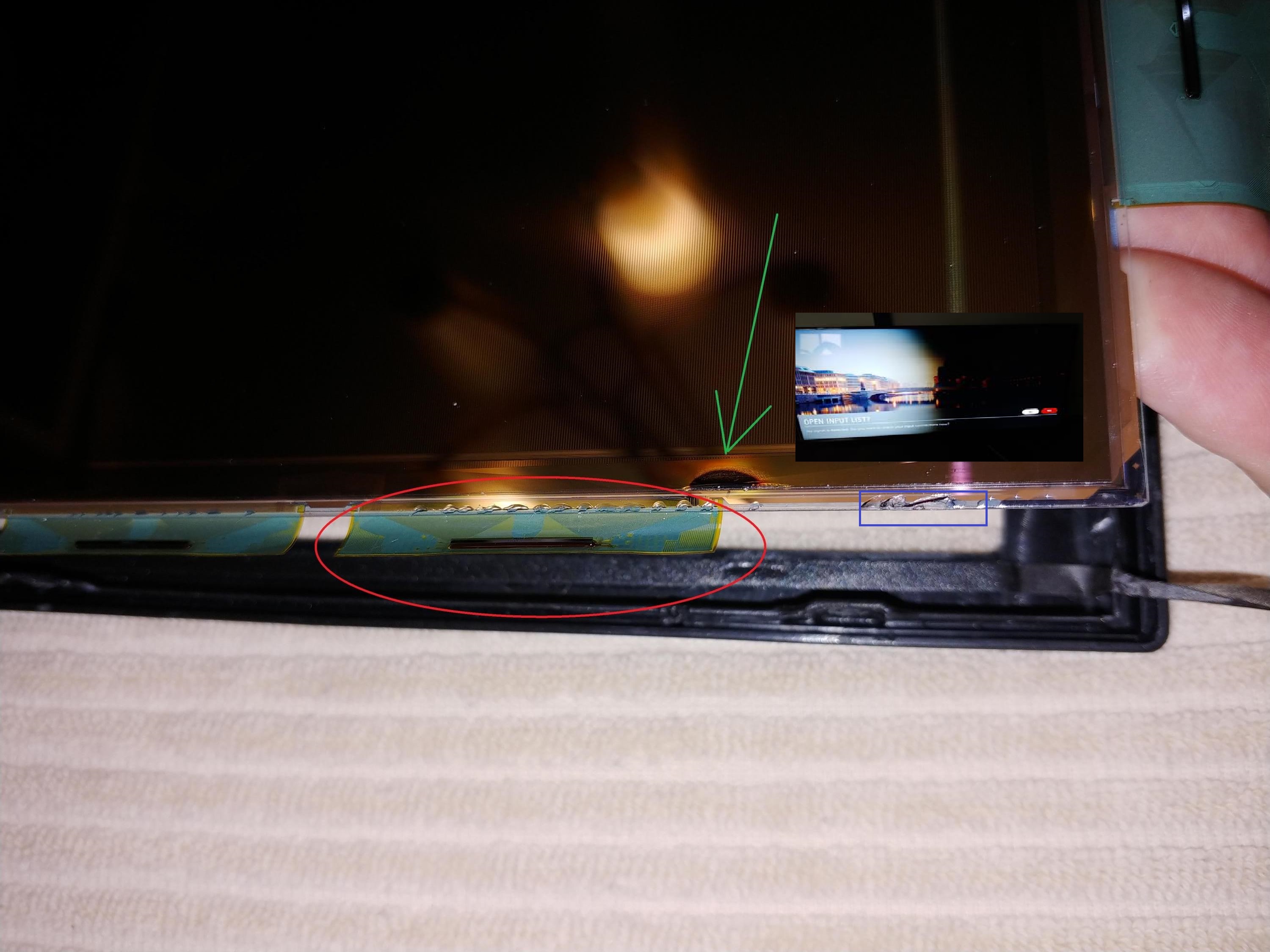

                    Here you go. A picture of the bottom board on the tv. (this is the board for the dark side)
                      #90
                      Re: Bad T-con or bad panel??
                      you post 2 photos i merge them the main one there look broken line ( remarked with blue color ) on the thin film of + VCC on the effected side which it show dark on the other photo you posted. this all guess from the photo maybe its different in real.
                        #91
                        yes that side with the chipped glass is the dark side. I looked at that glass at first thinking it was the issue but it didn't appear to short that thin film line.
                        That's why I was asking if that dark spot is something that is common on panels.
                        So your thoughts are that the VCC line in the glass got shorted and thats what caused the black spot?

                          shorted or not this is not what we seeking.. we need the vcc to reach the effected side and the side along tab .
                            #93
                            I'll try and get a mesurement and see whats getting vcc tomorrow or Saturday.
