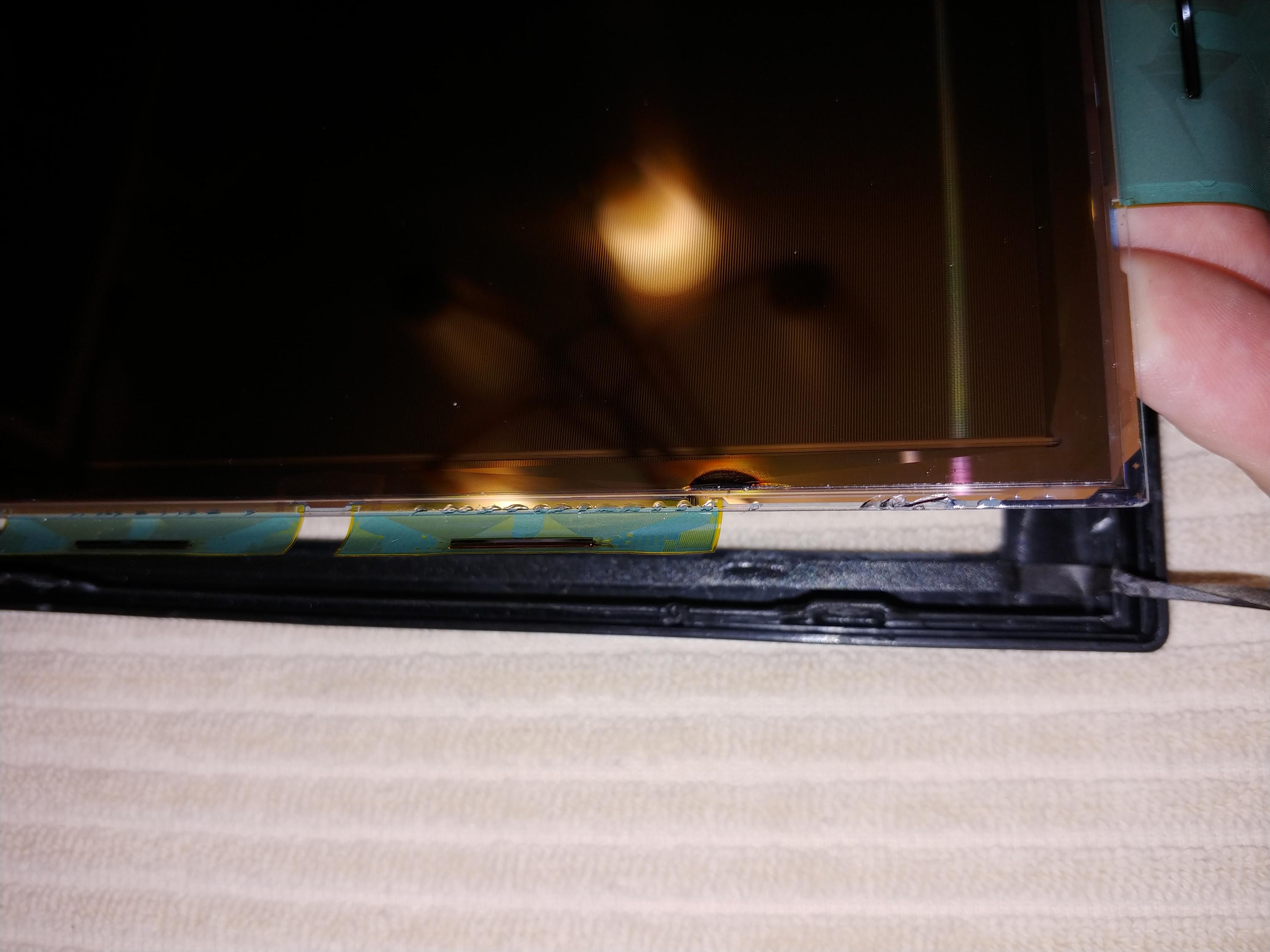

                So looks like the screen is damaged but I thought I would update for anyone that comes through with similar issues.

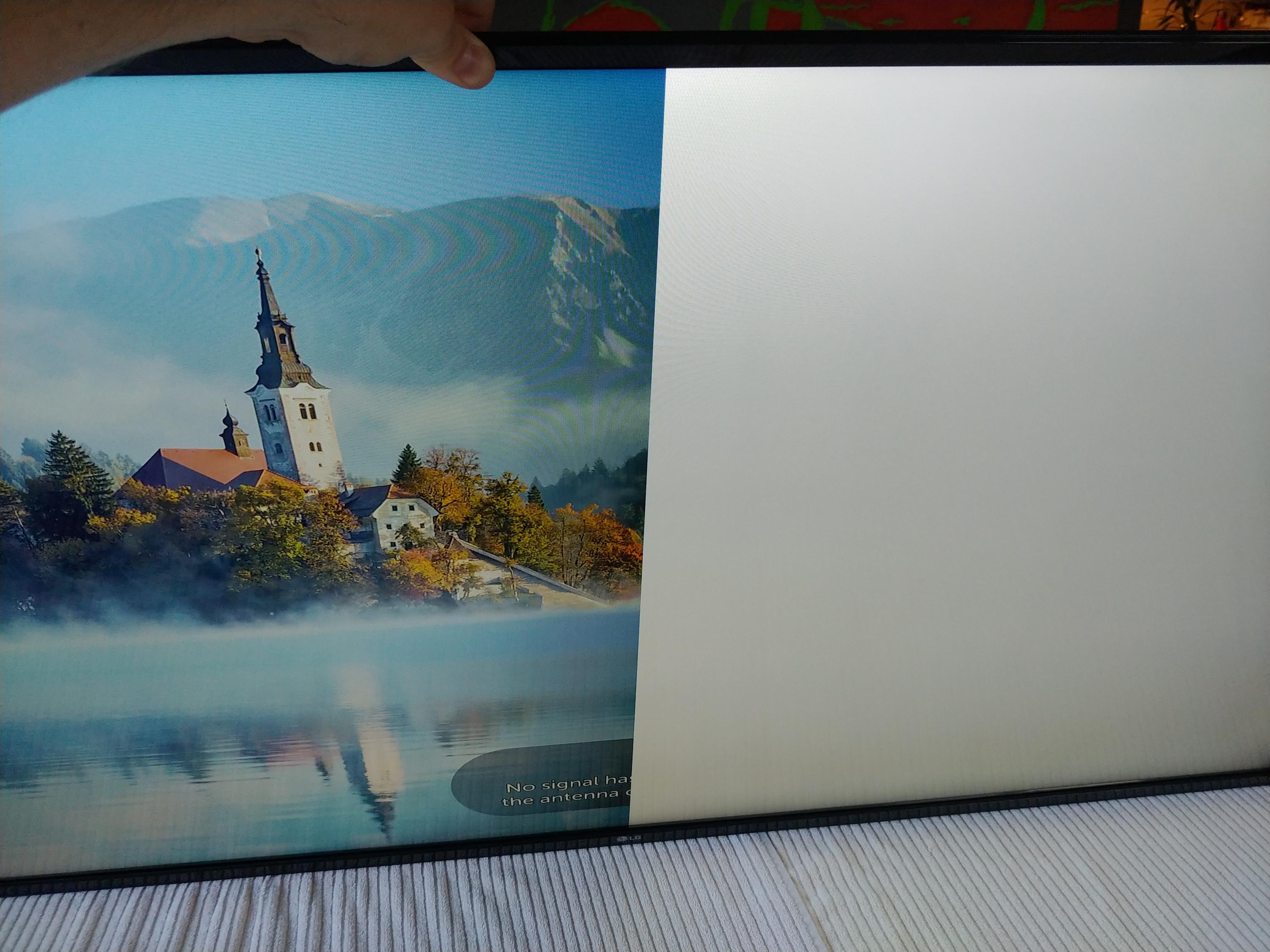

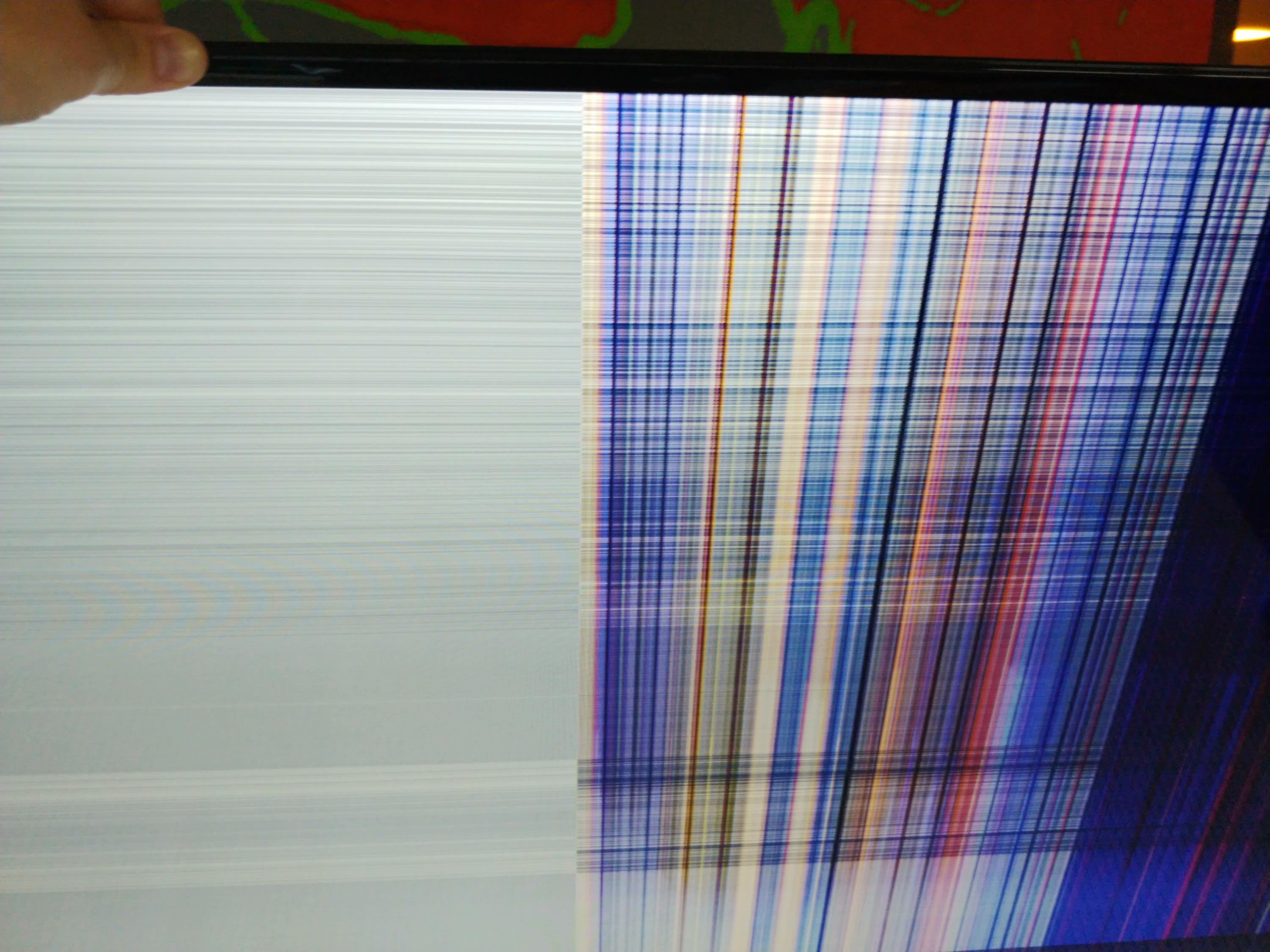

                I was asked to take pictures of the screen with each ribbon cable unplugged. (Pictures attached)
                As well I took the tv apart again to look for any new damage and found what some what looks like breakages to the screen as well as a black spot that looks like shorting.
                strangely it looks like the damage to the screen is only to the outer ground layer but clearly its more then that.
                Please see attachments for further clarity.

                  now you don't have to lost play with tAP cut or whisky tape on the defect side as nomoresonys suggest... who knows you could have satisfied picture

                      use whisky tape the thin one to cover the first 3-4 pin on the defect side ribbon ..
                      you may try more pins to cover or less till you have satisfied picture better than to rubbish the panel

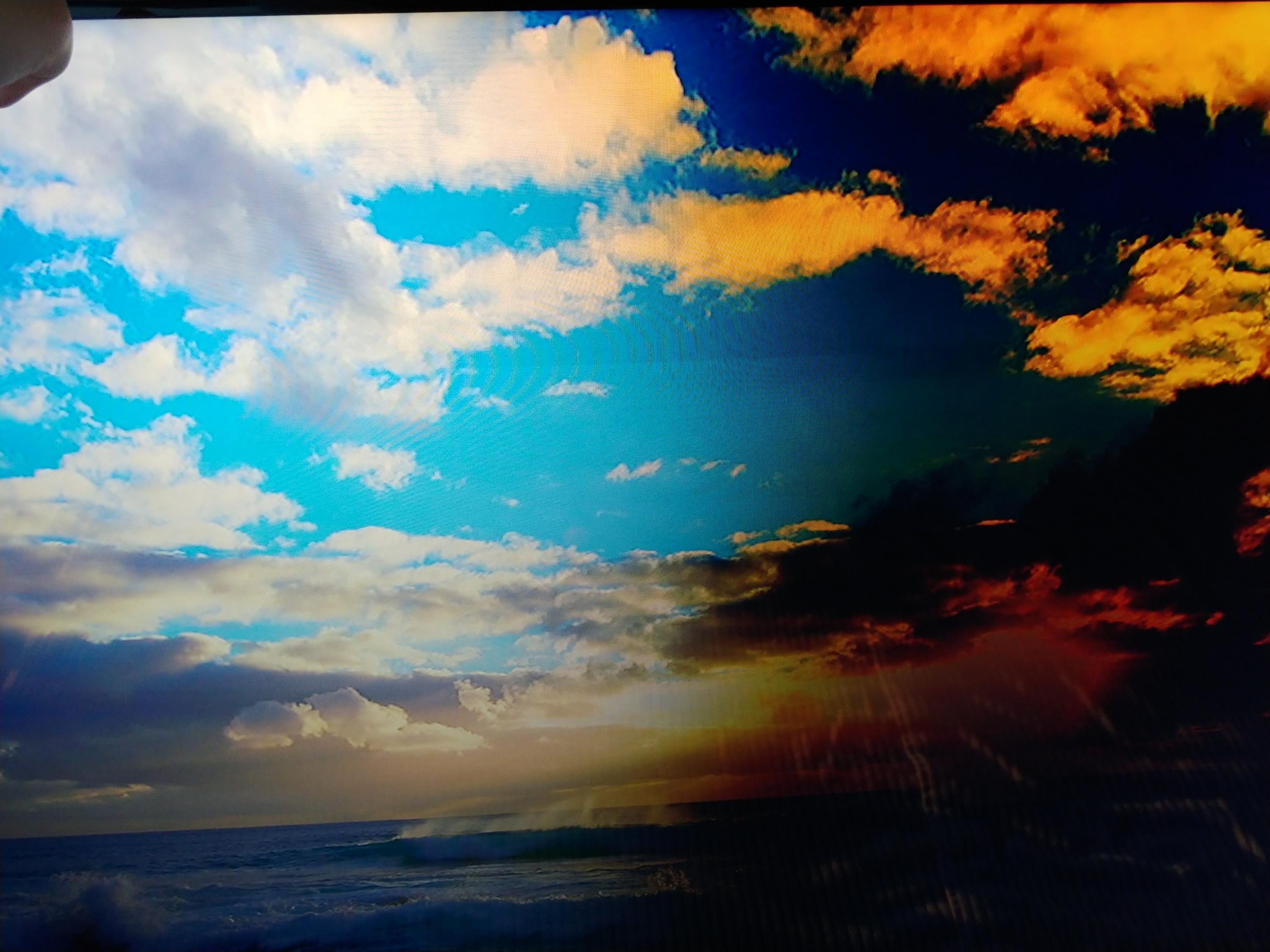

                                So I gave the tape method a try and the results are quite perplexing...
                                At first I started with most of the pins taped but the last few. As you would expect only the "good side" lit up.
                                Kept removing and adding tape until i was just about ready to give up. The most I could get out of the "bad side" was some garbage while the other side stayed lit with picture.
                                Then I removed a little more tape leaving pins 44, 45, 46 covered. All of a sudden I got a full picture. I thought I had figured it out and it was "fixed".
                                After a few of the background pics started being displayed I noticed that the "bad side" was a lot darker then the "good side". (See attached picture)
                                So I went back and removed the tape from pin 44. That cause the "bad side" to be very very bright. (brighter then the good side).
                                So I went back and moved the tape to pins 44 and 45. That made the "bad side" go back to darker then the good side again.
                                So uncovering pin 44 made it bright, uncovering pin 46 made it dark. Seems like the panel works as long as pin 45 is covered.
                                I made sure that only pin 45 is covered hoping for the best. The "bad side" was still darker then the good side.
                                So i play around and only cover 44 and leave 45 and 46 uncovered. the "bad side was super bright again"
                                At this point I was pretty much giving up. I removed all the tape and plugged everything back in like factory, just for the hell of it. Now the "bad side" is still dark but i'm getting full screen still.
                                I have no idea what is going on. I thought maybe some tape was stuck in the connector or I had damaged the ribbon cable.
                                I used a magnifying eye piece to verify there was nothing in the connector and I swapped the good side and the bad side ribbons to verify the ribbon was not damaged.
                                So as it sits on my table fully put back together I have no modifications at all and a full picture but the "bad side" is darker then the "good side". I also noticed that there is ghosting or a fading effect on the on the "bad side" when using the tv menus but didn't get a chance to check if it has any with a video (or if that is how the menus should look when appearing and disappearing.
                                So i'm not really sure any more if the screen is damaged. I would think that if anything is being displayed on the "bad side" then it has the capability to display what ever its being told to display.
                                You could also look at it and say one of the colors is not working and thats why its dark but the colors look right. They are just dark so the R, G and B have to be working. As well when covering pin 44 the "bad side" gets very very bright.
                                So i'm at a loss. Would a bad panel present like this? or should I be looking back at the t-con board?

                                  did you still hear puzzle?? can you show us picture when cover tape make the defect side brighter?

                                    There is a little buzz but it more sounds like a buzz from a switching power supply not the loud buzz that I was getting that sounded liked a short.
                                    I don't have a picture of the when pin 44 was covered. but just imagine what it would look like if your cranked up the brightness to extreme levels but only for one side of the screen.

                                      also pin 44 are Gama..
                                      at this point you reached i would suggest you dont touch the ribbon socket from panel side any more.. let it work with external live signal for view time as it start from cold state( out from wall sockt ) if the condition remain as ou show us in the photos. not bad at all if you do risk and investment little by replacing T-CON... but no one be sure what the result.. just try.
