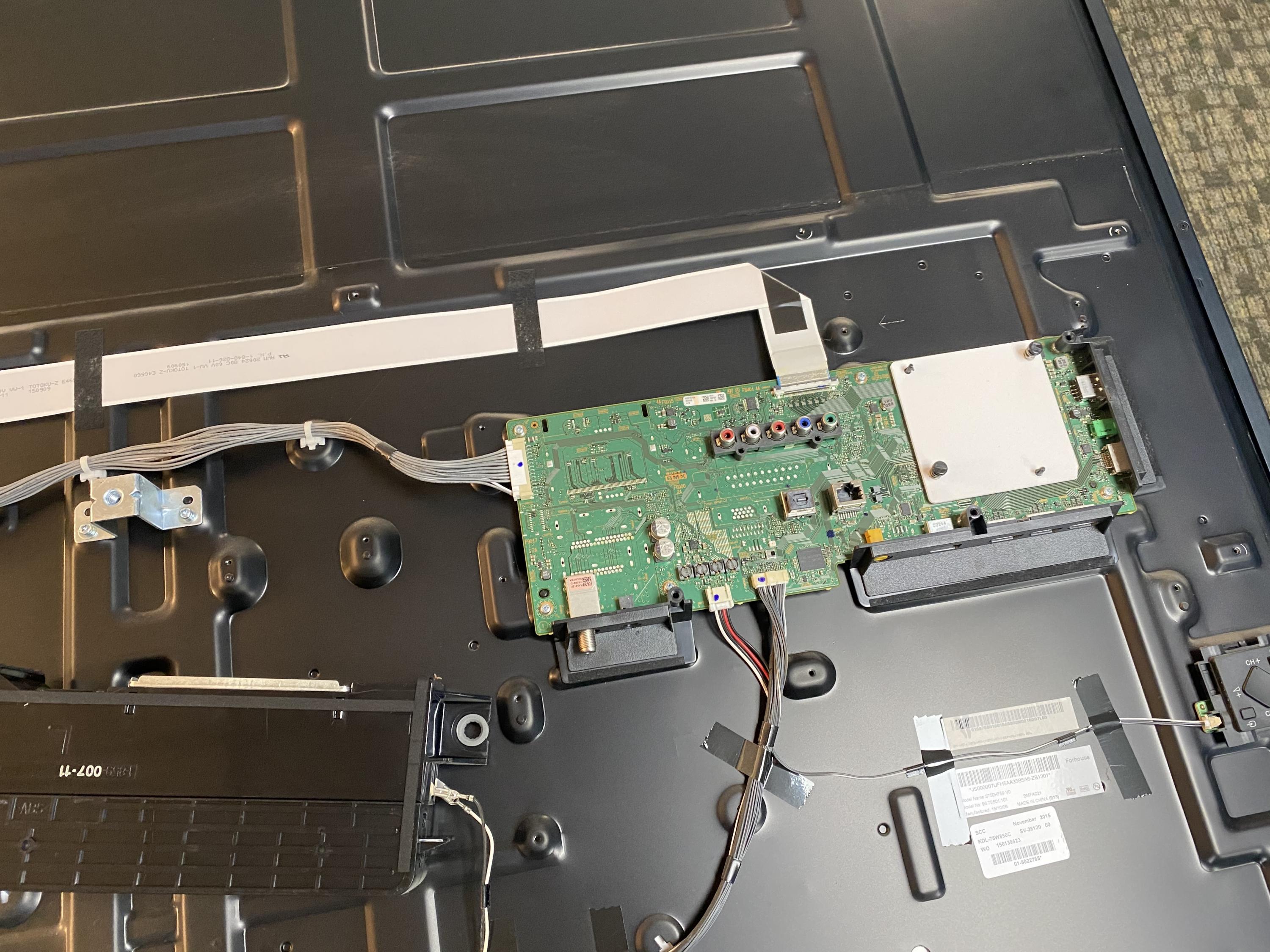

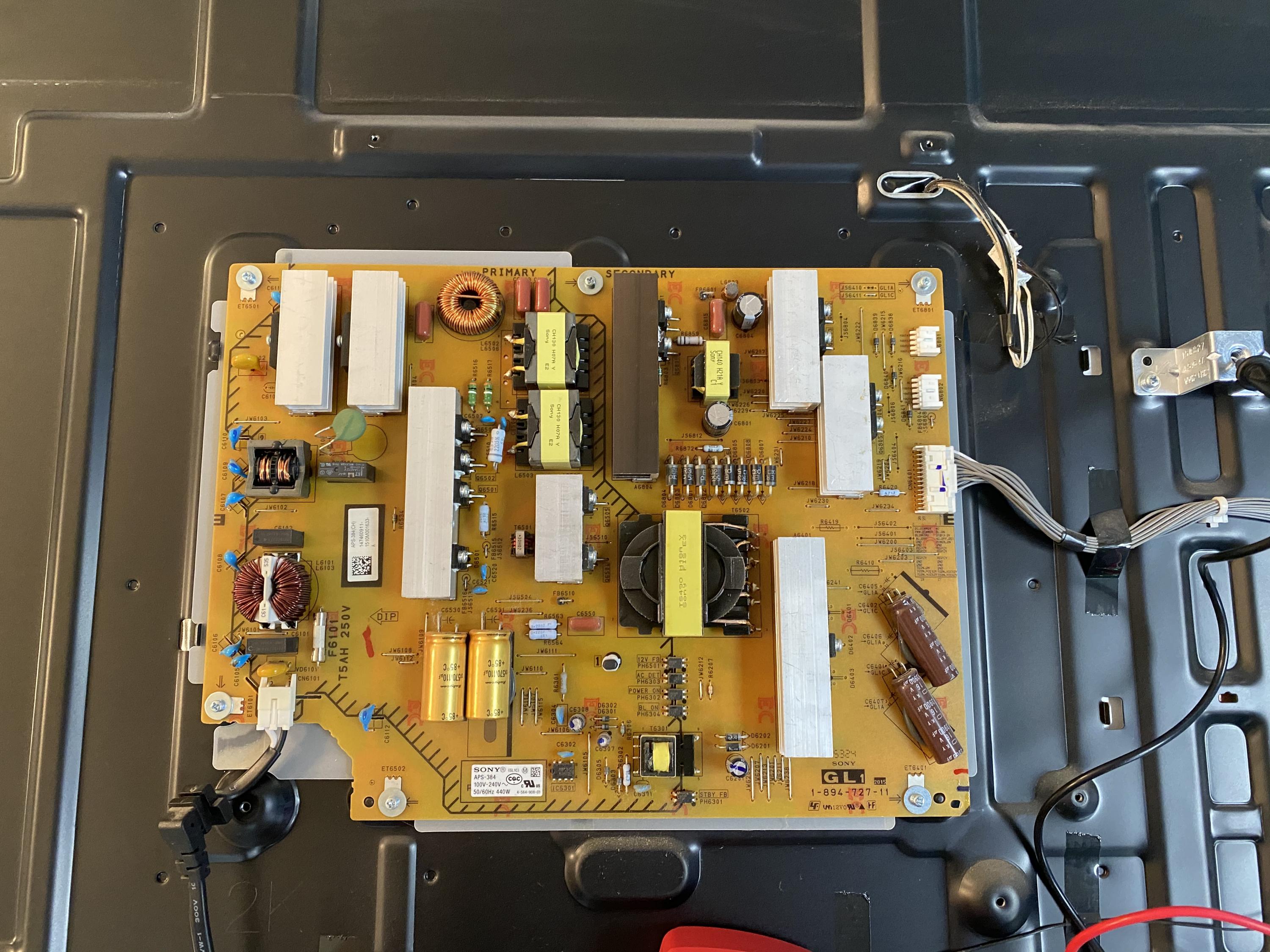

    I have a Sony KDL-75W850C that when powered on it blinks the backlights and then turns off. After a couple seconds it will then go into the led blink mode and will blink 6 times. I took off the back and the power board clicks on when powered on and then clicks off after a couple of minutes. I have seen where this could be backlights but is there a possibility that the powerboard or main board could be bad?

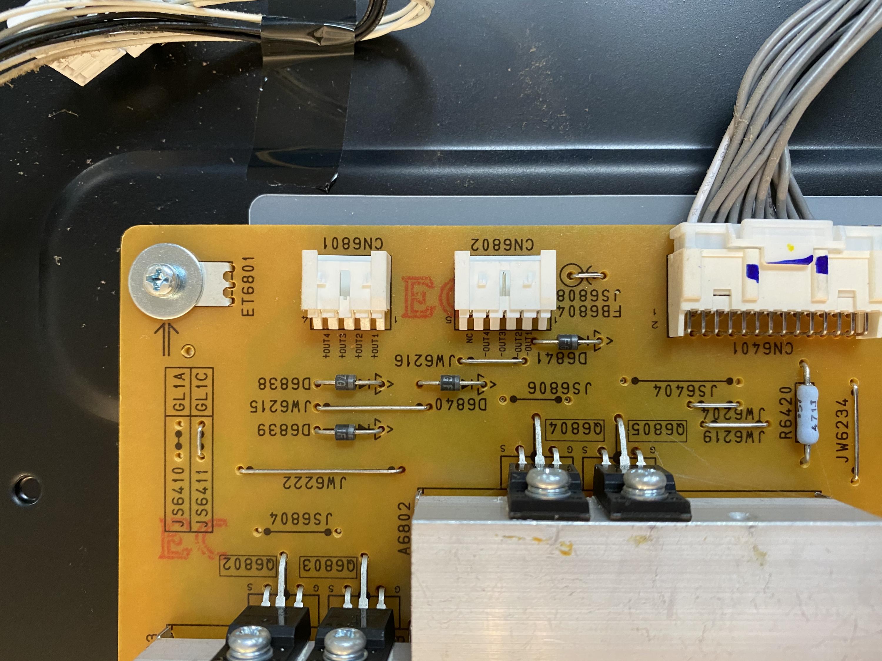

    Check your led voltages at the led connecter at switch on and see if they peak then drop before the power supply switches off.
      Re: Sony KDL-75W850C Issues
      +1
      You need to put all connectors back in place, then keep black probe on the chassis and then Red probe on each pins of the LED connector, since you have 4 LED strings, then you will have to preform the test 8 times when turning on the TV on while watching the meter.
