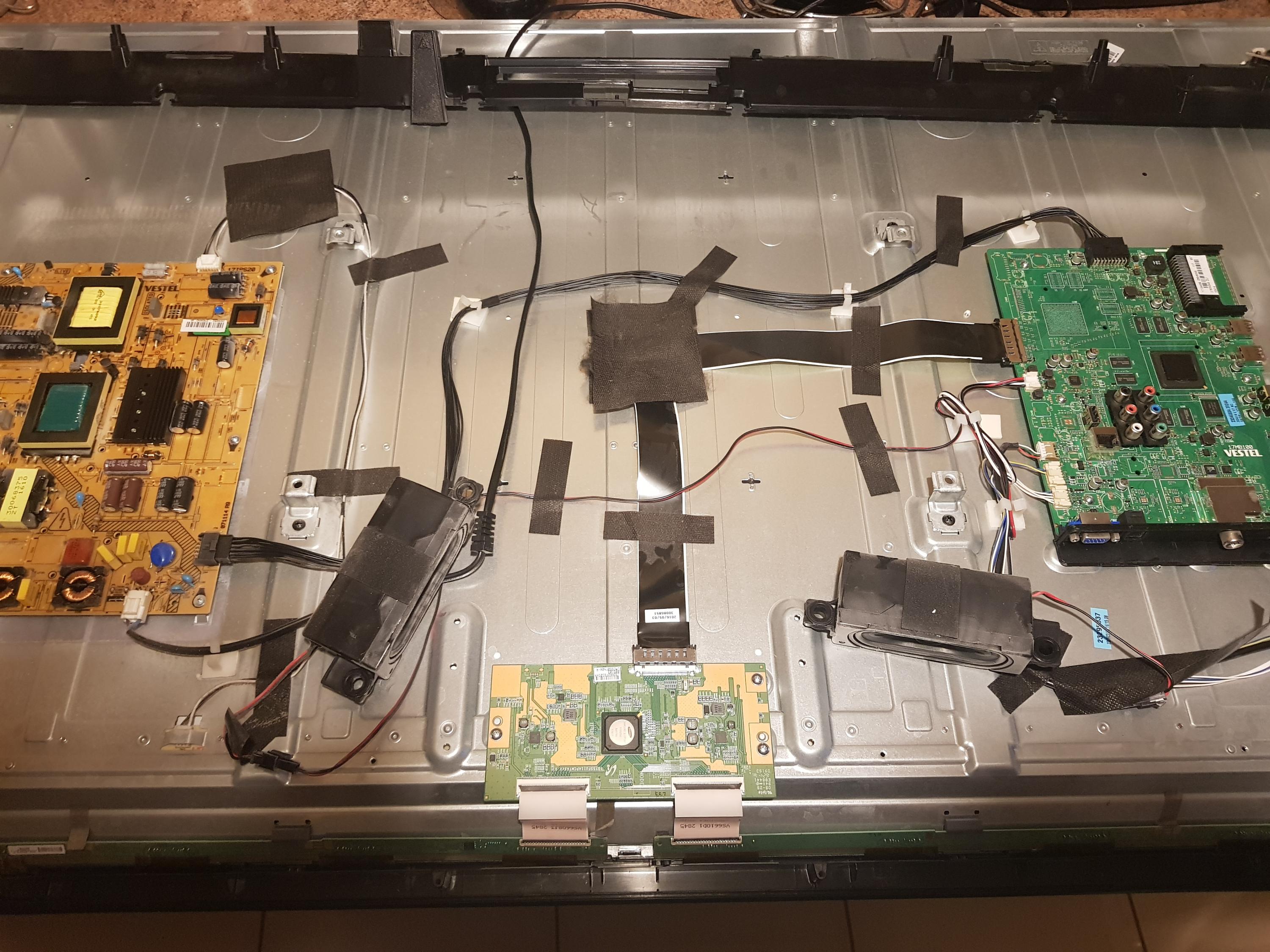

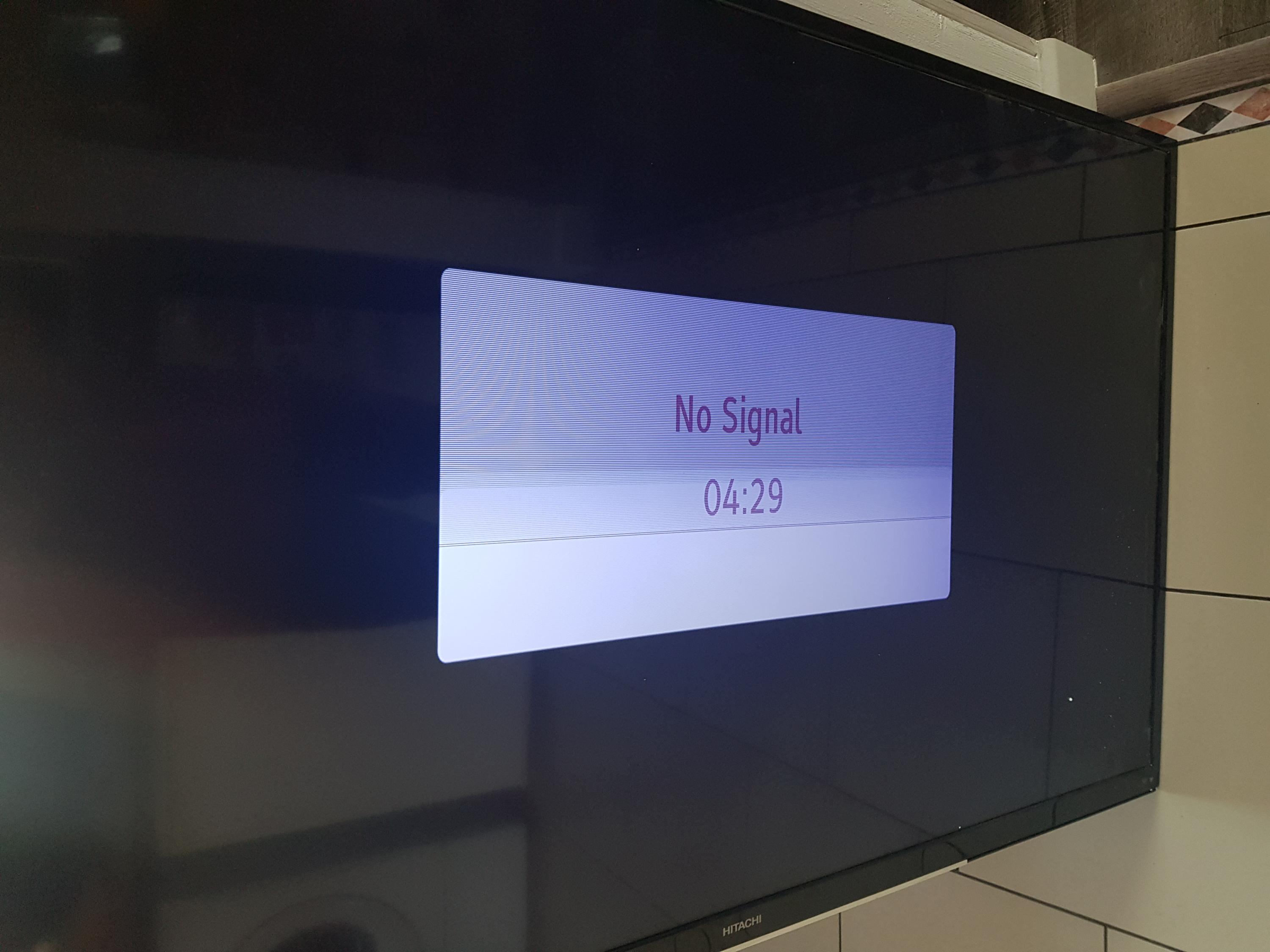

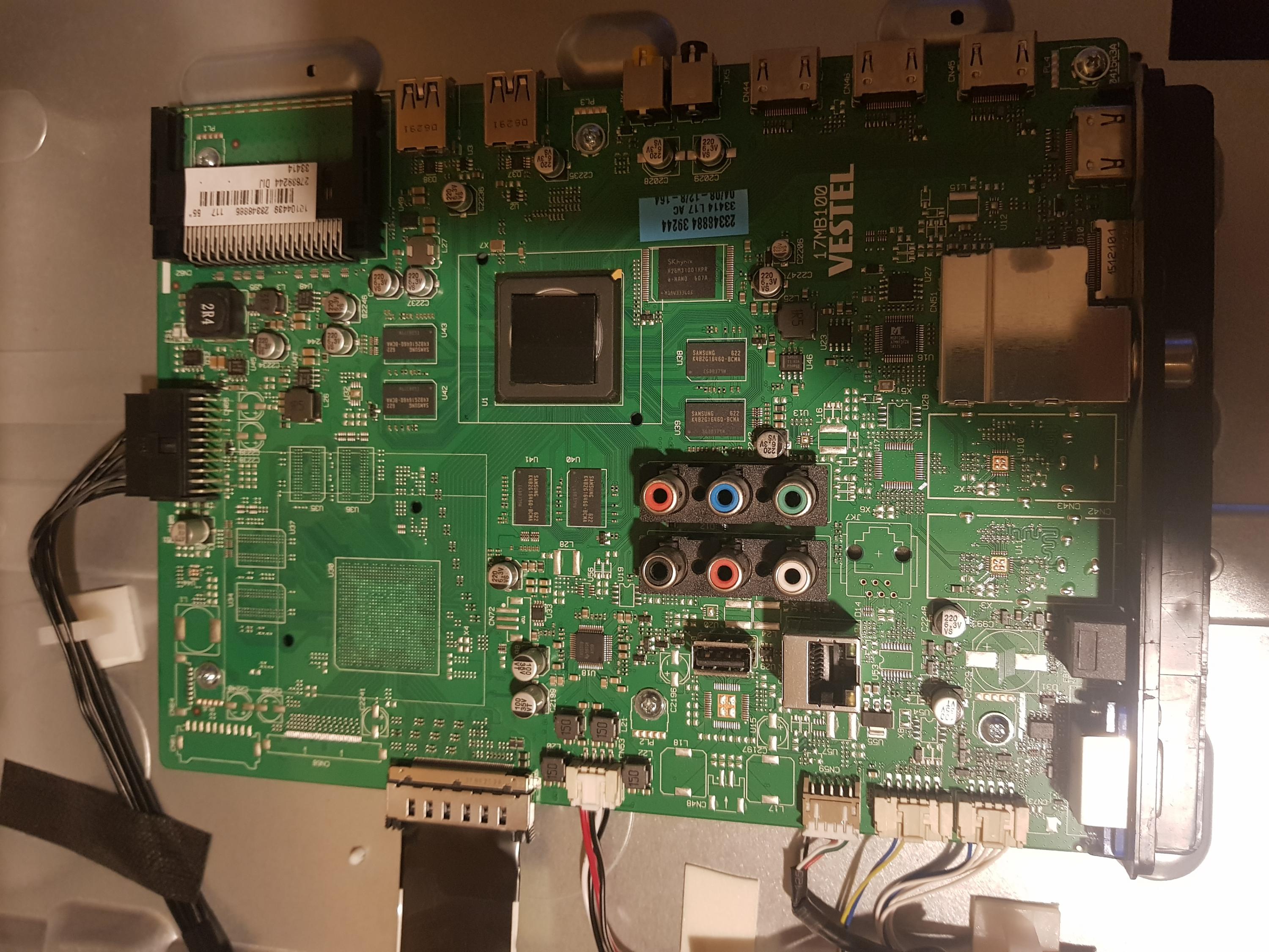

    Good evening
    Recently acquired this TV 2 small faint lines going horizontally across the screen and middle of the screen has a ghosting,jumping image

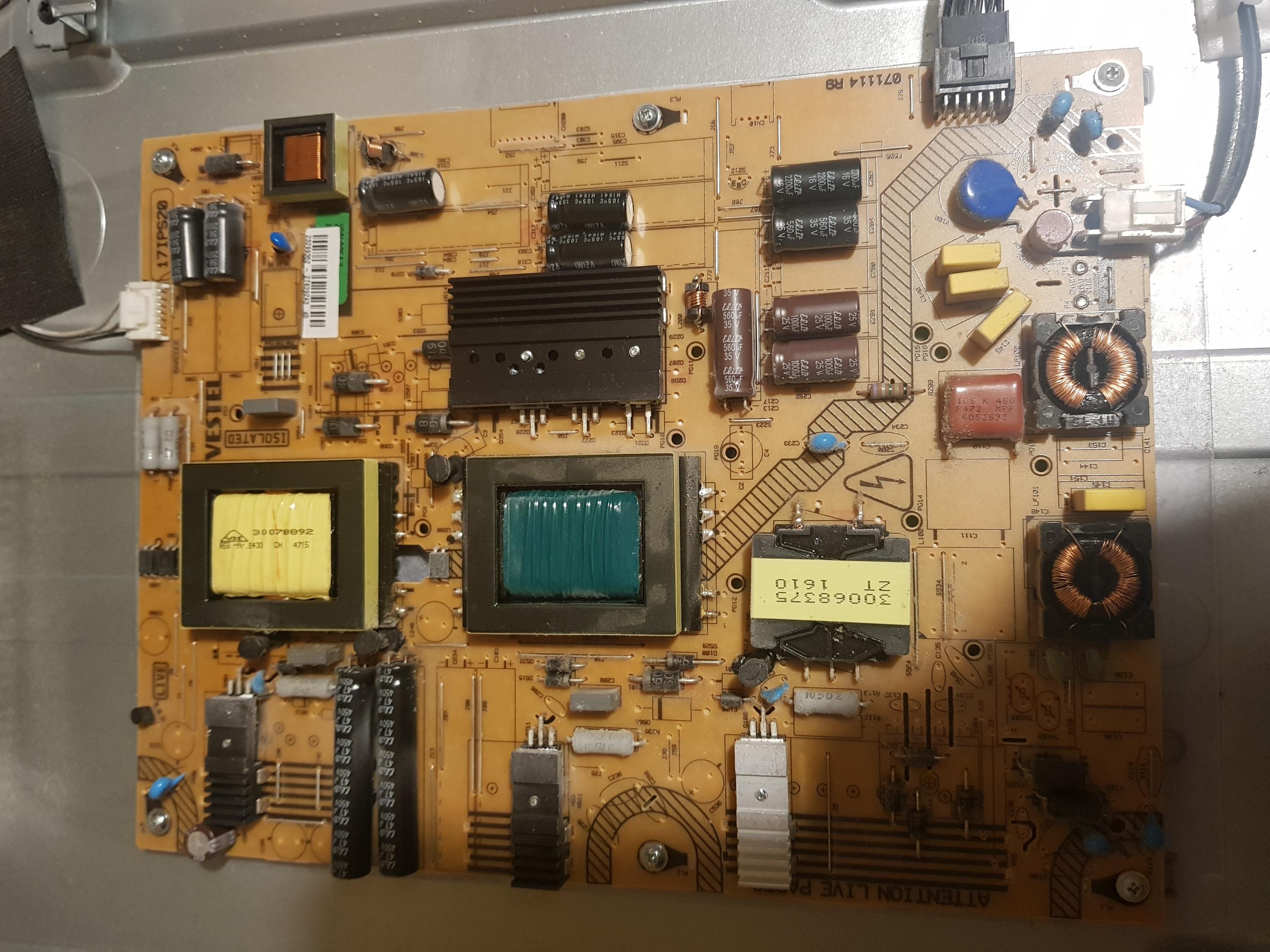

    Tested voltages 17ips20
    Low voltages for example 12v=11.4v

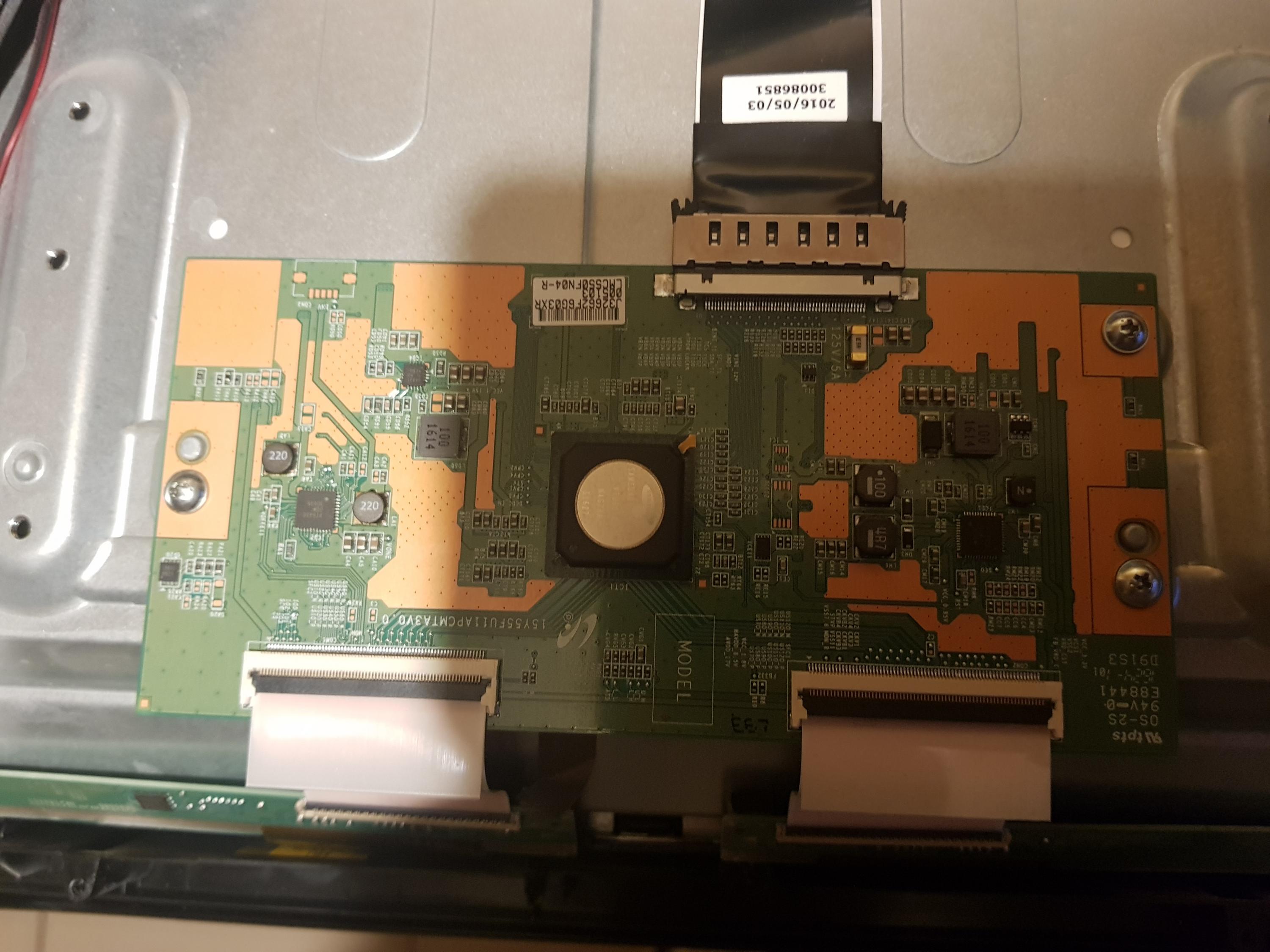

    Tcon board fuse is 11.4v I also disconnected one ribbon at a time but nothing shows on the screen so straight away thought it could have been possible tcon fault luckily had a spare but still the same

    Lest see the screen shots showing what it looks looks like on the screen, it sound likes Gate drive issue.

          Do you still get 11.4 with the panel unhooked from the tcon, both ribbons?

              11.4v even with both ribbon cables disconnected I decided to strip the screen apart to see if theres anything visibly wrong and noticed the majority of the backlights are giving of a blue light instead of a white glow so I'm gathering the backlights are faulty and this is what's pulling down the low voltages
              P.s I have tried the tcon ribbon tape trick with no luck what so ever
              • nomoresonys
                • Jan 2013
                • 12206
                • U.S.
                Re: HITACHI 55HK6T64U horizontal lines
                Yep need to replace all the backlights, then turn the backlight setting down as low as you can tolerate the display, some do a current mod with resistor/s, you likely saw all the posts here about blue backlights.
