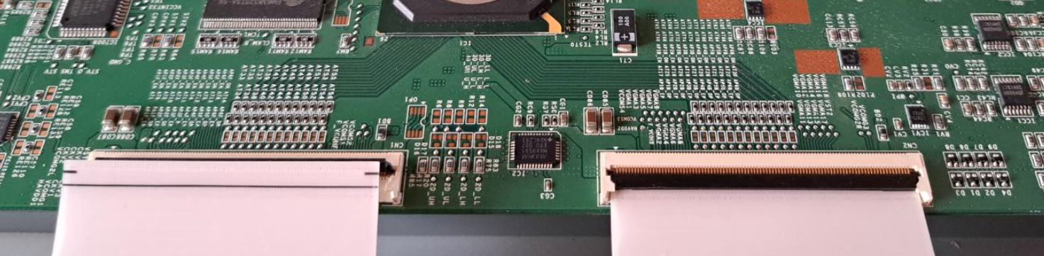

    T-con board
    Photos:
    https://ibb.co/Sn3h32J
    https://ibb.co/WPmY3wY

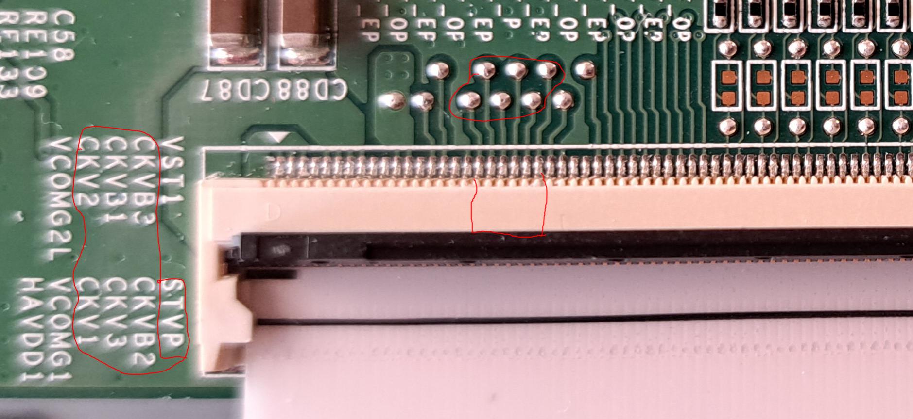

          • lotas
            • Jan 2016
            • 4708
            • Russia
            Re: Horizontal black lines on screen - please for your help
            Post a high quality photo of this area.
            • theo321
              • Jun 2023
              • 10
              • Greece
              Hi Lotas
              Thanks for your interest
              Are these clear enough ?

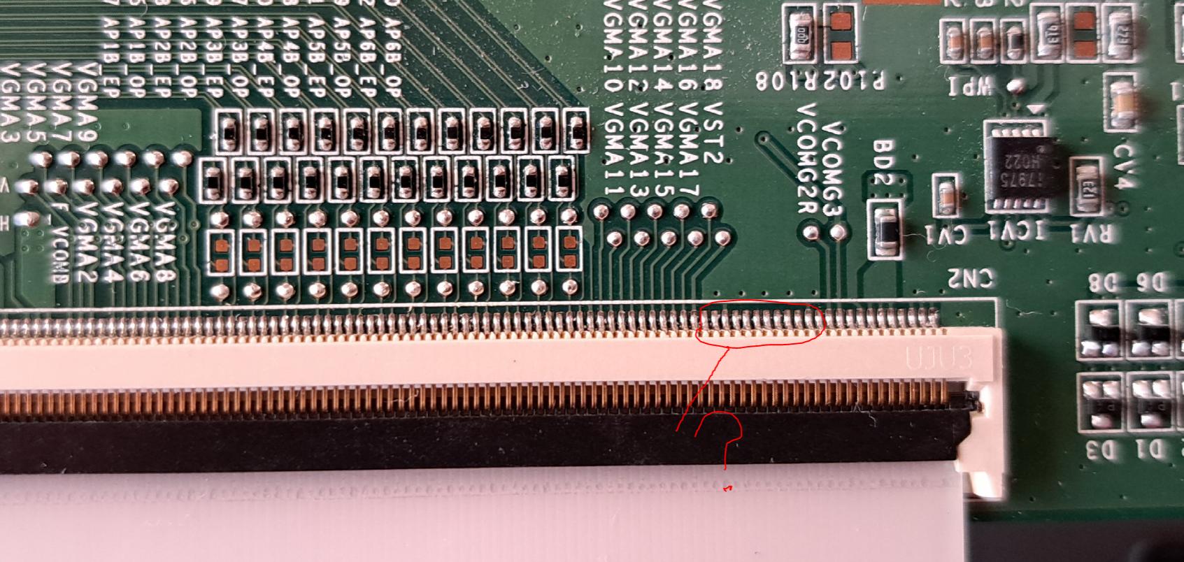

                  • lotas
                    • Jan 2016
                    • 4708
                    • Russia
                    Try to mask these contacts on the non-working side.

                      • theo321
                        • Jun 2023
                        • 10
                        • Greece
                        Hi Lotas,
                        I tried to mask these contacts you suggested me but with no results. Once I covered these contacts TV returned me black screen.
                        I tried to cover some other pins 6 by 6 without success.
                        Maybe I am wrong but I think that that the problem is caused by something else since once I unplug one by one the ribbon cable I dont take half clear picture. I take half picture with lines in one case and half picture black (& white) in the other.
