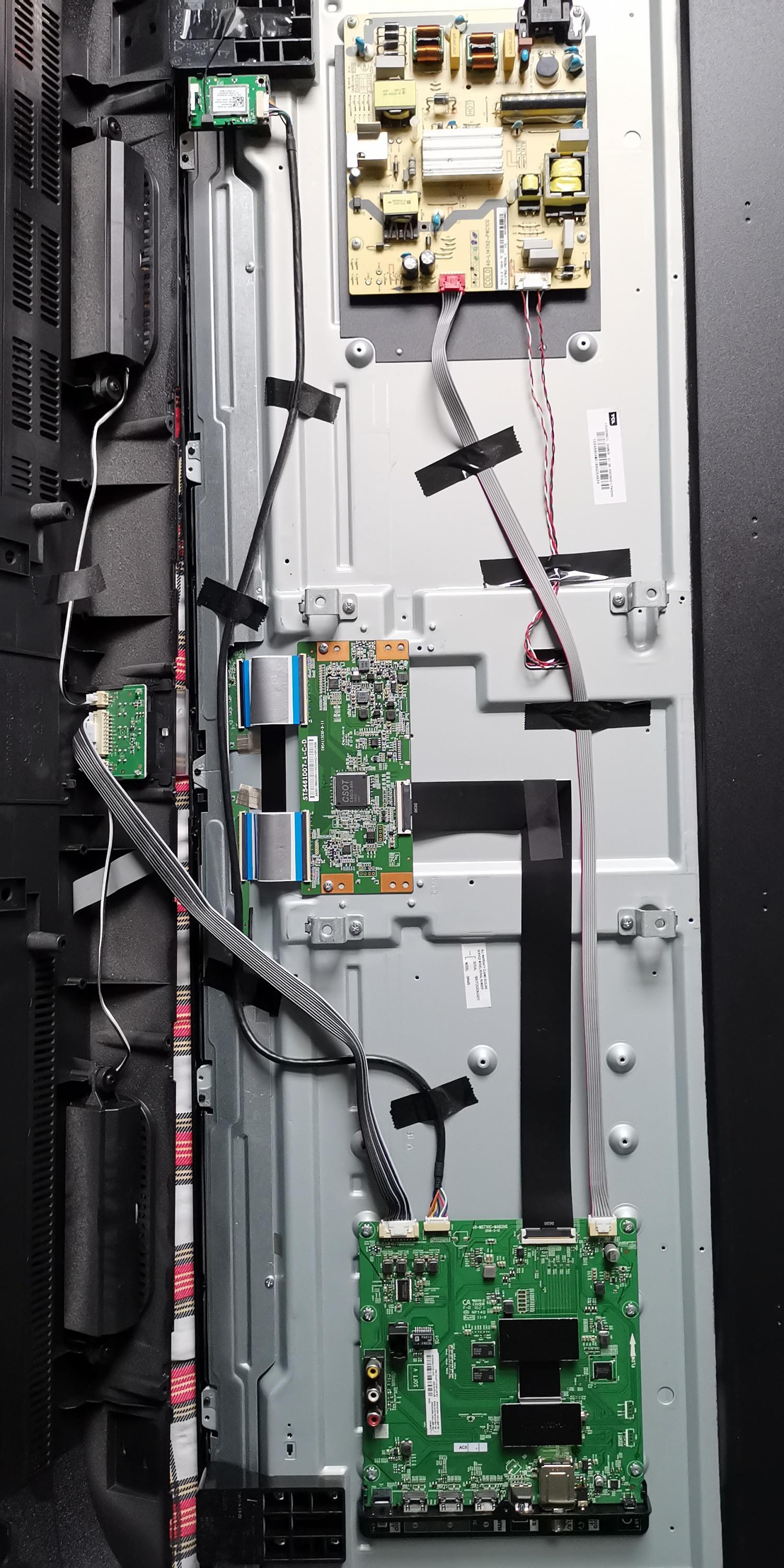

    Hi guys.. I got a tcl tv model 55S425 with no picture, no backlight and no sound. Do you think its an led or main board issue? What do you suggest I buy to fix it?

        Please attach good clear pictures of the whole backside of the TV using 'Go Advanced' so we can see all the boards.
        What Voltage testing have you done so far?

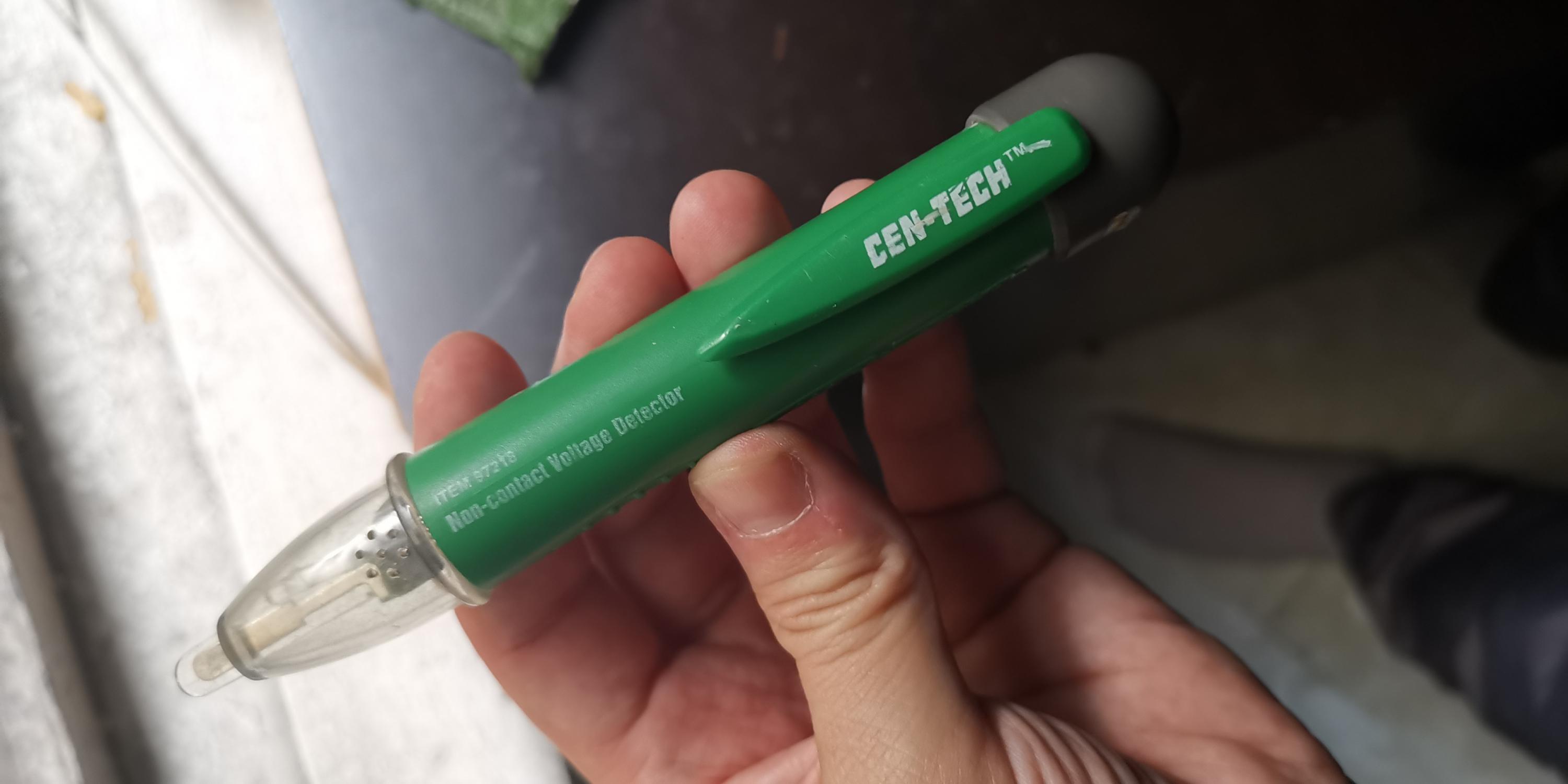

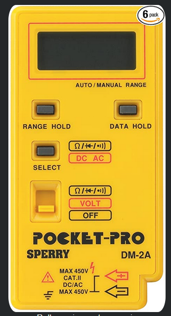

                        Hy bud.. ok so my super gave me his sperry mulitmeter. He also gave me a "pen" to check for other measurements. I assume the pen will be used to check the led strips. Let me know if both these devices will suffice and how to start fixing my tv.. thanks bud.
                          Re: TCL Model 55S425 - No Pic, No Backlight, No Sound - HELP!!!
                          That pen is for probing for active AC for electrician, not going to be use for trouble shooting the TV.
                          I hope you get the user manual for that meter, it looks like it is made for Electrician.
                          Please read the manual.
                          https://www.sperryinstruments.com/en...s-DM2A-Digital

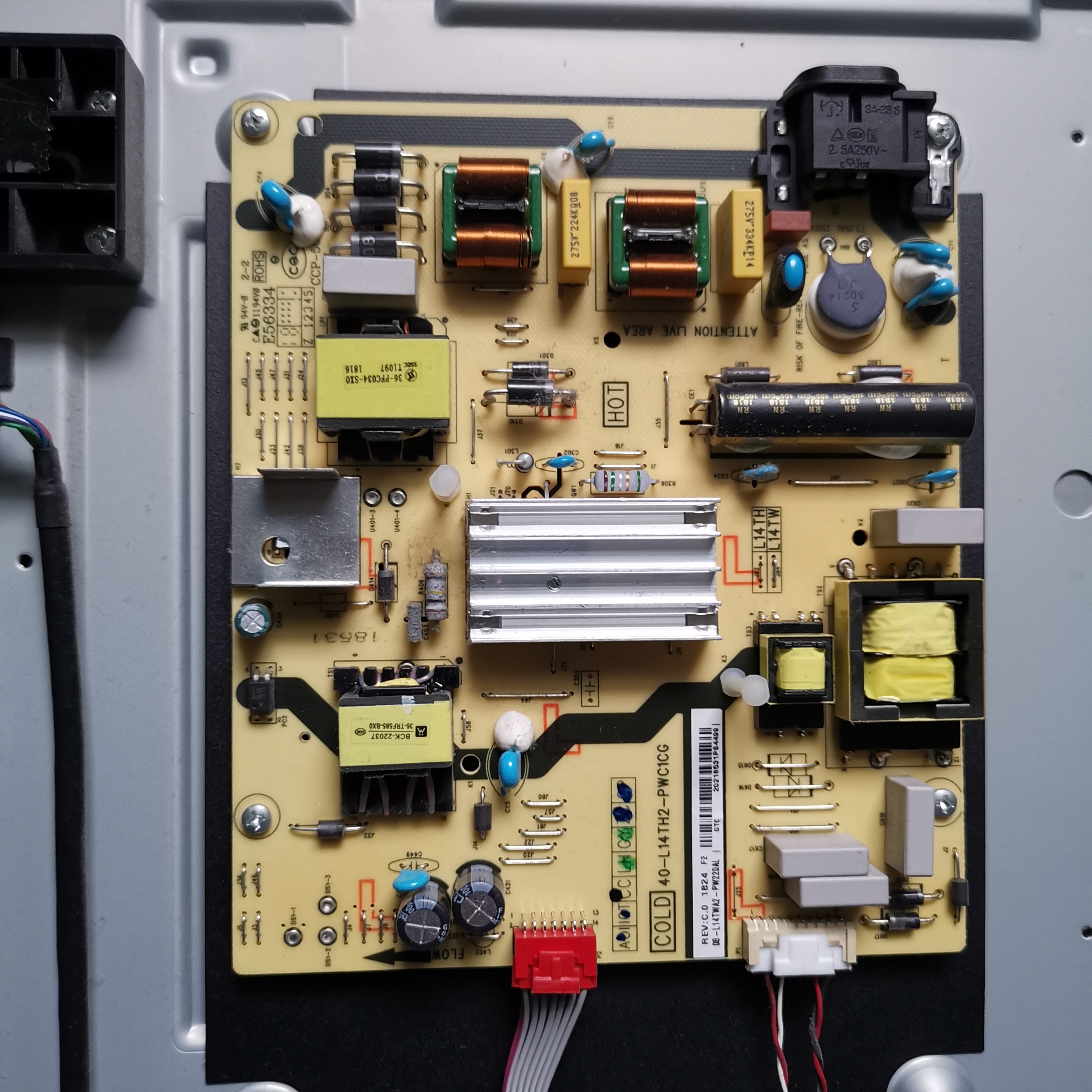

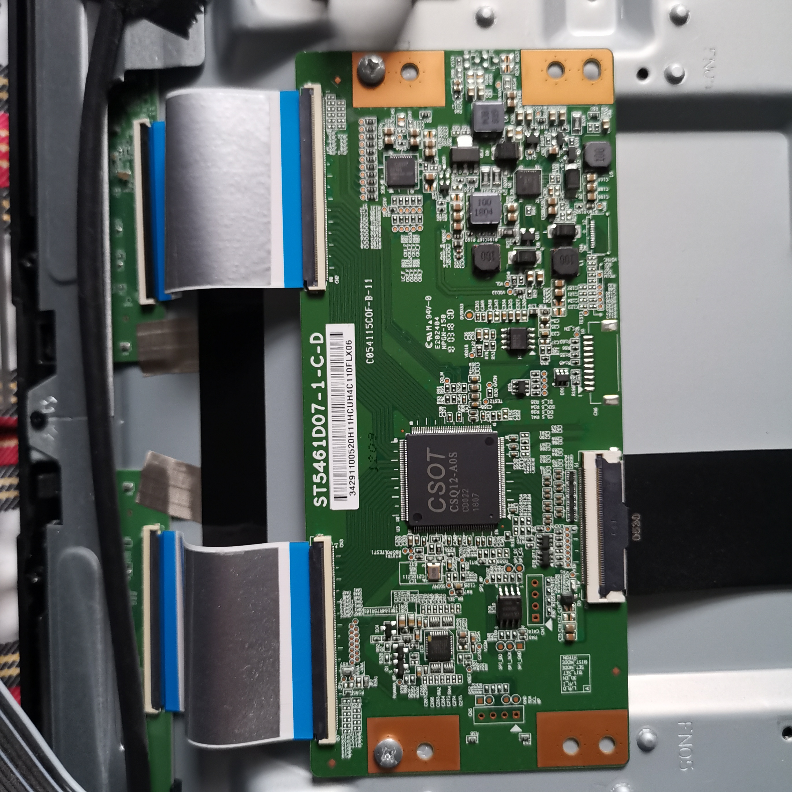

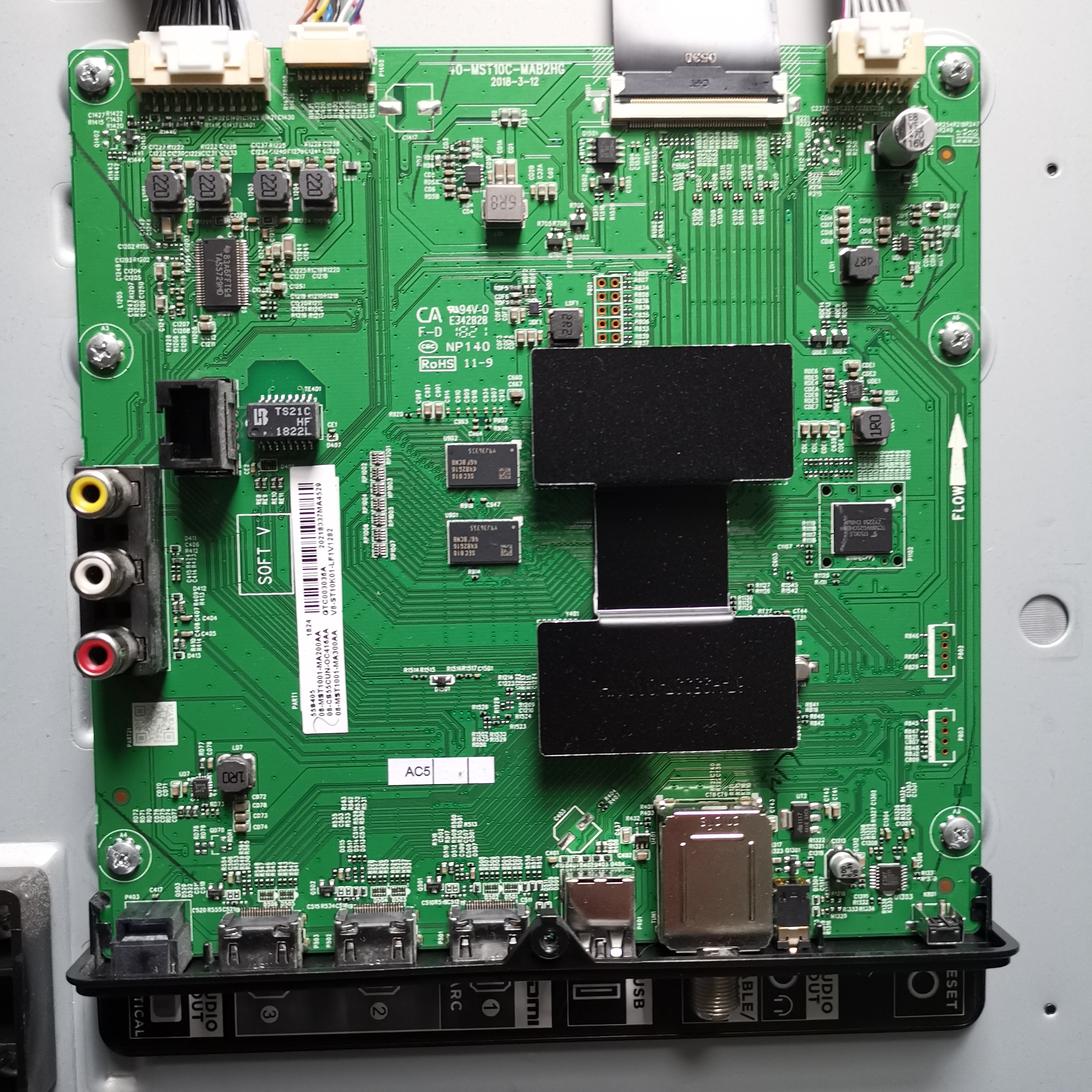

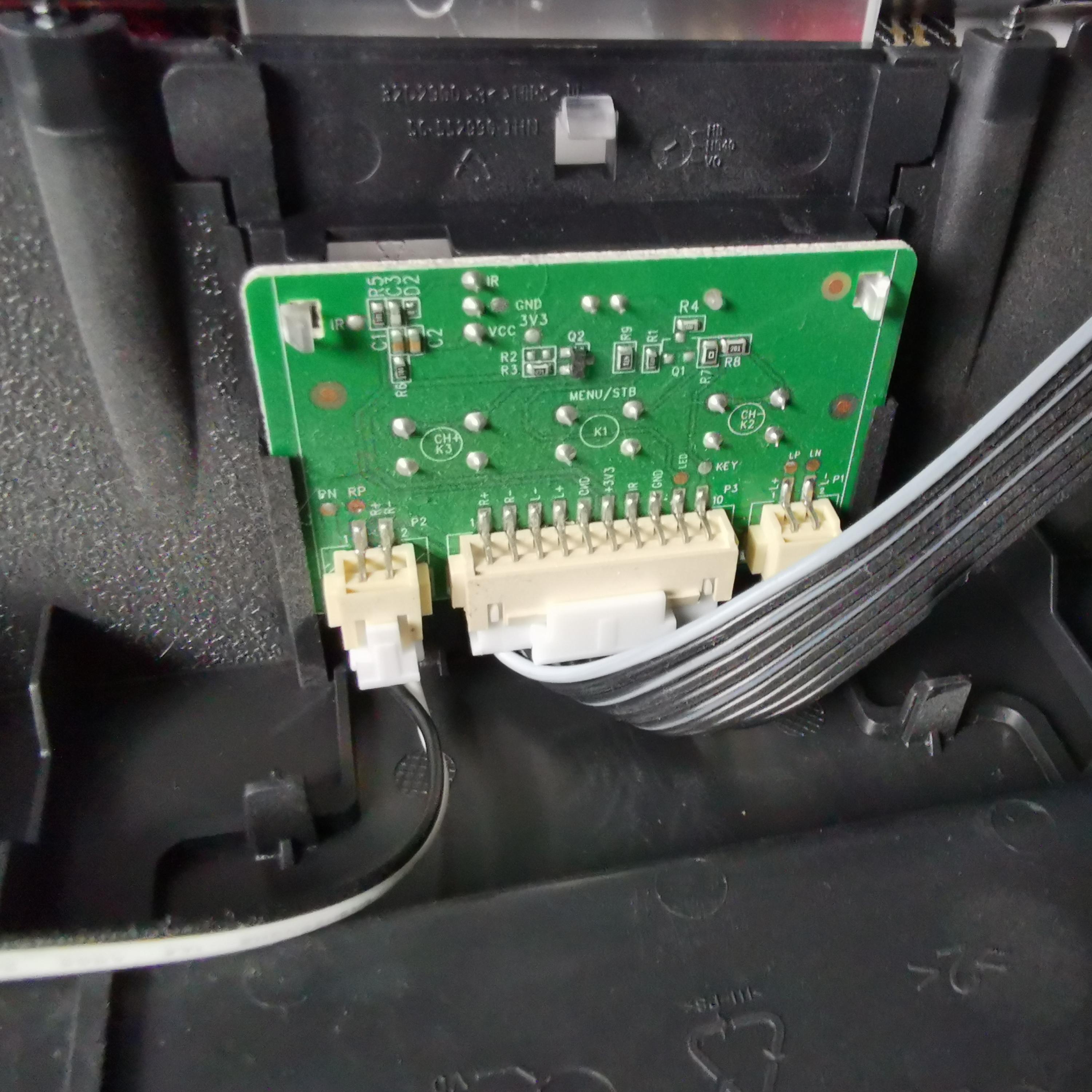

                              Below are the pics as you've requested...
                              ***CORRECTION*** My tv is TCL model 55S405. Sorry for the typo in my original post.. I'll change it!

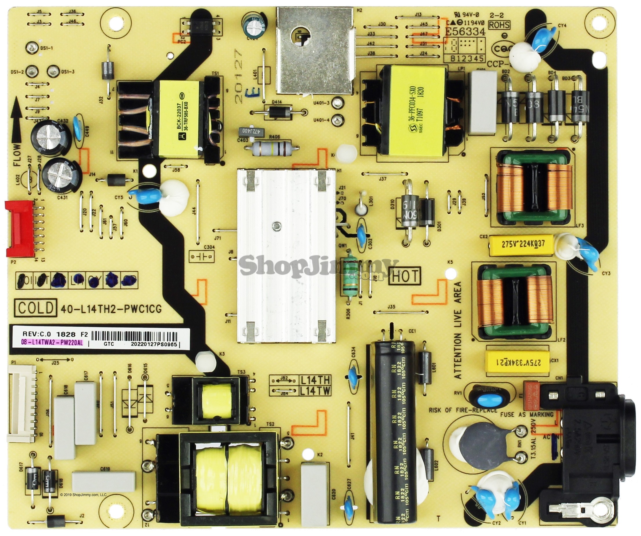

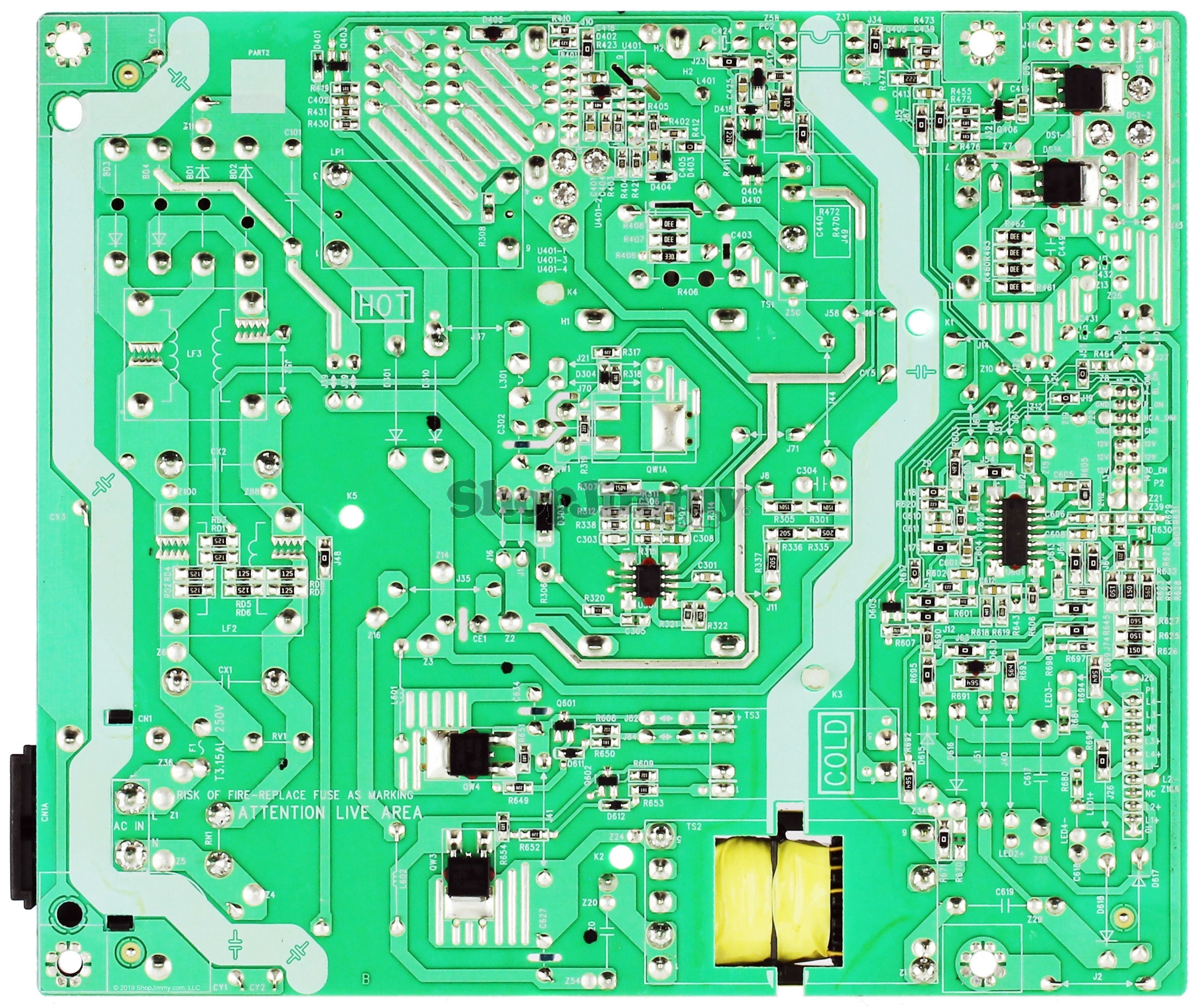

                                    Please verify the TV full model number.
                                    According to shopjimmy, the boards for the 55S425 do not show the power supply used in your TV, your power supply board is P/N 08-L14TWA2-PW220AL
                                    There are many versions of the same TV model.
                                    https://www.shopjimmy.com/tcl-08-l14...wer-supply.htm
                                    According to SJ, your power supply board is used in 49S405TDAA and 55S405LGAA.
                                      Originally posted by koolx
                                      Sure I'll have the super help me with that. But fyi I'm not sure you read the last part of my last reply. I edited it after posting it. Just wanted you to know that I made a typo in the title of my thread. The correct model of my unit is 55S405, NOT 55S425. I sent a note of this to the mod and hopefully he should correct it.
                                      I'll let you know when I'm ready for your instruction. Thanks bud!
                                      OK, these are the boards used in your TV model 55S405.
                                      https://www.shopjimmy.com/catalogsea.../?q=55S405LGAA

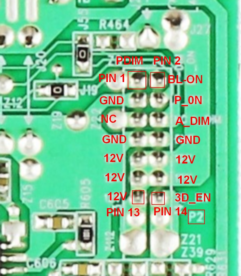

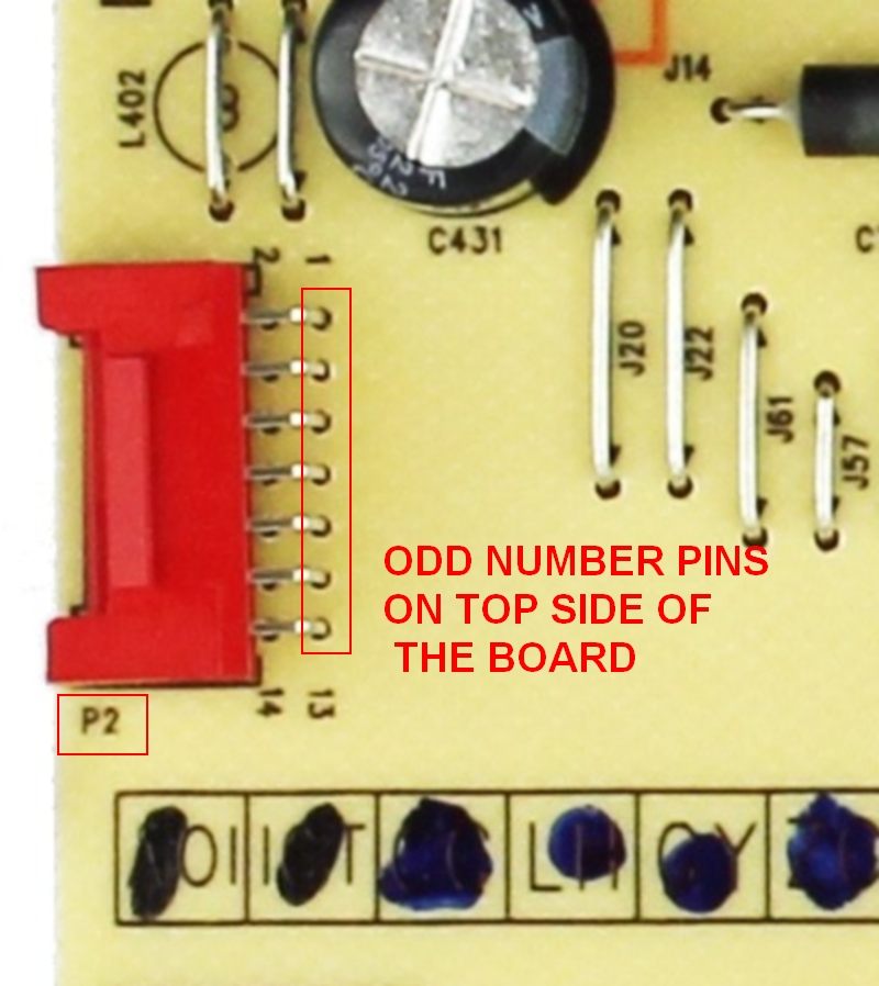

                                        OK, as you can see, Red connector P2 of the power supply board has pin names located on the bottom side of the board. The exposed pin on the top side of the board are ODD number pins that you can carefully check the Voltage of each pin easily, the EVEN number pins, you will need to use skinny probe to probe the pins from the wire entrance side side of the connect, all the Voltage testing has to be done with all connectors in place.
                                        Turn the TV on and then check the Voltage on each pin, Black probe of the meter connected to the metal chassis of the TV for meter ground reference:
                                        Report the reading as shown in the format below. Make sure to count the pin correctly.
                                        PIN 1: PDIM (PWM Dimming control) = xxx V
                                        PIN 2: BL-ON = xxx V
                                        PIN 3: GND = xxx V
                                        PIN 4: P-ON (PS-ON:mpower supply turn on control signal) = xxx V
                                        PIN 5: N.C. (NO CONNECTION)
                                        PIN 6: A_DIM (Analog Diming control) = xxx V
                                        PIN 7: GND = xxx V
                                        PIN 8: GND = xxx V
                                        PIN 9: 12VDC = xxx V
                                        PIN 10: 12VDC = xxx V
                                        PIN 11: 12VDC = xxx V
                                        PIN 12: 12VDC = xxx V
                                        PIN 13: 12VDC = xxx V
                                        PIN 14: 3D_EN (3D MODE Enable) = xxx V
                                        Pictures provided by shopjimmy.
