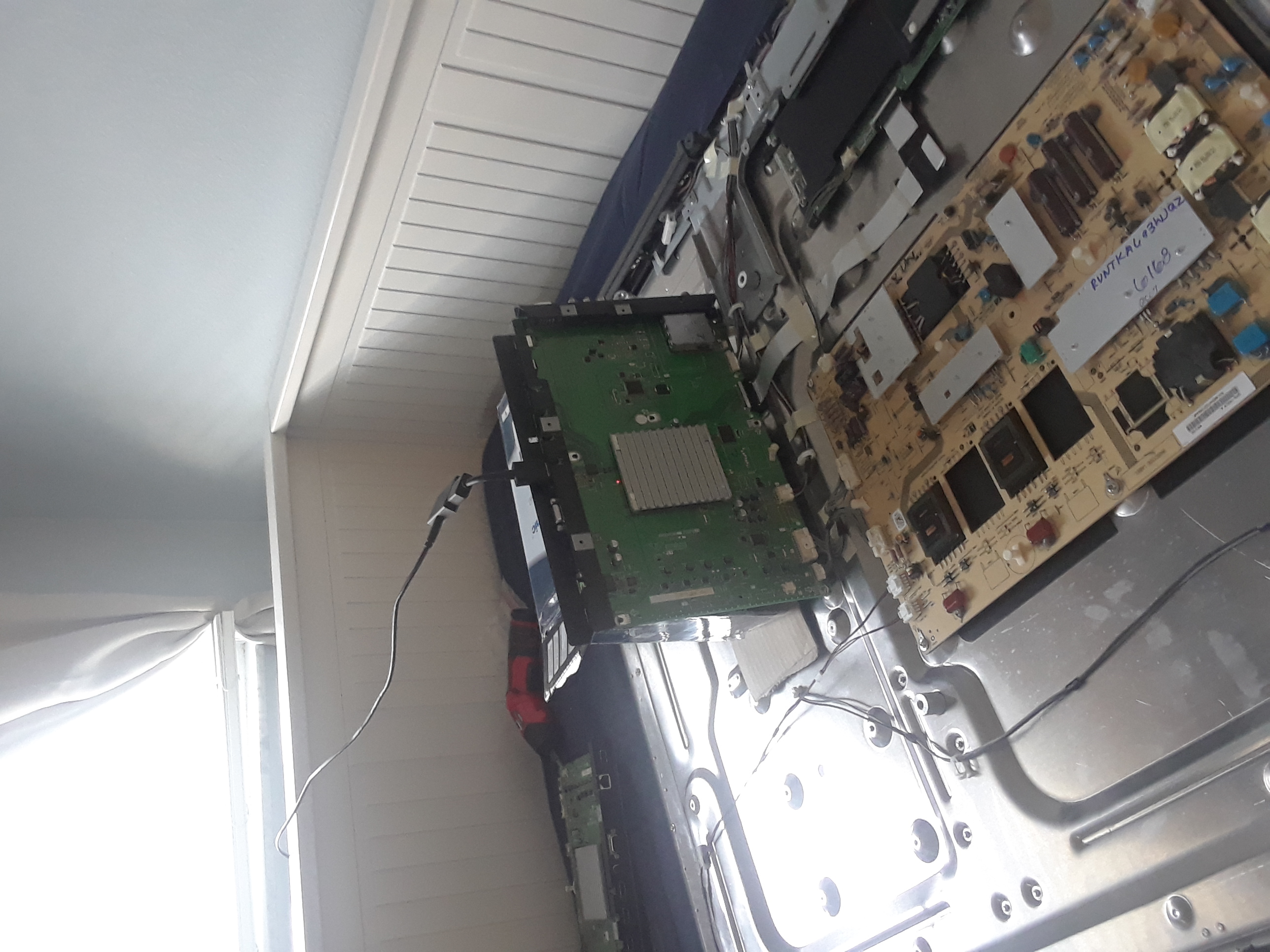

    If TV is upright TV runs for 14 minutes then turns off. At this point it tries to come back on every 5 seconds. At the 1 minute mark it came on for 14 minutes again and keeps repeating this process. When I place the TV face down with the back removed it runs fine. I've had the TV on this way for over 2 hours with no power cycling. Both the power supply and main board have been replaced. Any help please.

        Tightened all screws and checked all connections. As soon as I lift it upright it turned off within a minute. Unplug unit set TV face down and re plugged and it's working again.

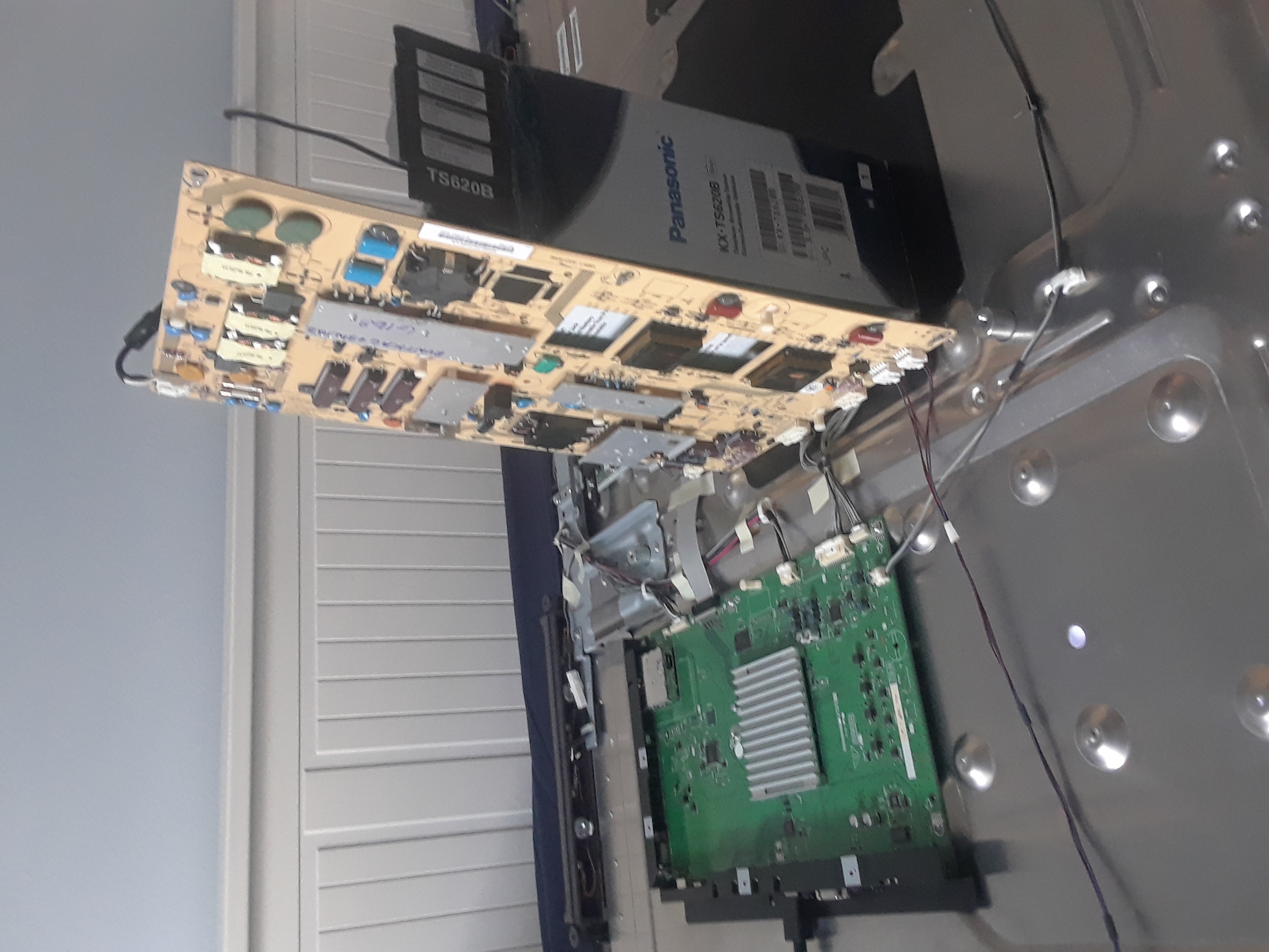

                          Not sure it's the power supply board as I had it standing upright while the TV laid face down. TV working fine for over 10 minutes now. Going to try the main board next.

                            Now have the main board in upright position for over 10 minutes with no glitch. Could it be the T-con board?

                              With the screen face down turn it on with mainboard unscrewed in upright pos. then bent it gently, if it stop working a reballing is needed, if its not the mainboard try the PSU. using gloves or better a wood spoon.

                                Re: Sharp Aquos Quattron LC-52LE810UN odd issue
                                Turn out that the power supply that I had gotten was bad. Replaced the power supply board and that fixed the problem.
