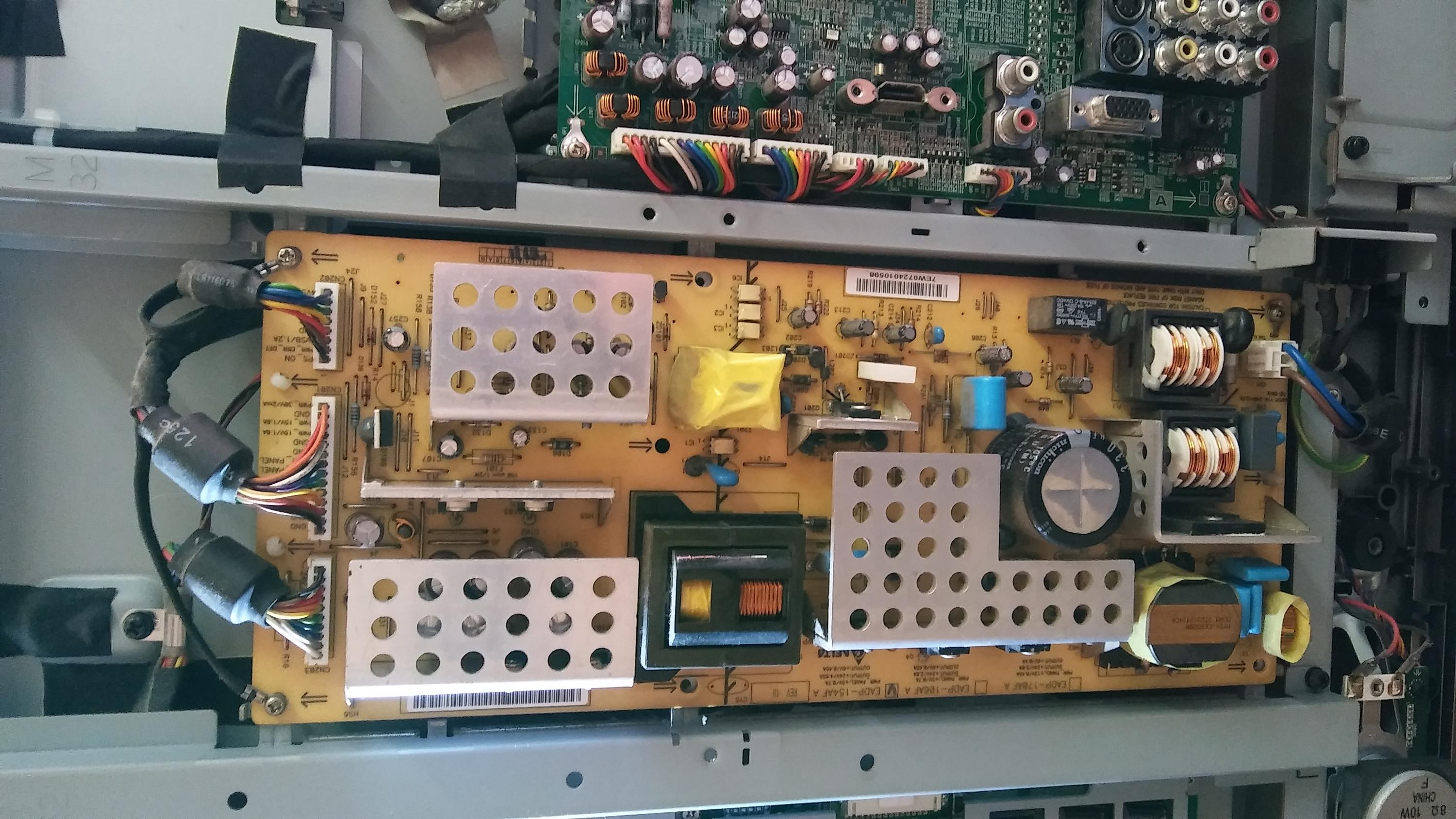

    Hi all i am battling with this issue and was doing voltage tests and came across a zener diode which has no voltage across it,it is 5v6B on the power supply,am wondering is somebody could help me in the right direction,i am still new at lcd tv repairs,i used to repair crt tv's,i will greatly appreciate any advice given

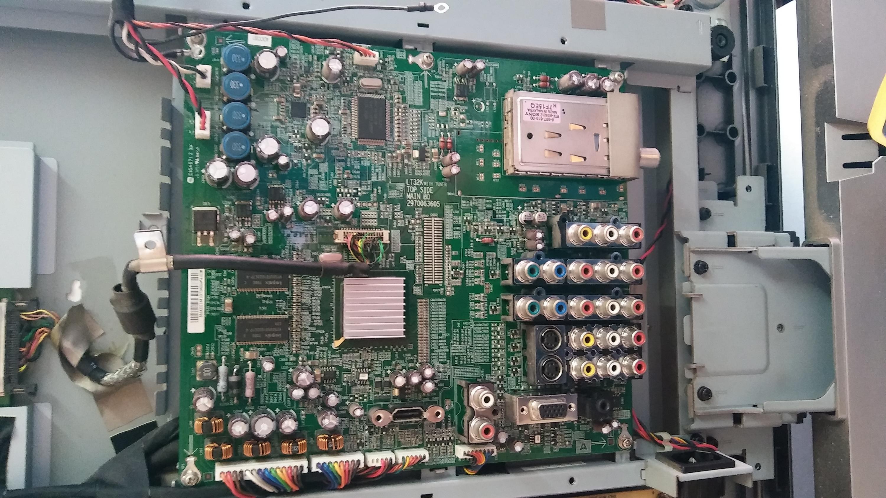

      We need good clear pictures of the backside of the TV showing all the boards, and pictures of each board so we can see what we are dealing with.
        Re: Sony KLV32U300A power on/off with 2 times blinking led
        ]214576
        ]214577

          What are the voltages you're seeing at the power supply connectors? List each pin description with the power on and off voltages.

                      So what Voltage are you getting at the three connectors on the cold side of the power supply when TV is plugged in but not turned on and when power switch is activated?
                      As you can see the pins are labeled with name for each pin so you must put down the connector pin name and follow by the Voltage reading for each pin so we can easily see whit it has and does not have.
                      What is the designator of the Zener diode in question?
                      I attached the schematic of ADP-154AF power supply for the 32"

                          Zener diode Zd 131 on schematic
                            That diode ZD131 is part of protection circuit that will shut down the power supply if it detects fault on +15, +24, and PWR_30 supply lines.
                            That Zener will not conduct until output of IC5 pin 7 goes high above 5.6V for the Zener to conduct which then will cause SCR151 to turn on and shutdown the power supply, you can look at the schematic to see how it works.
