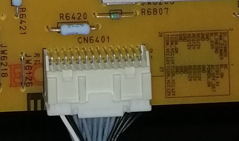

        Voltage, filter cap(yellow), 39v. and it immediately starts to drain away. C6524
        Testing 3.3v standby cathodes/diodes D6201 and D6201, both are 3.9v.
        Connector CN6401 pins
        1=0
        2=0
        3=0
        4=0
        5=0
        6=0
        7=12.7v
        8=12.7v
        9=12.7v
        10=0
        11=0
        12=0
        13=0
        14=0
        D6801-D6804
        Top =94v
        Bottom=4.7v
        Does this help any, and allow us to move forward any.

          You have made so many measurement errors and connector pinout counting.
          Below is my post #85:
          1) What DCV do you have on the main filter cap (yellow) C6524, measure right at the two legs of the cap?
          Be real careful since you are making measurement in the HOT DEADLY side of the circuit.
          2) You can also test the 3.3V standby Voltage by checking at the Cathodes of D6201 and chassis GND.
          3) Connector CN6401: You can test Voltages of the EVEN number pins on the top side of the board. the ODD number pin can be probed from the wire entrance side of the connector using skinny probe.
          My reply to this post:
          1) No way you can have only 39V on the main filter cap (yellow) C6524. If you measure it correctly right between the two legs of the cap, the Voltage reading should be around 330VDC.
          2) Your test result of Voltage testing at D6201 CATHODE: Testing 3.3v standby cathodes/diodes D6201 and D6201, both are 3.9v. It means 3.3v Standby power supply is working so no way you can have 0V on the CN6401 pin 5 (see CN6401 picture attached). BTW, you mean D6202 in your reply, D6201 and D6202 are connected in parallel.
          3) As I indicated in my post #85: Connector CN6401: You can test Voltages of the EVEN number pins on the top side of the board. the ODD number pin can be probed from the wire entrance side of the connector using skinny probe., and look at your report below:
          1=0
          2=0
          3=0
          4=0
          5=0
          6=0
          7=12.7v
          8=12.7v
          9=12.7v
          10=0
          11=0
          12=0
          13=0
          14=0
          From what I see, you did not count the pin correctly as instructed, the CN6401 has EVEN and ODD number pin assignment, and the pin chart printed next to it, also see my attached picture.
          As you can see, to measure all the ODD number pins, you need to use skinny probe to probe at the wire entrance side of the connector, the EVEN number pins you can access from the top side of board.
          You can see that ODD number pin
          Pin 1 = N.C.
          Pin 3 = BL_ON
          Pin 5 = STBY 3.3V
          Pin 7 = AC_OFF_DET
          Pin 9 = POWER_ON
          Pin 11 = GND
          Pin 13 = 12VDC
          Pin 15 = 12VDC
          Pin 17 = 12VDC
          Pin 19 = GND
          Pin 21 = GND
          Pin 23 = GND
          Pin 25 = TCON_VCC12V
          Pin 27 = TCON_VCC 12V
          For EVEN number pins, just look at the chart and see how pins are arranged.
          Basically you need to start it all over correctly. Bad DATA makes it impossible to do remote troubleshooting.
          You need to read and follow the instructions. Bottom line right now is that the Standby power supply is working fine, your meter may be inaccurate because you show 3.9V at the CATHODE of D6201 so I do not know how you come up with 0V on STBY_3.3V pin 5 of CN6401 connector.
          Are you sure you want to pursue troubleshooting this TV?

                            You mean D6201, D6202 Rectifier diodes for the STBY_3.3V.
                            Well, let me repeat about the pin names and pin numbers, they are printed right there on the board to tell you what each pin is for.
                            Your report:
                            1=0
                            2=0
                            3=0
                            4=0
                            5=0
                            6=0
                            7=12.7v
                            8=12.7v
                            9=12.7v
                            10=0
                            11=0
                            12=0
                            13=0
                            14=0
                            Well, as you can see per chart as printed on the board, pin 7, 8, 9 ARE NOT for 12V per pinout chart, your friend needs to look at chart, make the measurement, then write down pin number follow by pin name, and the Voltage reading for every single pin, he must look at the chart and understand how to read it and whet it means if he is experience in repairing electronics/electrical equipment.
                            Did you look at my picture of the CN6401 and see how each pin is named and labeled, then you will see why your report is not correct.
                            BTW, if your friend checks the resistance between Cathode of D6201 (STBY 3.3V rectifier) and pin 5 (STBY_3.3V) of CN6401, it should show continuity (very low Ohm) between the two points, he can also look at the bottom side of the board and see how the Cathode of D6201 is connected to pin 5 (STBY_3.3V) of CN6401.
                            Also regarding to the Voltage reading on the main filter on the hot side, if you did see 390Vdc, then that means the main board sends the POWER_ON signal to turn on the power supply, but then again you said that you get 0V on all the pins except 3 pins show 12V, so that is measurement error on the POWER_ON pin 9 for sure.
                            Your friend should also read Basic LCD TV troubleshooting to understand how typical TV functions.
                            We are at 113 threads now and still having problem getting readings on connector CN6401.

                                Latest data Readings
                                Signature:Seemingly hopeless tv fixer
                                  #116
                                  Re: Remove rear panel Sony Bravia KD-65X7500F
                                  Please fill in the pin name for each pin so we can easily see what each pin is for..so when we look at the chart we will know what is present and not present.
                                  • viewerau
                                    • May 2020
                                    • 305
                                    #117
                                    DATA ADDED
                                      #118
                                      So Standby power supply is OK.
                                      So main board is not sending the Dimming control signal, T-con ON signal.
                                      The problem is on the main board.
