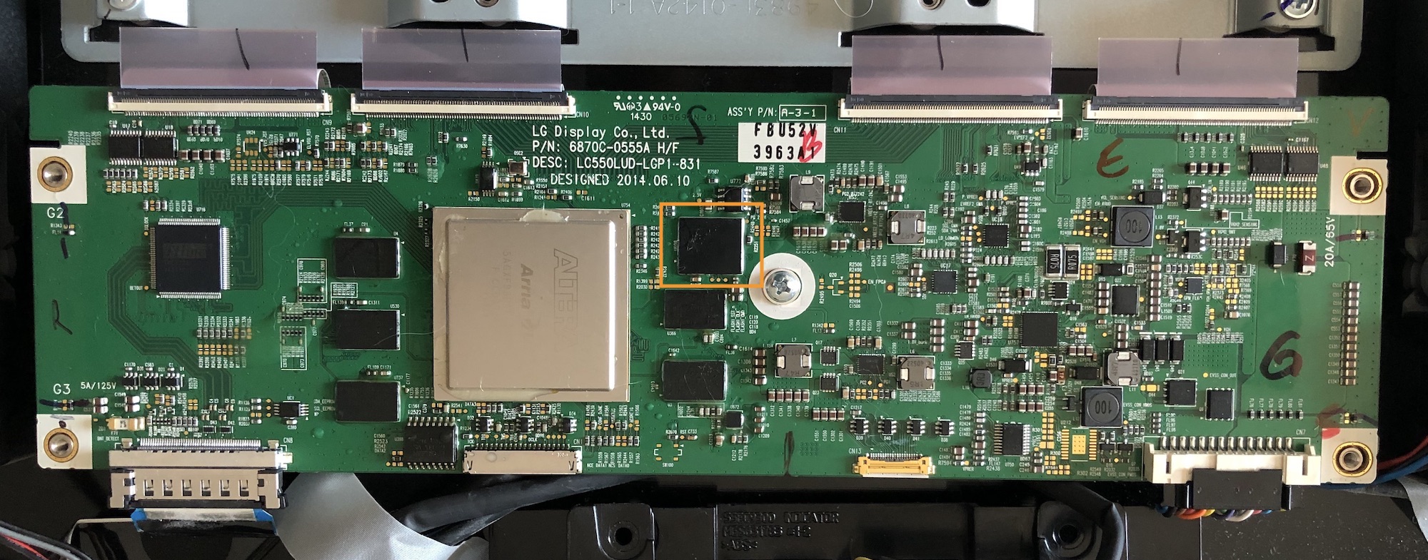

      Re: LG OLED 55EC930V Horizontal flashing lines problems
      Since after 3 compensation cycles (12h of viewing in total, checked the number inside IN_START) the panel still shows some vertical bands, though I see sort of improvement, I can't find how to force a deep pixel compensation on this model (please help if you know how) I also checked the service manual. It says to do VCOM adjust after replacing the T-COM (please see attached extract).
      So do you know what the VCOM is exactly? Is maybe a voltage measurement? Can do the VCOM be responsible of these vertical lines?
      PS: I'm sure is not a panel problem, it was without any banding before the original tcom failure.
      Thank you

          • maxino
            • Apr 2020
            • 31
            • Italy
            #45
            Yep, the banding is a known issue that is worse on the older OLED's, no fix for it.
            Thank you for your help. I found how to force the pixel compensation at every shutdown, just put 0 into IN_START/OLED/Compensation (instead of 4, means 4 hours)
            But after 6 compensation, no improvement, so yes, no fix for it, I'll try to do a reballing of the old TCON but I think the problem can be a FPGA silicon fault, so we'll see... Billys told me also his set have the same issue. Sure the TCON "is" the problem, sure you get something to watch at, but replacing it will never restore the set to it's max.
            PS: I had search a lot for the VCON adjustment but on this TV there's nothing like that, even if the service manual for this model says it, what I read in the top left corner of the spreadsheet is LCD TV, in my humble opinion is a mistake.

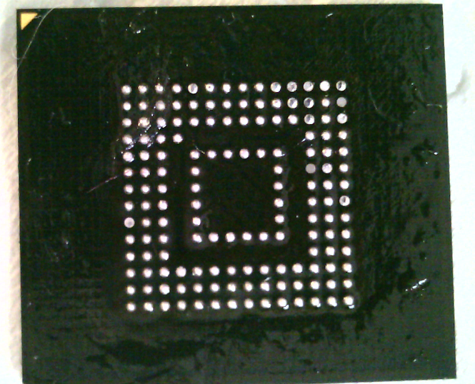

              #46
              Finally I found the damaged component. Is a Micron eMMC 8GB memory next to the FPGA named U698, (41A18 JWA07 NAND MTFC8GLDEA-1M WT) responsible of storing the basic OSD (volume control, source info, ecc..) and unfortunately, the screen factory calibration. Replacing it with an identical component of a donor board, works but the screen vertical lines remains. So no definitive fix for now.
              The only way that pass in my mind, is to read both the original and the donor board NANDs, find the location of the screen calibration by comparing the two, and then flash the new one with a custom merged ROM.
              If someone have some knowledge in this matter and want to help... thank you!

                • maxino
                  • Apr 2020
                  • 31
                  • Italy
                  #48
                  Originally posted by Diah
                  vertical bands appear only when ribbon cable swapped or T-CON driver boards or some time MB replaced.. this all happen of changing the resistances of ribbon gate. to bring them back only by calibration equipment, which are expensive more than new TV for private user.
                  Sorry but I have to desagree please see attachments on my previous post here:
                  https://www.badcaps.net/forum/showpo...3&postcount=37
                  these bands shows with a new TCON. When LG replaces an OLED panel, the kit came with a TCON altready installed on the panel, probably because the TCON is custom calibrated only with that OLED panel.
                  When I soldered the old TCON eMMC on the new one, the TV showed exactly the same behavior as I opened the topic, so it is clear the problem is the defective eMMC that stores the factory calibration. In fact, the lower bar, the only piece of image the TV shows with the new TCON with the old eMMC does not show any vertical band.

                        #51
                        Originally posted by Davi.p
                        What horrible technology, a screen control board that needs 8Gb of data... that's surprisingly ..
                        a screen then a 2000euro tv that needs to be replaced for an error on a memory on that board... engineers are going crazy...
                        how do you have sent In-Stop?
                        The problem is not much finding calibration data on a memory but reading that memory that needs to
                        posess a professional eprom reader.
                        Yes, horrible, they clearly pushed an early prototype tech to the masses just to be the first, otherwise why the TCON have an Altera(now Intel) programmable FPGA chip(!?) and a big eMMC memory like that? Clearly to compensate an un-optimized screens production line, where every screen came out with unique defects that have to be forcibly compensated by a custom by-zone calibration stored into an eMMC... almost unbelievable. Not counting the price payed for the set itself...
                        The IN-STOP was sent with a WAV to IR interface.
                        Now I'm thinking on buying a professional programmer, is around 150$, but read and write directly on the TCON will be better and since I'm sure this will not be a one shot try and solder-desolder the eMMC more than once will destroy the chip itself very soon. Unfortunately I'm not able to find the data connections by using a microscope, the board may be multi-layered and I don't know where to find the schematics. If someone have them, very welcome!
                        there are a lot of probe points, and more... there are two dedicated cable headers currently not used... see attachment
