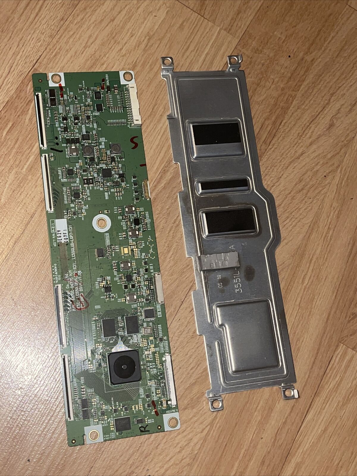

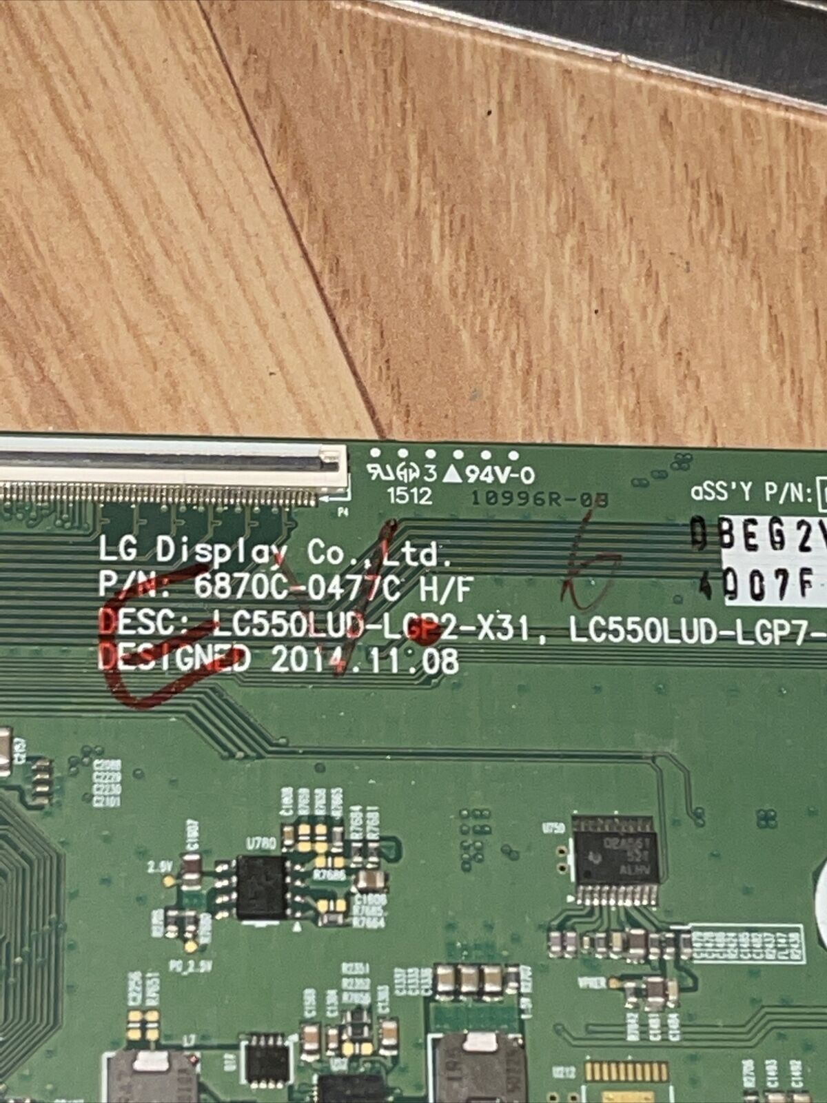

        unfortunately the original eMMC is readable, but data corrupted, so it's impossible to copy between them, I checked both with HEX editor, and the data is organized in a different way, so is not the memory itself, is memory controller that is addressing data in a wrong way, the original one data seems to be shifted up. Since I got the vertical bands too, I wanted to try the latest version of that TCON, see picture attached:
        new version
        6870C-0477C LG550LUD-LGP2-X31 DESIGNED 2014 NOV 8TH
        the one I have now is (OLD)
        6870C-0555A LC550LUD-LGP1-831 DESIGNED 2015 JUN 10TH
        I hope someone already tried this solution.
        Thank you!
