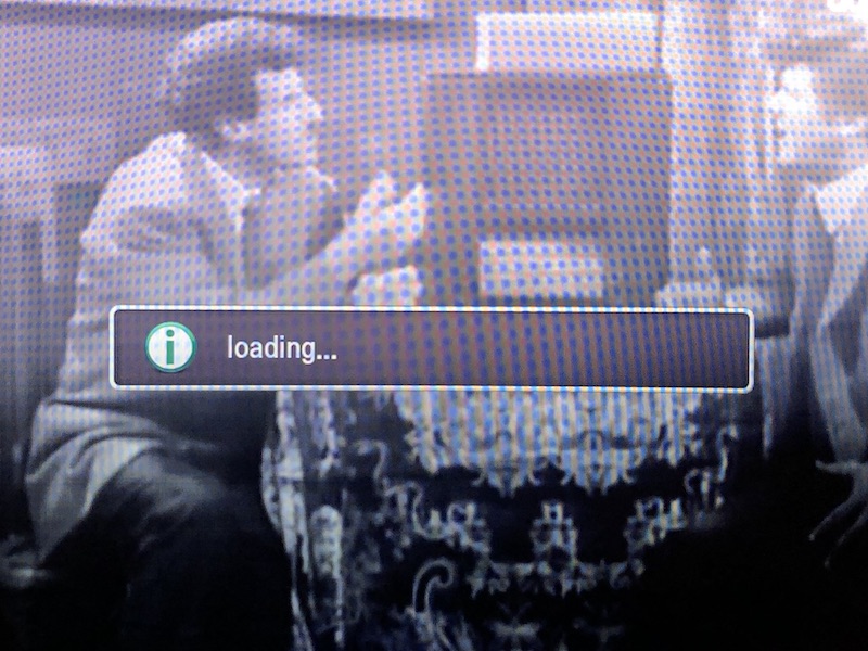

    So I tried to remove ribbon cables in this order:
    1 - the both on the left (turns on , white line on the left, growing-descending from the top of the screen for about 2 seconds, but also below the level normally the panel is not illuminated properly (!?!) The rest of the panel is faintly lit everywhere, then TV turns off by itself)
    2 - only the first ribbon, same as above, but the growing white line take all the screen width, 2 sec, then turns off.
    3 - only the second ribbon same as 2
    4 - only the third ribbon same as 2-3
    After that it can't be able to turn on the set anymore, so I pressed the reset button on the Main board, the TV works as before, the air mouse pointer moves. So no improvement for now
    VIDEO
    https://youtu.be/_XyHyBkK8vY
    At this point I just ordered a new TCON board on ebay, but I'm almost convinced it's a Main Board problem.
    I just remember I disconnected a Raspberry Pi 3 before the problem appeared, without turning off the set... can be the disconnection of the RPi caused some components burning on the Main Board?
    Thank you for your help.

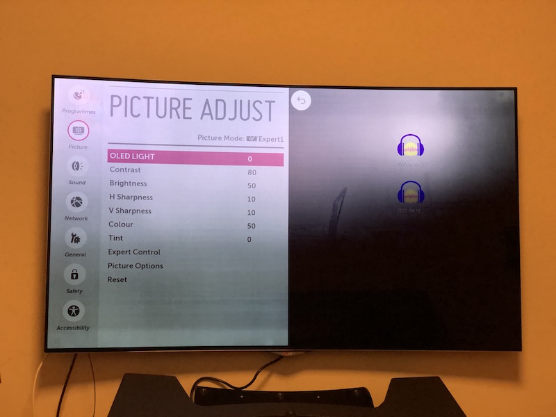

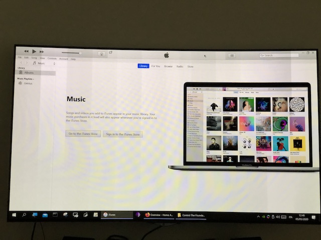

              Good news and unfortunately bad news, today I replaced the TCON board with a refurbished one, the picture now is almost everywhere lit at high "OLED light" settings (Standard value is 60), but at normal viewing light (set 10-30) the screen shows a very strange behaviour! In the upper left corner, I see something strange, an "a" that in my opinion is a part of a TV emblem. The rest of the image especially at the bottom is faded out a lot.
              Just to clarify, this TV was never used with TV sources, only for BD movies and streaming service like Netflix, so TV emblems are really unlikely to be there...
              Correct me if I'm wrong, it seems the used TCON is retaining the picture of the old TV from where it was taken. Is that possible?!?
              Please kindly see the pictures below, I already did a factory reset and then a IN_STOP to reset the TV, but with no change.
              Thank you!

                I have yet to come across an OLED but won't that clear itself up after a few power cycles ? I remember freakafter8 had something similar happen to an OLED he was working on and the problem vanished without him doing anything iirc.
                • maxino

                  Unfortunately, the TCON did not refresh by itself, but as per LG website, the screen do a pixel compensation every 4 hours of use (when then you put the set in Stand by). BTW, I have another issue here, it seems the firmware have something wrong, I never saw a volume indicator like this one, also the loading screens are very strange (see pictures) is there any way to force a firmware update? The set is connected to the internet but it does not show any available update (current FW 5.05.70), so part of the firmware is stored inside the TCON!?!?

                    05.05.70 are the last version of this set firmware.
                    T-CON ram saved part of panel driver and refresh rate, this will be reset at IN-STOP and you did it already.
                    as mmartel wrote. this behavior could be corrected by time or via build in pixel scan at setting.
                    it help too to use build in player to play movies.. or test jpg pictures with one color, also play YouTube on the set.

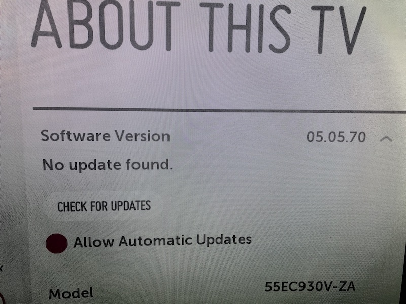

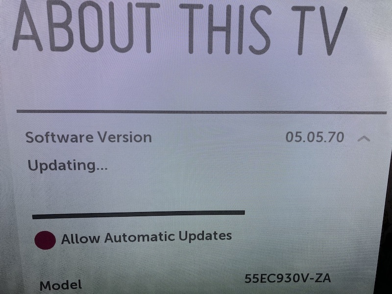

                                Tried to downgrade the FW with LGDTVUPDATER but it doesn't work, please look at the attached pictures.
                                Original Content From: https://www.lgwebos.com/topic/1997-h...ware-tutorial/
                                Now I'll try with the tool NSU Emu by SMX
                                https://github.com/openlgtv/nsu_emu
                                NETFLIX doesn't work, it seems the HDCP chain is not working properly

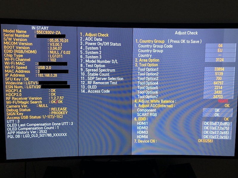

                                  post photos on first page of service menu IN_START and E-Z Adjust

                                    So thank you for your patience, after 4 hours of random viewing, the TV did the pixel compensation as you described, the picture is finally better than before, some persistent vertical lines are there, almost same behavior as Billsy here https://www.badcaps.net/forum/showpo...4&postcount=53
                                    BTW, emblems almost vanished, no solarization and no color banding so I'm already happier than before
                                    Pictures Below (please note the moiré effect does not come from the TV)
                                    So have I to wait for a second compensation, so it will eventually make the image even better?
                                    Please also find IN_START and EZ_ADJUST pictures below.
                                    The Firmware problem still remains, but at least the TV is "usable", I'll try to reflash the same firmware next days.

                                      yep it look good.. as its just did compensation 1, when the count come high it will clear it more.. the effect as billsy caused by removing the ribbon cable. it will disappear later..
                                      i would say dont touched it any more or doing any to the firmware.. always if you want to refresh the firmware and clear TEMP of using.. IN_STOP always the only answer.

                                          Just a small update, I solved the NETFLIX won't to play anything because an "the content cannot be played right now" error. What I suppose to be an HDCP chain inconsistency, and I was right.
                                          What I found, the TCON replacement (called MICOM in the IN_START menu) has an old firmware version, precisely the V3.00.1. This firmware is supposed to show and give a basic interactive interface in the meantime the real firmware boots into main board.
                                          I notice after replacing the TCOM, the boot menus was "old style" (see some post above), and I recall I show this when I bought the TV first time in 2014. For eg. when you press the "smart/home" button on the remote, the message "the smart menu will be available shortly", well this message comes from the TCON not from the Main board.
                                          In order to force the TCON firmware upgrade, you have to do an "Online" downgrade to FW V3.23.6 with a fake DNS called LGDTVupdater from our great Russian friends (running on windows)
                                          The good thing is that the FW code itself comes from LG directly, you don't need the FW code, just a "hook" file.
                                          After that, doing an IN_STOP will reset all the settings to factory defaults, at this point is enough to configure the WIFI / LAN, and let the TV do the updates by itself.
                                          Magically the MICOM firmware will also be updated to the V3.00.7 and the HDCP chain restored. So enjoy NETFLIX again!
                                          This is not an easy way to solve the issue. If someone will be really interested eventually, I could write a more in deep details guide. Let me know.
