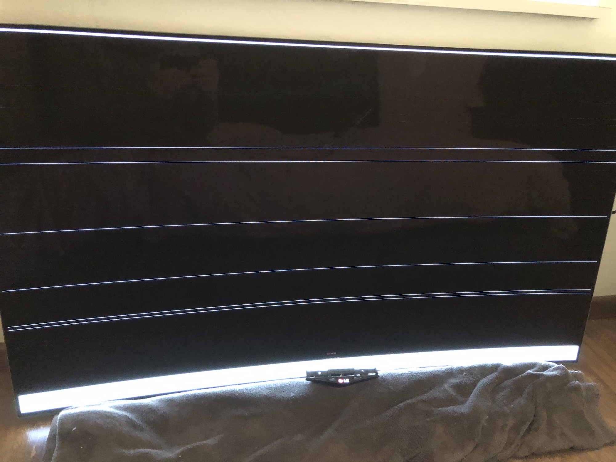

    I have a LG OLED 55EC930V, that worked perfectly hanged on the wall for more than 5 years, now, after a initial screen dim for 30 seconds, I cycled power it, and now I have this strange problem that was filmed on this short youtube video.
    https://youtu.be/vgF_kTjzEe8
    Since the TV in background works, it respond to the remote normally, audio works, and after reading similar posts on this forum I understand it can be the TCON board (please help me to understand if it is a defective panel instead) I found two part numbers for this TV, one, the oldest version (6/2014) have a FPGA chip, the second one (11/2014) seems to have a custom chip instead.

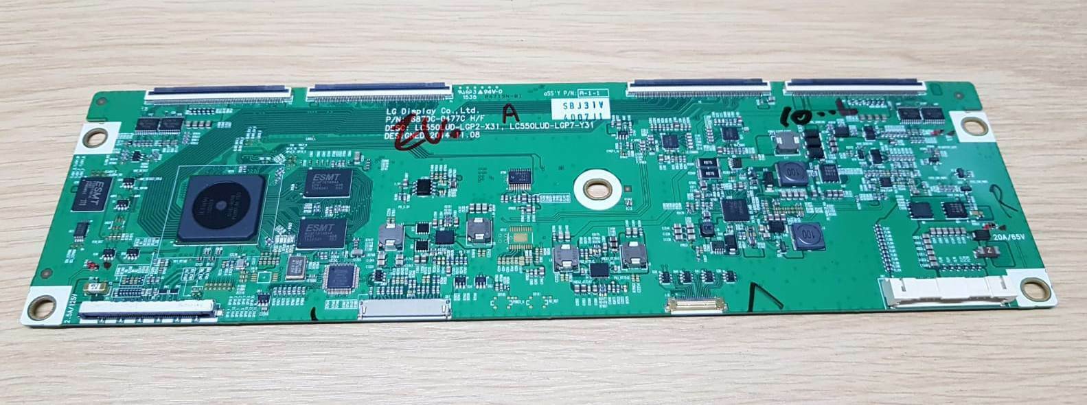

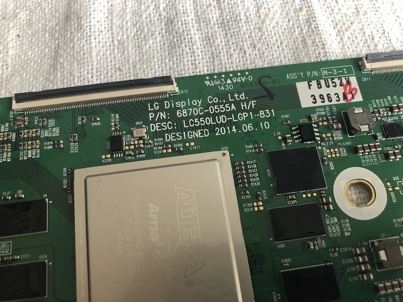

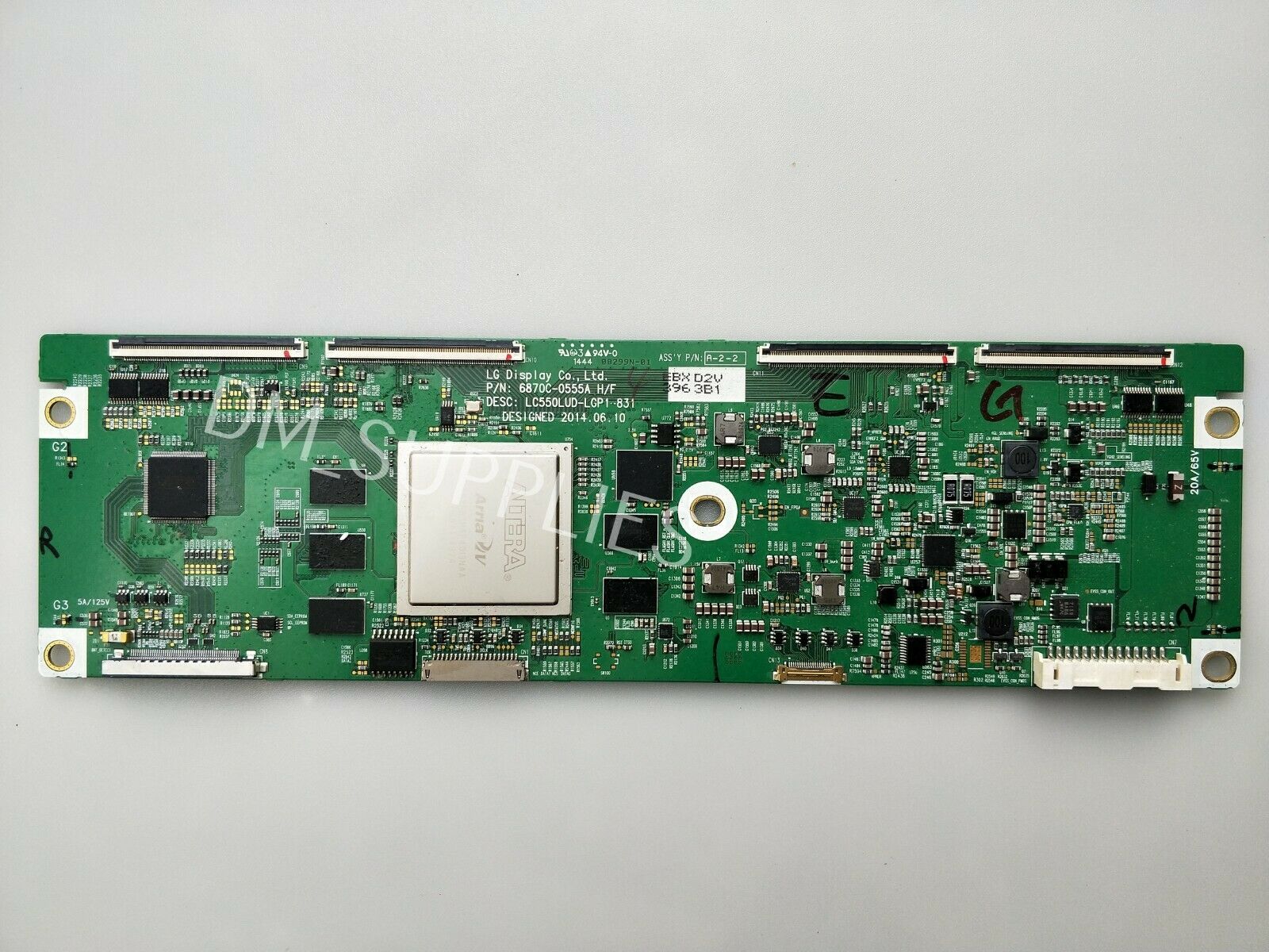

    Original part number: 6870C-0555A
    Possible improved (?) compatible part number: 6870C-0477C
    With your kind help, I just want to understand:
    - If behavior in the video is a panel issue
    - If the problem caused, can be addressed by replacing the TCON, and if the "improved" TCON can be a better solution if compatible. (less heat)
    Thank you very much for your time and your help!
    1. "improved" replacement found on ebay
    2. same model replacement fount on ebay
    3. original part
    4. back sticker

                                  this thread might be somewhat "equivalent" if you look at his last picture of what the panel is doing... almost the same kind of "linings" but in reverse video (ie. white background). Poster indicates a shorted panel. :-(

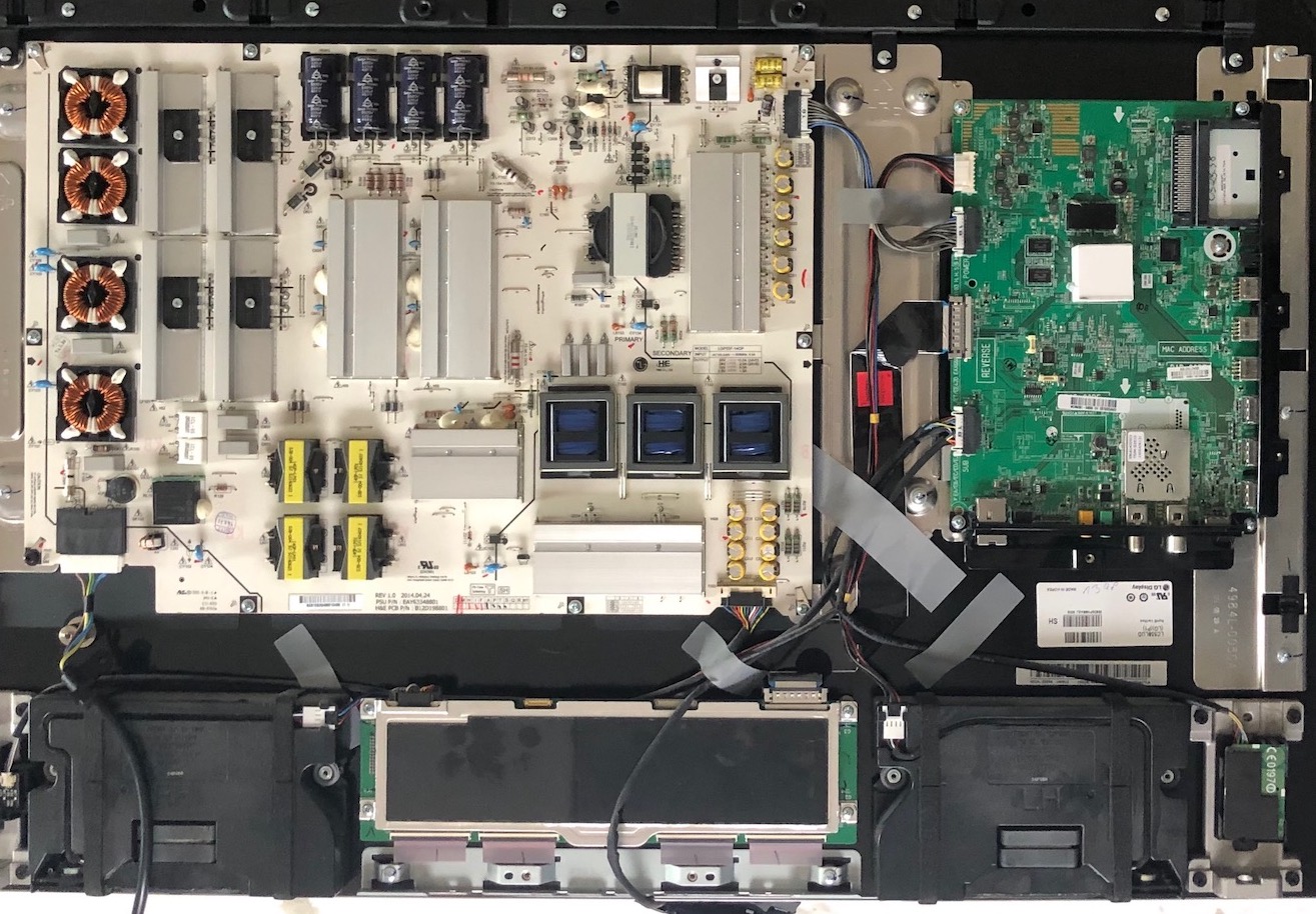

                                    Maybe try the disconnect one or two ribbon cables from the tcon to panel test, one side at a time and see if you get half a proper display(always disconnect and reconnect cables with tv unplugged from power)

                                        Re: LG OLED 55EC930V Horizontal flashing lines problems
                                        you mean this one?
                                        https://www.badcaps.net/forum/showth...hlight=lg+oled
                                        - since the last pictures in my opinion is not a picture of the panel, I glimpse something at the bottom like a metal frame
                                        - moreover, the lines are moving fast on my set, and they are part of the current picture, so strange behavior
