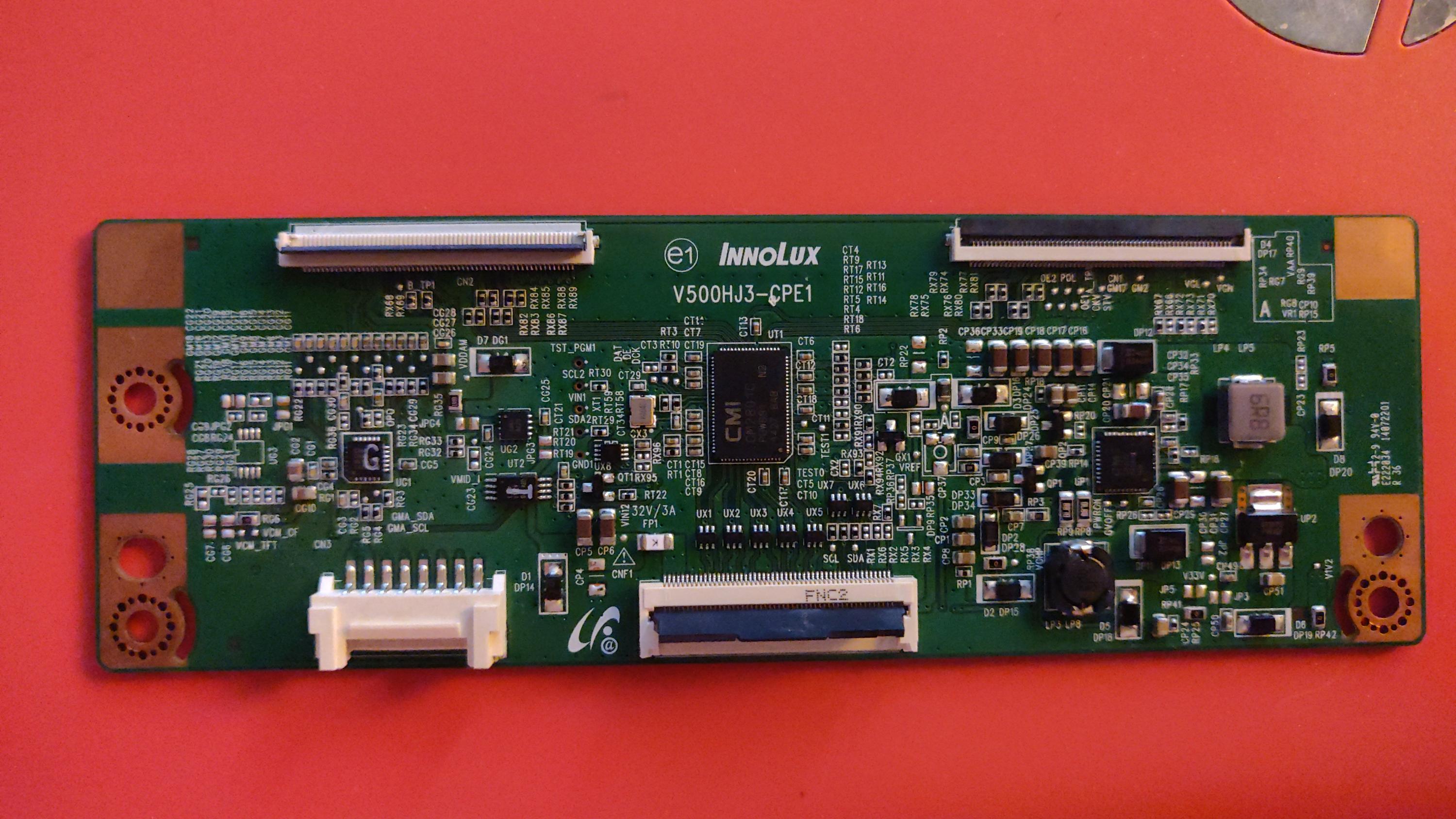

    Picture of tv is washed out, but all features are working and visable. There may be a slight blur to the text, but not sure that's just a result of the washed out effect, or a sign of something more, as i ordered a t-con board replacement from shop Jimmy and got the exact same results.
    From what I've gleaned from the web, this issue is usually due to a bad cmi ic chip on the tcon, so either I got a bad board from shop Jimmy with the exact same issue or there is another possible cause of this issue that im missing.
    Any guidance is appreciated.

              Can we see a decent photo of the tcon?
              • mnaty
                • Feb 2017
                • 11
                Re: Sony un50h5500 washed out image
                Here ya go.
                • nomoresonys
                  • Jan 2013
                  • 12116
                  • U.S.

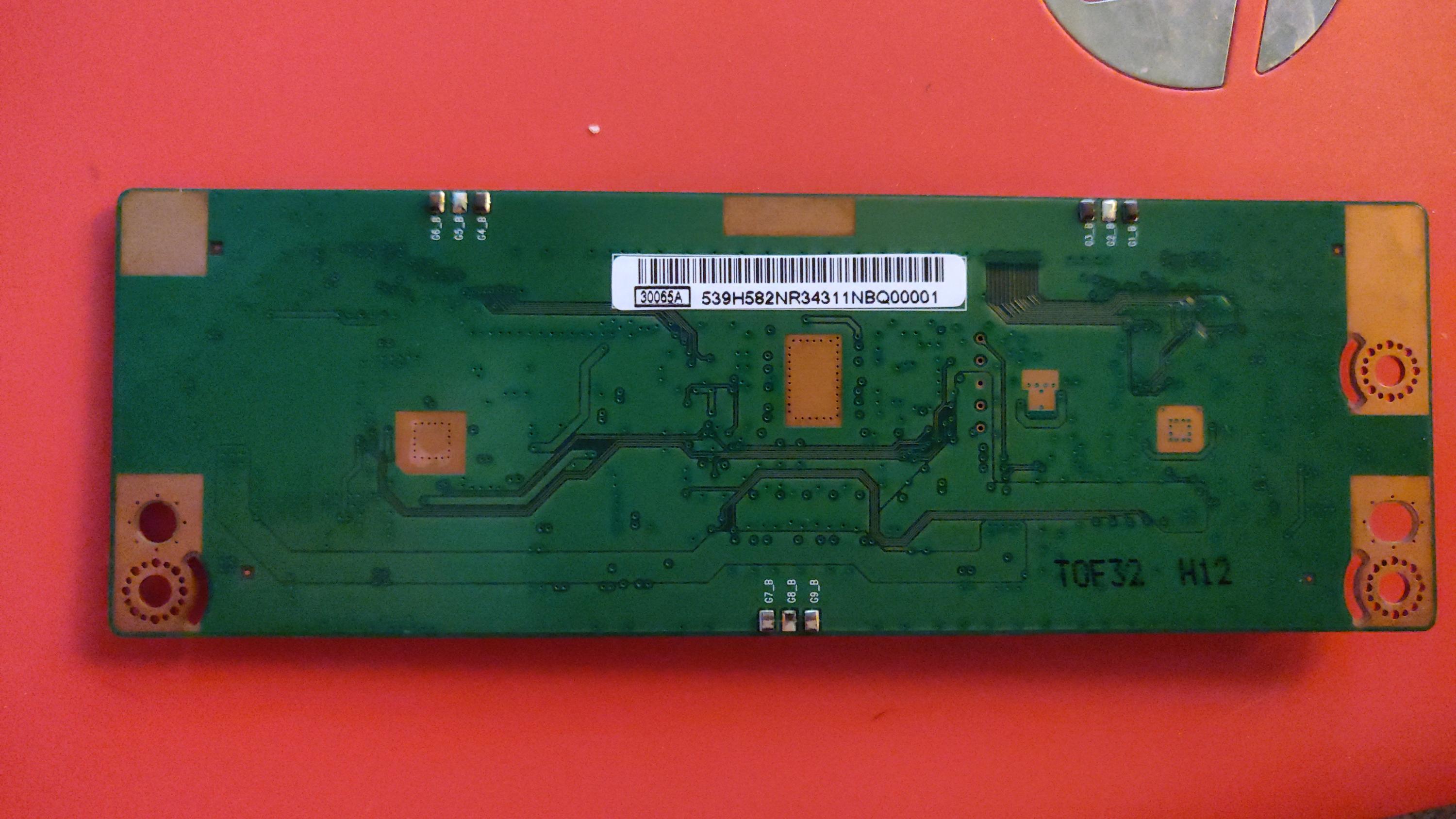

                  Sticker numbers don't match, wonder if maybe it's not compatible?

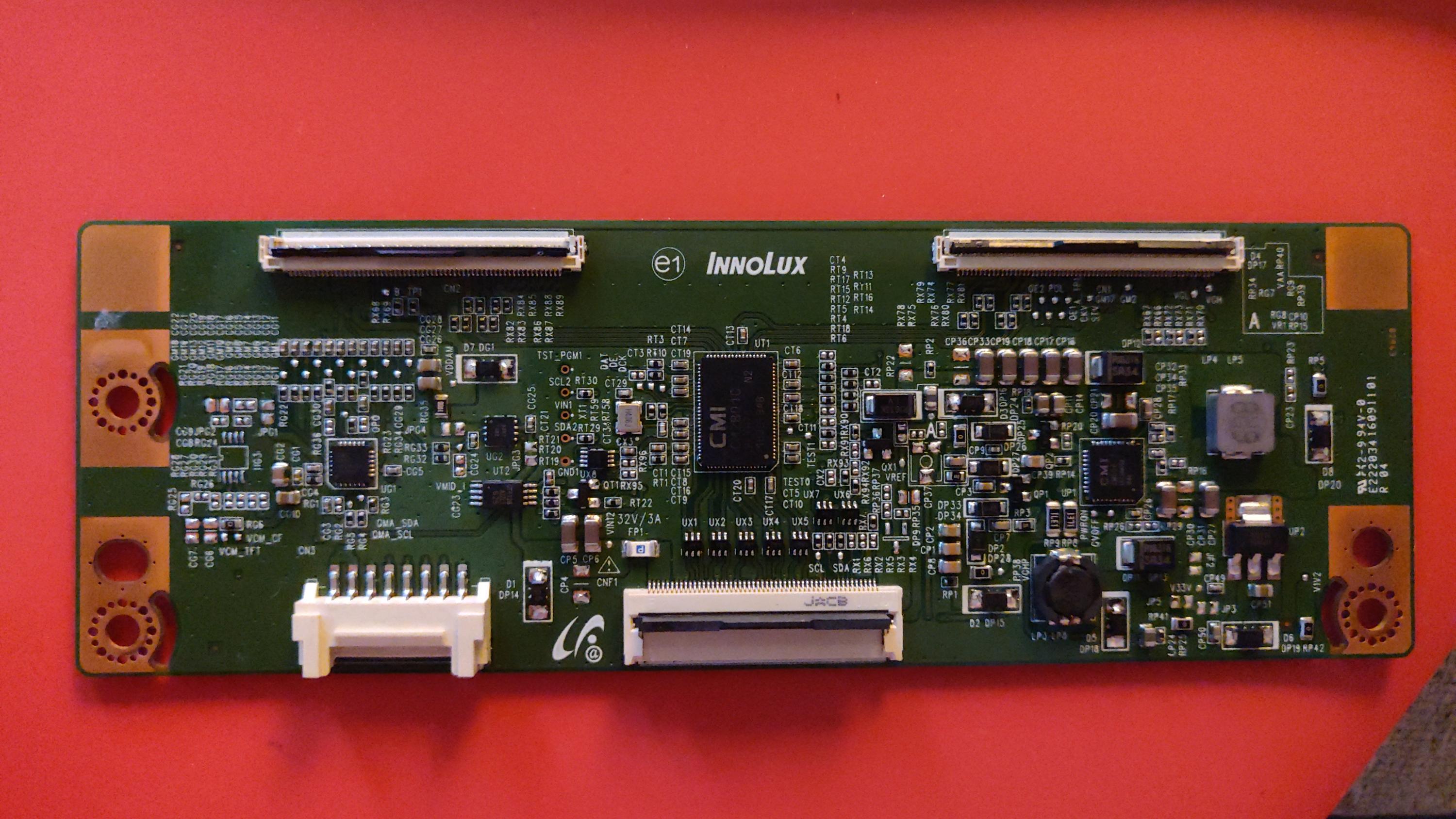

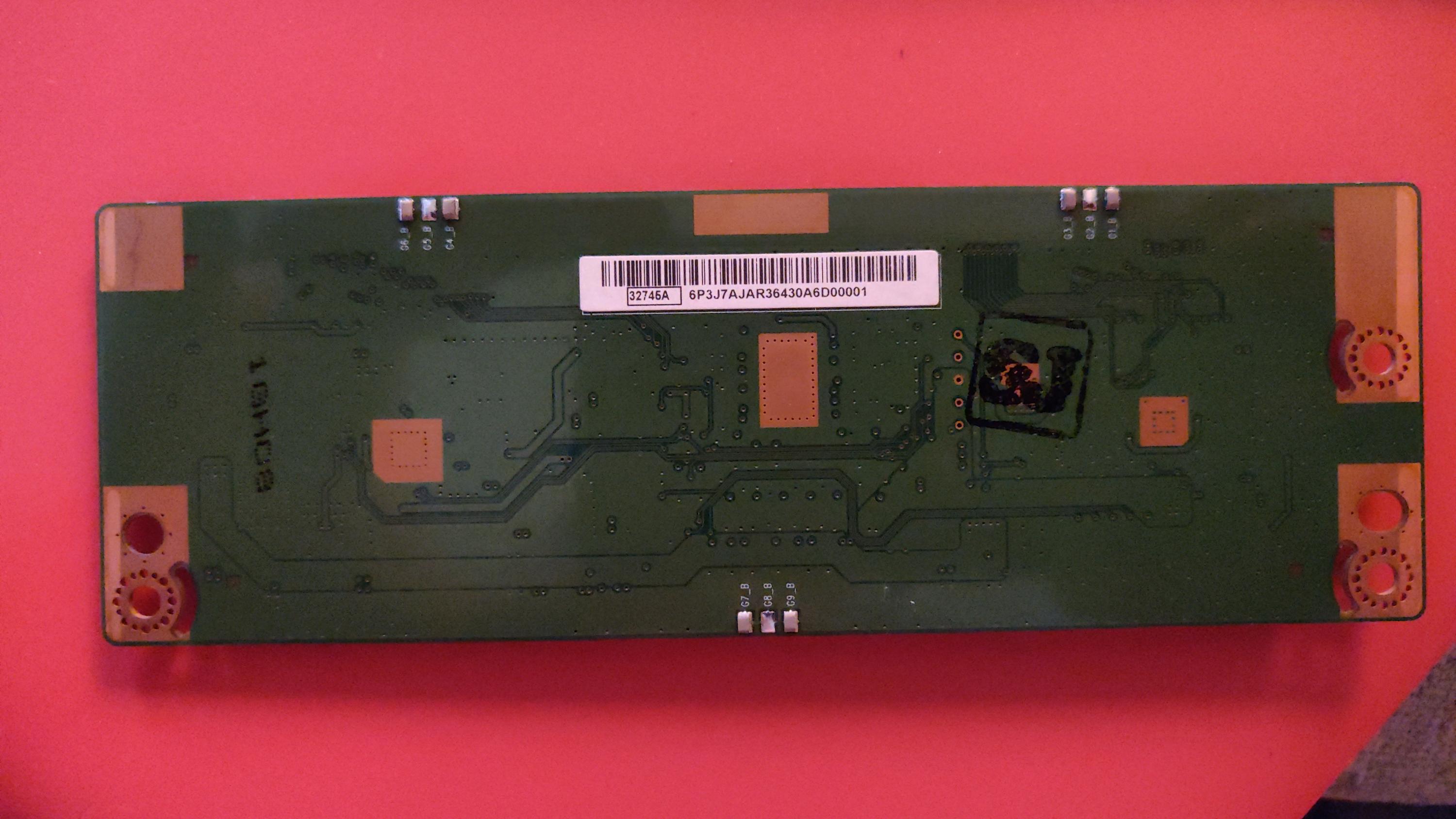

                      The PCBA numbers on the barcode sticker do not matched.
                      SJ PCBA is 32746A, your is 30065A, you may want to verify that with SJ.
                      https://www.shopjimmy.com/samsung-bn...con-board.htm#

                            Ok, so I swapped some parts from sj board that was a non match with original board.
                            Swapped cm608 ic and p12 voltage reg. (voltage on regulator is 3.3v on left side and right side is 1.2 which I thought was vr output and was also supposed to be 3.3v)
                            No change, but ive now noticed that the cm603 ic which is the smaller ic on the right hand side is extremely hot. However, not sure if this ic is interchangeable. Anyone know for sure, as i could find no data sheets for any components.

                                    So just an update...
                                    Cm603 was almost burning hot to the touch, so I pulled ic chip from one of the non matching boards for swap. After completing reinstall of the swap chip it was still hot to touch but I noticed that the color settings were now slightly better, so I fiddled with controls and options cycling through to see if it could be made right
                                    After 10 minutes of fn with settings, the picture snapped to and the overheat of cm603 ceased and is now cool to the touch while in operation.
                                    Ultimately I swapped 608 and 603. 603 seems to be inline with short but maybe not the exact cause as overheat persisted for a time after swap.
                                    It was reported to me that tv had been wiped tv with a damp cloth prior to screen bleach affliction. Some signs of potential water penetration behind filter layers near edges were visible. Any chance that if water got on the cof tabs it would need to be baked off with heat before short would disappear. (Just curious)
                                    In reflection, I think 608 was dead and overheat on 603 did not occur until 608 was swapped. However replace of 603 was necessary to get whatever bad juju that still remained worked out. Time will tell if it's a permanent fix.
