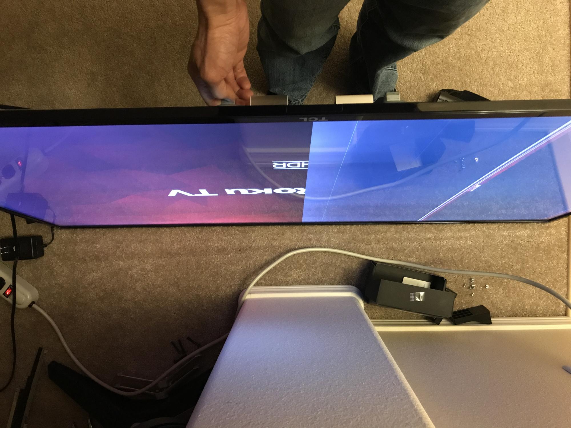

        AH HA! It turned on again... i spent the last 20 minutes measuring an annotating voltages. Please see the spreadsheet in this post.
        Please see Tabs 2, 3, & 4... it's the right most column with data .. marked "working 3/31" as the title.
        Regarding VGL: With the TV working, VGL is STILL (-5.5V)
        For the "right" board - fifth tab over, i measured HVAA as 0V when it was broken and 7.35V when it's working. The "working" voltage has been double checked... i wonder if this was a measurement mistake in the "broken" state..
        VGH measured as 33.25V when the TV was in the broken state. It measures ~25V when it's working.

          Also -
          While the TV is on, i probed the Mainboard differential pairs towards the connector to the T-CON. Diff pairs, 50mV/div and swept the time scale - no apparent signals? The amplitude would not be less than 50mV..
          From the T-CON towards the cable connectors - i see signal pulses. Same with the diff pair test points on the tab boards. I'll look at them again when the TV finally "kicks the bucket" and turns off.
          It's been about an hour so far - still running.
          The very interesting data point here: I have the ORIGINAL T-CON and ORIGINAL Main board installed -- it was left this way after i went through all the combinations of "old" and "new" boards yesterday.
          -Thomas

                    • ngth82
                      • Jul 2015
                      • 541
                      #50
                      Re: TCL 55S405TBBA - backlights on, no video; T-con and main board replaced.
                      Originally posted by budwich
                      a "gross short" might not be the problem in terms of "always shorted" but maybe "collapsing" as it takes a load.
                      Do you have any idea of the sequence that gets a regular working image... eg. wait 20 minutes, power down, power up, hit menu, etc ?
                      There is no sequence of events that gets the TV to a working state. I was surprised to get it to boot three times yesterday, but that is merely random as far as i can tell.
                      The first time it worked yesterday, it was about 30min-1 hour between the last time i had powered the unit up. About two hours later - i tried it again.
                      But before then, the TV had been power cycled numerous times before with no resulting image on the screen.
                      All i do is:
                      1) plug in the unit
                      2) wait for the status indicator LED to go from "full brightness" to "half brightness" (this seems to be when the TV is ready to accept commands.
                      3) hit power on the remote.
                      4) Watch the status LED slow blink;
                      5) Backlights come on
                      6) -- and at this point seldom see something on the screen.
                      7) proceed to whatever task i was out to do -- measure voltages.
                      -Thomas

                          • ngth82
                            • Jul 2015
                            • 541
                            #53
                            I taped up both ribbon cables. I have a second set from the tv with the smashed screen
                            On the first try today, I taped up the ā€œrightā€ cable. All 15 pins from the right hand edge. I powered it on and this happened (see picture).
                            I powered it off and back on again - it went to black. If the tape method ā€œfixedā€ it, I would expect the same picture result when powering on again. Wouldn't you?
                            Tried several times again. No dice. No change. Picture remains black.
                            With that in mind, I taped the ā€œleftā€ cable and got the image to come up - first try. Power cycled, then it went back to black. (See second image)
