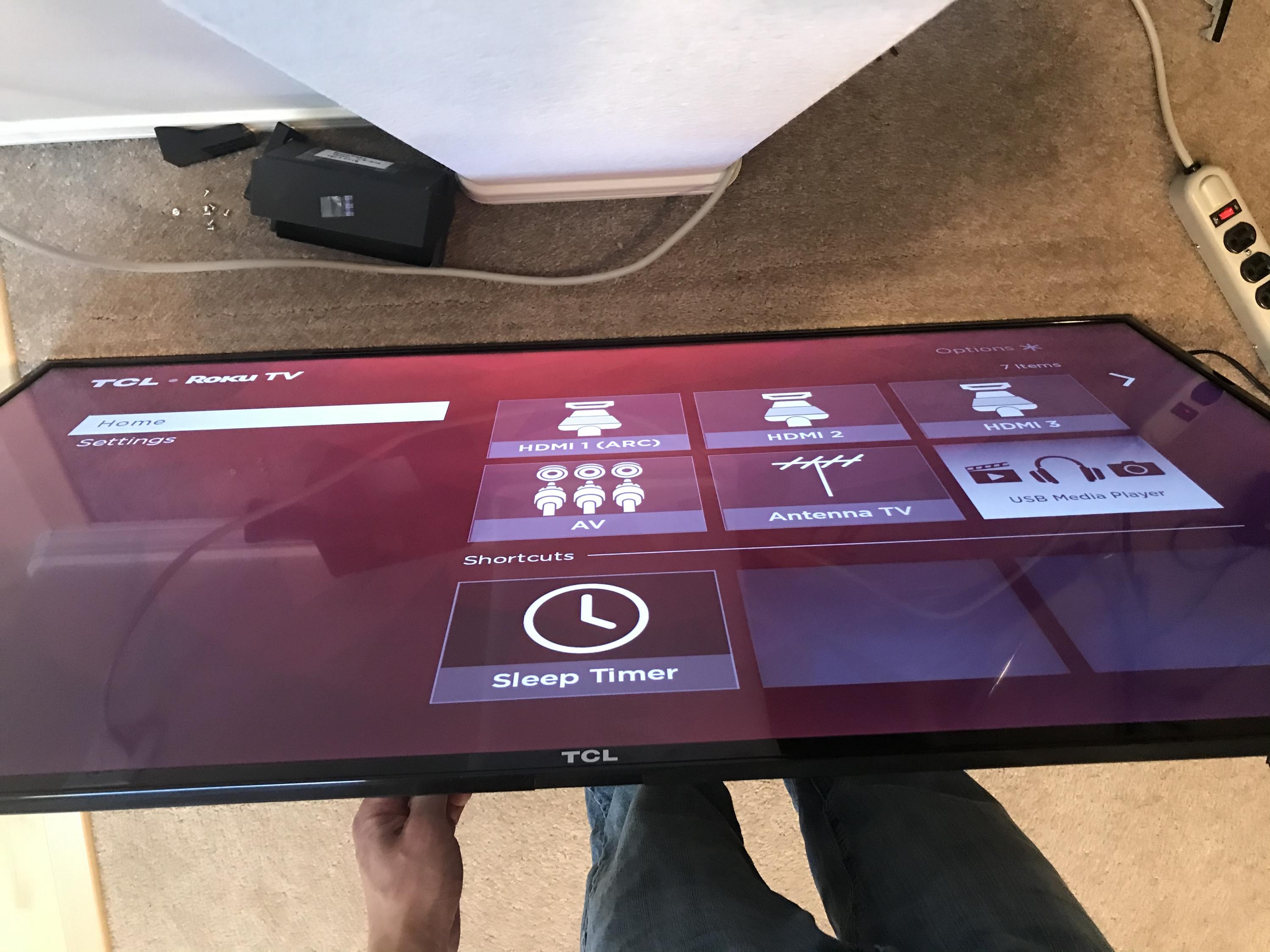

                                  • ngth82
                                    • Jul 2015
                                    • 541
                                    #37
                                    Re: TCL 55S405TBBA - backlights on, no video; T-con and main board replaced.
                                    Originally posted by budwich
                                    Interesting.... it would appear that maybe there is some base level coms between the tcon and main board... but my "pay grade" at this point is way past.
                                    The display patterns that you posted especially ones where there are "significant" difference from a "perfectly" even black / white screens might be screen that are attempting some sort of screen but the panel is in trouble. Further, since appears there is some sort of start up sequence with the main->tcon, it is possible that perhaps there is also some sort of similar "sequencing" between the tcon and panel / edge board and that is not complete.
                                    Not sure how much further time you have, but if you get the panel to display again like in the previous posts (blotchy white / blacks), check some of the voltages ... vgl / vgh / vcom on both sides to see if you can spot anything. Again, you might try the tape cutoff method to see if the panel comes up.
                                    still further, if you get a "half panel" result like previously (or otherwise), during your "playing", trying using your finger as a "touch probe" around some of the smd componets (eg caps) on the edge board. A few have found that the "added capacitance" may trigger things. This is no worry of body safety as the voltages are all small.
                                    I had a few minutes... i powered on the TV and the screen came right up (see first pic). I powered it down and disconnected the "left" side of the screen. The right side stayed up - left side was perfectly white. (pic 2).
                                    I powered it down again and swapped the cables (left connected, right disconnected) - no dice; i reconnected it again - no dice. No video displays again.
                                    While the full screen was "working" and actually displaying something, i ran my fingers across each tab -- pushed on it a little bit to see if i can get the image to change. Nothing changed. Did this twice.... no difference.
                                    With the unit not displaying video again, i ran my fingers across the tabs once more - no difference. Slowly pushed on each one hoping something would happen. But nope.
                                    I'll try the tape method today - soon, but what's the chance of success on this TV since it has side tab drivers?
                                    -Thomas

                                    • budwich
                                      • Jul 2015
                                      • 3097
                                      #38
                                      what.... sorry for get this post... I didn't see the pictures and missed the part about seeing a picture... wow.... forget this ->
                                      not sure I understand the "power down" statement... oh, you mean cord disconnected in what ever state the set was in (ie. if operating, then it kind of keeps that state so that if you plug back in all you need is to do a "power button" start as opposed to wait for the thing to initialize... right?
                                      anyway, it does appear that the main board kind of thinks things are hunky dory and appears to power up and down, in terms of state lights, OK.... so perhaps things from the tcon out are a target.
                                      I think is you track down the vgl (which I will take as voltage gate low), that value should be more in line with -12v (guess). It is being loaded down or the driver has an issue.
                                        why the hell did you touch any cables ????? :-))))))
                                        YOU HAD A PICTURE
