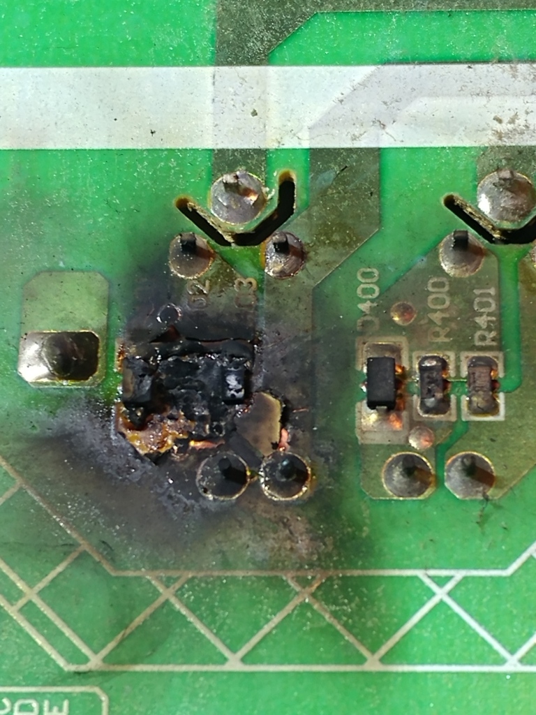

    Got a Vizio E3D470VX. Issue is when power is on, no video. I did a flashlight test and I can see an setup menu in there. I did not connect it to a video/audio source to see if it would play. Do I need to do that?
    Took off the back cover and found the P/S board burnt. Looks like its beyond repair since it got some of the traces on the back.

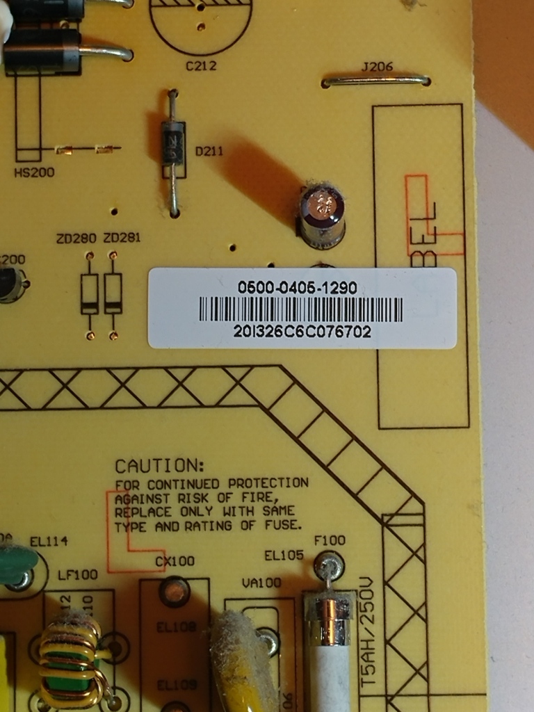

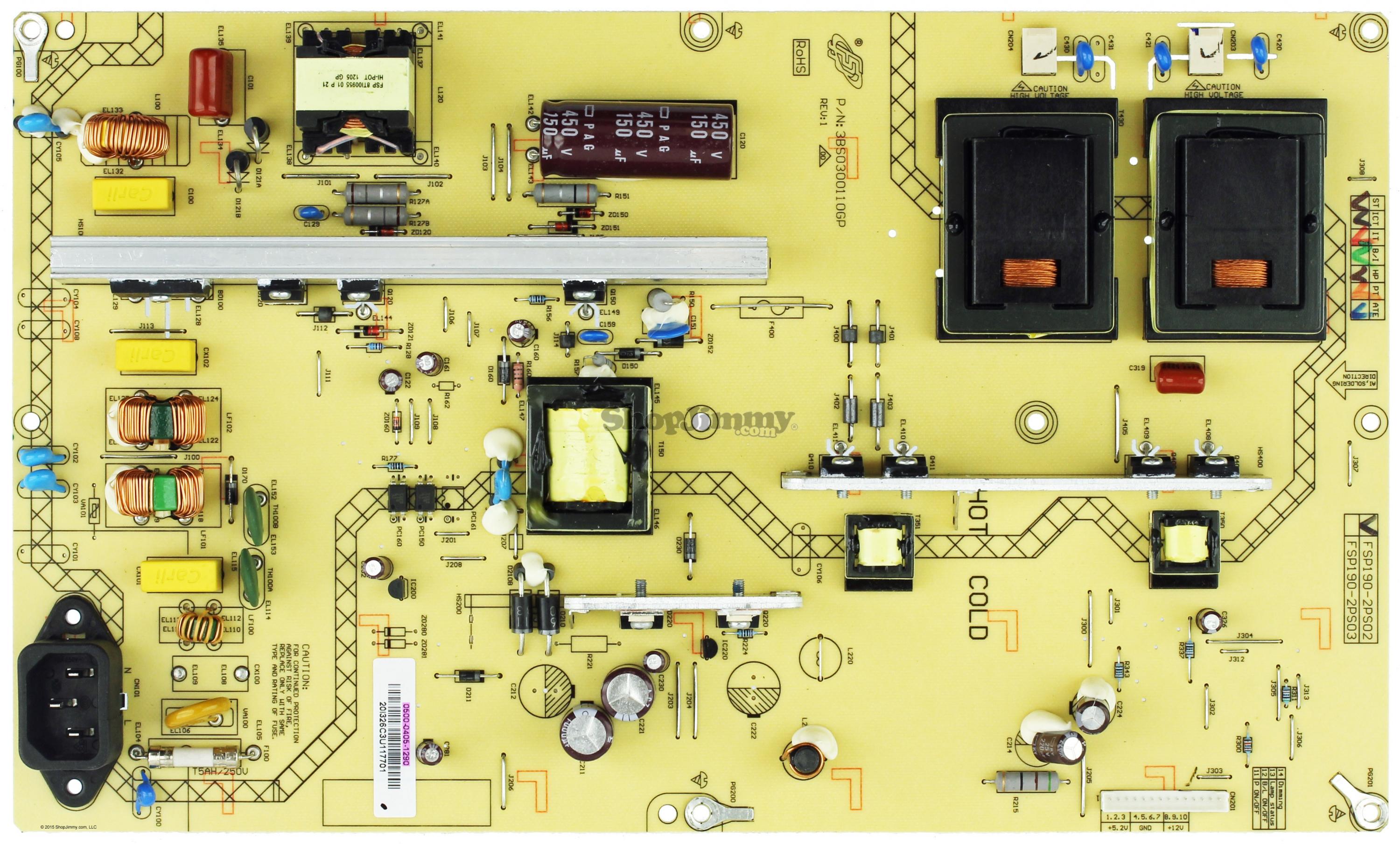

    Next step was to try and find a replacement board (#500-405-1290). ShopJimmy doesnt have one in stock. The ones that they list as an alternate replacement does not look like mine.
    Any advise to find a suitable replacement or alternative board.

      Those sub boards should work, shop jimmy usually gets it right, even tho they may look a little different.

        So accordingly this one should work, it looks newer and cleaner it's about 22 dollars cheaper and there's a make offer option: https://www.ebay.com/itm/Vizio-0500-...YAAOSwMTFeSxfH

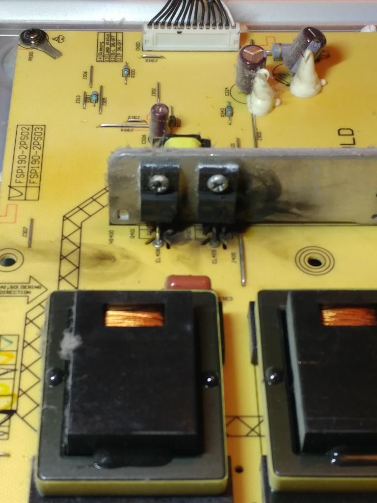

          I saw that one on ebay (from ablemantvflatpanelparts), but it just looks totally different. Here is what mine looks like (see attached). I just saw your second post. Going for the "Best offer" option.
          Found this one too.
          The video board looks good. Its pretty obvious that the P/S board is toast, but is there anyway to be confident that this is all thats wrong? I dont know any history on this set.

            They re-design and revise them, it's on the sub list, I would trust it to be a match. The one you found has the same number as yours, looks good, 42 bucks depends on the shipping I guess.

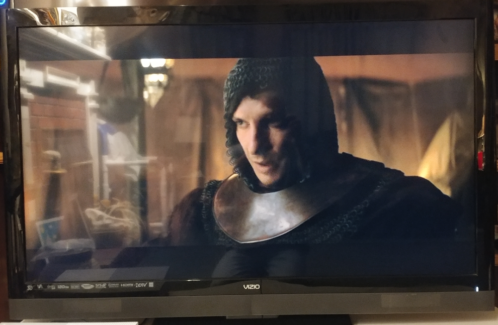

                    FYI.... Got the board installed. Worked perfectly. Great Picture. Not bad for something I picked-up sitting on side of the road.
                    Thanks for help.
